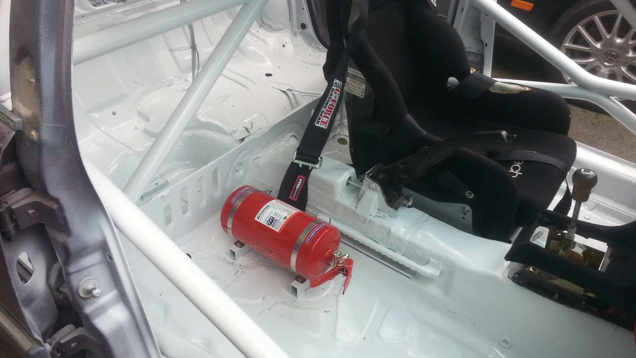

Fire system mount
Fire system mount

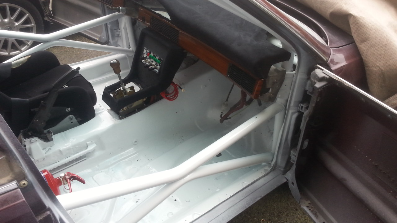

Interior
Interior
Original Car
Original Car

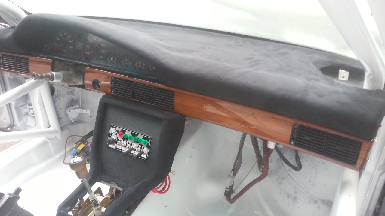

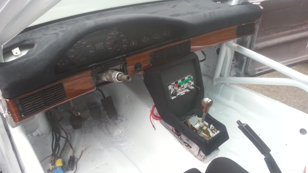

Dash, notice the wood trim, a little bit of class!! Plus the dash and center stack is wrapped in Alcantara

driver's position.  We stripped the car completely of the sound deading, lots or work.  The interior is painted with Dupont single stage factory pack white

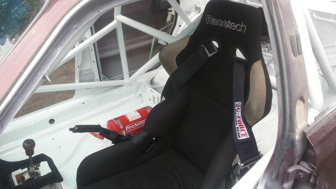

RaceTech composite seat.  The seat is on dual locking sliders, plus there is an adjustable rear seat brace on the roll cage that can be adjusted during drivers changes

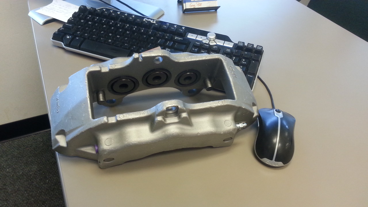

17z 6 pot calipers, we can get these for only $110 each rebuilt in raw

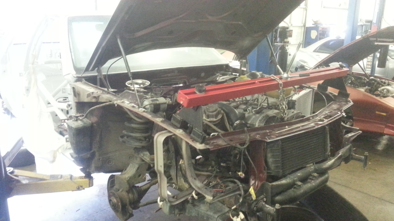

when we were working on the gearbox, constant issue

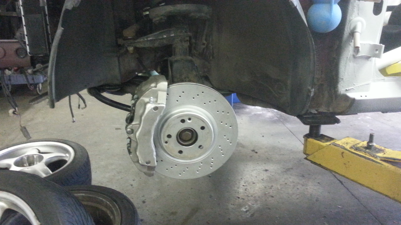

brake setup, no adapters because they weren't allowed, just some grinder work

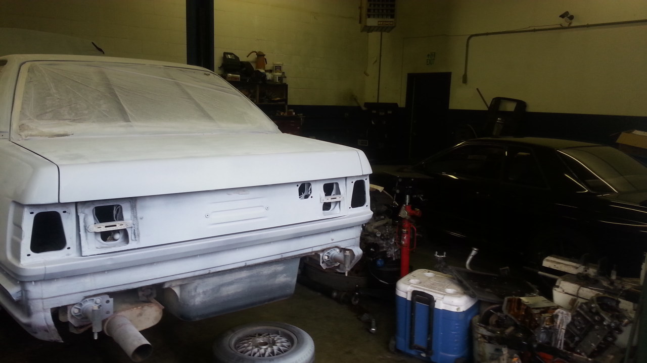

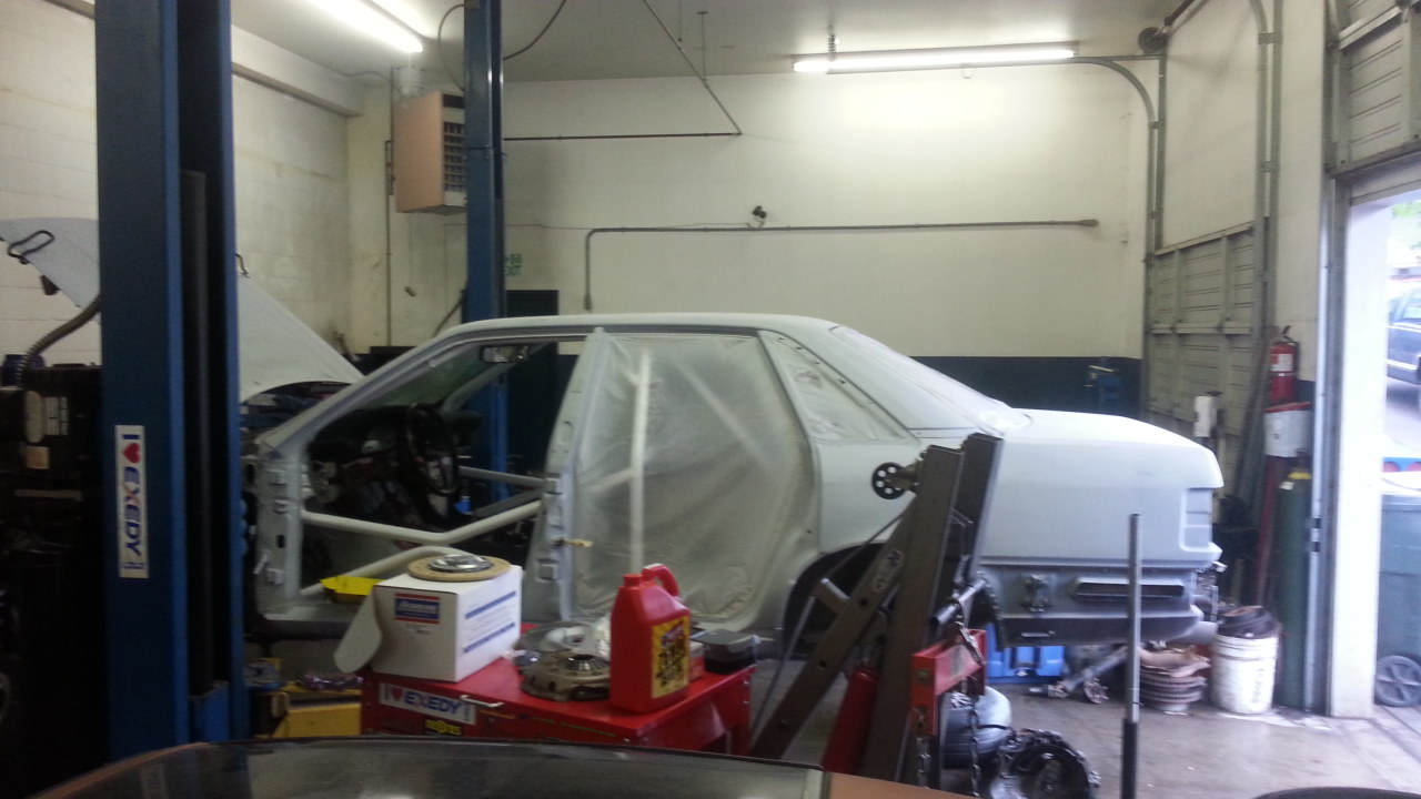

in primer, notice there is no sunroof, we re skinned the roof, only 91 200 20v with no sunroof I believe

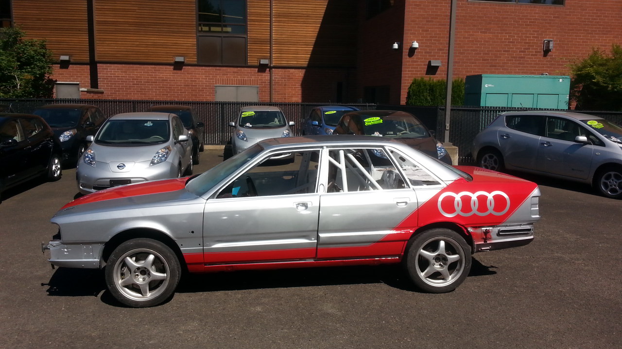

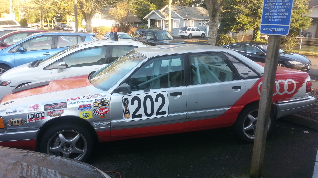

fresh paint, these aren't vinyl graphics, it's all paintwork.  We copied the audi v8 dtm car paint, like it better then the trans am look

I didn't realize those had an 016 and not an 01e from the factory. Definitely go for the o1e swap.
Car looks good. The juxtaposition of the full dash in an otherwise completely stripped and clean interior is hilarious to me.
