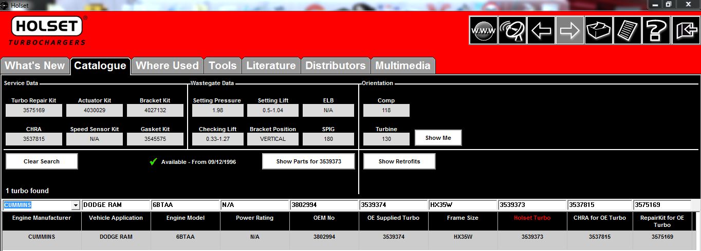

i have the stock holset documentation for the HX35 and HX40. it says that when setting base boost pressure on the HX35 in a dodge truck is 26psi and they also say that the maximum pressure output safely is 42psi if i recall correctly. the HX40 is like base pressure at 34psi and max 56psi. now i would assume this is all based on the engines these turbo's actually belong to as well.88a5tq wrote:Damn that's crazy pressure! The hybrid turbo part was for the guy with the screen name yada-yada-yada but still interesting. Link to s2forum thread? Thanks
Actually here's the data for my turbo straight from the holset catalog.
- holset.JPG (109.81 KiB) Viewed 25645 times
