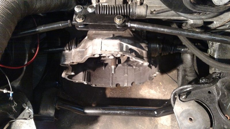

I pulled motor by myself with this jack. Hopefully goes back in as smooth. Was fast not taking manifolds or turbo off.
Re: My VEMS VRT o1e CQ..

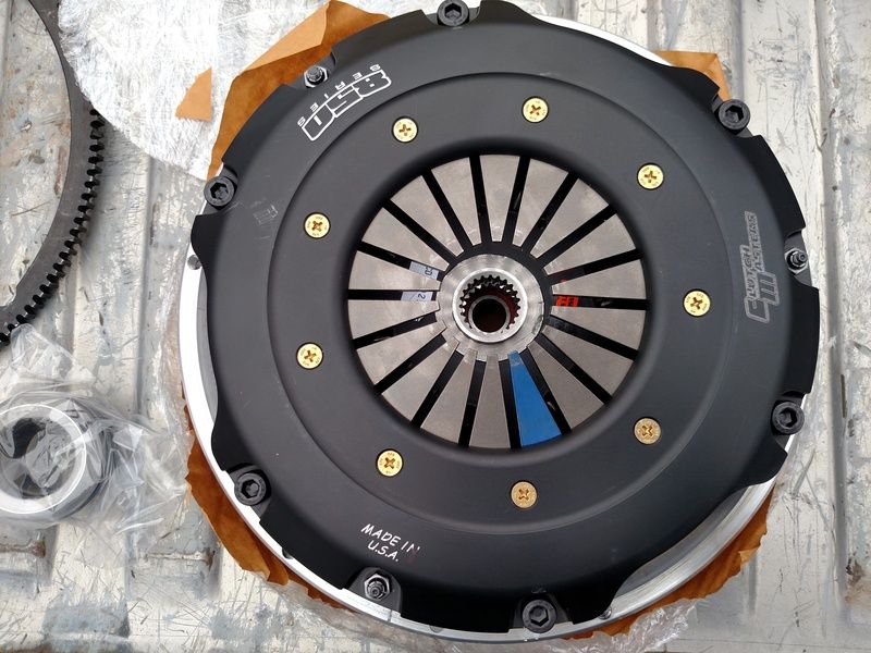

New clutch
New steering bracket. All done
Motor going back in
Motor going back in

You know it's Made in USA because it's the only damn country that would use Phillips head bolts for something important... Lol. Sorry. Looks great!
I think the same thing when I'm around airplanes and see all the phillips fasteners. I should talk to one of the design engineers and find out the reason.chaloux wrote:You know it's Made in USA because it's the only damn country that would use Phillips head bolts for something important... Lol. Sorry. Looks great!
The Phillips just holds it steady. Once it's starts to get tight, u don't even have to hold it while ightening nut. I'd prefer Allen head instead of the phillips but I probably won't ever take them out anyway.

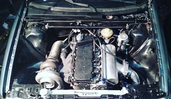

Looks like you might have a little boost leak at the intercooler inlet

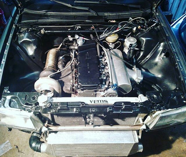

well the turbo was making more and more noise so i stuck a fork in her this weekend
thank god for aaron and his turbo shelfs.. one vband away
doesnt look much different in this pic compaired to the one above, the pte was 4" and the new turbo is 5" inlet.
Here's a better comparison and why my vc is scratched up in above pic hehe..
