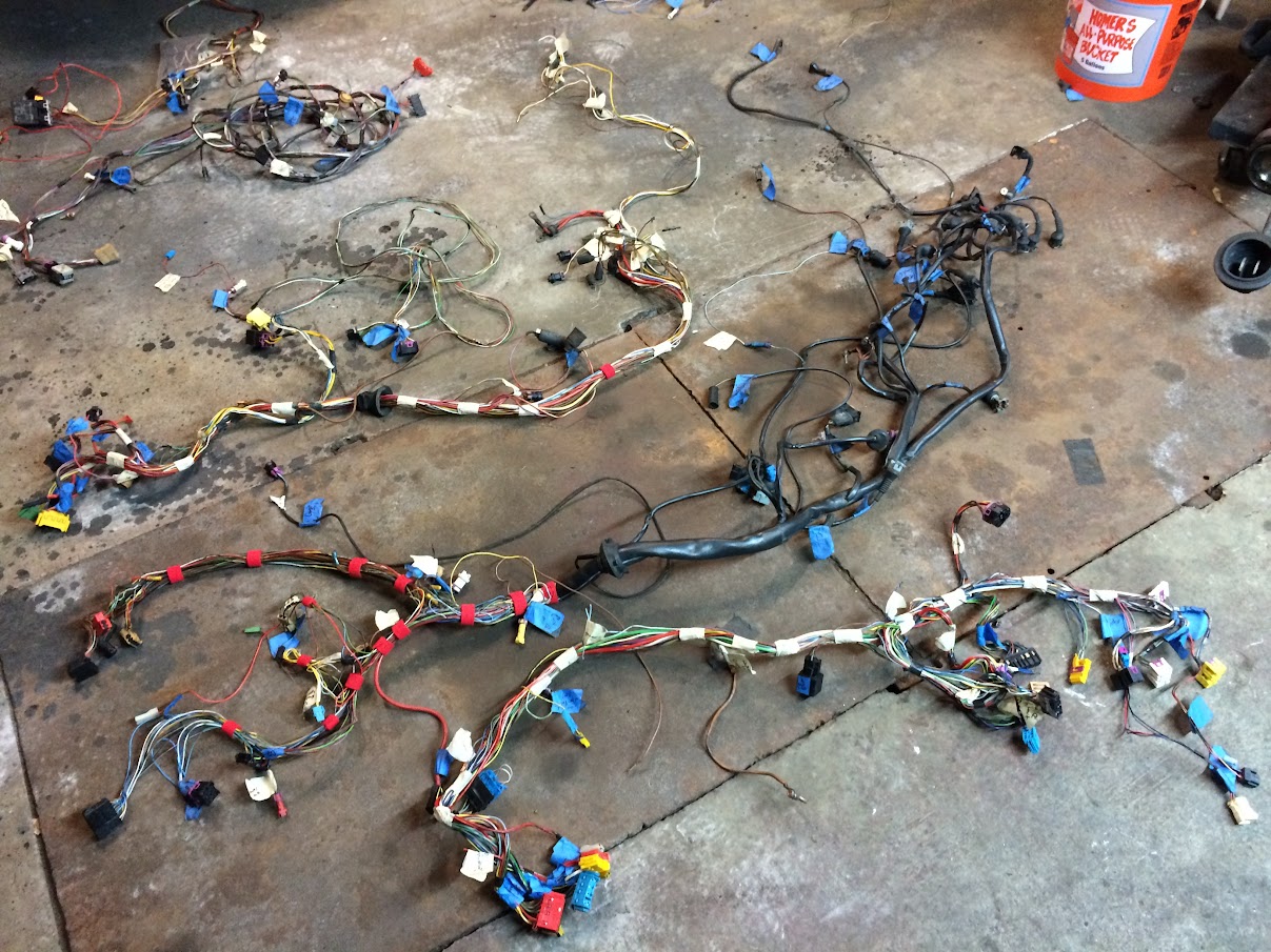

OK, got a small bit of time before Lemons, and got the main interior harness to where I want it. Yes, it could be better, but damnit, It's going to have to do for now!
The little black wraps you see are not electrical tape, they are one-wrap velcro straps. The way I see it, there is no reason to wrap an unproven harness up in nice, expensive adhesive-lined shrink wrap because I'm sure I'll be back into this thing all too soon.

Still working on the wiring a bit. Replacing all my shitty masking tape labels with proper vinyl labels that can withstand the heat/conditions. I'm happy with how it's coming out but it's taking plenty of time!
This is about 80% of it:
