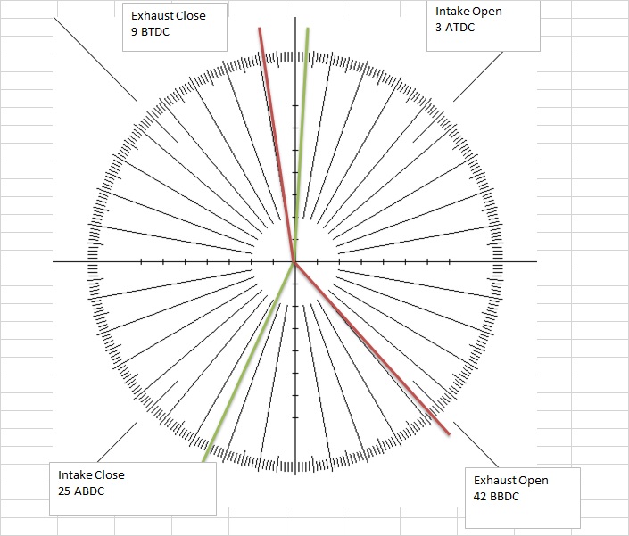

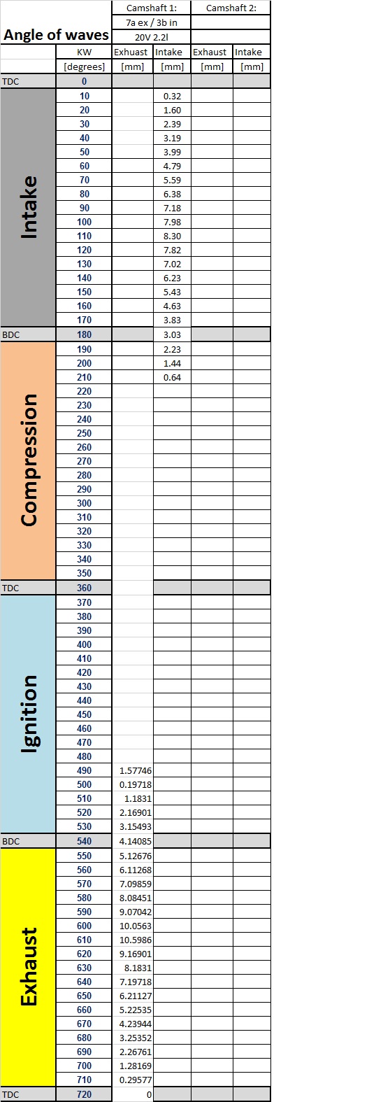

ok - believe it or not I'm finally getting ready to start this thing - but in doing all the necessary due dilligence, I've discovered that my Cam timing graph is fawking wrong - if anyone would like to verify my thinking that would be GREAT!!!!
So here's the thing - motor turns clockwise, that means that as you look at the graph, after TDC would be to the right of the zero mark and BTDC to the left as well as BBDC to the right and ABDC to the left. My original graph shows this relationship backwards. So, re-adjusting to this thinking - which I believe to be correct is attached (BTW also figured out that each tooth on the cam gear on the chain = 30 degrees on the crank and every 20.3 degrees on the crank is = 1mm of valve movement, so moving by a tooth = ~1.5mm of valve lift)
Cam timing w/7a ex and 3b intake
vbares
Posts: 36
Joined: Thu Apr 18, 2013 11:31 pm
Re: 4kRR Audi 4000 Rally Rig
Post by vbares »
in order to try to wrap my head around this - I built a model that shows the degrees of the crank and which stroke the piston is on. This helped my understand that the way I currently have the cams set, is exactly what you want:
1. Exhaust as piston begins descent on the intake stroke
2. both closed during compression and ignition stroke
3. no overlap when the intake and exhaust are open at the same time
Based on what we know regarding the duration open-to-close for each cam shaft as well as the lift, we can calculate that for the 7a exhaust, each degree of lift = .0985mm and for the 3b = .0798mm - given that we can build this model:
Intake and exhaust modeled by stroke type
this shows that the exhaust closes 12 degrees prior to the intake opening - there is no overlap and no danger of bending valves ...whew...
If anyone has thoughts on this - I'd love to hear about it

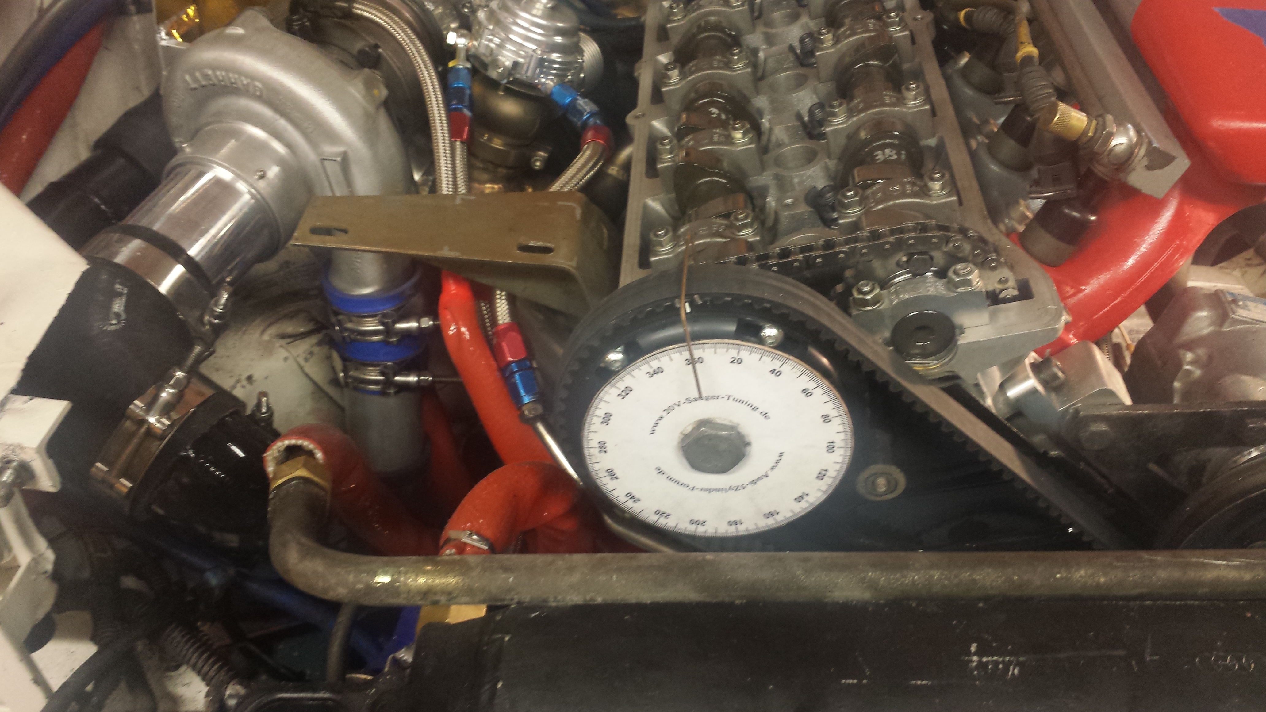

and there's more - in order to be able to tune at the dyno I've made a degree wheel that we can use to measure what's going on
2015-07-12 09.52.49.jpg (3.01 MiB) Viewed 51498 times
downside of the 3b intake manifold is that you need to remove the TB to remove the valve cover :roll:

Makes sense to me!

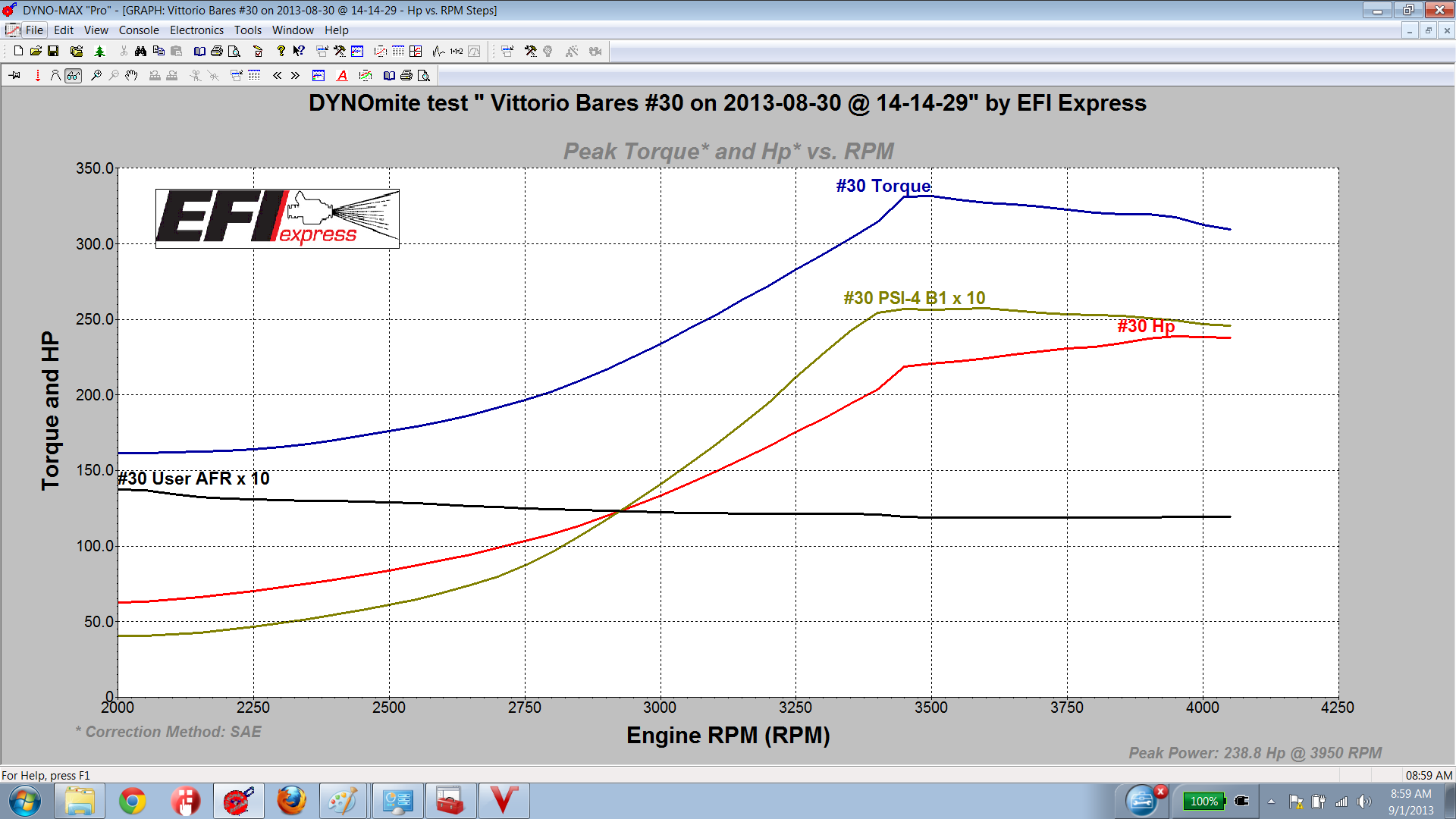

Ok - this is the old numbers - GTX2862, STR log manifold, sub-optimal restrictor (but really not horrible):

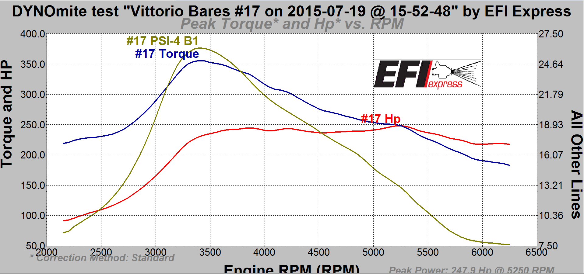

Next is GTX2840 (IMS flavor), efficient restrictor, IMS small runner EM, 7A exhaust cam, 93octane:

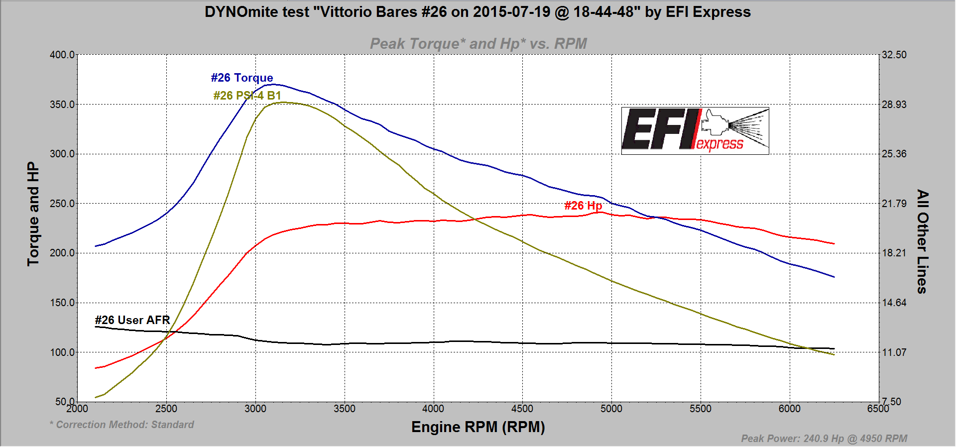

Next is GTX2840 (IMS flavor), efficient restrictor, IMS small runner EM, 7A exhaust cam, 103octane:

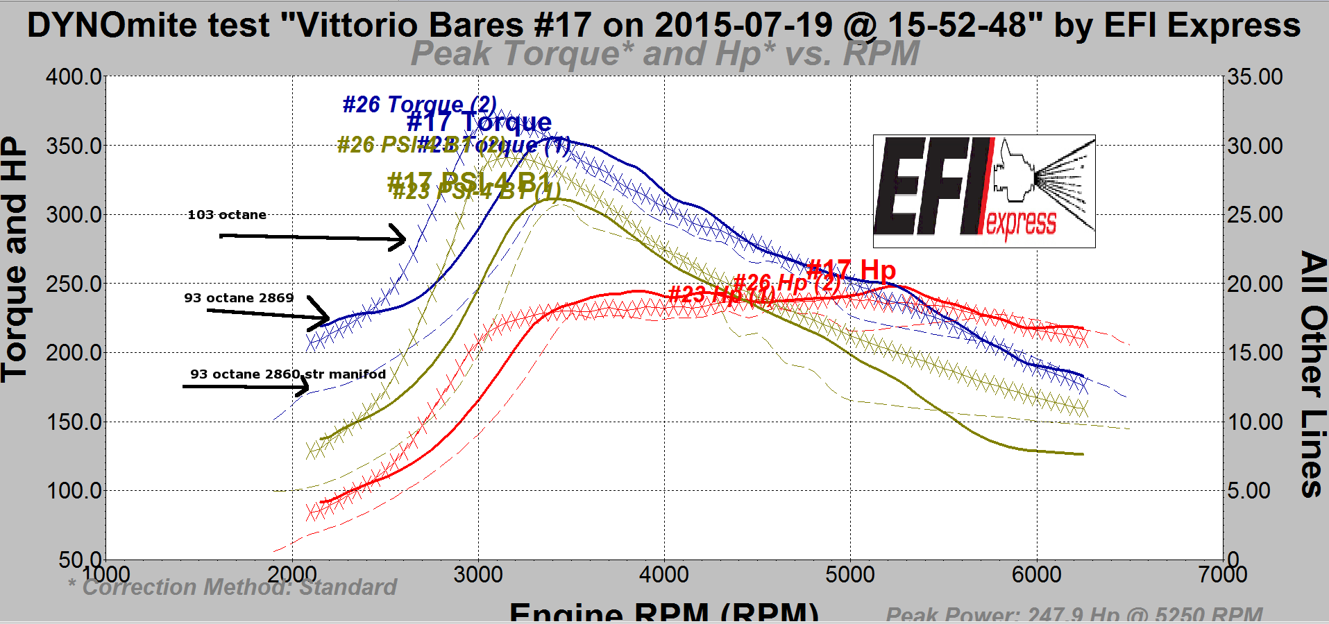

And finally an overlay of all 3:
Conclusions:
Restrictor improved HP numbers 10%-20%
Small runner EM, 7A exhaust cam and custom turbo improved spoolby 10% on 93oct and 25% on 103 as well as smoothed the boost curve
103octane, awesome early power, 370 ftlb @3100 rpm.
Running 93oct still produces 350 ftlb around 3300 rpm, but for much longer than the 2871 - which is pretty good when having to make the choice between race fuel $$ and pump gas...
