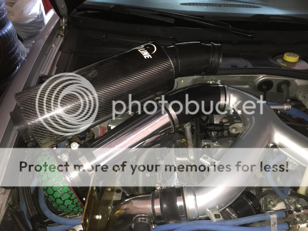

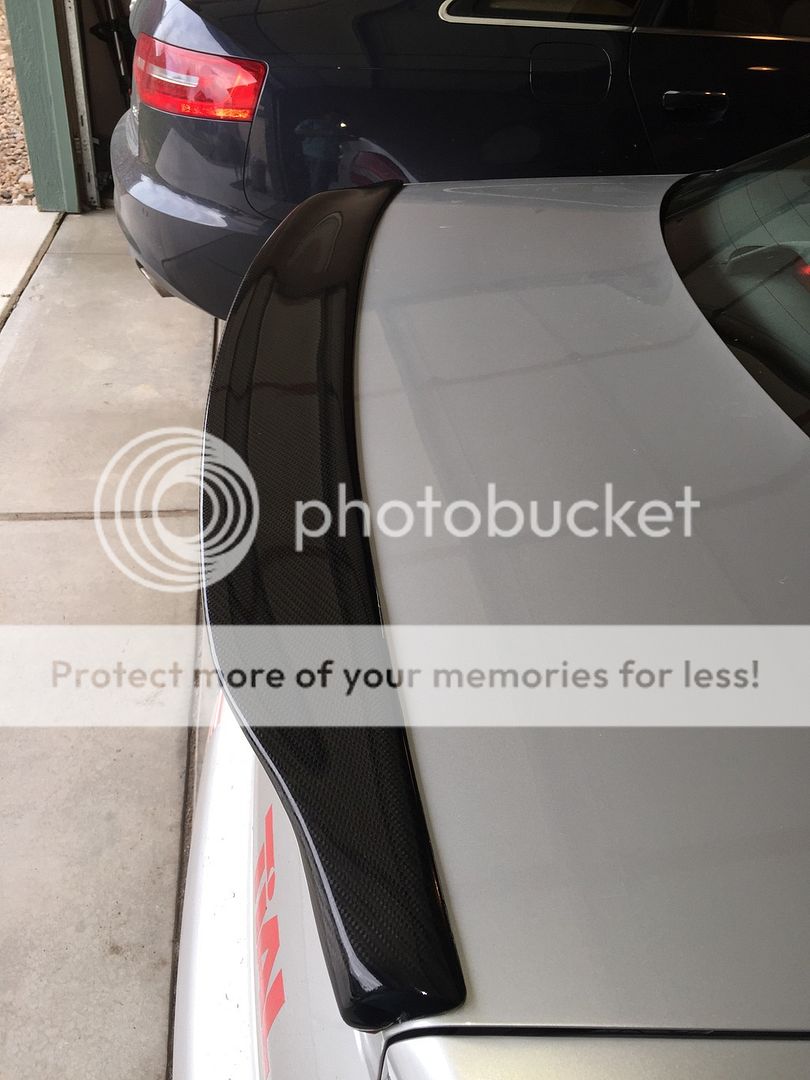

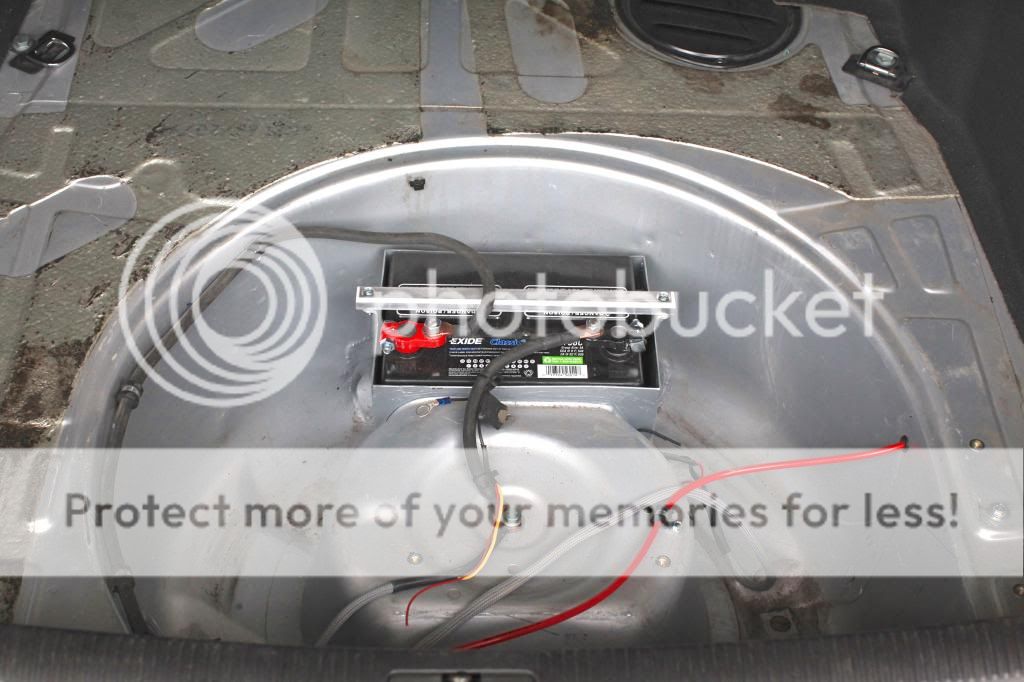

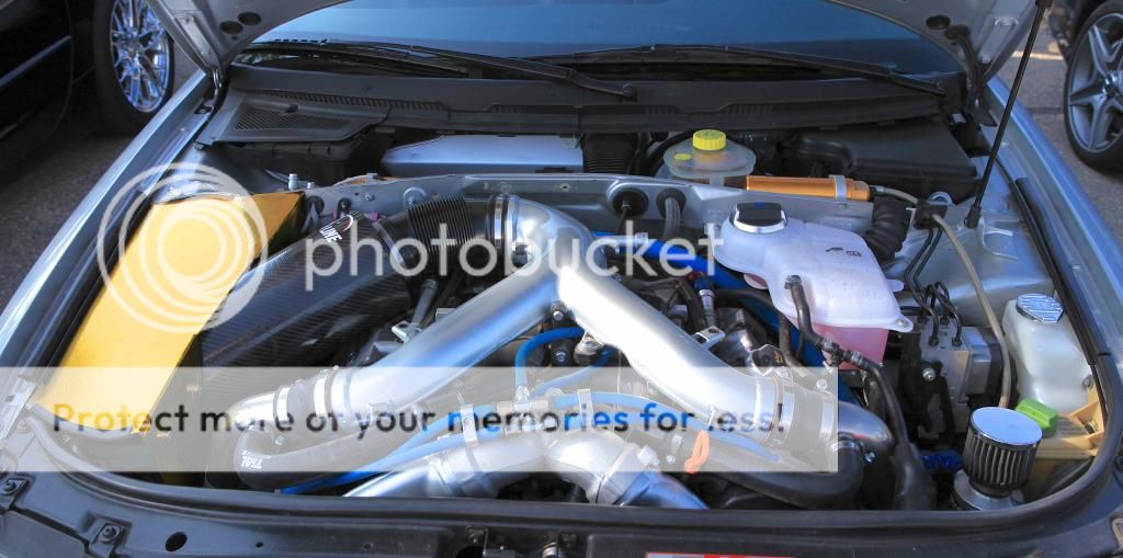

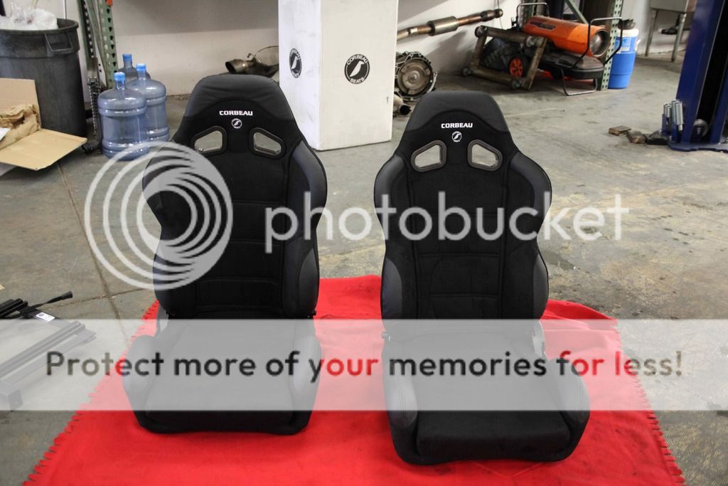

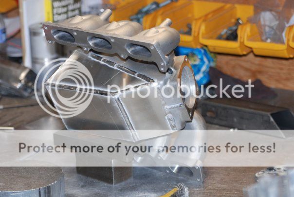

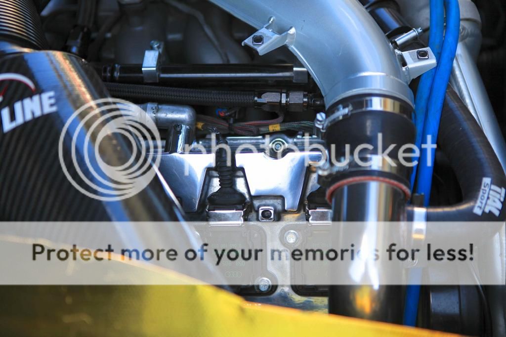

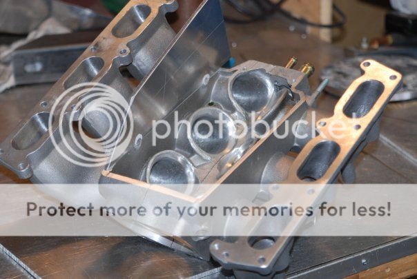

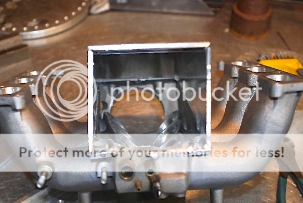

My second Hot Rod Audi is also my daily driver. This car was also built by Dave Jones of S-Line Motorsports with consultation, welding and tuning by Brendan Rudak. I purchased this car from Scotty Davis about 1 1/2 years ago and have added my own touches to enhance the overall affect. Here are the build sheet and some pics:
Engine Modiifications:
Ported RS4 intake manifold with enlarged plenum and thermal coating, 034 Motorsport Drive by Cable kit with 80 mm big bore throttle body, OEM 2.8 large port cylinder heads with full porting, RS4 cams, solid lifters, Supertech 1mm oversized intake and exhaust valves, Supertech high rate valve springs & titanium retainers, polished valve covers, OEM 2.7T APB block, OEM balanced and knife edged crankshaft, Pauter rods with ARP 625+ rod bolts, OEM pistons with Swain coating on sides and thermal coated tops at 8.5:1 compression, ARP main studs, ARP head studs and bolts, 034 coated main and rod bearings, dual Bailey BPVs, OEM ported exhaust manifolds with thermal coating, Tial 770R turbo kit, custom 3.0” stainless steel down pipes with 1.75” wastegate pipes, HKS 4” air fiter with 4” aluminum tube fitted to an 034 reinforced silicon 102mm to RS4 Y pipe, APR Tuning Bi-pipe, 034 fuel rail kit, relayed Aeromotive 340lph in-tank fuel pump, Fuelab external fuel pressure regulator with pressure gauge, Fuelab inline filters, underhood fuel sump tank with SX Performance 18203 external fuel pump with -10 lines to fuel rail, heavy duty boost control system, custom shrouded oil cooler, new OEM radiator with dual SPAL fans and custom shroud, Earl’s 27 row external oil cooler, custom catch can breather system, Apikol side mount intercoolers and silicon hoses with custom shrouds, , NOS nitrous serpentine intercooler spray system for both side mount intercoolers with purge function for cooling during staging and integrated into the 034 IIc Engine Management System at set throttle position and temp with 10lb bottle mounted in the trunk, custom stainless steel exhaust with v-bands and dual Magnaflow mufflers, 034 llc Engine Management System with all supporting equipment and wiring by Dave Jones and tuning by Brendan Rudak, 034 llc features launch control and swichable fuel programs that include 91 octane pump gas and E85, the ashtray reveals 2 switches to engage the NOS system and to switch between pump gas and E85 programs, dash mounted button for purging the NOS while staging, Red Top Optima battery mounted in the spare tire well, 034 Motorsport motor mounts, Porsche oil filler cap and coolant expansion tank cap, Forge windshield washer cap,
Suspension and Drivetrain Modifications:
Southbend lightened steel flywheel and F-SS-XX custom clutch good for 800 ft/lbs, race spec CVJ front and rear axles with Teflon boots, Stasis rebuilt close ratio 6 speed transmission cryo treated gears with limited slip to the 2 front axles and high bias 4:1 center diff, JHM trio package short shifter. JHM drive line stabilizer, Stasis rebuilt rear differential cryo treated with limited slip to both axles, Stasis Motorsport Ohlins suspension with remote reservoirs and aggressive street linear springs 750lbft/1200lbrr, SPC Motorsport Edition adjustable front upper control arms, OEM front sway bar with Powerflex bushings, 034 front sway bar links, Neuspeed 21mm rear sway bar and reinforced subframe brace, 034 adjustable rear sway bar end links, 034 Motorsport transmission mount, new steering rack, Apikol rear diff mount, rear cossmember, rear diff crossmember bushings, Stasis/Alcon 6 piston front calipers with Stasis 355mm 2 piece rotors, Euro urRS4 rear brake set
Interior and Exterior Modifications:

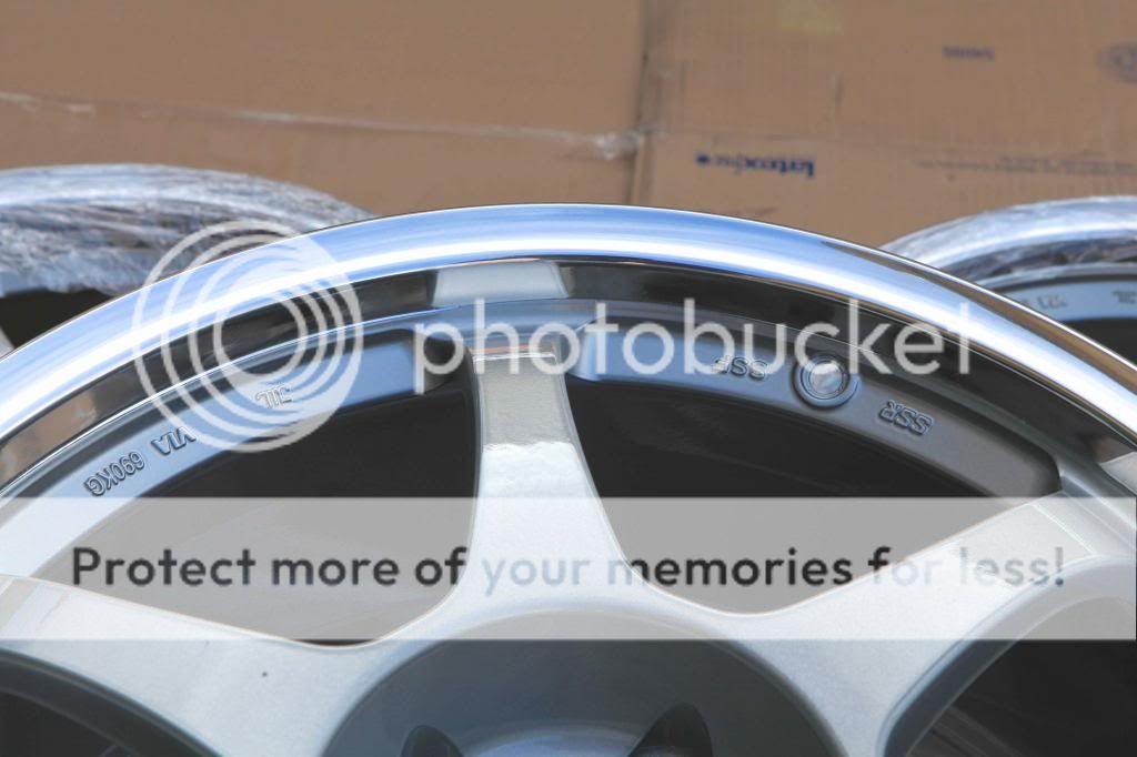

Kenwood DNX 690HD head unit with Nav, BT, HD radio, Sat radio, JL Audio XD 400/4 amp, Focal IBus 20 8” undertray subwoofer, Focal 130 AI SG front speakers, Focal TC 165 rear speakers, Sullivan Racing Products pedal and dead pedal set, Autometer A-pillar dual gauge pod, Autometer Sport Comp 35 lb boost gauge, Innovative wide band air/fuel ratio gauge switchable between left and right bank O2 sensors, custom carbon fiber trim set, custom hand stitched perforated leather covered steering wheel, JHM weighted shift knob, Schroth Rally 4 harnesses for passenger and driver, lightening underway with actual corner weighted readout at 3270 lbs, custom stitched mats. Reiger RS4 front bumper, Fiber Images carbon fiber hood with Aero Latches, Track-Studs 55mm wheel studs with matching conical nuts, 18x8.5 et35 SSR Comp wheels with polished lips and powder coated spokes, 245/35-18 Hankook Ventus V12 Evo2 tires, 18x8 Kosei K1 track rims with 245/35-18 Hoosier track tires, 18x8.5 powder coated Kosei K3 rims with 225/40-18 winter tires.
Performance and lore:
677hp/576tq uncorrected at the wheels on E85 at the Bluewater Performance Dynocom chassis dyno. The best lap time at High Plains Raceway is 1:58.8 with track tires. Yes, even with limited slip at all 4 wheels, the tires do break loose at times. Although somewhat highly strung, this car has proven to be ultra-reliable. It is my daily driver and track car. With E85 I run 35 lbs of boost on the street. The dyno runs were with E85, NOS blowing across the front of the intercoolers and that same 35 lbs. The ride is somewhat stiff but still comfortable enough for street driving. The car is an absolute blast to drive and beckons you behind the wheel.
