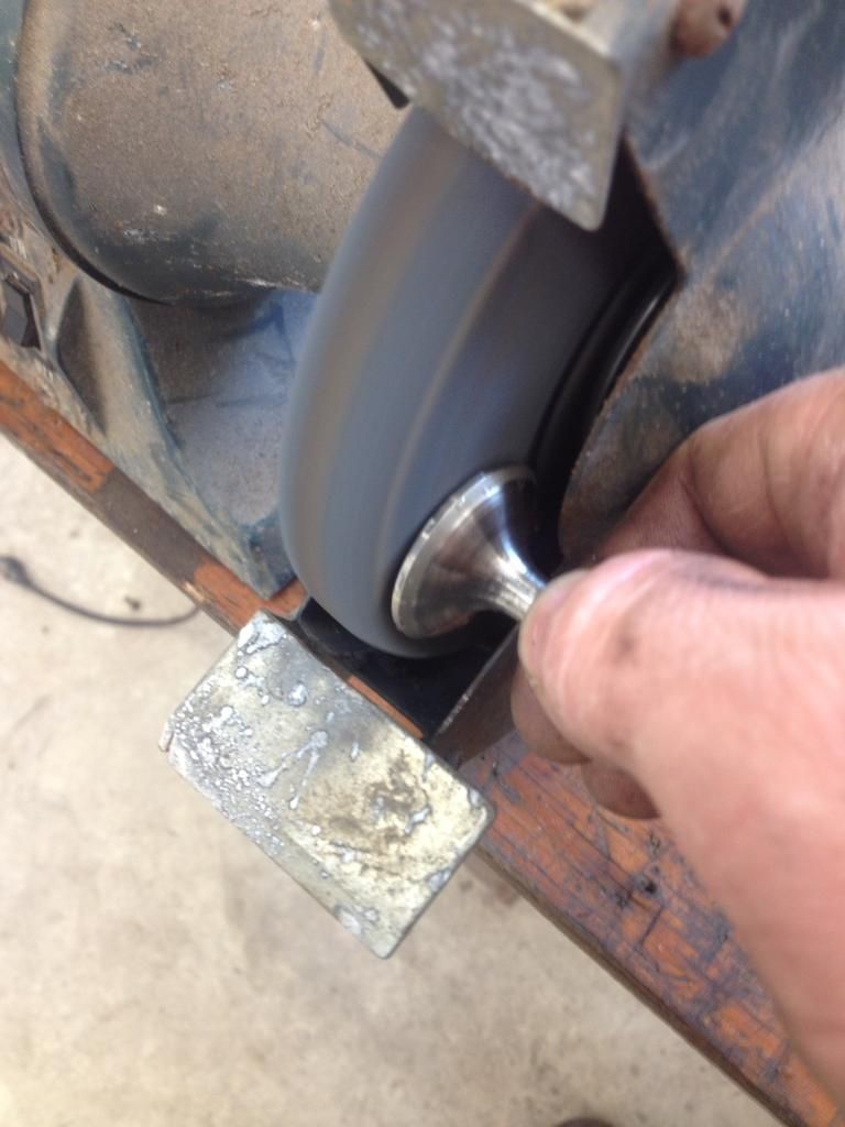

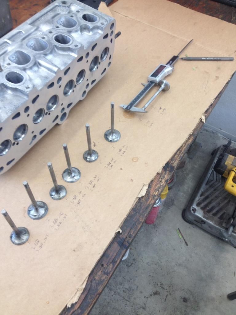

plus i like somewhat retarded DIY solutions like this. Its similar to how I just shaved .050" off my valve heads to compensate for a shaved head.

Lol at the valve fix.

scubagli wrote:Lol at the valve fix.
I actually took more care than it looks and ended up with a nice finish. You wouldnt even know I did this. I think its going to work just fine, but won't pat myself on the back until its up and running.
Was thinking I would post a DIY valve head skimming up on TDIClub.... :lol: I would get crucified. I might do it once it is running reliably.

Ha ha [SMILING FACE WITH SMILING EYES] they will love that.
