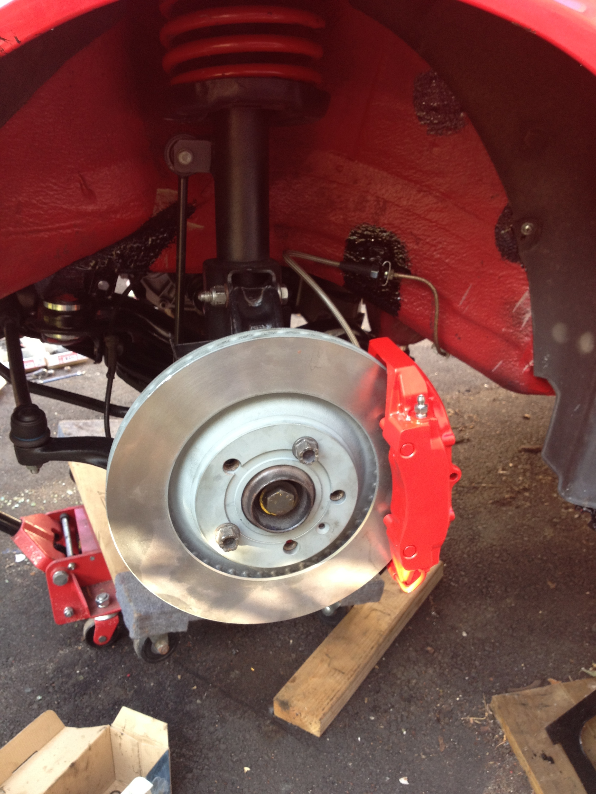

- Sebastian's CQ91' rear brakes done 1.jpg (2 MiB) Viewed 21749 times
