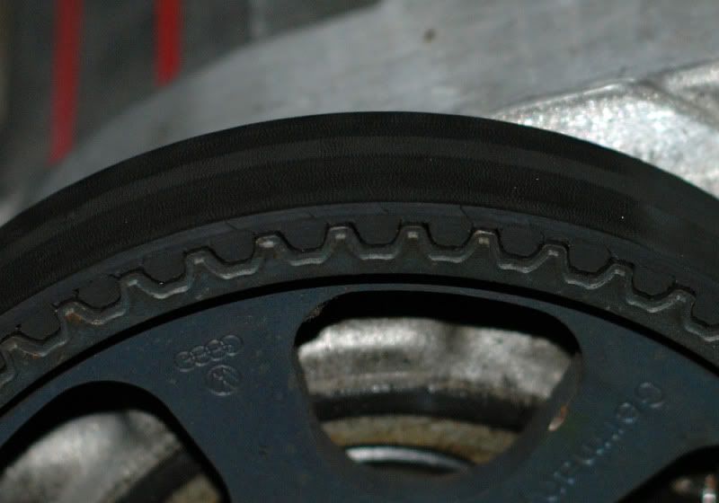

So I was taking the front of the car apart today in preparation for the t-belt job, and when I looked at the belt, I noticed that its about ready to take a shit any minute now. The teeth are starting to separate from the belt and there are places where its starting to crack though. I am not going to drive it until the 4th when my buddy gets home and we can use his shop. I might even have it towed to his shop because I'm scared to drive the 40 minutes it takes to get there. This belt didn't look like this a few weeks ago. Its crazy. It went from looking just fine to looking like imminent failure in a few weeks time. Scary stuff!

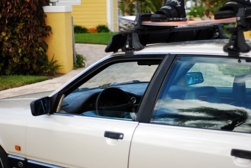

Got the roof rack all mounted up and test fitted but the $75 price tag definitely reflects. The bars are pretty trashed, but I'm going to refinish them to the best of my ability. I'll have pics up soon. It looks pretty awesome.

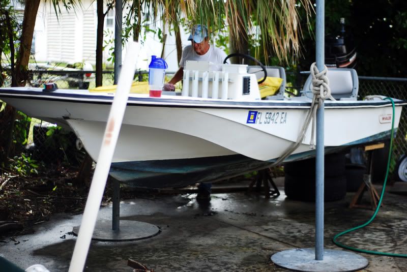

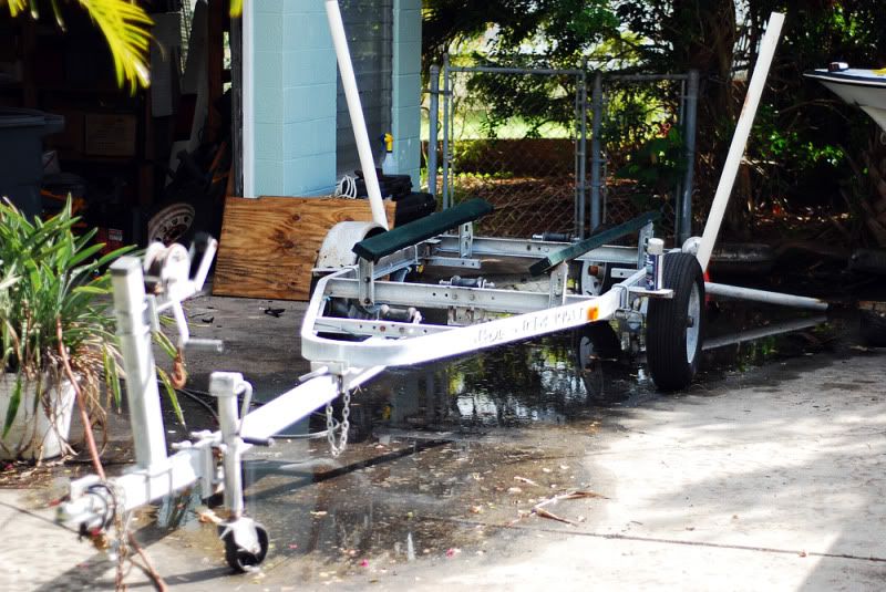

Also, this is the biggest thing I've accomplished so far this break. Old trailer parts were shitty.
Mounted new (used) parts for cheap and they are solid.
Got the boat back on and in the water :) She is lookin great and runs like a champ after all of the fixin' we did this month. This is how it came off of the trailer and sat for about a week.
Here are some pics of the condition of the t-belt. I might just tow it up the 40 min drive to fix it. It seriously looked fine a few weeks ago. I guess it just decided this last few weeks was its time to let go.

The roof rack is looking good. Looks like its fits your board perfectly.

loxxrider wrote:Here are some pics of the condition of the t-belt. I might just tow it up the 40 min drive to fix it. It seriously looked fine a few weeks ago. I guess it just decided this last few weeks was its time to let go.
EEK!
I would tow it....
