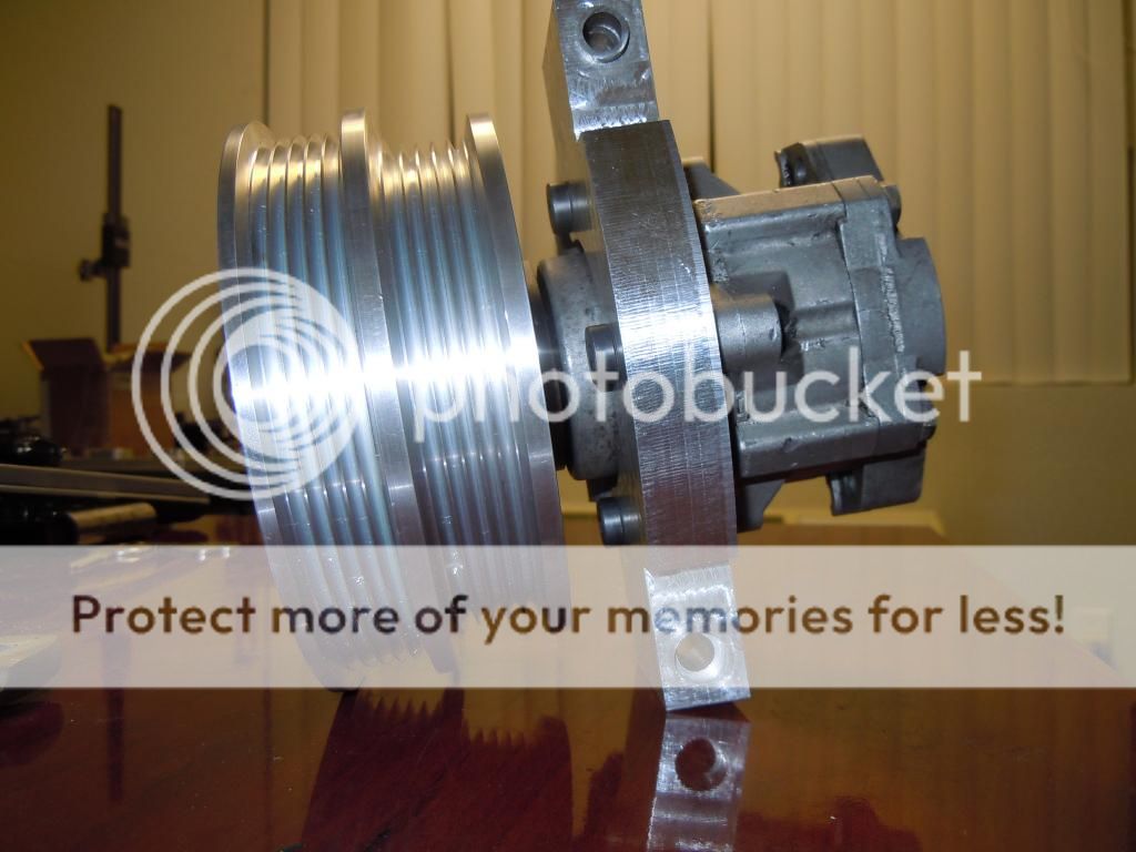

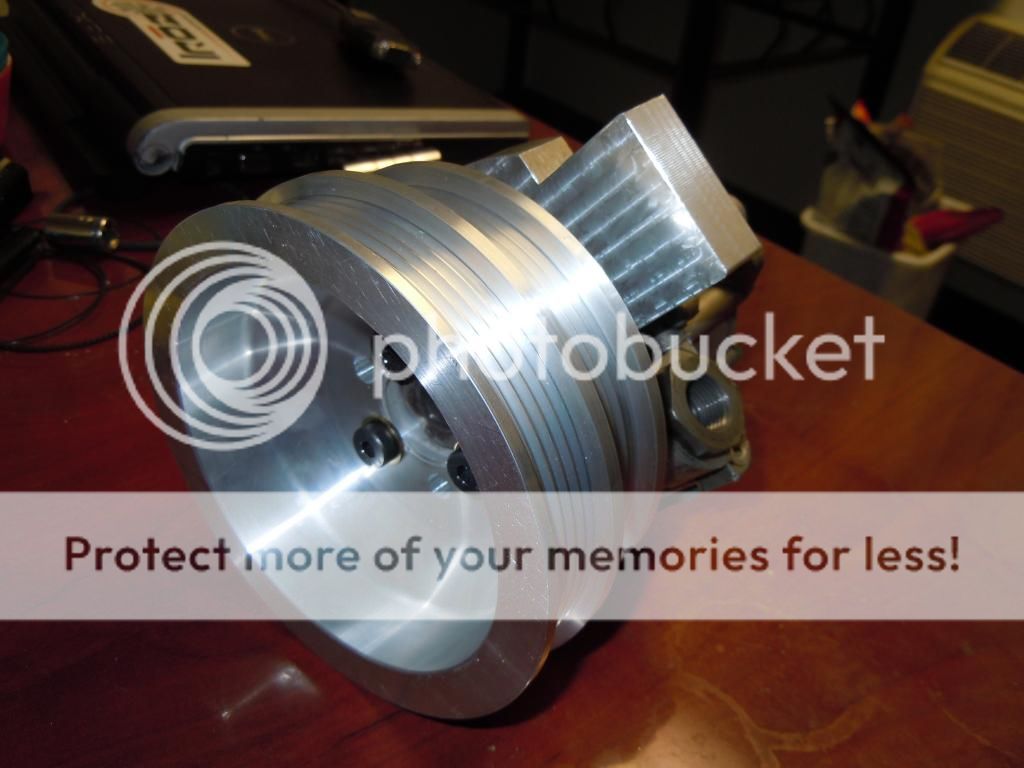

Few updates. After building the bottom end, we needed to make a PS pump work on the accessory drive in order to have power steering in the Quattro. We CNC'ed a pulley and made the offset correct to be a plug and play on the stock AC location with OEM belts and tensioners. Works really nice, and the raised rails on the pulley help keep belts on past 7500
[video]http://www.youtube.com/watch?v=9YOZcCIosYI[/video]
It is driving under it's own power with all gears forward and reverse. Need to button up a few loose ends and then it is calibration time on the ECU. Fun times ahead.
