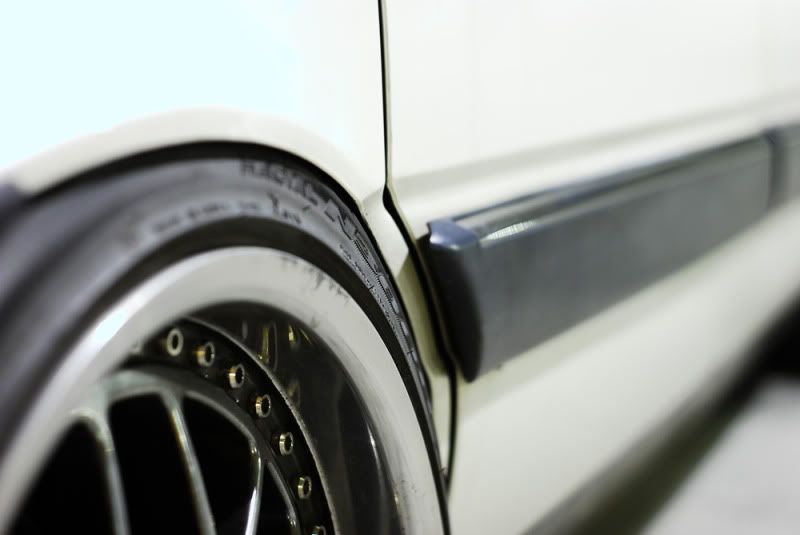

Yep square is definitely preferred in my taste. I think I may create a jig to measure the capability of the 200. Something simple to simulate various wheel width and offset.busmn280 wrote:I'm running a 18 x 8.5 wheel square setup without any rubbing in the front or rear. But 18 x 10 is a completely different story-at least in the front. Nick just posted some pictures of his 200 with BBS RS-GT's with 18 x 8.5 (F) and 18 x 9.5 (R). Wide wheels can fit on T-44's. It's all about the proper offset. I do prefer a square setup like most people.
I'll believe it when I see it! T44 suffers from the same issue as the C4, interference with the steering arm. Unless of course you are talking about some mexican wheel offsetloxxrider wrote:You are right Ed, there is no point if you are running the same tire. I could have put 275 on there with no problem with a different offset though.
The steering arms will be lowered about 3" on the strut tube, clearanced on the outside, and potentially clocked slightly inwards. I'd like to avoid re-clocking as I don't want to upset Ackerman geometry, but a slight adjustment may be necessary and wouldn't have much effect. Wheels will be 18x9 or 18x9.5, around et40.busmn280 wrote:Ed,
What are you doing to your strut housings to mod them to fit your future wheel and tire setup? What wheels and what offset will you use?
Ah, well yeah there is a lot of room in the rear...but staggered FTLloxxrider wrote:I was talking about in the rear Ed. Not sure what could fit in the front.
