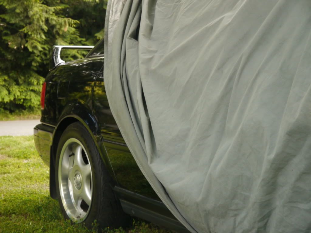

With nearly 8 inches of snow on the ground it's time to start thinking about the winter project....
I'm wanting to gain some fender for the rear wheels and tires to hopefully fit some 245 and possibly 255 size tires. To fit those in the front will require some fender liner mods, but for the most part they should fit without much issue. The rears will require new fenders. I've stared at and longed for the Vomit Comet's fenders, but I don't want to redo the fronts so I'm focusing on the rears only. My goal is maintain the lines of the fenders, yet increase the amount of fender as well. I believe the best way to do that is to use B4 rears. I have an idea of how I might achieve this, but here are some test fitment pics to get things going.
The tough part is going to be the transition by the doors. I like how these fenders stay with the body curves of the car, but I'll have to cut and manipulate them to weld up while maintaining the extra flare. I think it's doable.
I am thinking I will get the S4 side skirts though to and remove the upper door trim for a cleaner look. A full respray will be the last bit in the Spring.

b4 doors any differnet?
Re: Darin's 80tq...FENDERS...
The difference is the length from the door to the fender. Where the B3 distance is maybe 2", the B4 is 3" or more.

Here are a couple of really similar pictures of the B3 and B4 fenders. Big difference.
Trying to capture the whole car in this shot. I'm pretty excited about this.
This is the challenge. I'll get a better idea once I remove the trim, but you can see where it will have to be manipulated.
I don't think the rear bumper will have to be modified at all, it just won't match up as nicely as a stock S2 sedan bumper would, but like I said, my front doesn't match up either.
Check out my front bumper and front fender in this shot.

Focus on the fenders in the rear, and you can trim the bumper as needed. Get it close and let the tires clearance the rest around tight corners :) I cut the corners off a B4 bumper at the yard and was going to graft those on to my B3, you could do something similar. I don't think I still have them, but will let you know if I come up with them.
The doors are the same on the B3/B4, the difference is the size of the wheel well. The b4 wheel is located quite a but further back and the wheel well is larger too.
Which means that a B4/RS2 bumper will not fit.

Not necessarily, if he does B4 fenders, it should match up. A tucked in B4 stock bumper might be a good way to build from then source an s2 bumper that fits the sedans.

I'm thinking the distance from the wheel back.
