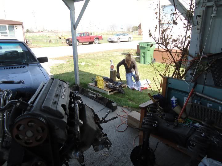

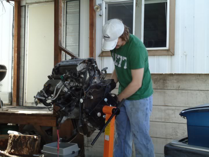

SOOO progress today. Got the engine on the stand and pulled the A/C, Alternator etc. Then I really started inspecting stuff...

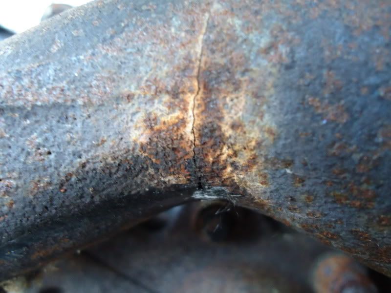

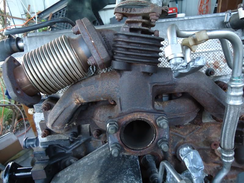

Found a cracked exhaust mani:
SOO good thing I was planning on the 034 set up... so Im not TOOOO upset.

So are you doing a full rebuild? Any history on the motor itself? Come from a running car or one that hasnt run in a while?
Looks good!
Looks good!
I bought it from a board member. Has 200+ thousand miles on it but when it was in the car it ran. Today I also pulled the tbelt cover off and it all looked good. But anyways It is getting a full rebuild . I am pretty set on Integrated Engineering Rods with JE piston combo off thier site also planning on 034 HD Springs and Titanium Valve spring retainers with a bunch of other goodies.

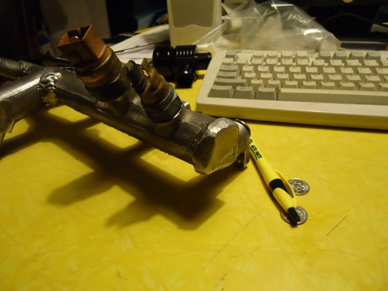

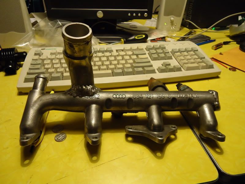

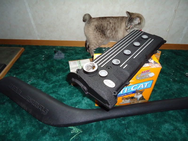

Got my water mani all welded up today. Please go easy on the weld critisism. First time I have ever welded aluminium with a spool gun. Let me just say pre-heating it would have been a great idea. I have only Tig welded aluminium before today. ( it is water tight so that's what counts right?) :bashtard:

Don't worry about the appearance of the welds. I have never seen attractive-looking aluminum MIG welds.
Pre-heat would help, but I would preheat only the area where the welding starts. Heat will spread fast enough. Chamfering helps a lot, too. When I weld aluminum of any thickness above sheet metal, I chamfer the ends, almost to an edge. Also, the piece looks to be clean, but thorough removal of the casting skin is essential.
You probably know most or all of that if you have welded aluminum before.

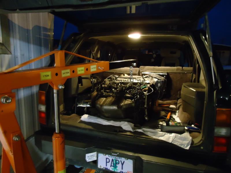

Well just got done loading up the AAN to head up to the machine shop tomarrow. :-D I am having them assemble it because I live on a dirt road and only have a carport SOOO I don't think all the dust and dirt would very nice things to my engine hahaha. SO I shall have it back in a month or so.
The plan is the 034 Valve springs, ARP goodness, Autotech cam gear from 034, IE Rods and JE pistons. :-D So while the engine is gone getting work done I have a crap ton to do to get the car ready. This plus all my classes and work... :bashtard: I am going to be one busy guy for the next month.
