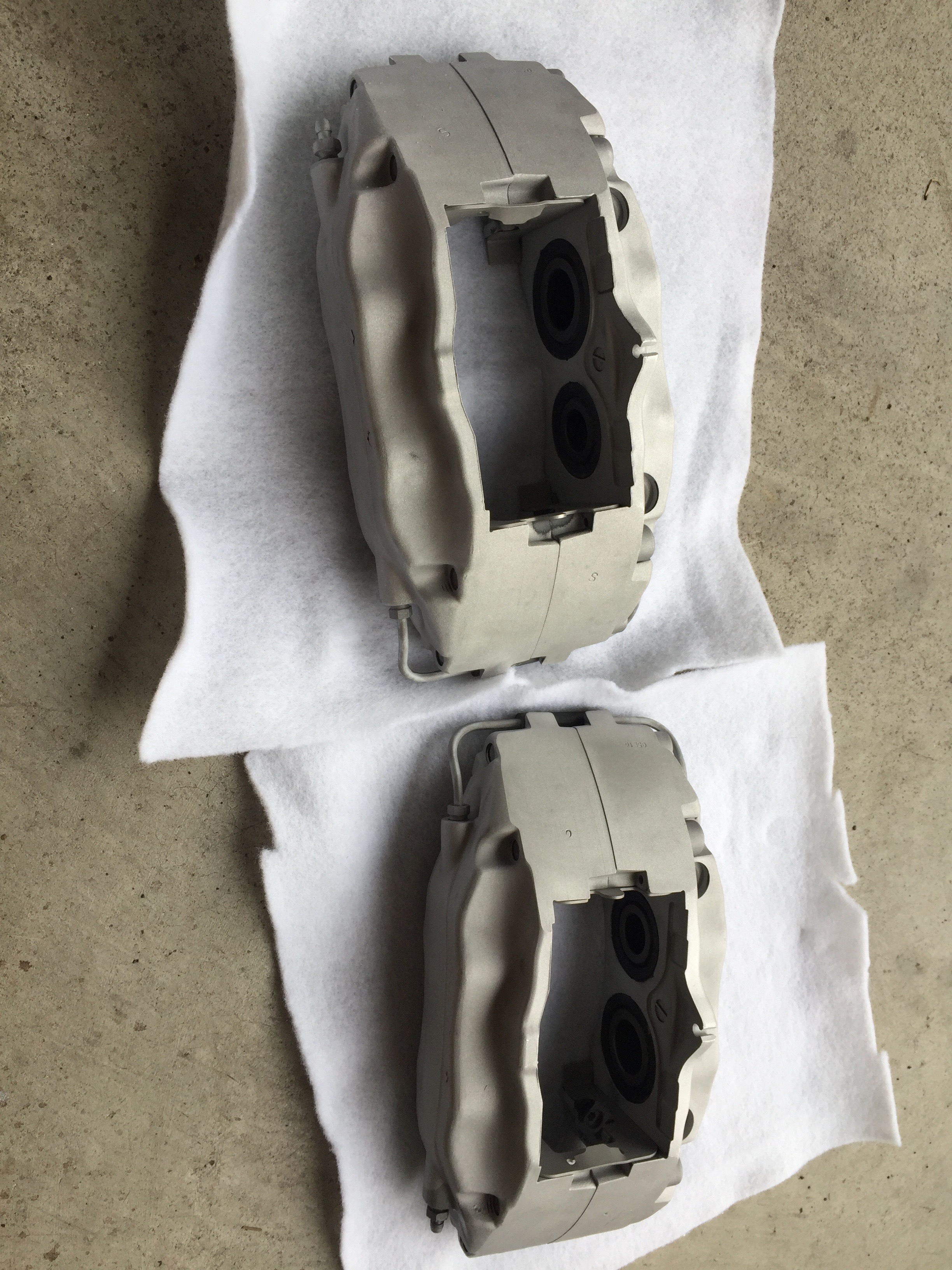

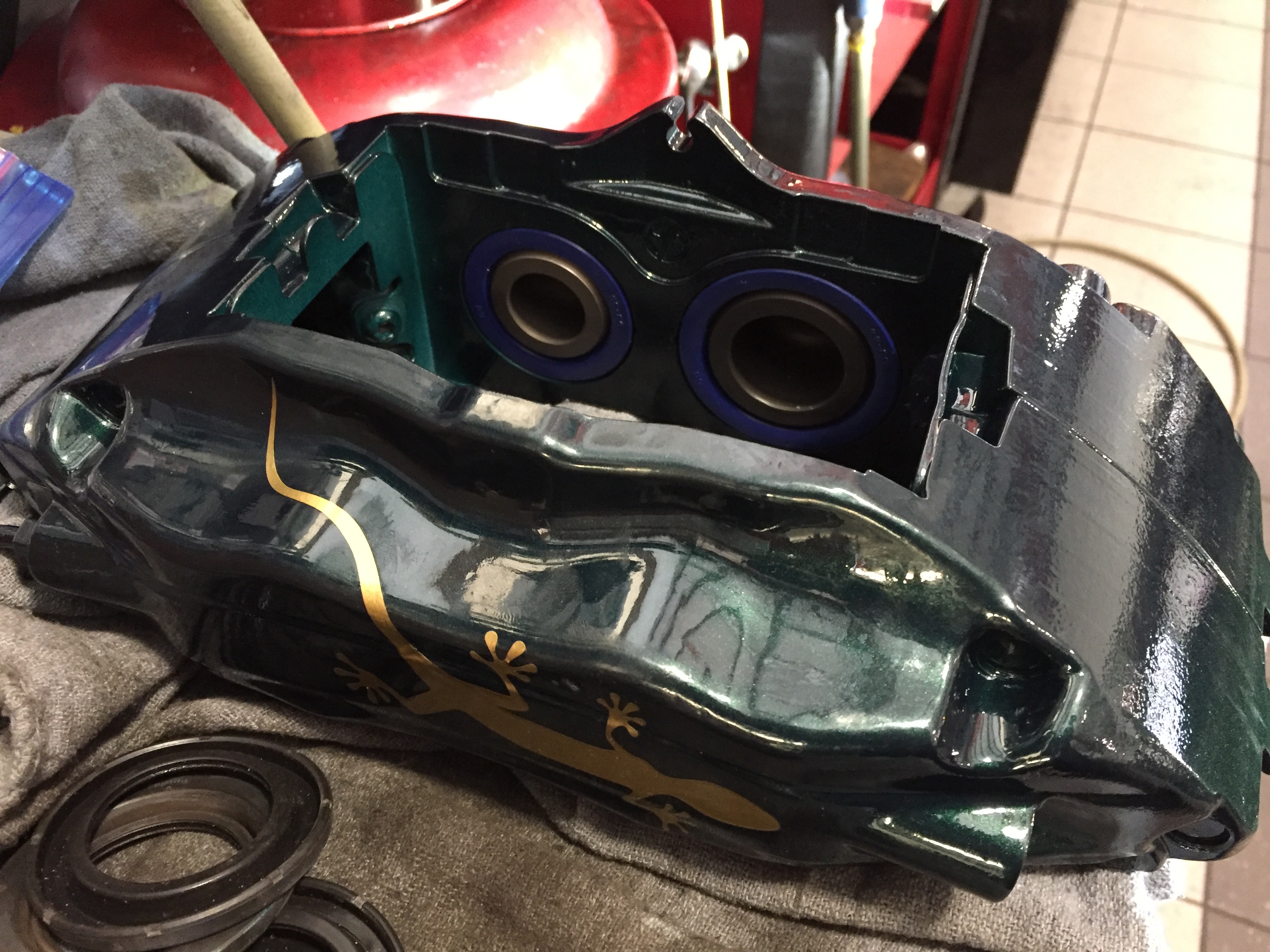

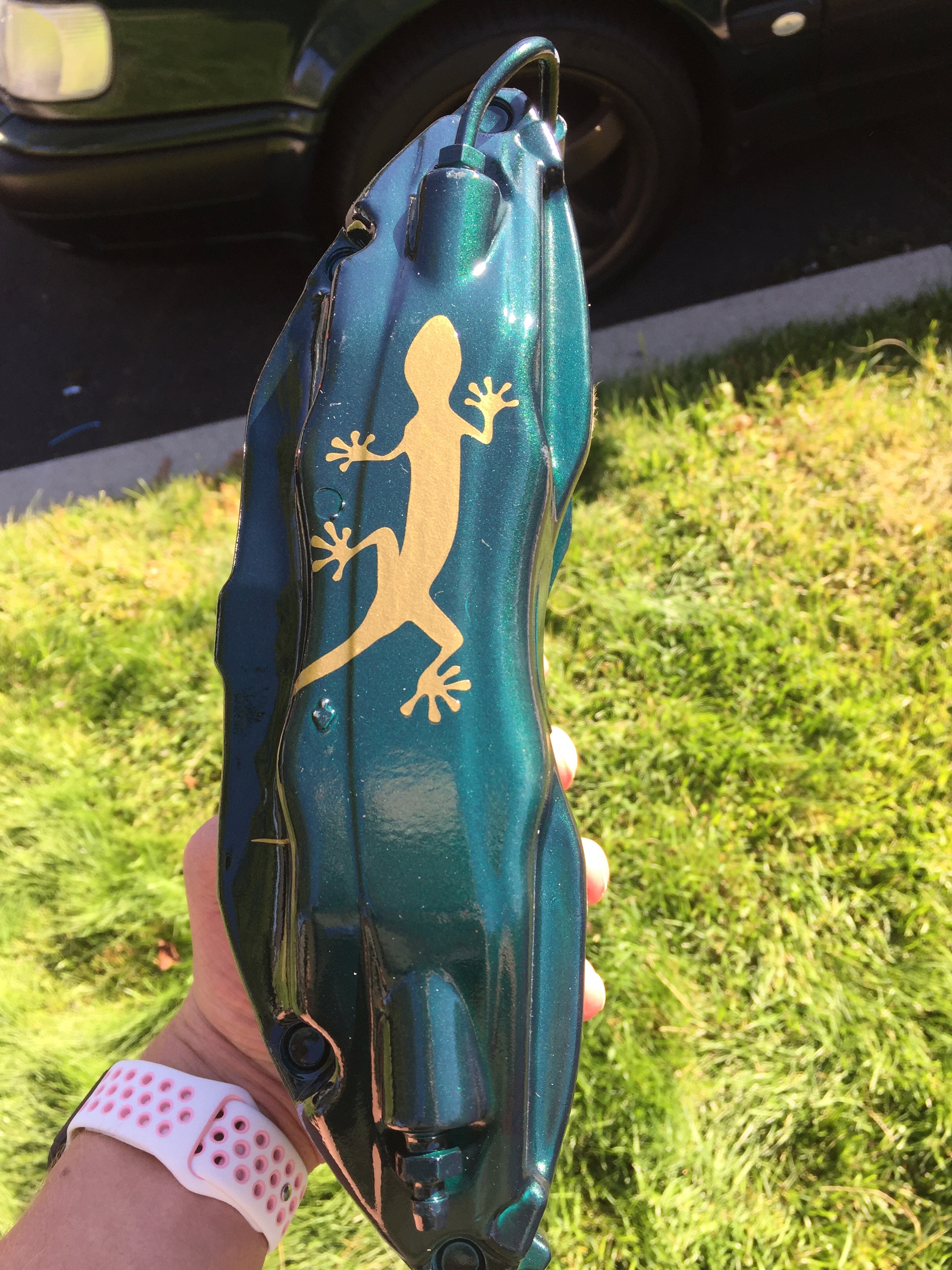

Finally, after way to long, the brakes are back on the car! My pads were getting pretty low and since the clear coat was peeling off of the Porsche logo I decided I might as well repaint them. I had a couple ideas of what I wanted to do and my buddy said I should do something unique.
I was able to do some measurements to find what Porsche these calipers came off of. They are the "Big Blacks" from a 993 911 Turbo. Rotors are a two piece 330x32mm with custom hats, that I need to get another set made just in case. Pads are OEM 911 Turbo pads. Painted with caliper clear, a base coat of my choice, and a 2k clear for a better protection and also had them covered with a ceramic coating. I am pretty happy with them. There a few spots that the paint rubbed off, but it is what it is. Worse comes to worse Ill just redo them or have them professionally done.
My buddy came up with the idea of doing a gecko logo and thats what I decided to go with.
- Final product
- IMG_8167.jpg (2.05 MiB) Viewed 61627 times
- New seals and boots
- IMG_8280.jpg (1.53 MiB) Viewed 61627 times
- Media blasted clean
- IMG_8088.jpg (1.85 MiB) Viewed 61627 times

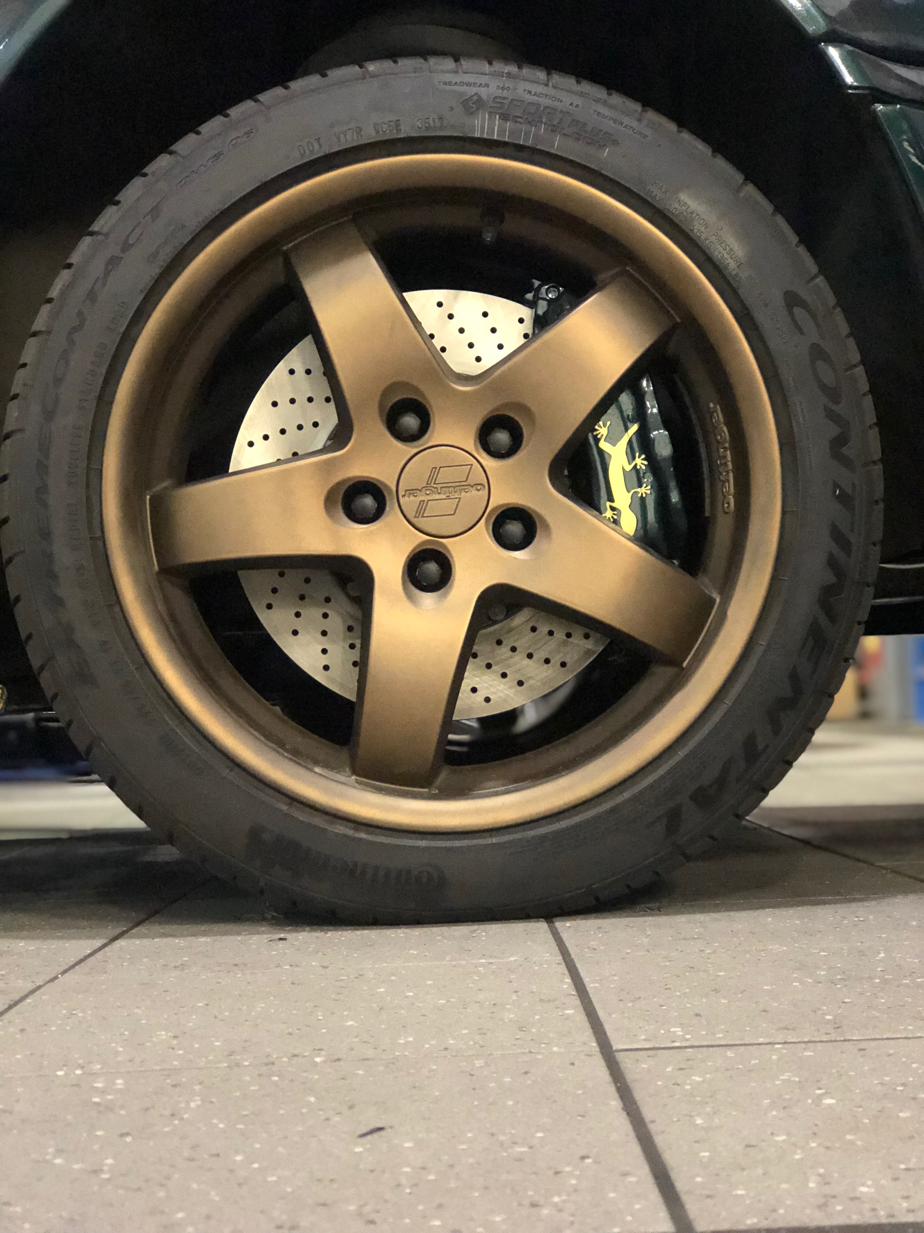

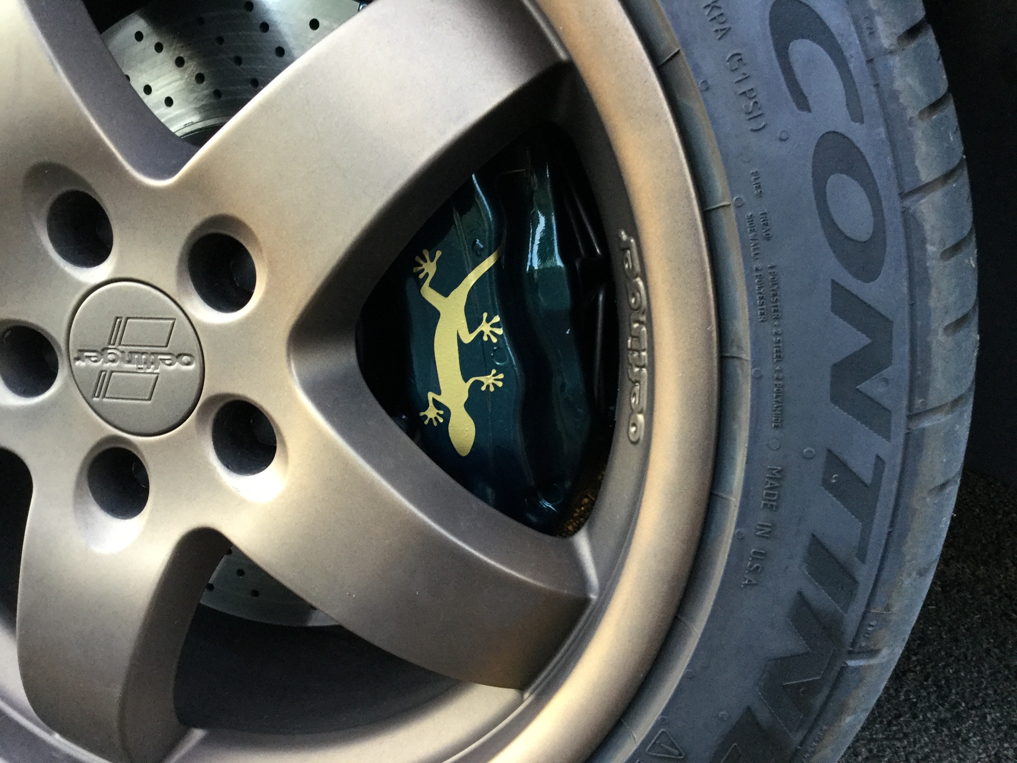

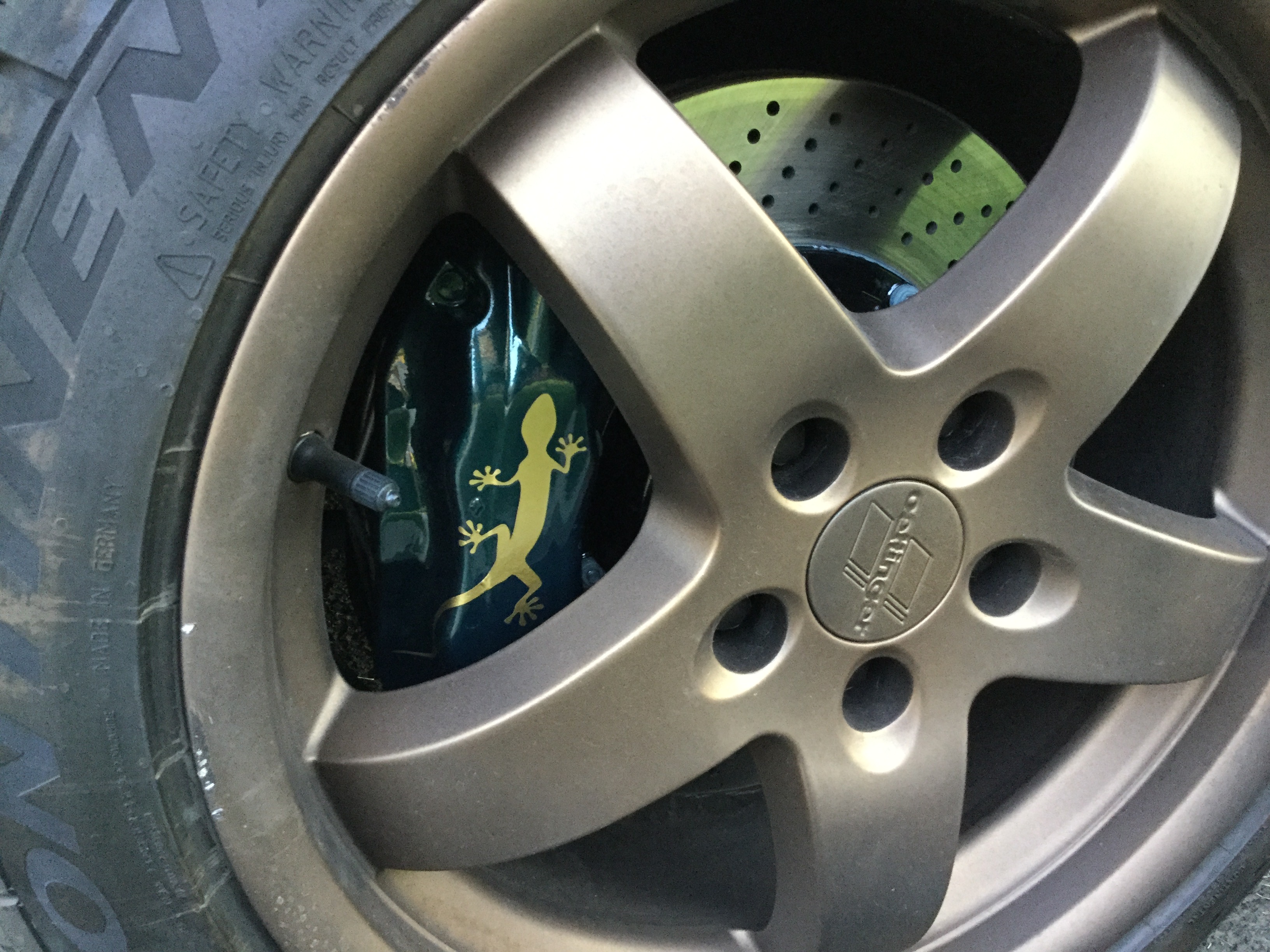

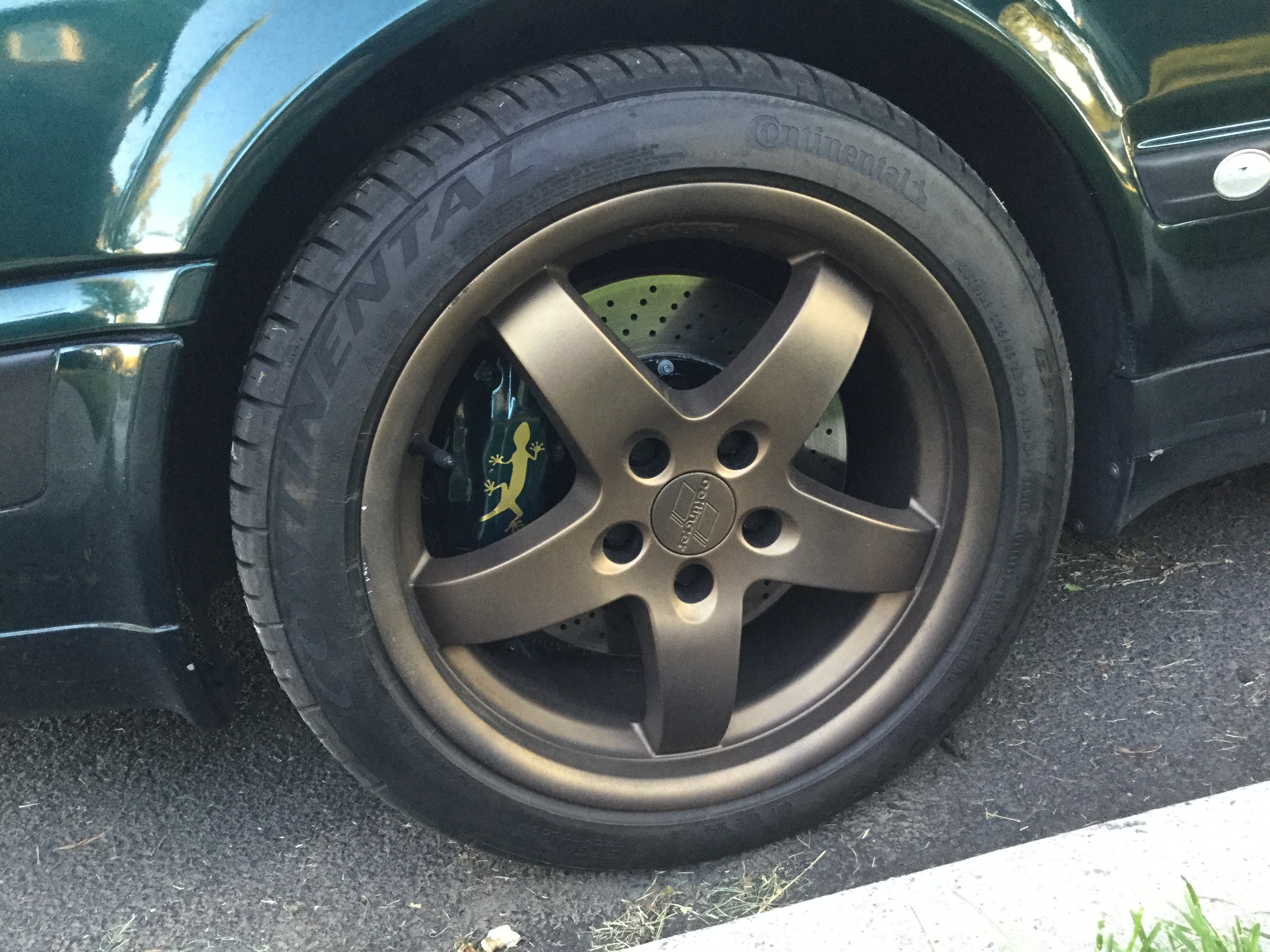

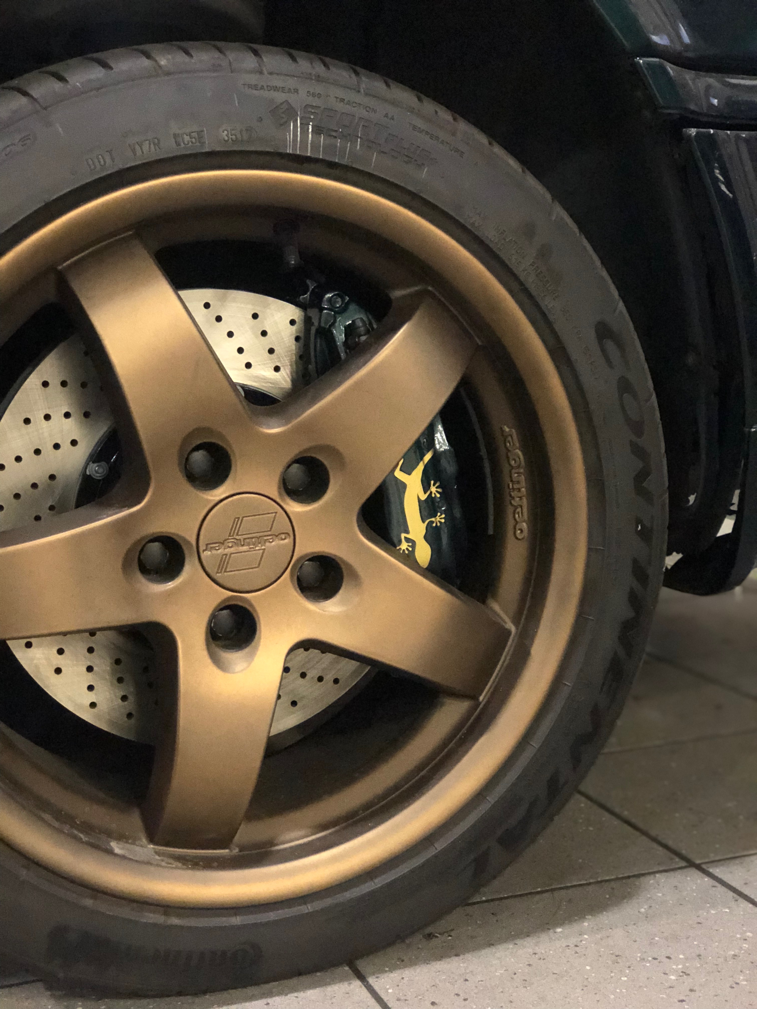

Re: TCombs UrS4, Brakes done!!
Few more pictures, on the car.
- IMG_0035 2.jpg (1.95 MiB) Viewed 61626 times
- IMG_0032 2.jpg (1.66 MiB) Viewed 61626 times
- IMG_0033 2.jpg (2.18 MiB) Viewed 61626 times
- IMG_8288 2.jpg (2.05 MiB) Viewed 61626 times
- IMG_8287 2.jpg (2.11 MiB) Viewed 61626 times
Obviously I still don't now how to upload pictures bc they are never in order. I guess I have to upload my last one first.
Very nice! Different is always fun
Ha I would agree with you there. I color matched them as best I could to the car paint. I really like them. Big fan of the Gecko so I thougt why not, it is Quattro after all!ringbearer wrote:Very nice! Different is always fun

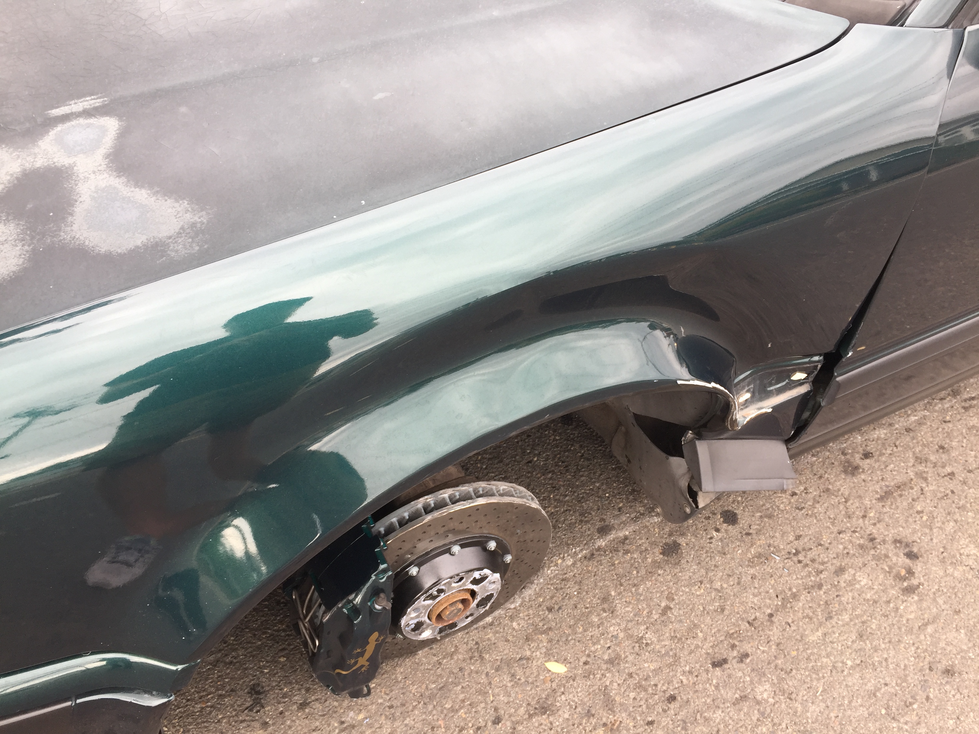

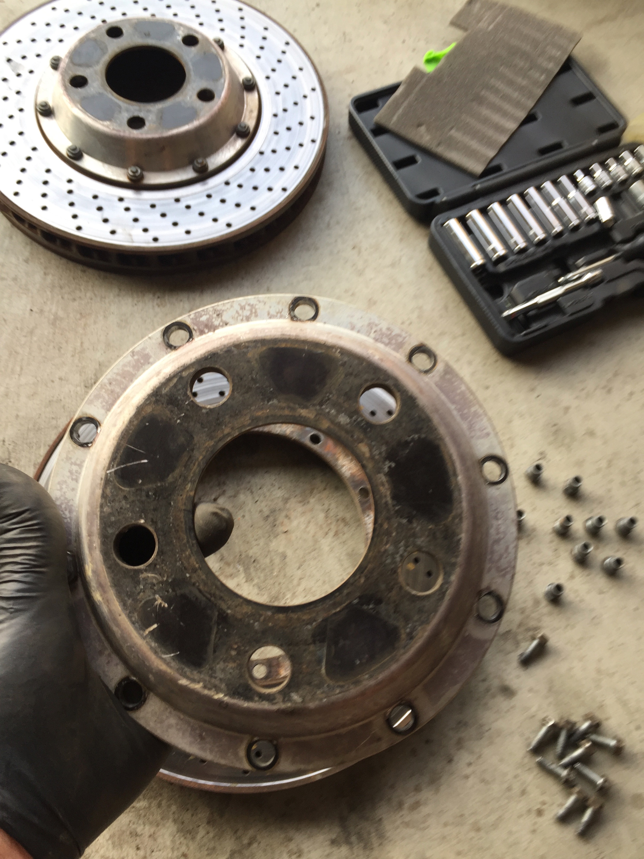

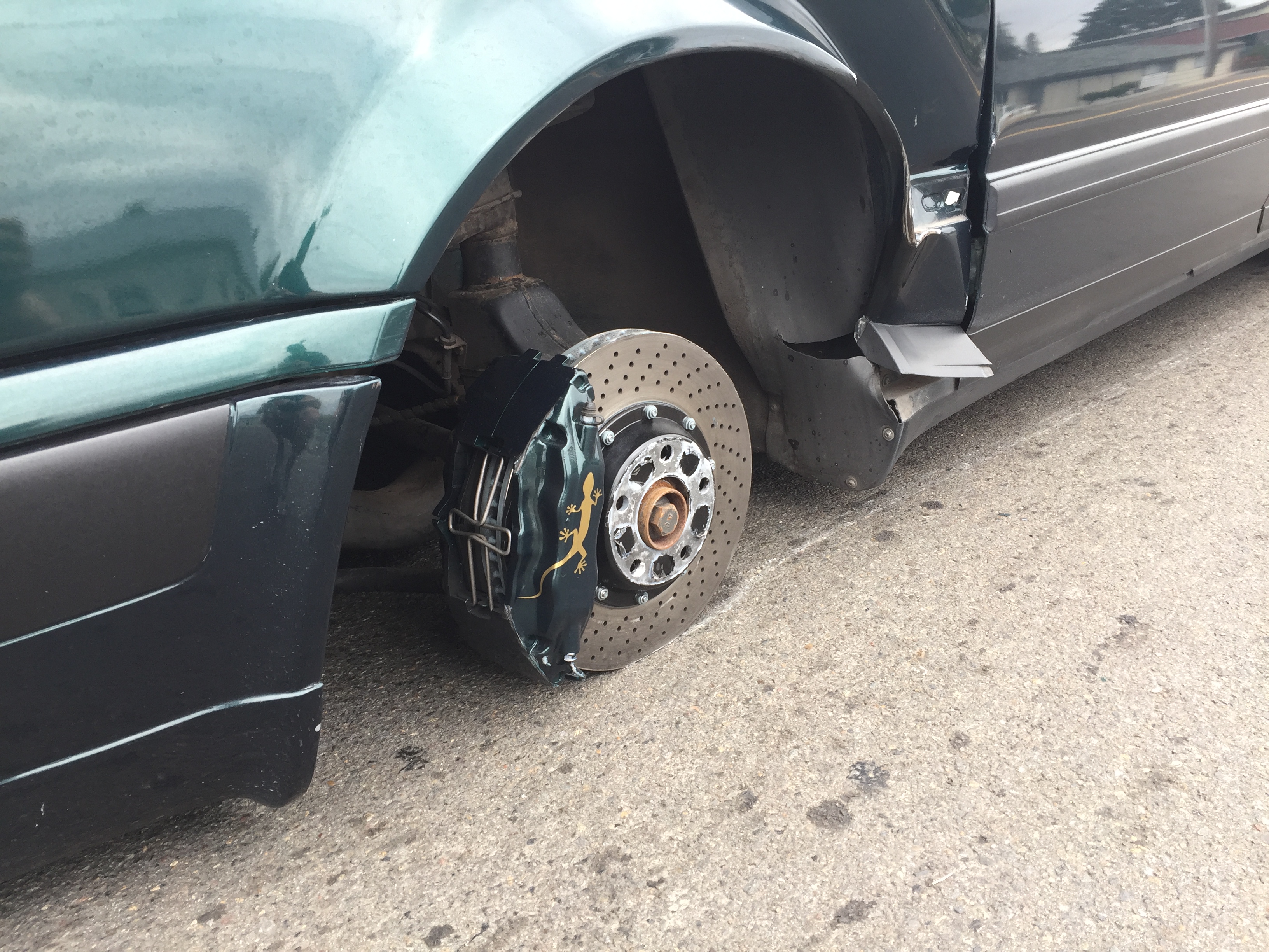

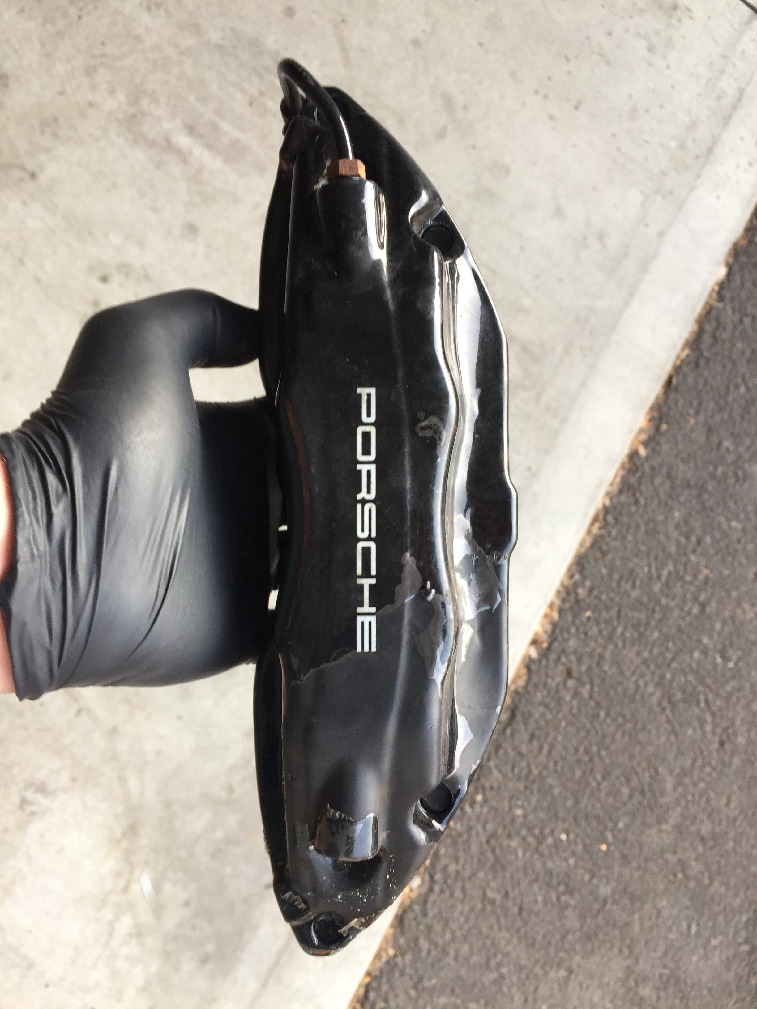

Spoke too soon!!!!
- CF652C4D-7C46-4DFB-B55B-AAC144F5D996.jpeg (2.12 MiB) Viewed 61593 times
- 4F03D51B-9702-4278-B3A0-BF8E798AE56C.jpeg (2.55 MiB) Viewed 61593 times
Noooooo, what happened?
Fuck.....
Condolences man. Have had that happen before but on a much shittier car. sorry to see.
Not exactly sure. I torqued everything, drove quite a bit and made sure everything was good to go. Drove to and from work and drove around some more and everything was good. Drove 130 miles over a pass to a different city, everything was good. Drove less than a mile today and just fell off. I was only going around 25 luckily. Thought I heard a noise, so I started slowing down, car shook for about a second and next thing I knew the car slammed to the ground and the tire was rolling away. No one was hurt, but that car doesn't look that good. One of the lug bolts still had threads from the hub on it. You can see that the brake rotor had paint stripped off, so maybe I didn't have a good contact surface between the wheel and the rotor hat.Lucky wrote:Noooooo, what happened?
Some bro did stop by and completely talk down to make and act like I didn't know what I was doing. Questioned me about the hub when I said the wheel bearings are pressed in, because he "knew" they just bolt. Told me he works on Mercedes, and cars for the last 10 years and I need to torque the wheels correctly. I told him I torqued the wheels, and he said I need to torque them to at least 140lb ft or more. That's how he does every wheel, then said he goes until the bolt stops. Then told me I need to get wheel studs because if I had studs it wouldn't have happened. Continuing to say that what I did is like a Subaru and they are small and don't work well, even though a Subaru uses studs, not bolts and said he is rebuilding a WRX and knows what he is doing. Haha, but I got the wheel back on and it is currently being towed to work and I'll get it on the rack on Monday and address everything.
But can I just say, those calipers look good!

Re: TCombs UrS4, Brakes done, and wheel fell off..
So far from the looks of it, I'll need a new hub, brake rotor, fender and any other body damage, new wheel lugs, centering rings. Check condition of the caliper and make sure the rotor didn't damage anything, check the rest of the suspension on that side. Re-torque everything I have touched.
