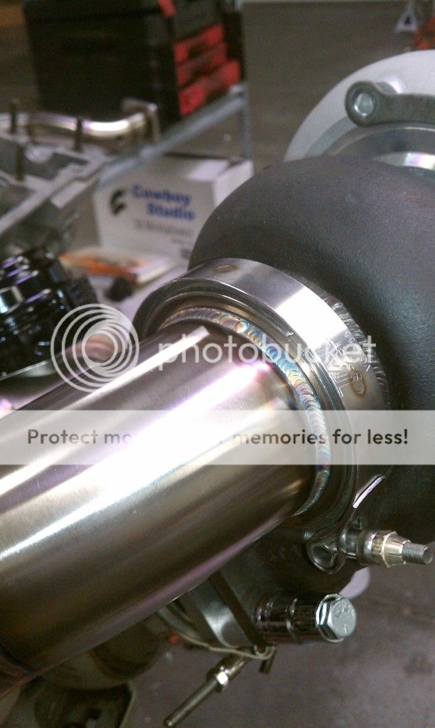

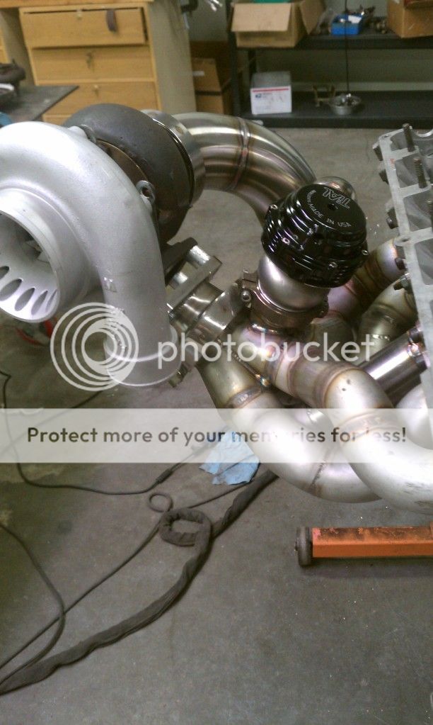

So while waiting for things we do a lot of talking. I think we narrowed down what caused the det that destroyed the motor. It was before we got the 044 pump in there and the car was running lean. A few full throttle runs probably toasted the block early on and then (thanks to the coatings) lasted through while we tuned it but the damage was already done. I am sceptical about it being the QSV closed but that could have played a small part. One thing that Ed said stuck out to me when he was talking about tuning his car with Marc at Carlisle and running out of fuel - "if I was on pump gas, that motor would have now been in pieces" - or something along those lines. We definitely had more than one scary lean situation happen and my feeling is that's what did the motor in. Sad... :(
Anyway pistons are ordered from Wiseco and I think Hank's almost done with the fun v-band->t3 adapter so we'll get rolling on this thing soon! Just gotta finish a TDI first

Re: Pops' 1997 S6 2.5L Stroker - moving forward
That is a beautiful bead...
Dude can weld.
Stacks of tiny dimes...
Looking great, the vband adapter kicks ass
