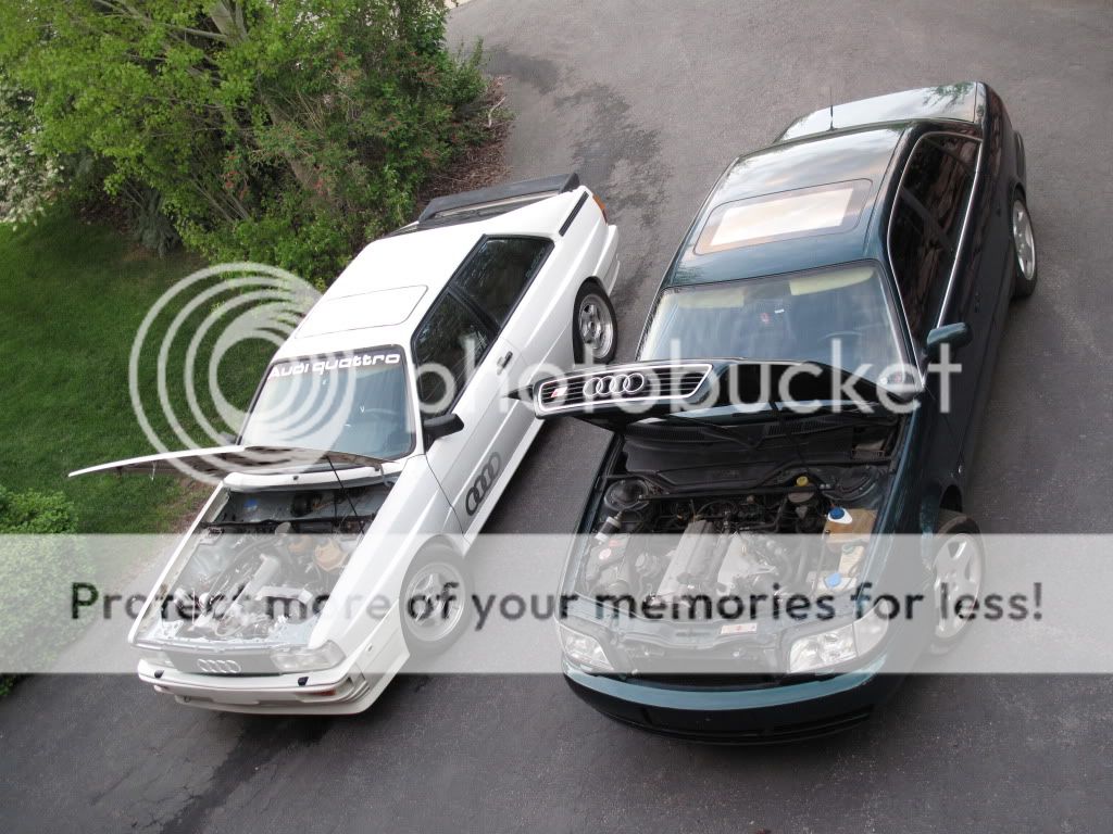

my two whips together for a v10 40vt twin turbo shot
