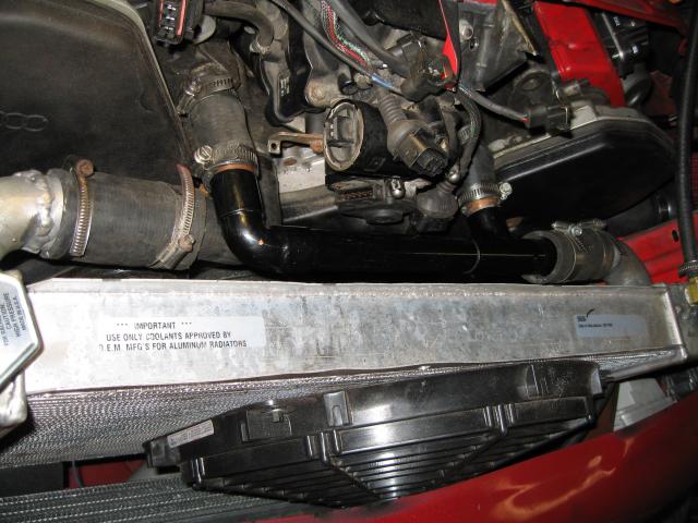

Heater core lines are all set, as Nate suggested I was able to use most of the factory hoses and get everything to hook up:

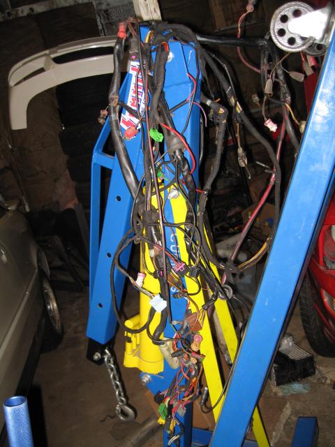

I decided to remove quite a bit of the factory wiring when I realized I was going to have to re-do the alternator wiring anyway, plus run relays for my RS2 lights. It will just be cleaner to run new wiring. I also removed the now unneded ABS wiring:
So now _most_ of the coolant system is connected up, next step tomorrow will be to pressure test the whole system and make sure everything is leak free :woowoo:

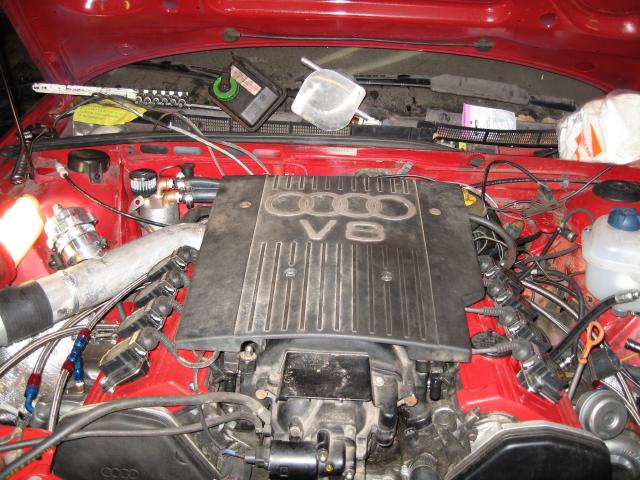

And I saw the v8 engine cover over in the corner of the shop and thought to myself, self, it would be nice to have that bad boy proudly displayed on the top of my motor. A few passes with the grinder later, et voila
I think I should stick an audi turbo badge on there somewhere too 8-)

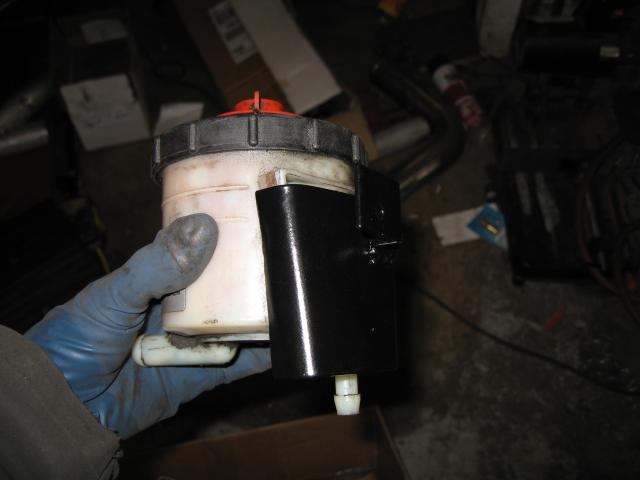

made a new bracket for the power steering resevoir, 4kq spec (along with the rack)

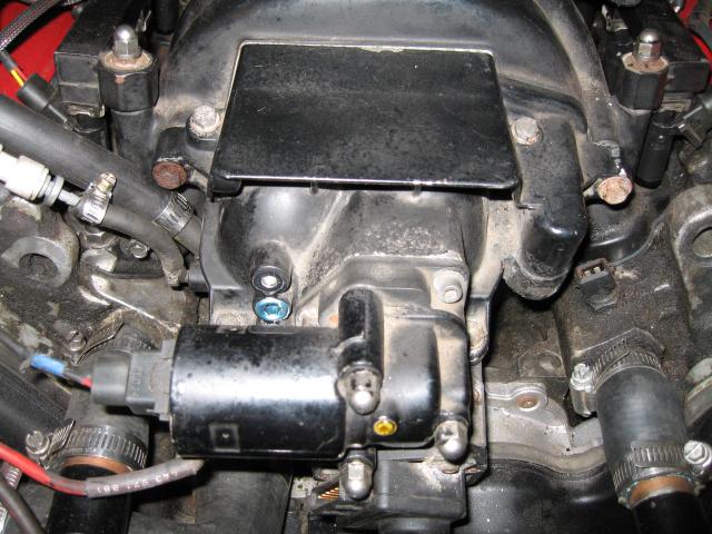

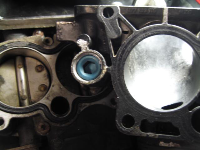

plugged a few ports on the throttle body flange, this one was used by the crank case breather system which I'm not using (catch can setup), the other for the factory IAT.. unfortunately there isn't enough room for the 1.8t sensor in that location due to the ISV:

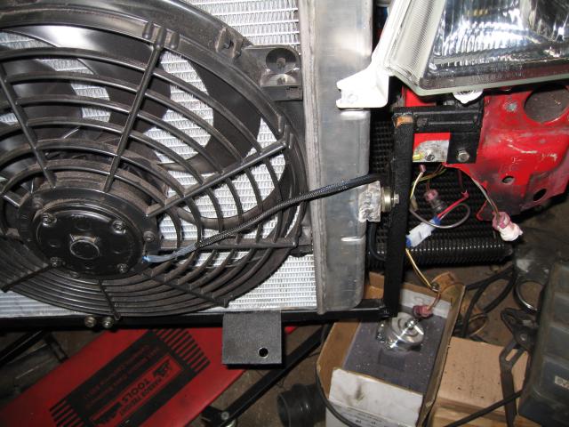

ran wiring for the radiator.. while testing for polarity vs. flow direction I hooked it up to my jump pack and I can say without a doubt this bad boy has some kick!

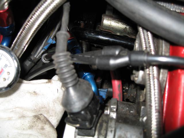

ran vacuum lines for brake booster, ecu, etc
I really like that new vacuum tubing stuff, much nicer than using rubber hose with hose tees all over the place

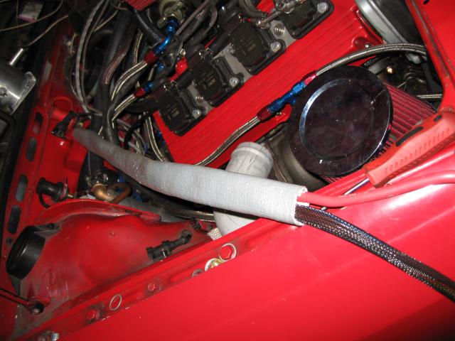

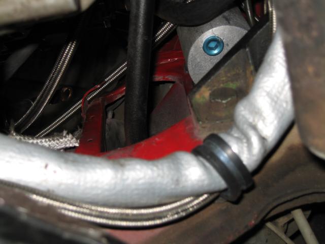

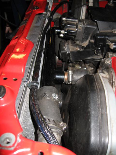

routed new wiring for the alternator (mounted on the opposite side of the motor from the 7A). Taylor firesleeve since it has to go near the passenger side downpipe, nice stuff :thumbsup:
rubber clamps to keep things out of the way of the downpipe (the stainless braided line is the drain for the catch can):

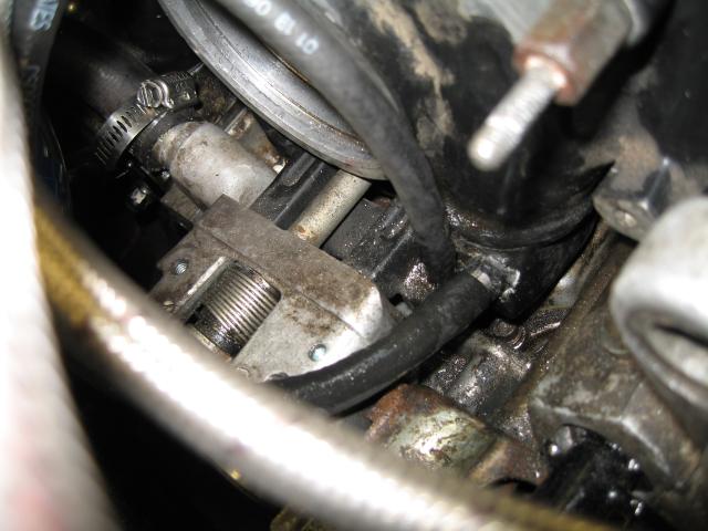

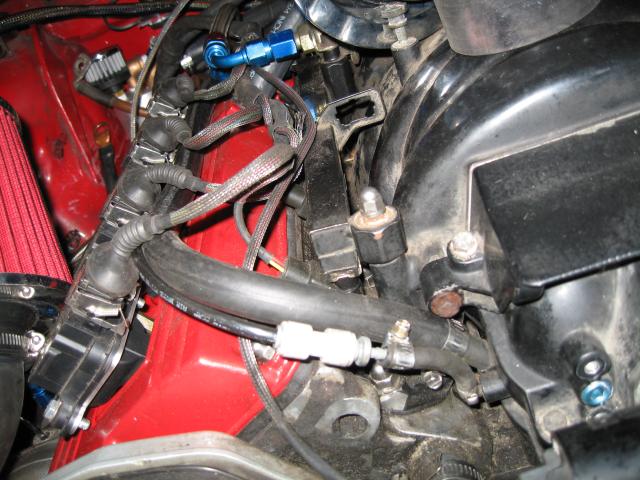

Question for those 'in the know' on the v8s, where does this rubber line normally connect to? (the one toward the right headed toward the bottom of the photo):
just trying to determine if its part of the crankcase ventilation system or if it is a post-throttle-body port..

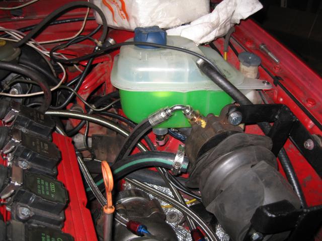

And lastly, it almost feels like a bit of a milestone, time for coolant 8-)

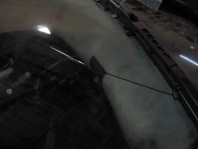

and one 'unplanned' thing from this weekend.. came to the shop in the morning to find a fiddle sticking cracked winshield :curses:
thankfully, on a whim, Peter contacted me about a month ago with the chance to buy one of the last available OE CQ windshields for a killer price and I jumped on it. Guess I'm glad I did! Thanks Pete!

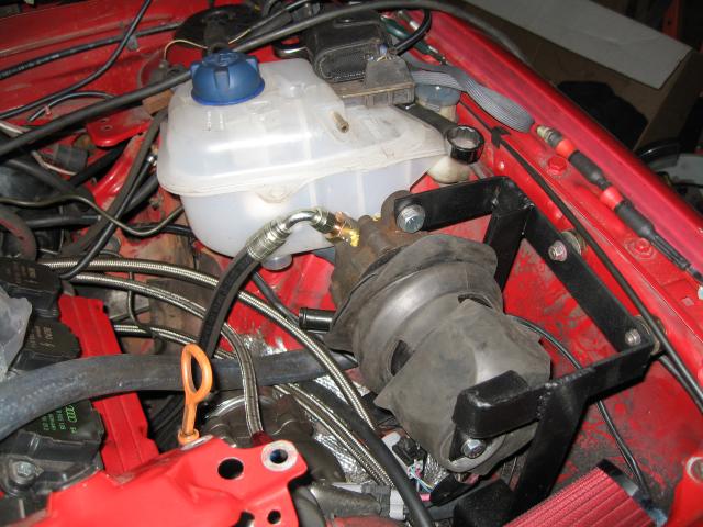

Marc, are you planning on making some kind of hotside heat shield for the turbos like Jim did? Looking at that shot with the expansion tank, there are alot of lines running over the hotside/downpipe, looks like a potential problem.
Anyways, great progress like usual!

gidrew wrote:Marc, are you planning on making some kind of hotside heat shield for the turbos like Jim did? Looking at that shot with the expansion tank, there are alot of lines running over the hotside/downpipe, looks like a potential problem.
theres room, I haven't tied them up or anything yet. I'll use some more rubber clamps to swing things up and out of the way. If things are still too close heat shielding will be used.

"Firesleeve" good stuff for sure, I have some in dull orange color that looks like KaKa as soon as it gets the least bit oily or sooty... saw some in a pic in black color AudiFreakJim? that ought to maintain a better appearance and look better with those hot red camcovers!

Marc - "new vacuum tubing stuff, much nicer than using rubber hose" where do you get the stuff?
Everybody's favorite plumbing supply mail order house, mcmaster-carr.
they are called instant tube fittings. This link should get you to the pages of interest, 151,152,153'
yeah, thats the reason I didn't go with the orange. Gray seems to do better with oil, but black would be even better. Problem is heat absorption.. black.. well.. absorbs heat, kinda defeats the purpose!

a4kquattro wrote:Question for those 'in the know' on the v8s, where does this rubber line normally connect to? (the one toward the right headed toward the bottom of the photo):
The one all the way on the right is a vacume hose that gets attatched to a valve on the firwall.
The one near the Manifold hole is a breather line & attatches to eather side of the opening.

Posts: 1589
Ronald G Wainwright+ wrote:[/quote]
The one near the Manifold hole is a breather line & attatches to eather side of the opening.[/quote]
ahh, I'm going to bet that would be for the charcoal canister, then. thanks ron!
