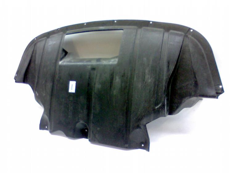

Thank you for all of that, Greg, greatly appreciated. I do not have a belly pan, I couldn't get one to fit with the S2 bumper on my old CQ, at least not well. I did find on my old C5-A6q that the belly pan really helped oil temps. Maybe when I get all the rest of the stuff taken care of I'll fab up an aluminum pan at work (there is an iron worker and a 4ft wide hand break, plus several TIG and wire welders set up for aluminum).

Eric, I think I have a spare belly pan here. Although it likely won't fit around the oil cooler

Hey Ben, thanks, but I'm not sure how Greg got his belly pan to fit, unless that bumper is some sort of hybrid. It looks like S2/euro-B4V6 lighting and the chin, but the grilles look taller and no license plate area like on a genuine Euro bumper like the one I have. The trailing edge where the belly pan would sit is vastly different than both of the US B3 and B4 belly pans I've tried so I either need to source an S2 or make something. I can cut/plas/bend/break/drill/punch/weld at work...

Here is a picture of an RS2 encapsulation panel. Notice the vent to help extract air out from behind the intercooler. Might work to move more air thru a front mount radiator. Looks to me that this would be doable on a B4 encapsulation panel with a little work.
HTH, Chris
HTH, Chris
- RS2 lower encapsulation panel
- RS2 lower encapsulation panel.jpg (29.14 KiB) Viewed 77778 times

He modified his bumper to be more square.cuatrokoop wrote:Hey Ben, thanks, but I'm not sure how Greg got his belly pan to fit, unless that bumper is some sort of hybrid. It looks like S2/euro-B4V6 lighting and the chin, but the grilles look taller and no license plate area like on a genuine Euro bumper like the one I have. The trailing edge where the belly pan would sit is vastly different than both of the US B3 and B4 belly pans I've tried so I either need to source an S2 or make something. I can cut/plas/bend/break/drill/punch/weld at work...

I do have a modified front bumper, but had the B4 belly pan on the car fit with the stock Euro V6 bumper. Early on, in 1996, when I bought the car, it did not have a belly pan. Audi service personnel like to remove them and not put them back on. The car had been serviced by a dealership, til I bought it. I ordered another one and the original belly pan was superceded to the B4 one. It fit with the stock bumper til I changed it out to the Euro V6 bumper in 2001 and it still fit. I had to trim the front a little when I modified my front bumper, in 2004. But other than that it always fit.cuatrokoop wrote:Hey Ben, thanks, but I'm not sure how Greg got his belly pan to fit, unless that bumper is some sort of hybrid. It looks like S2/euro-B4V6 lighting and the chin, but the grilles look taller and no license plate area like on a genuine Euro bumper like the one I have. The trailing edge where the belly pan would sit is vastly different than both of the US B3 and B4 belly pans I've tried so I either need to source an S2 or make something. I can cut/plas/bend/break/drill/punch/weld at work...
I will crawl under the car and take a picture. Give me a couple of days.
