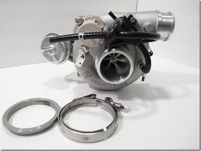

Re: 86 Alpine white 4000's
Same turbo I have:
EFR 7163, 0.85 A/R, v-band in/out, EWG
Hank ran into the same issue with the v-bands on my set up, using his old personal exhaust manifold running standard TiAl vbands.
Digging through my emails, here's what Mike Hood figured out:
Mike Hood @ Ringer Racing wrote:You can use the Tail flange for the input at the manifold, the discharge on the 7163 is the BW EFR style V-band like the rest of the EFR’s.
So you will need a discharge EFR v-band clamp and maybe a flange if you are going to be making your own down pipe.
Mike
And in a further email:
Mike Hood @ Ringer Racing wrote:If that manifold was made for a Tial V-band housing then the V-band you have for that will work for the EFR. Since the EFR exhaust outlet uses a different type of clamp/flange you will need those, they are $22 and $24 each.
You can see the EFR clamp/flange in this picture, the clamp is completely different then the normal V-bands used for other brand turbos.
HTH
