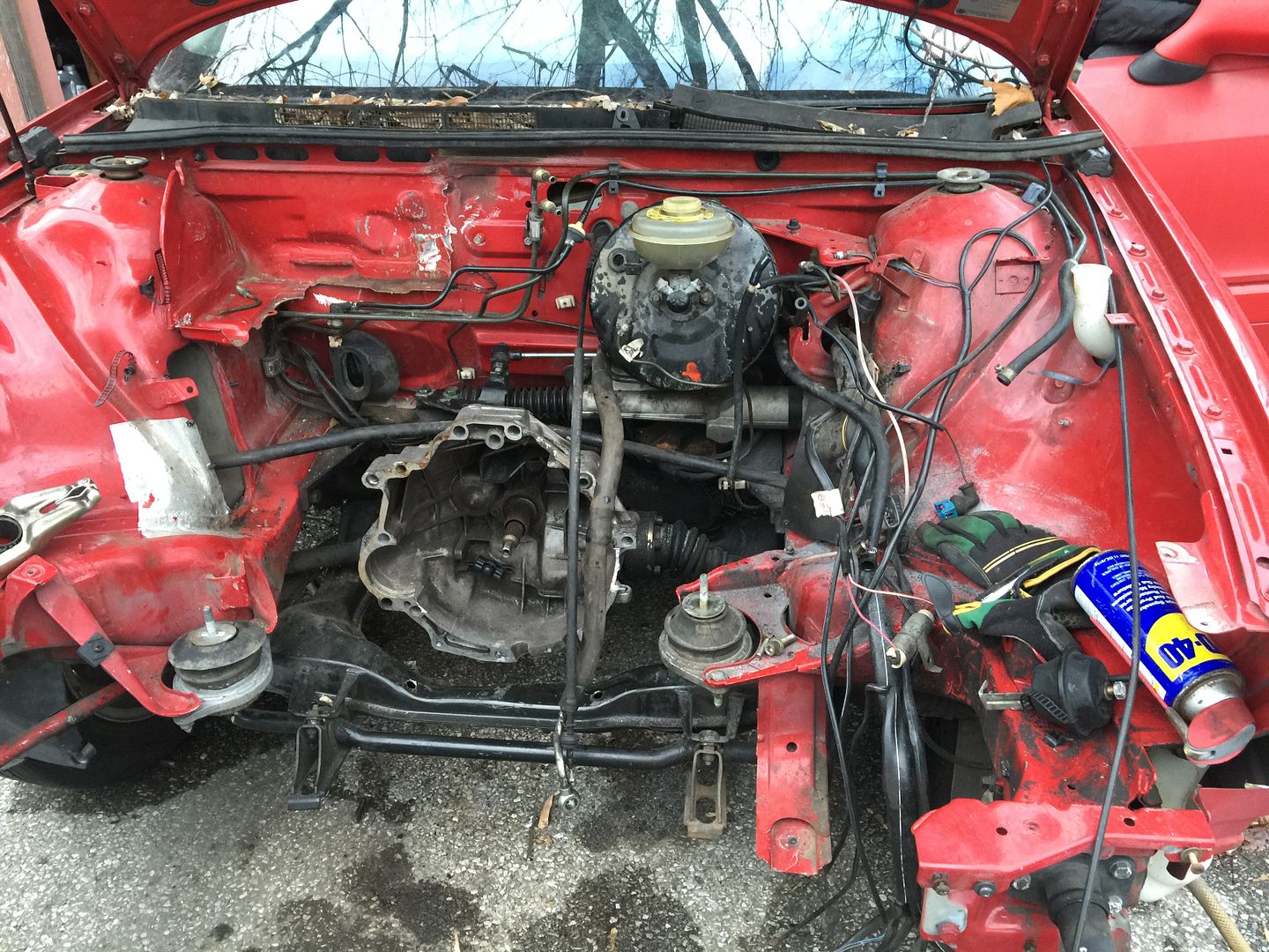

While I wait for the motor mounts to get tabbed, I am working to fit some other stuff.

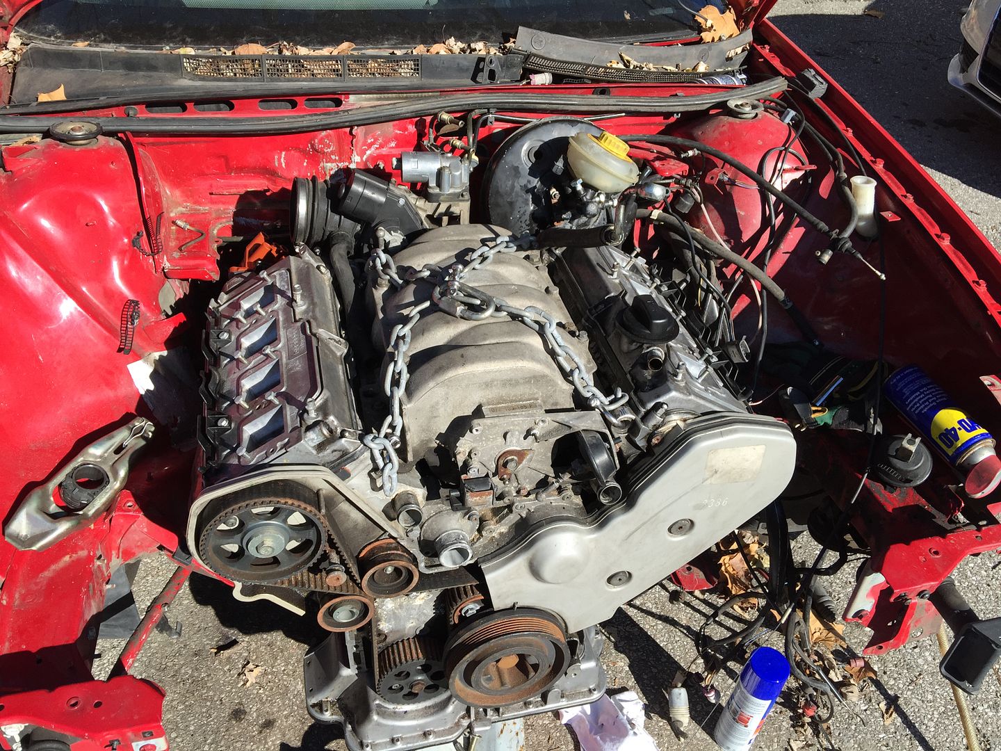

Firstly the coolant caps on the ABH heads needed to be trimmed even more than the pic above. I had to bevel the bottom edge too.
Then the ABZ Intake Manifold fits on too and clears the hood.

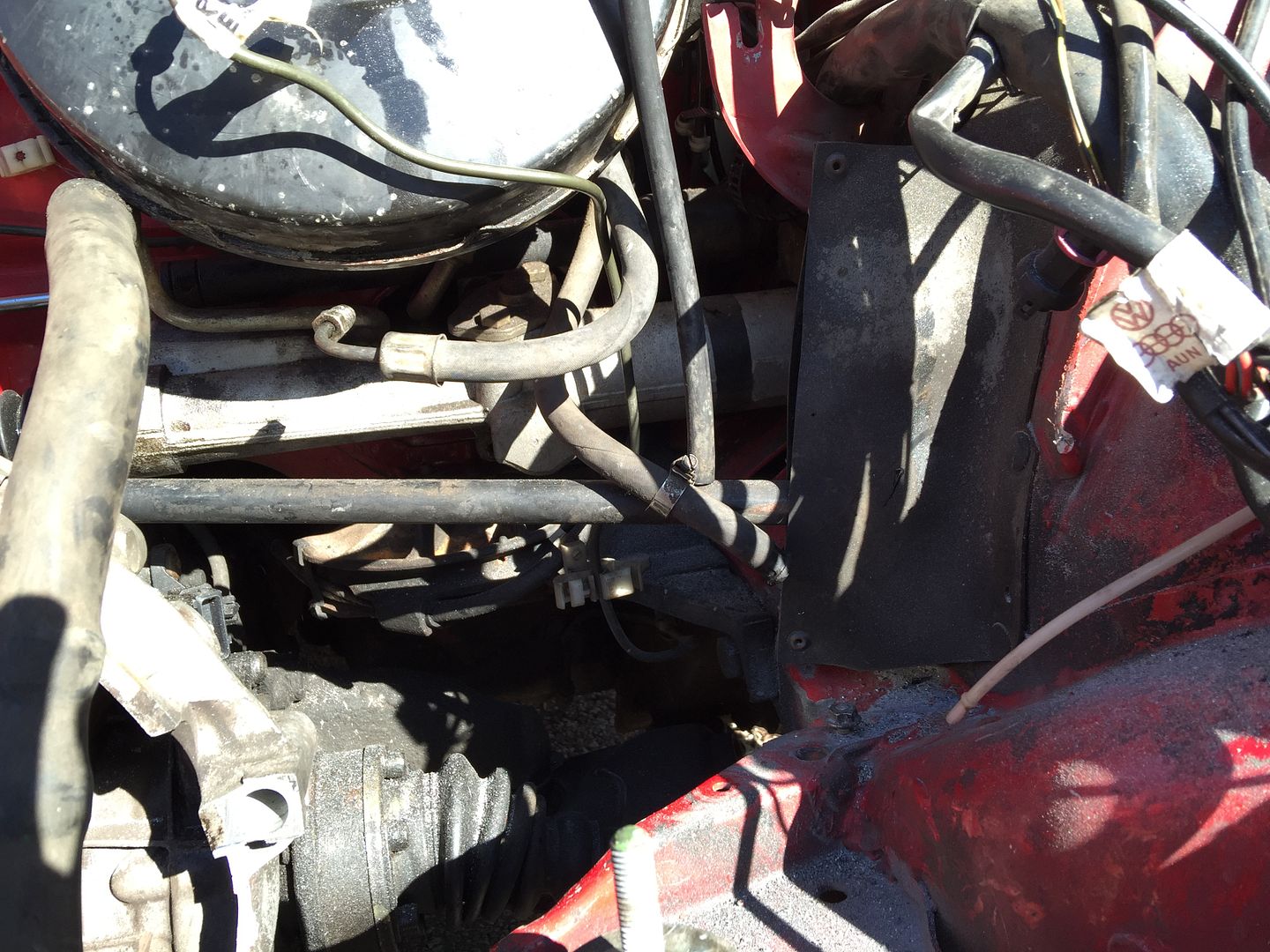

The next thing is the brake booster swap. I am omitting the bomb and replacing it with a vacuum booster and deleting the ABS while I'm at it.
boy is it tight!
So that leads to a couple questions…
Firstly, the brake reservoir sits a little cocked to the right…
is this a problem? I think as long as it's full it should be okay. It's leaning to the clutch hose side.

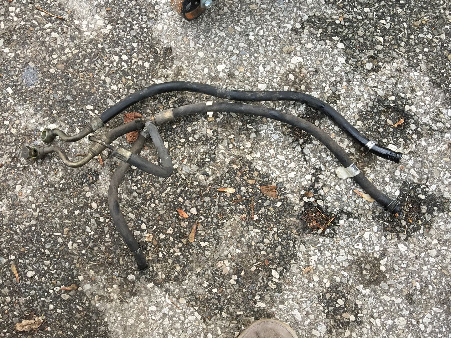

Also, the Power steering hose that should start at the pump and end at the rack is going to prove difficult. How have the rest of you V8 swappers dealt with this?
Lastly, the hose that used to go to the bomb, can I just fill the end of the hose and close it off or do I need to have a new hose made without the tee for the bomb?
I'm pretty close to getting the motor installed for good. I have to find a fabricator for the mounts and then install the PP and Clutch (I have it off to ease the engine install/removal cycle that I've been doing for the last few weeks)

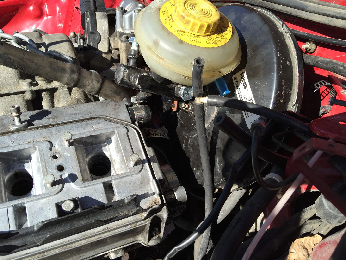

boy is it tight!

Great progress!
Something is not right with your brake booster/MC setup that it is clocked like that. The reservoir shout be positioned so that the top is flat. From what I recall, I had to swap out firewall spacers and push rods when I did mine (IIRC the vacuum booster I used came out of an 80). I would not run it like that- beside looking like crap, if your cap leaks at all it's going to make a mess, screw your paint, and potentially cause a dangerous situation if it gets low enough. Better to make it right now.
For the power steering hoses, I took all of mine to a hydraulic shop and just had them remove the rotten old rubber hose and replace it with new (re-using the steel ends). $15-$20 a hose, you don't have to worry about them failing, and you can get lengths adjusted to exactly what you want. on the two low pressure lines (to and from the reservoir) I had them leave the hose long then trimmed them to length once I had them in and routed. I omitted the T that used to go to the bomb when they replaced the hose on the high pressure line. In terms of making them all fit, I seem to remember having to tweak the end that connect to the rack a bit, but nothing major.

Here is what my high-pressure line looks like after having the rubber replaced. For this one I waited until the engine was in so I could see exactly how long I wanted it before having it made.

For the t that went to the bomb, I cut the fitting /tube nut thingy off the old line and just plug welded it and screwed it in. Simple blank. Can't help on the ps hose side as I ended up using an electric pump as I couldn't find a way to tension the belt without the ac compressor.

Either way, I got the Vac Booster and MC hooked up - now clocked properly:

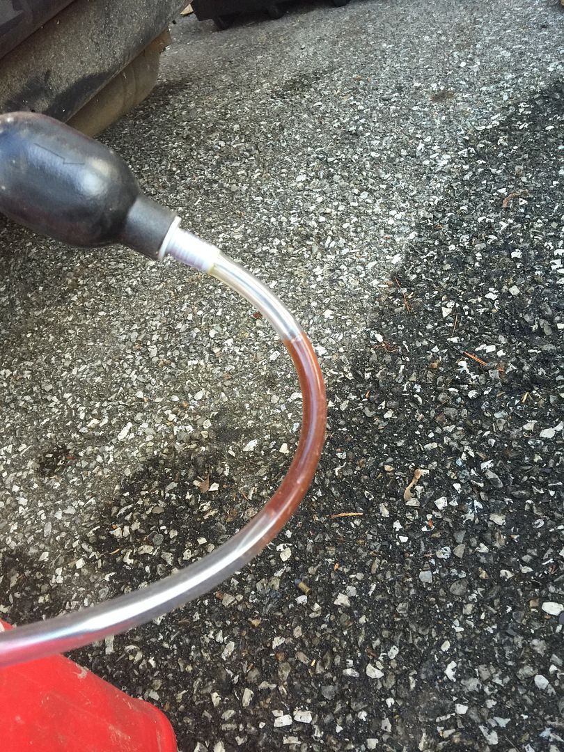

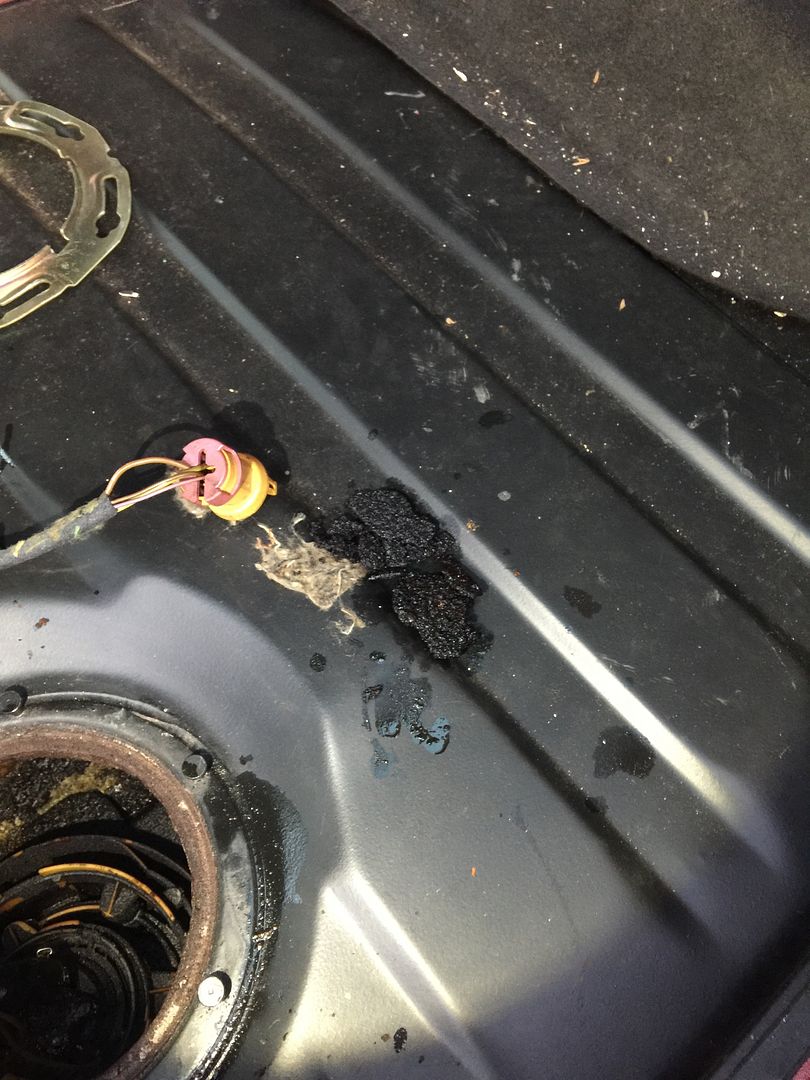

It was in the 50's today so after a nice drive in the Cabriolet with the top down I decided to drain the gas out of the Coupe. I have smelled a varnishy quality to whatever has leaked out of fuel lines in the past so I knew I wanted to start fresh.
Here's what I found...
Crusty chunks I pulled out...
Here's the color of the gas...
So is the tank salvagable? It seems pretty easy to remove completely and clean out assuming that would do any good.
Also, will I need a bigger fuel pump for the V8 anyway?
