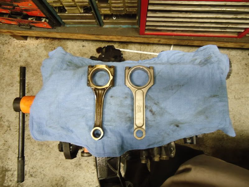

New hawtness vs. Old and busted

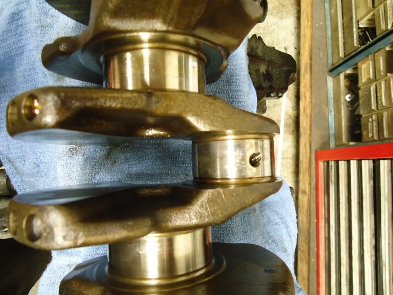

AAAANNNNDDDD .... crank journal wear... :(

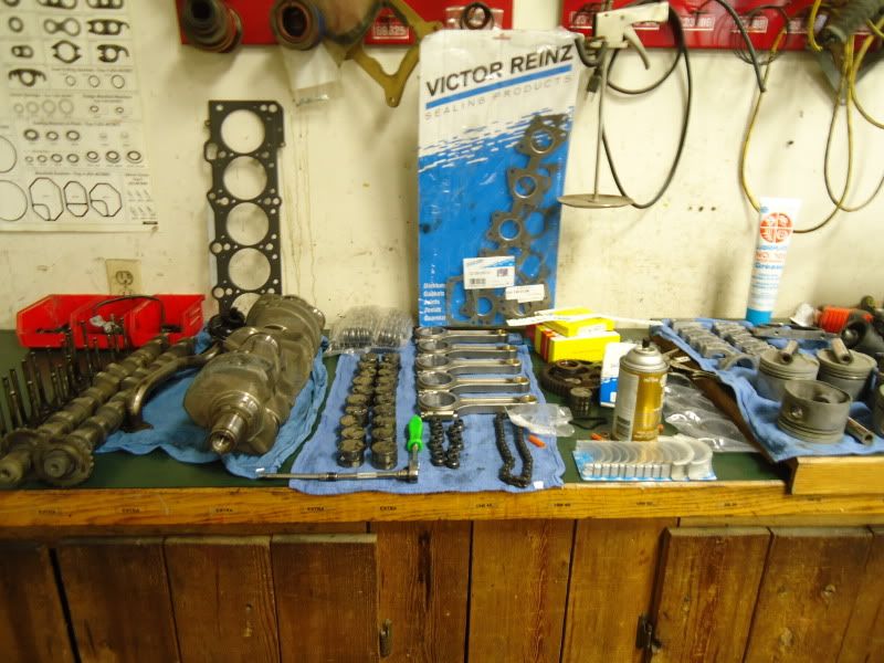

Ok, So I had the crank polished, so it looks like I am ready to go back together. Does anyone know where I can get engines specs so I can plastigauge this sucker? Or, with the 'dirty' rebuild I am doing, does it really matter???

Ben make sure to gap everything properly.... I dont see anything "dirty" about this rebuild and I would hate to see something happen down the line on ya. I got all my specs and clearances from the Bentley.
Re: Ben's AAN 4kq - Engine Rebuild Time -I have a couple of
I just realized that the plastigauge kit has the specs that I need.
I feel like a tard now. HAHA Oh and Jt4k, this is a dirty dirty rebuild. No machine work to the block. Just bearings and hone, with the rods of course. I have a 2nd block that will get all the lovin later down the road.

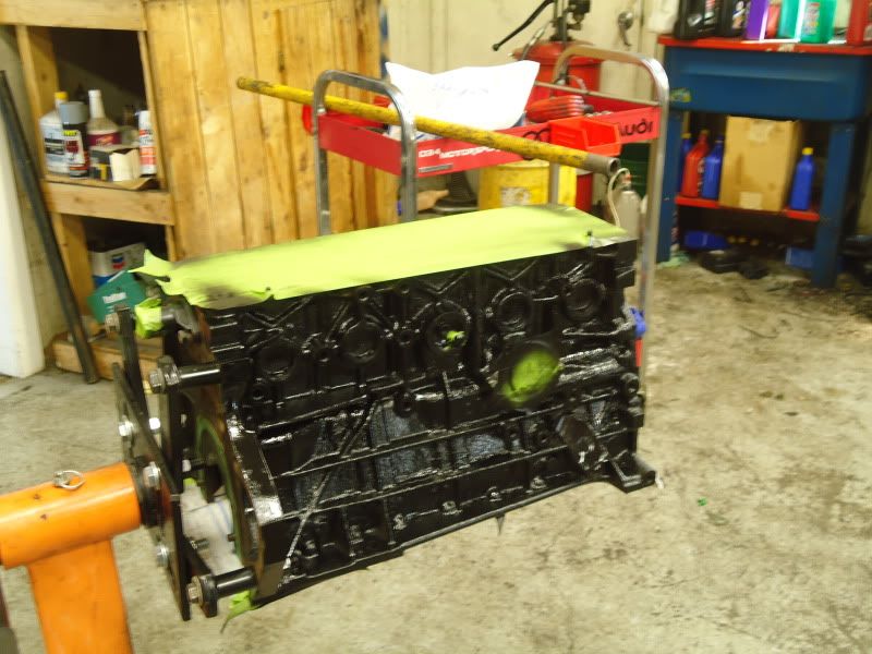

So... at the moment I am waiting on the correct rings, the ones I received had miss-boxed #2 rings... :bashtard: In the mean time I have assembled the rods/pistons as far as I could, cleaned the valves and honed the engine.
Fresh paint... for the 2nd time.

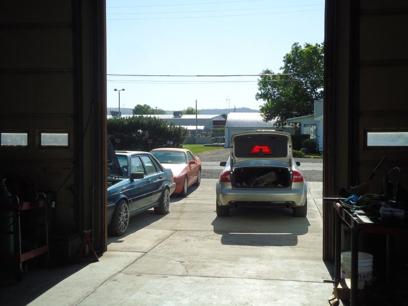

A6 Parts delivery from storage...

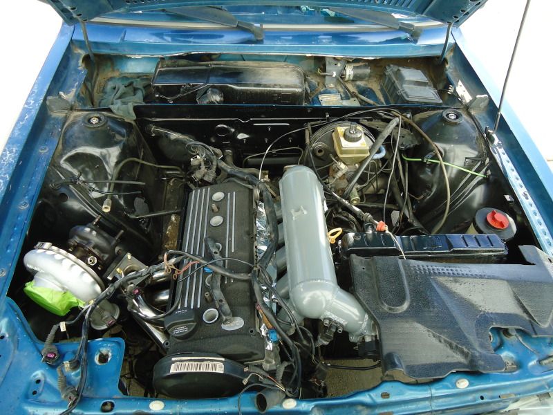

Current state of the engine bay =D

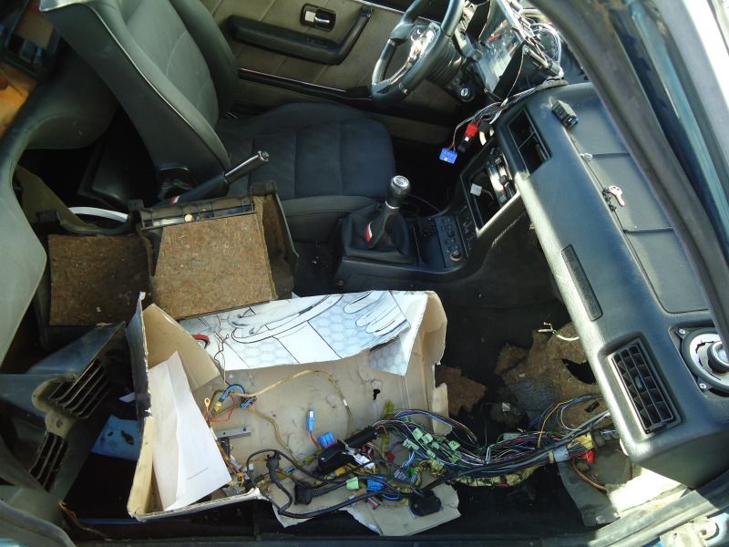

I'm still slowing working through the wiring. I'm about half done with the integration of key components. I have decided I am going to forego ECM control of the Fuel pump and just run an inertia switch for protection. The other part of the equation is identifying plug ends with-out damaging the shielding, so at the moment I am trying to identify the crank sensor plug (VR Sensor). Another reason I am going to keep the shielding is so that I don't have to continually fight with signal interference. GOOD CLEAN SIGNALS will minimize needless down time IMO. Here is a pic of the rats nest thus far:

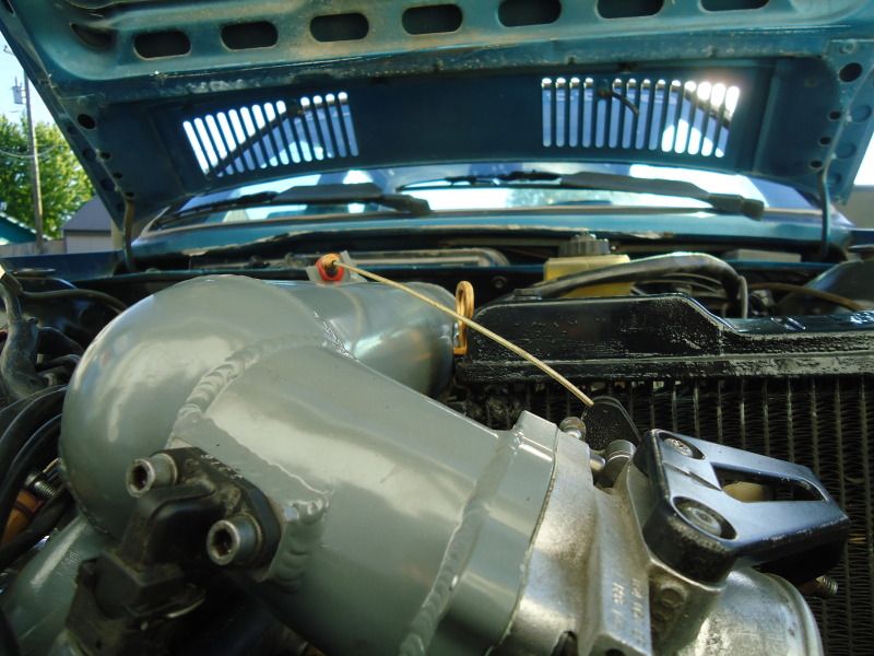

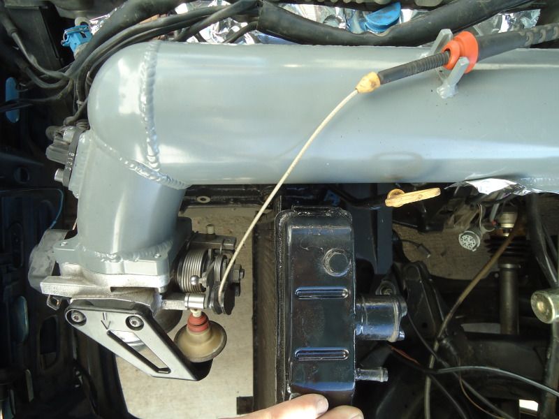

Another item on the list: I need to figure out my throttle cable, I believe I ended up with an Early Hank's intake model, so I don't have the pulley provision on this one... ergo I need to figure out a pulley to make it work without rubbing. More than likely I will mount something off of the RAD brace that I am fabbing up.

Good to see you going at it! Engine bay looks beastly.
