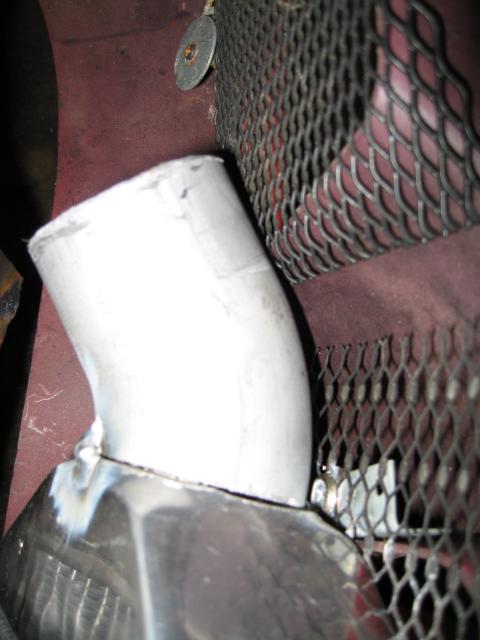

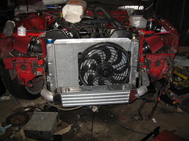

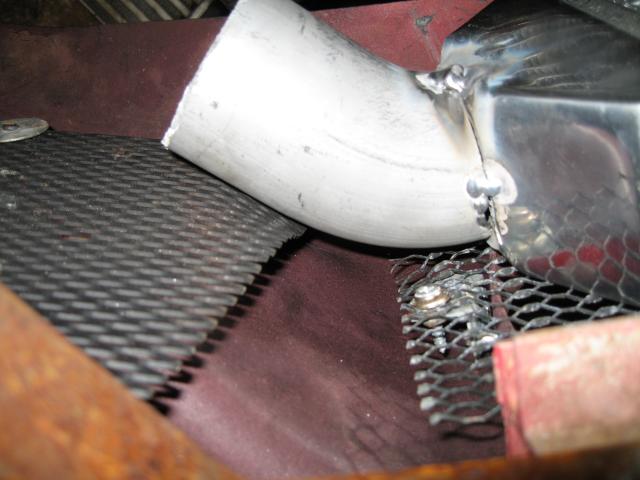

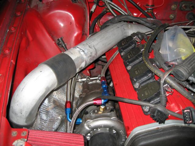

Anyway, got some intake plumbing further along today. I had to switch to a different gas tank for my welder because they sold me argon last time that.. isn't.. argon. Dunno what the hell it was but the welds were coming out ugleeeee as sin.

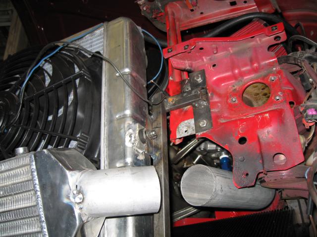

I've got very little clearance between the small front mount intercooler and the outlets but by cutting the stock outlets off the core and welding on 45 degree pieces of mandrel bent pipe I was able to clear the bumper with no cutting:
The drivers side intake plumbing is pretty much done.. I just need to get some more 2.5" mandrel bends to finish everything up.

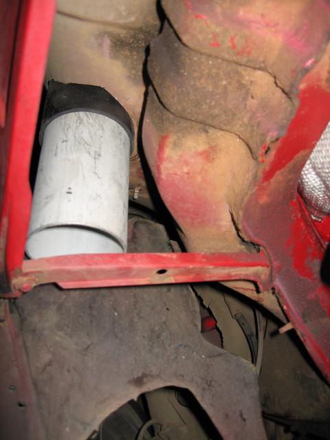

Shot of the plumbing into the intake manifold:
The 'y' pipe will join somewhere down here:
As for an intercooler for the passenger side turbo, my stock S6 intercooler was too big, so I bought a small intercooler of an eclipse that will take its place.

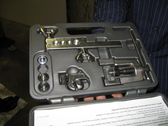

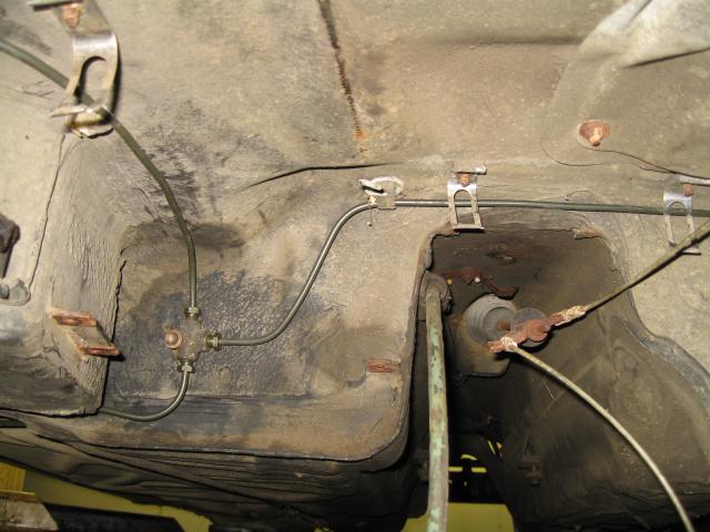

New brake lines on his UrQ too, nice job Den!

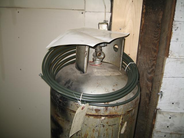

Note to self, use somma that stuff next time I need to do a brake job (plastic coated steel tubing)

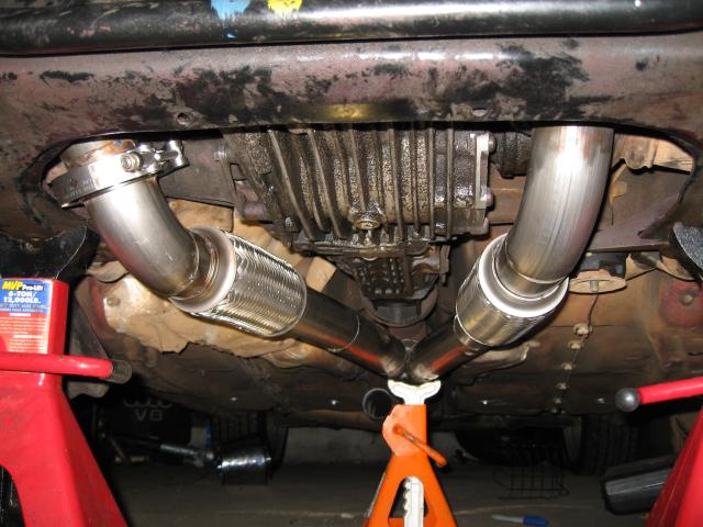

spent part of today working on teh car.

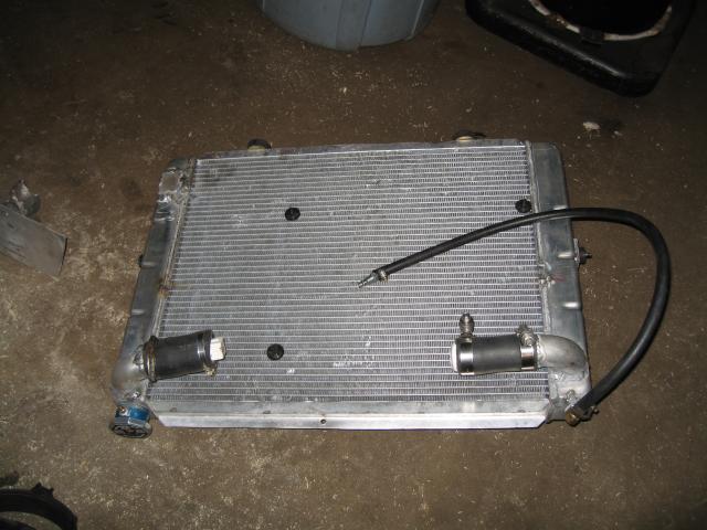

pressure testing the radiator

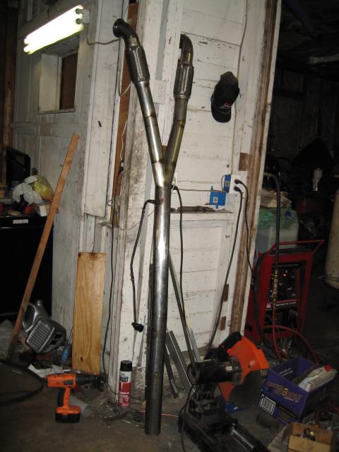

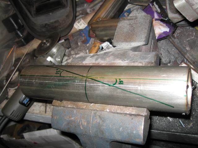

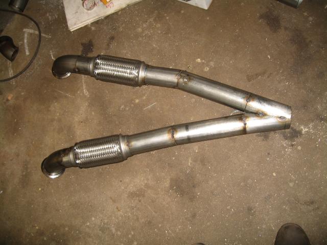

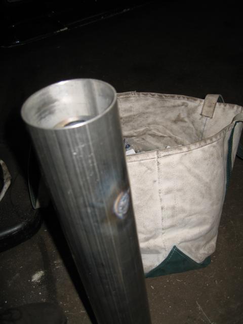

I ended up completely redoing the y-pipe from the version I had initially built for the NA setup. I wanted a closer ratio 'y' so I ended up fabricating one that joins at about a 30 degree angle
and the finished y-pipe to downpipe exhaust section

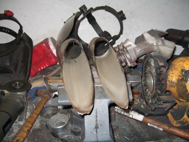

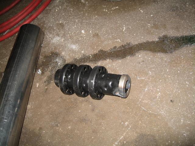

I also installed a 3" car chemistry insert after the collector
All I had to do was just drill some small holes where I wanted the insert to sit and tack weld the insert in place. I really like these things.

im dumb, what is a 3" car chemistry insert? what does it do?

3bAudios wrote:im dumb, what is a 3" car chemistry insert? what does it do?
Its a stealth chambered muffler. Check Car Chemistry's website for a full explanation.

I had heard of car chemistry inserts before.. in fact I threw one into an 80q I used to own to quiet down a single muffler setup I had on the car at the time. Worked like a champ.

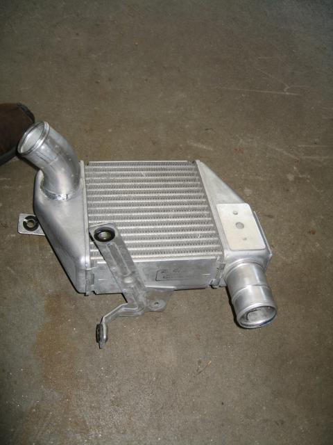

'new' intercooler for the passenger side turbo arrived today. I shouldn't have any difficulty fitting this into the available space.
This one is a stock unit off a mitsu eclipse:

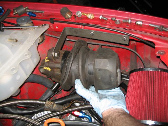

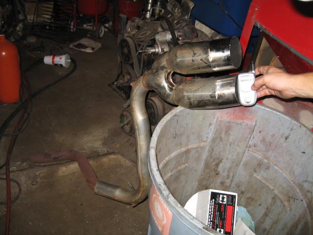

Also, I never posted these pics from last weekend, did a little more work on the exhaust (added bung for wideband, started mounting MR2 power steering pump)
And here's what the PO of my coupe thought was a 'cool' exhaust system mod. Cripes, most of the adnoH ricer tips I've seen aren't even this big :-P :bashtard:

i'm gonna bet that you get a lot of P/S harmonics with it mounted solidly to the fender well there ;)
