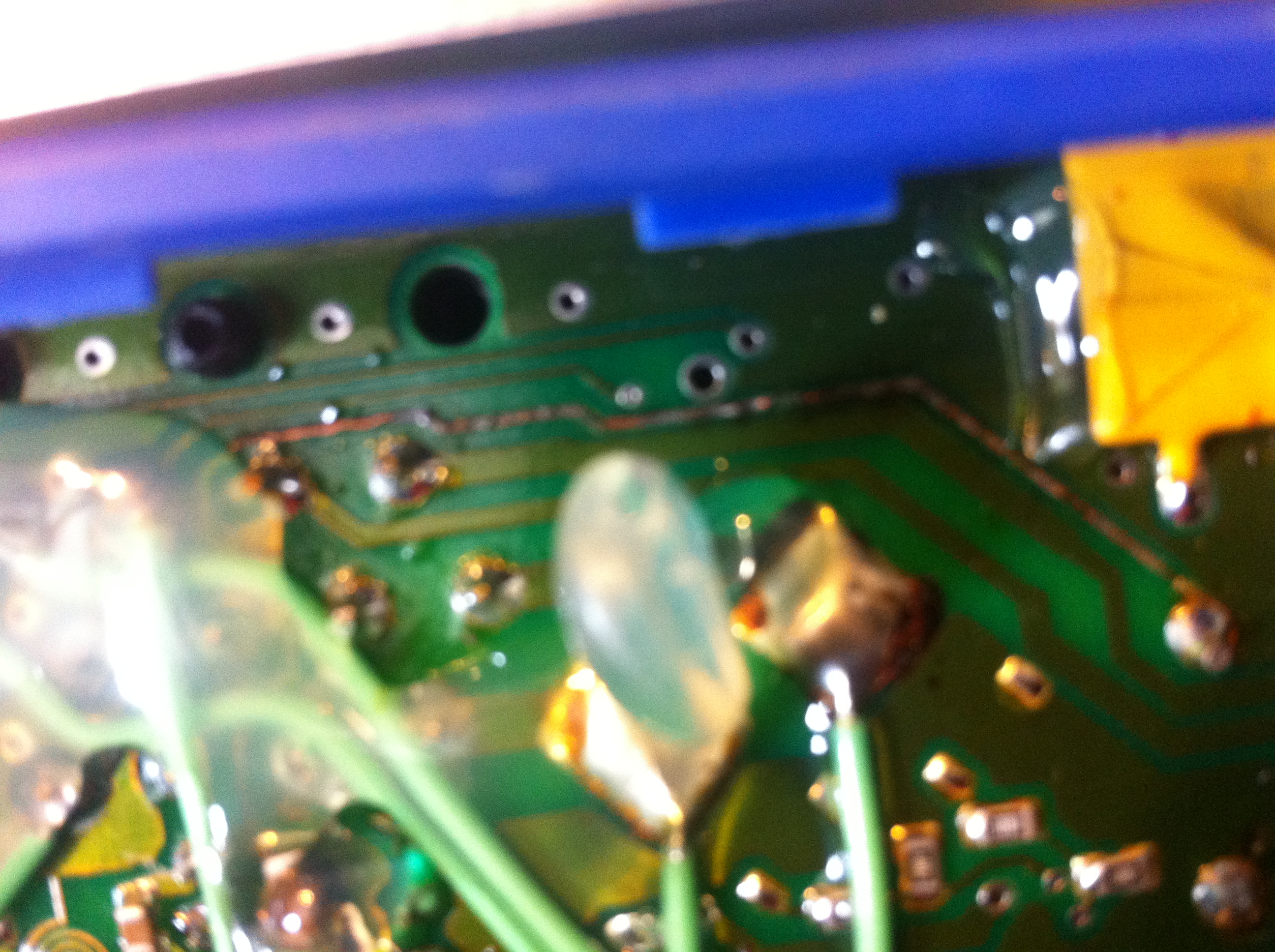

when the stepper chip exploded it burned up the power input trace to it, which runs right to the ecu power supply junction. I'll get it fixed up and back out to you today.

See, thats why i sent it out to you. LOL. Thanks Marc.

Yep, Marcs got it handled and it should be making the journey back to me starting today. Marc also put in a lower resistor for the tach driver so my tach should work

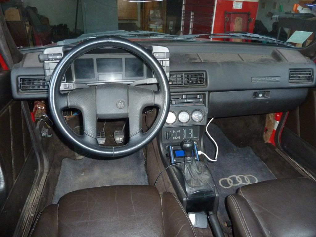

A little update. Worked ove the weekend to get my wiring cleaned up and off the floorboard. Then put my guage cluster cover and dash bezel on. While I was at it I decided to play around a little and installed a corrado steering wheel that I had. Just used a factory late model mk2 jetta steering wheel adapter that changes the splines on the column from the small ones to the big ones. Had to cut the adapter in half so it would slide on far enought to allow the steering wheel to go on far enough so the turn signal cancel and horn contact work. Looks a lot better now(like a real 4k
Now all thats left to do is put on the kick panel on the lower passenger side and the driver side knee panel and the interior is done with the exception of a good cleaning.

PS, that steering wheel completely transformed the feel of the car. Its soooooo much better now. Much easier to grip, slightly smaller diameter makes steering a little more direct/faster, and it sticks out towards me about 1 inch further which makes it more comfortable. Highly recommend it to anyone with a factory steering wheel.

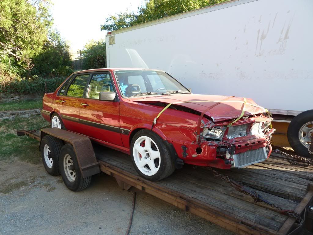

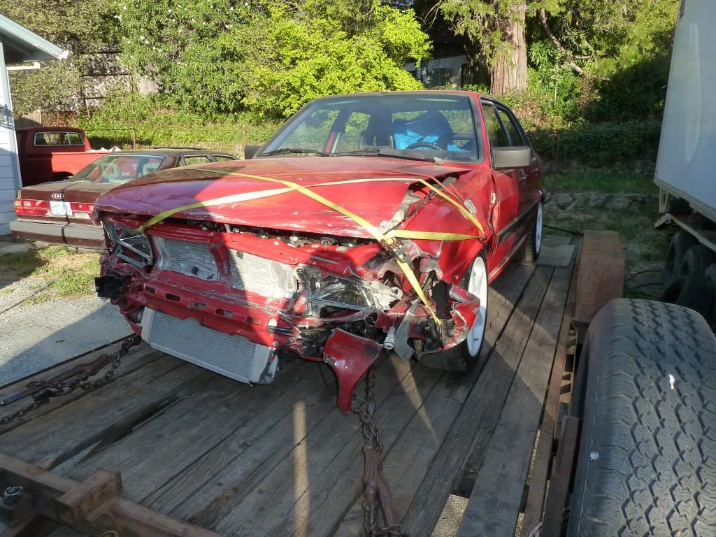

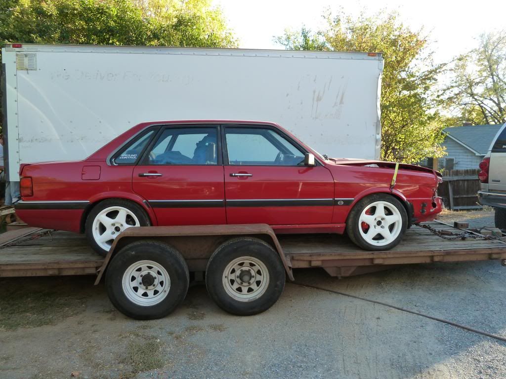

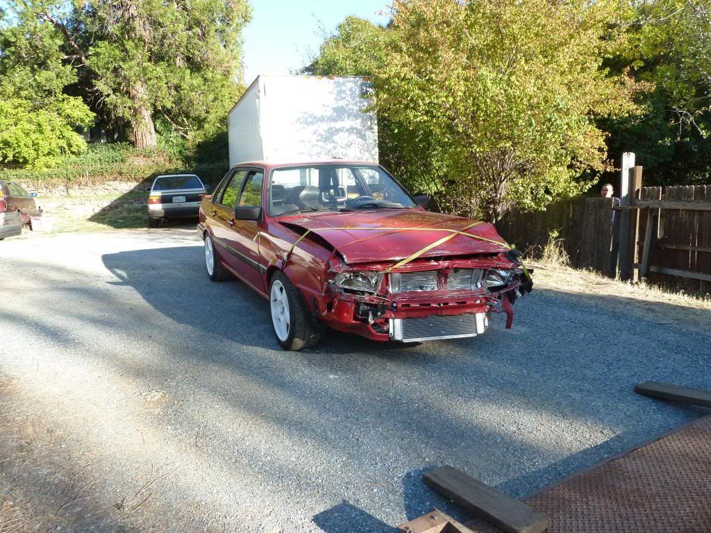

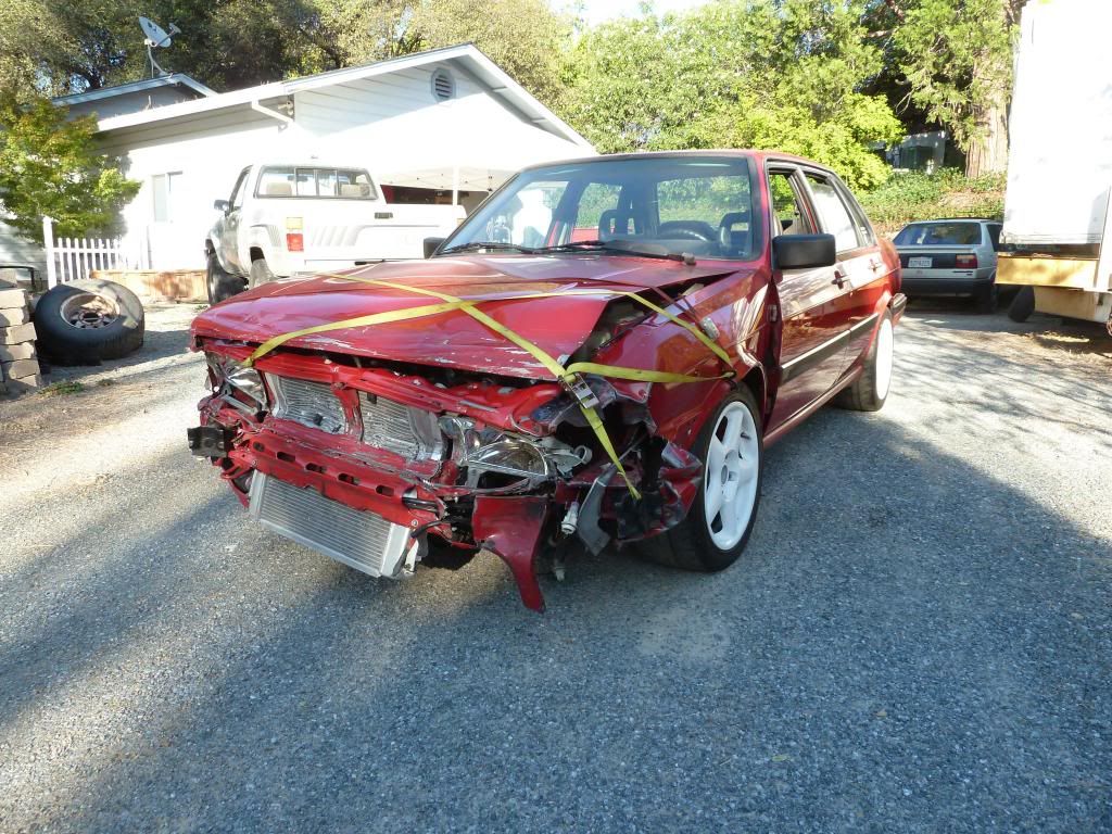

Re: Dan's 40V V8 4000...On its way to Oregon
Heres an update for yall. The car is in/on its way to its new home for rebuild by the skilled hands of the man known as Derracuda. There is an S8 engine awaiting transplant and possibly some other parts too. Heres some pics of the departure...
If things work out as we hope it may be ready in time for Tahoe 2014 and or Leavenworth Drive.
