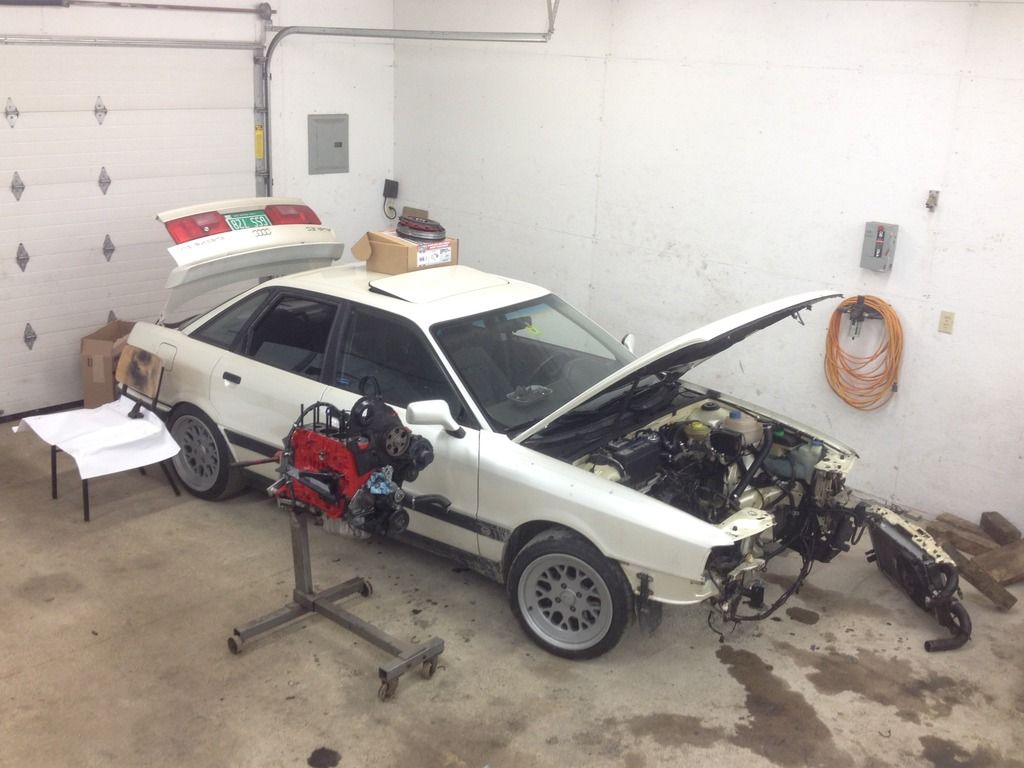

a little project car refinement got out of hand..
I had planned to install a cam and lifers and an oil cooler. When I pulled the cam I saw a couple lifters with abnormal wear. I decided I should pull the head and make sure there was no piston to valve contact. I still had the wimpy factory valve springs, and it seemed like a real possibility that they flutter open under high boost.
Once the head was off, I found no evidence at all, but decided to port the head.
Then I decided I needed to install my new 240mm DMF and clutch, so I may as well pull the motor. So with the motor out I have a list of things to do.There were several issues I discovered
-only two of the 4 intake manifold bolts were never tightened!!
-there was a small bit of metal that looks like part of a hole boss in the timing belt cover that had gone through the timing belt and was sitting in the bottom!
-the main timing belt cog was a bit worn on the crank and causing timing deviation.
-the head needs porting
-both of my motor mounts were ripped out
-I want to change the bulkhead fitting in the oil pan for the turbo drain to a welded AN fitting
-the intermediate shaft bearings are a little worn, not a deal breaker, but "while I'm in there"
-adding a lift pump to the fuel system
-power steering pump is noisy
-adding a bigger cam and dual valve springs
Plus I still have paint work to do on the passenger side. Sucks to not be driving the car. I was really digging daily driving it, but it will be nice to iron out all these details. I hope that the car will run lower EGT's, smoke less and have more top end power. I also hope the new flywheel can handle the torque and not bottom the springs out.

Re: 1.9 TDI into 90q: MPG average report
Wow, I would say it got a little out of hand... the question I have is, how were you making the boost you were with a loose intake manifold?
Both end bolts were tight still, it was mostly sealed. It probably leaked some when it got hot. Either way, not good, and pretty bone headed!DE80q wrote:Wow, I would say it got a little out of hand... the question I have is, how were you making the boost you were with a loose intake manifold?
Re: 1.9 TDI into 90q: Tear it down, built it back.
Is it back together?
yes. Had it running well for 30 minutes to break in the cam. Took it on a test drive. It was running great for about 10 minutes and it started shitting out quite badly under load. Like it did way back when I had the timing really retarded. Except this time, injection timing is dead on. No codes.scubagli wrote:Is it back together?
Swapped entire injectors out for a spare set, no change.
Checked compression, all cylinders 460-480.
Cam and lifters look perfect
Cam timing dead on.
It would seem like I have a pump issue or a restricted fuel supply. Honestly I am just kind of over it at the moment. I'll get my motivation back.
I probably dumped 100 hours and untold dollars into it this month and let other life priorities slip.
At least the new clutch flywheel and starter seem to be good.
Its probably something simple. Ether a fuel supply issue, bad pump or a wiring issue.
A miracle has been performed by diesel purge. I think the timing piston was stuck in the pump. Running like a champ now. Looks like it's time to upgrade to an 11mm pump.

the time for my long awaited old audi roadtrip has come. We leave tomorrow at 0700, and drive towards Vegas for Battleborn and general adventure. Some hiking and camping in national parks along the way. I am beyond excited, I have wanted to do this for as long as I could drive.
I have ferreted out many trivial issues in the last month.
-odometer fixed
-rear diff changed
-all new fluids
-lift pump added
-body work done
-rust fixed
-etc etc etc
A quick tape measure alignment tonight, and we are ready. Car is running strong and healthy, and hope to make it 6000 miles trouble free.
I have spare alternator, spare belts, full size spare tire, tire plugs, compressor, tool kit, coolant repair tape, extra fuel lines, random hardware, extra wire, mulitmeter etc. Should be good to go.
