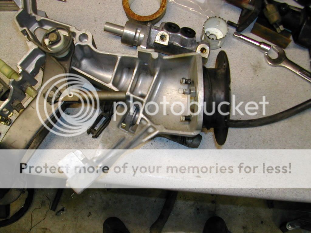

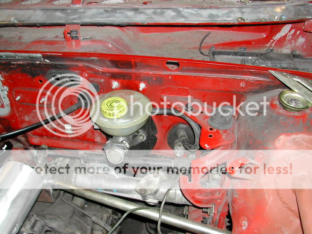

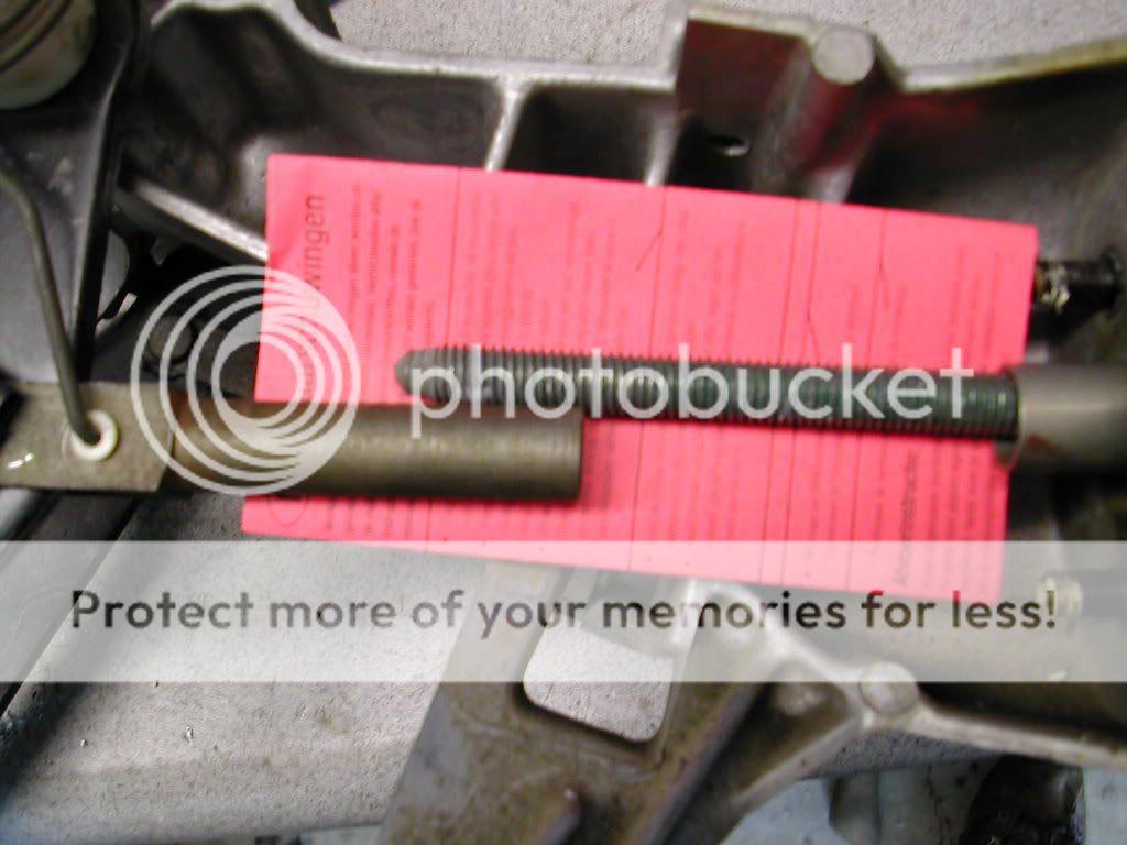

so i am ditching all help for the brakes. just like on the rabbit, just a master cylinder. no bomb, no hydro assist, no booster. nothing. nada. zip.
see, the aftermarket companies make pedal and MC stuff, kits, with no booster, hydro, etc. the car still stops fine, just a little more effort has to be put into the pedal.... and its fine, because it is only going straight.
so i pulled the pedal cluster. much easier on this car than the rabbit, that one kicked my ass but good. also something about working on a car with a cage i seem to remember

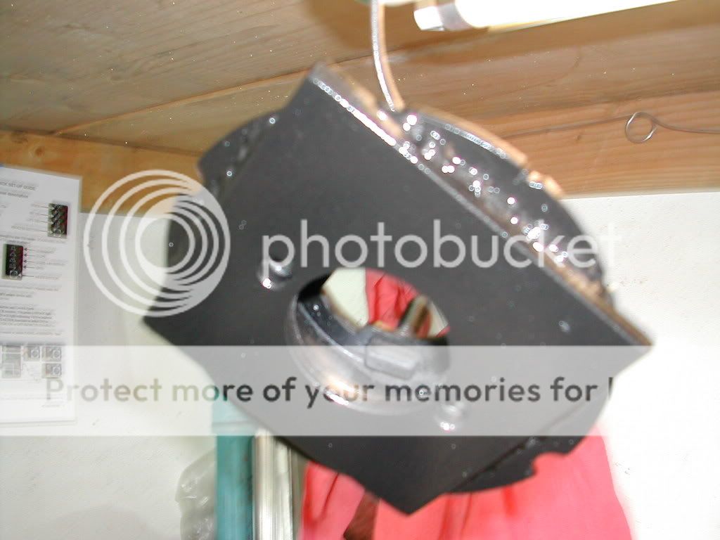

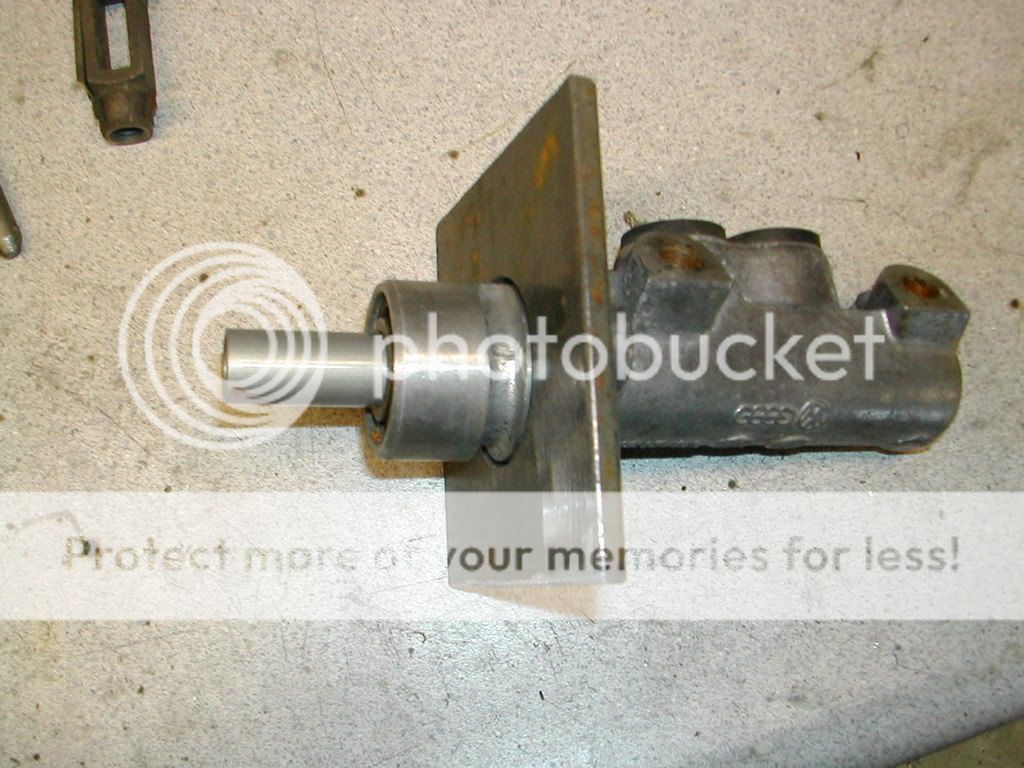

so pull pedal cluster.
remove hydro assist part.
remove bracket.
measure it up.
make a plate to mount the MC to the bracket.
drill for MC.
weld backup nuts onto the plate.
weld plate to bracket.
many test fits in between, BTW.

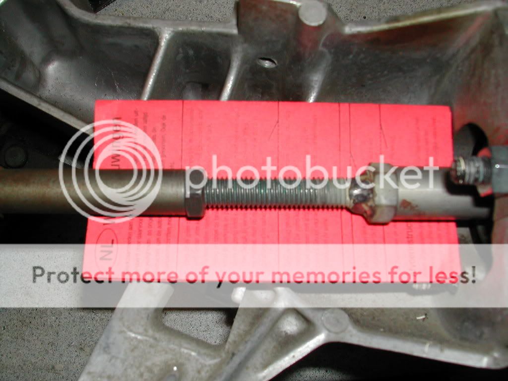

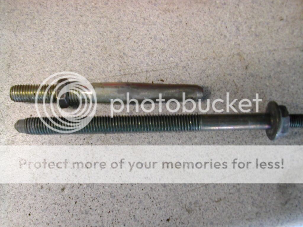

measure up for rod, find out the other rod from the rabbit is too short. find something.
today, while at the wreckers looking for a bracket to do this mod with, i found many OEM bolts. one happened to be an 02A starter bolt. hmmmm, whadya know, same thread pattern as the plunger rod. and the required distance longer
cut bolt head off, test fit/measure up.
make a jam-nut for the MC, weld it to new rod.
install rod into clevis for pedal, and adjust.
VIOLA!!!!! manual brakes in under 1.5 hrs.
and i even got me a replacement for the broken pedal i did when building the tunnel. $5 bucks plus $1 entry.
:woowoo:
i have progress pix, but the paint is drying on the bracket i made, so i will post up a picture later of it all installed. gotta love making room under there
and i made a thread about this mod in the Brakes forum, so if someone (like me awhile ago) was searching info on manual brakes, it would be easy for them to find it.

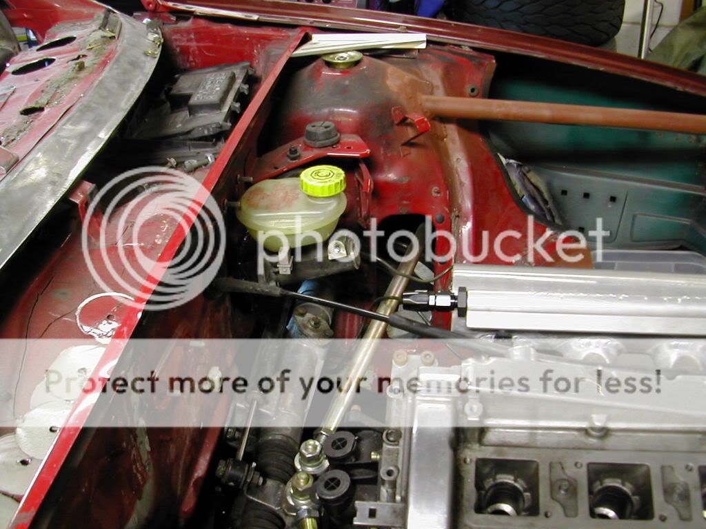

haha. well, yesterday we had a couple hours of planning session. now all the manifold, AWIC, valve cover, fuel cell, catch can is in development.
i kept the car at home for the day as the welder is here, etc. in case we wanted to tack/try things. but alas, we did not do anything of the sort. and today too lazy to do the swap arounds... plus it started snowing while i was browsing at the wrecking yard. been sooooo long since i went "grazing" i did not even know that there was a B5 A4 v6, a v6 100 auto, and a 90Q there, among others. i saw at least 3 01A trans'd cars, i can tell by the shifter now. the 90 yielded me the gas pedal i broke, and some motor to trans bolts i did not have as well.
i also welded the crap out of the steering linkage that i had to "make" work together, from the manual rack swap.
the rabbit has ~5 hours or so to make track ready for what i WANT (trans swap, wire in the new WB02, harness). for what it NEEDS is <30 minutes (lace the new harness in).

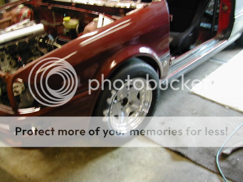

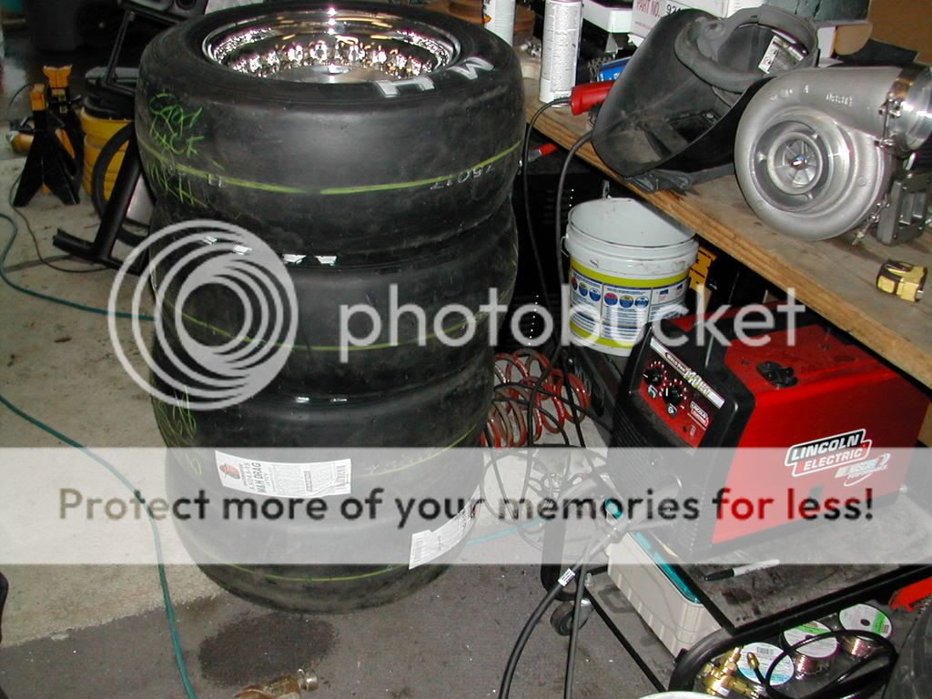

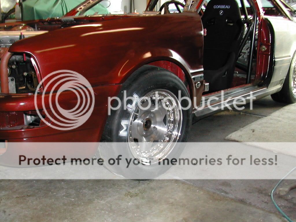

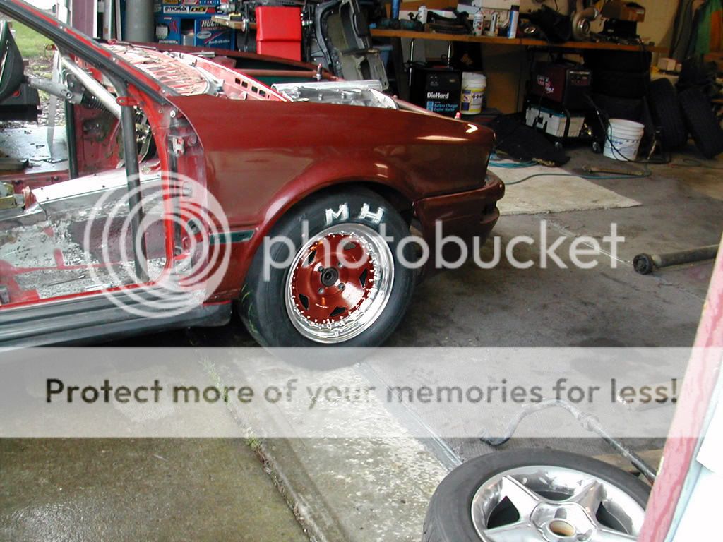

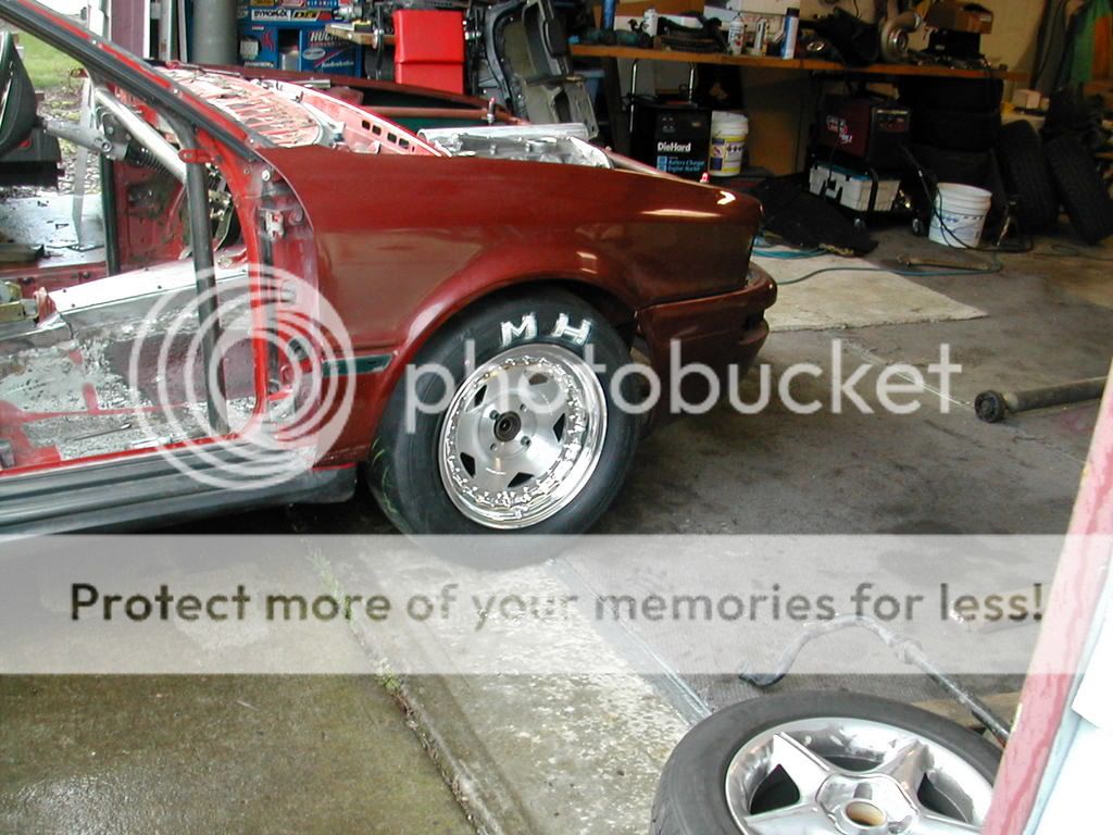

slicks are here, they are temporarily on, and they look BADASS. period. the front is about 1/2" from the bottom of the coilover, i think it turned out ok. it will lift anyhow. the rear is alot lower, and i will raise it up a little bit to run them. the tire does crown and grow on hard acceleration. and i plan on a bit of that i do....
