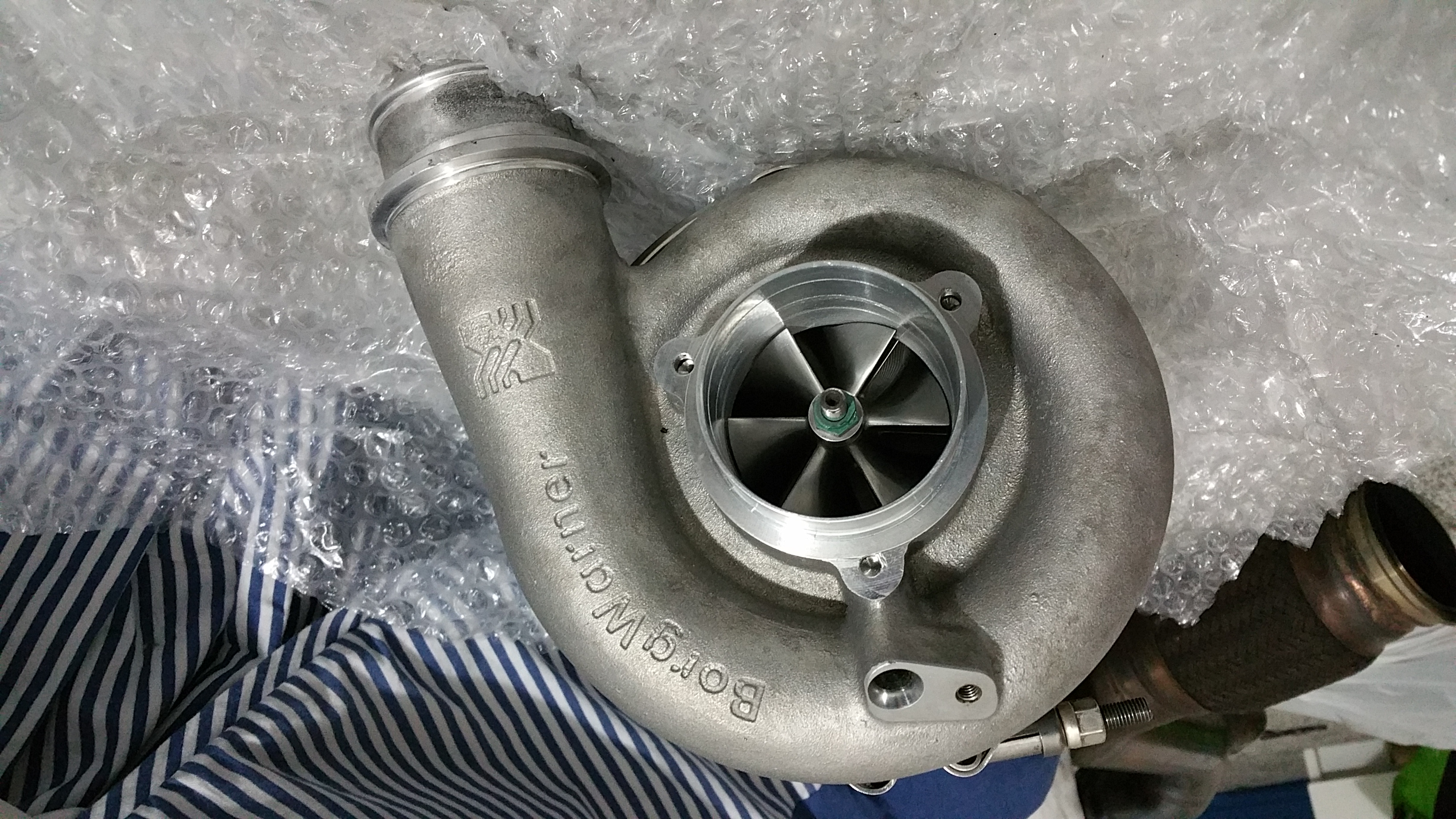

Hi
- 20160716_223130.jpg (2.2 MiB) Viewed 36852 times
Hmm
- 20160716_223130-1.jpg (2.34 MiB) Viewed 36843 times

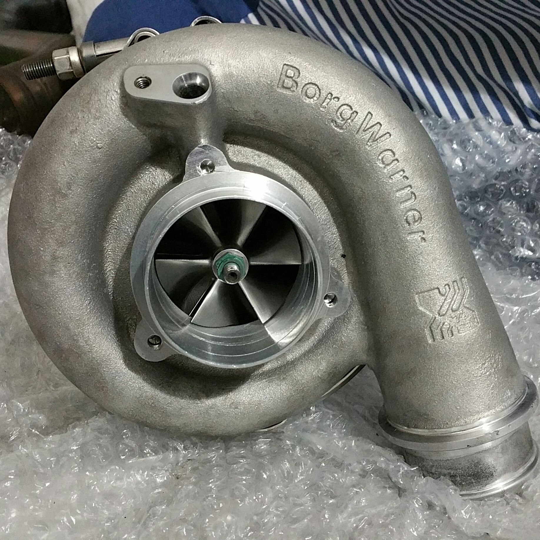

Someone had a good waterfest
Did you choose an EFR?
Is that a 9180?
Is that a 9180?
Haha no, just a little 6758.
According to Marc, spools like stock but then HOLY S****!
Can confirmloxxrider wrote:Haha no, just a little 6758.
they're a damn hoot and a half.

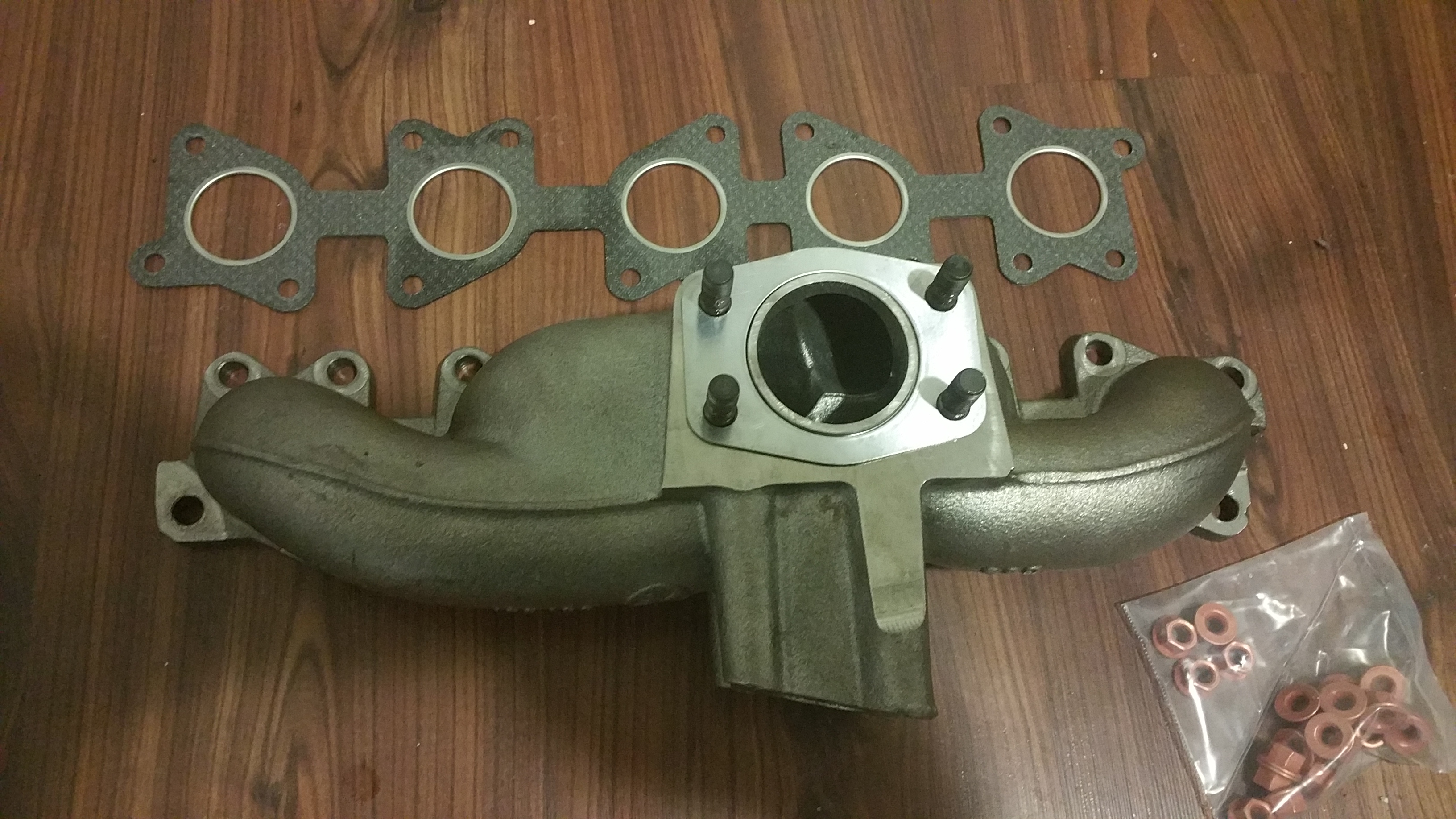

I do have at least a picture of the manifold and one of the car to hold you over.

Yup.

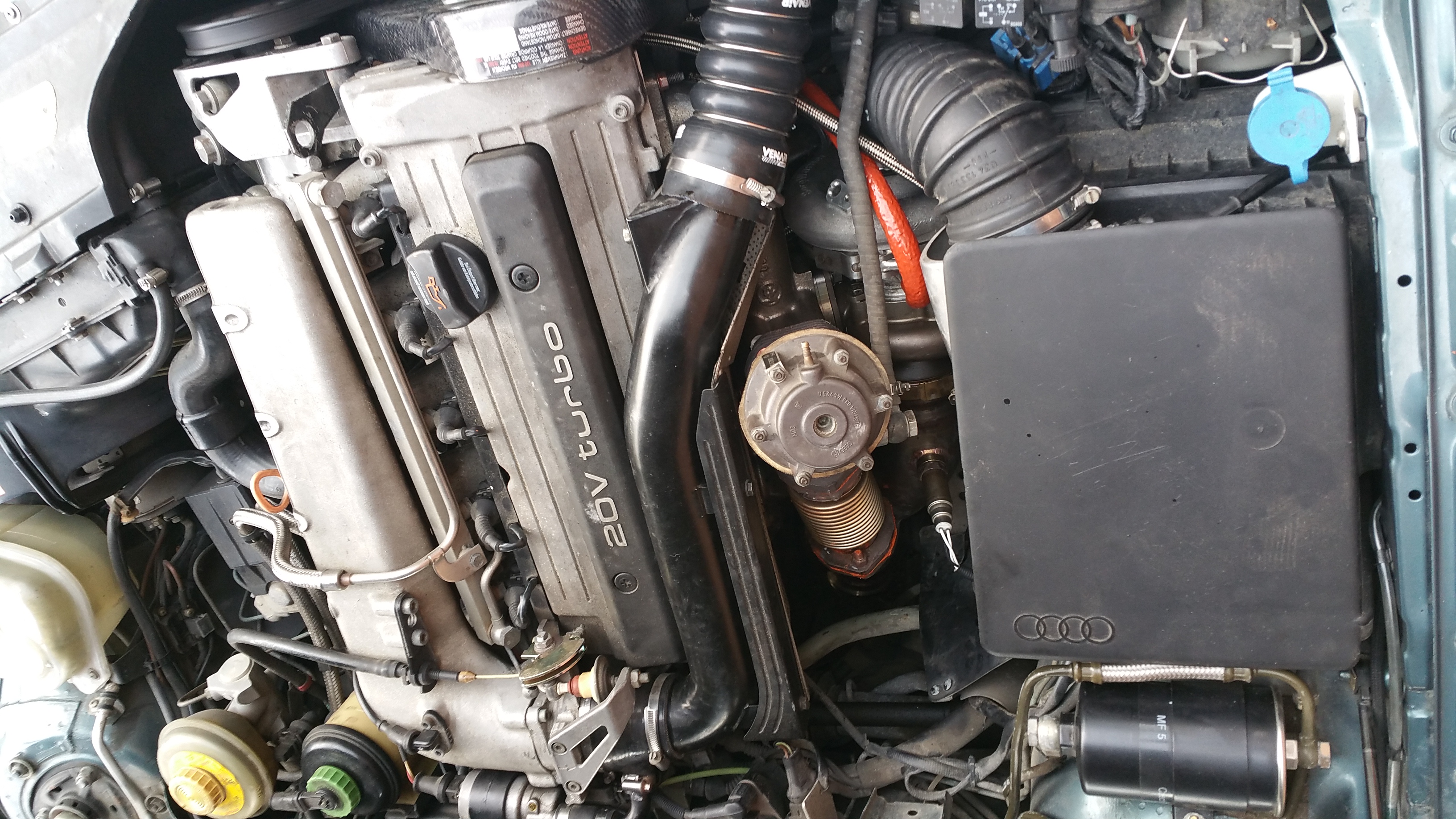

Didn't look much different than stock!
- 20160725_174632.jpg (2.08 MiB) Viewed 36643 times
Haha! Sorry dude! Sounds like something i would do. Car looks good. New setup should make for a dynamite daily. Looking good!loxxrider wrote:Welp, it's in but not without its problems. Still have to fill with coolant tomorrow, the rear section of the exhaust is bungee corded up near the transmission, the wastegate reference line is plugged because I didn't have the right size hose for it, and... Wait for it...
I forgot to put the gasket between the turbo and the manifold. FUUUUUUUUUUUUUUUUUH!!!!!!!
I noticed that after it was completely assembled. Not happy about it. I was thinking Oh, I have a vband. No more gaskets to put on, yay! Here's to hoping it still seals. At least enough for me to drive it for a while until I can redo it all over again :(
Yay for long distance drives with open downpipe!
