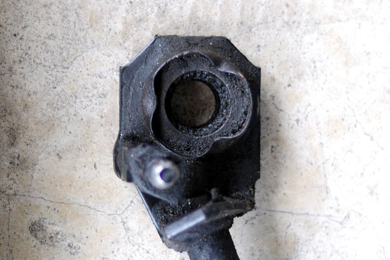

I got to work on the 200 for a bit today. I did all that I could without parts. I got the wastegate in and it looks great. Before I did that, I got under the car to try and fish the shift linkage out of there. That was hard, so I can't imagine how much cursing I'll be doing when it comes time to put it back in with the new bushing. I'm not really sure how I'm going to get that other little ball/socket (attached to a small rod) hooked up to it either. Here is the old bushing... thoughts on this? Looks old and nasty to me.

That bushing is TOAST. There is supposed to be rubber all the way around. You should not be able to see through it.

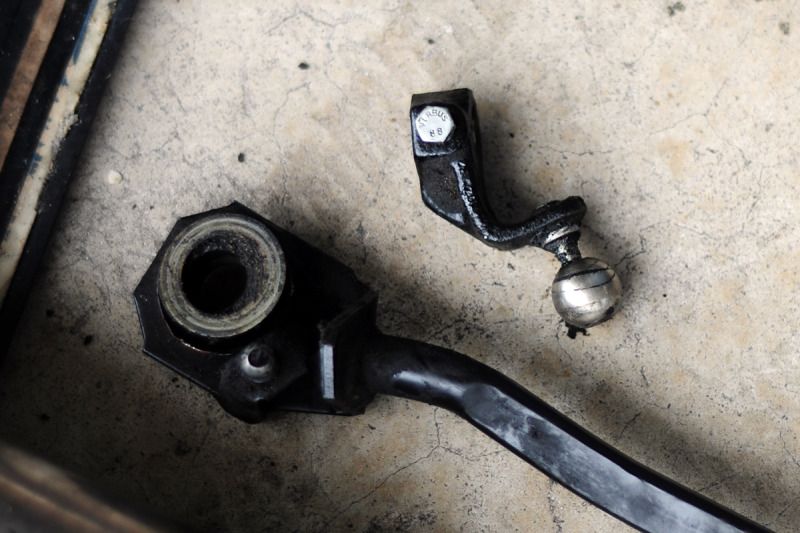

Easiest way to get it all back in would be to assemble the ball part out of the car as well. So the shaft that the ball and bracket bolt to should be removed from the transmission. Then assemble with it out of the car. Then slide the linkage on and bolt it in. 10 times easier. And actually possible.
Only place to get a replacement.
http://www.034motorsport.com/chassis-co ... 20049.html" onclick="window.open(this.href);return false; ... 20049.html
Direct replacement. Done 2 of these. and they sure as shit aren't easy out of the car. But definitely possible. Grease and lube helps.

What I'm talking about is the ball that goes into that bushing. That ball is bolted to the shift selector shaft (probably not the right technical term) with I believe an 8mm bolt. Remove that so you can get the ball back into the linkage easier.
Does that make more sense? I'm so terrible at wording things sometimes. I'll try to grab a picture after work today.

There is not a bolt for the small ball. And there is not one for the large ball. There is one for the bracket that the large ball is attached to. Does that make more sense?

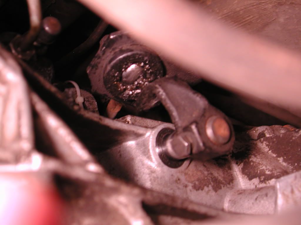

Home now. Heading to the garage armed with a camera.
Re: Loxxrider's 200 20v: shift linkage fixing
Not totally sure how I managed to get my hand or the camera into this location. But hope this helps.
Remove that bolt, remove that arm. Then install outside of vehicle. Install by putting arm back onto gear selector shaft.
Wow, that is not at all what I imagined I was feeling haha. Thanks for the pic! Hopefully I'll be able to figure that out now, and hopefully I'll be able to just man that little ball back into its socket as well.

I have the engine out of my 5k, I'll go out to see if I can see it from the front and try to get a pic of the top too.
Posts: 659
Post by glibobbo21 »
Without "punching" from the side over the top of the trans itll be hard to get that arm off. Not impossible, but difficult. A puller cant really fit either...
