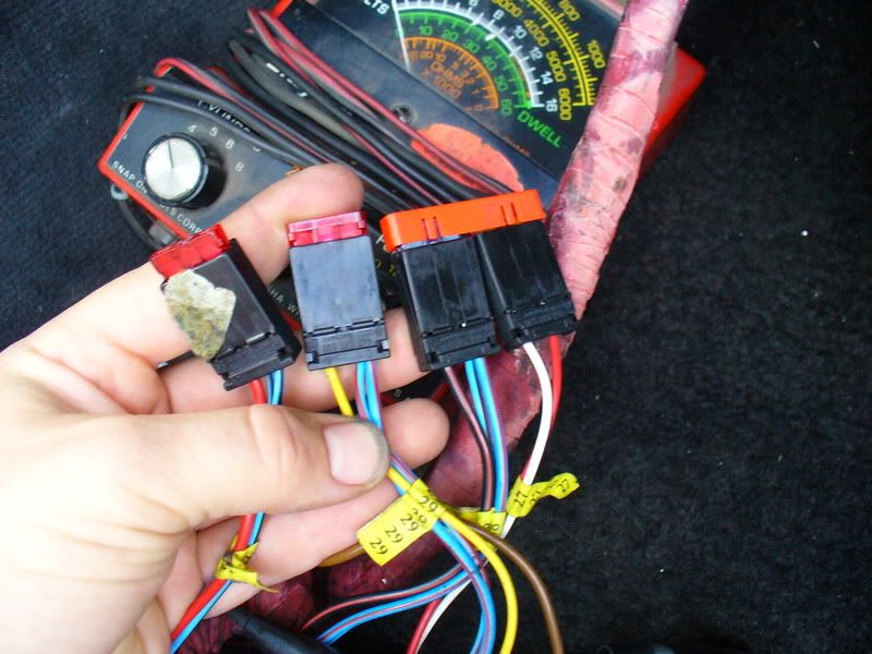

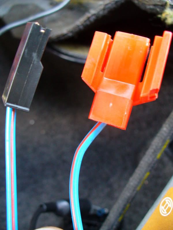

ok, wiring up a 3B is really easy for the 4kq. there's only 4 wires that need to be hooked up to get power to the ECU, 02 sensor, and ground.
first off these two...
are hooked up to key on +12v. they power the fuses for the ecu and 02 sensor, etc.
fuse #27 on the far right has a red wire, that red wire goes to the yellow plug, from the yellow plug, i don't care :P it just needs to be hooked up to +12v all the time, not just key on. i believe this is the wire that keith said is for the ecu memory.

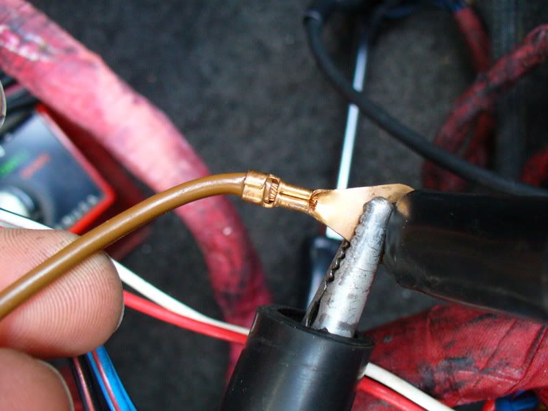

this is.... ground :P very important ;)

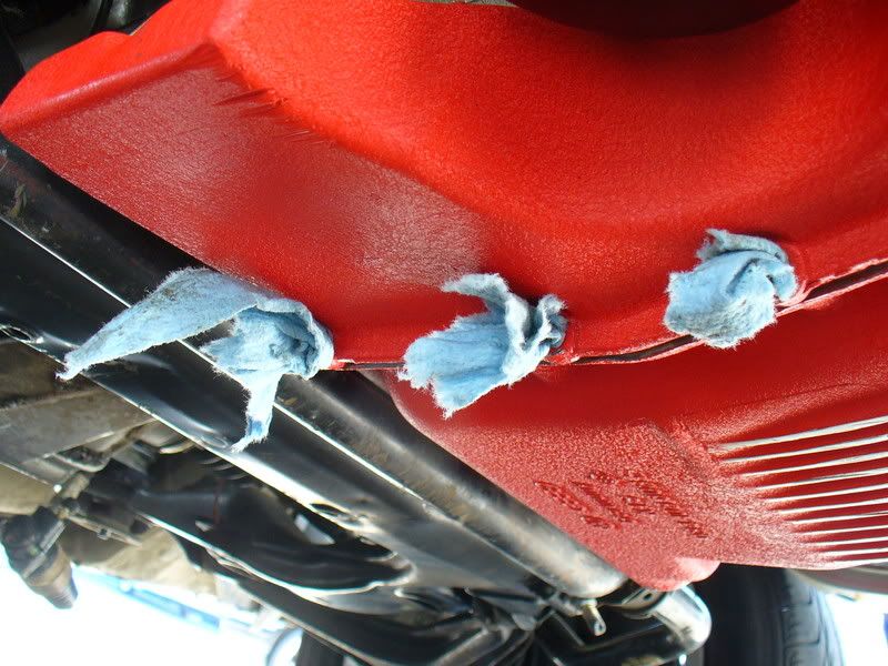

i pulled the bolts out and cleaned and siliconed them up, let it set for a few hours, and they still leak :frustrated:

it's not the actual extension that's leaking, it's the bolt threads. the oil comes out at the bolt head, not through the seam of the two pieces.

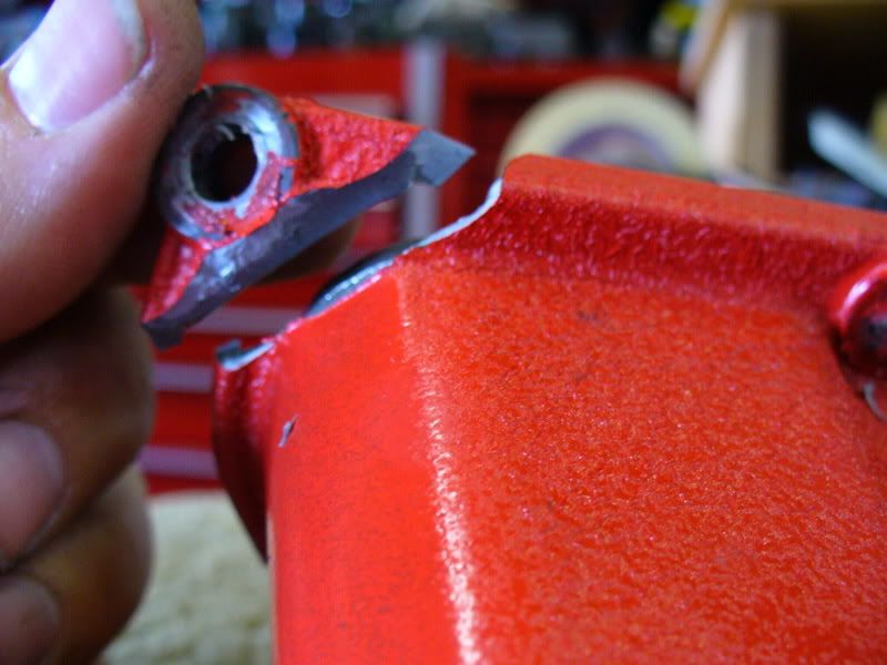

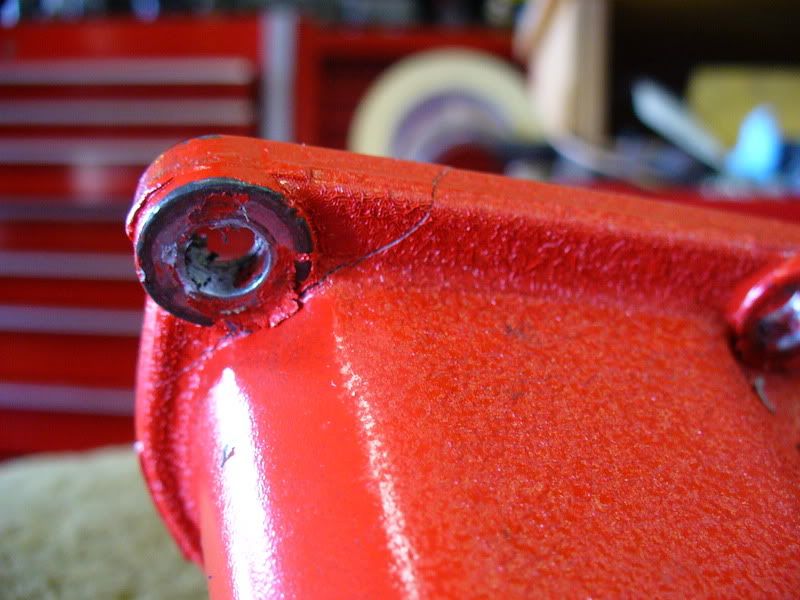

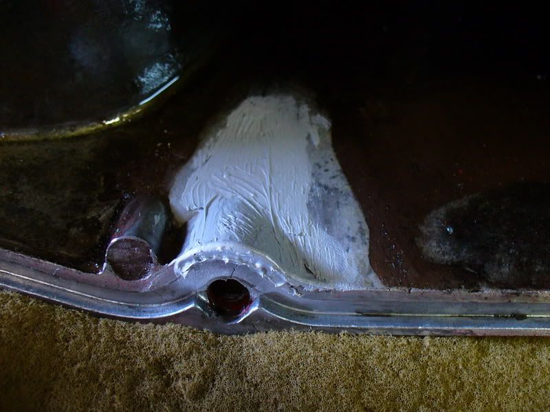

nah, it won't be done. i've had another uh.. setback. the pan extension bolts were still leaking, so i got it on the hoist this morning so i could take the stupid thing off and find out what's going on. well.... it's cracked. no biggie, right? right, just silicone it up like so...
then install. well, no. not when the corner decides that it wishes to live it's own life seperate from the already extended family...
