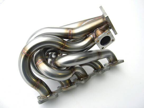

So, we have set Fridays and then Saturday mornings as the "URQ days" to get a push on the process. "doing it on our spare time" has not made a car run in 2 years, so we are just going to knock it out.
We worked on the front end today and turbo/downpipe.
First the front end. I want more front end room, plus I want more airflow . My car was a little tired from a minor previous owner fender bender. I ordered a Group 4 front bumper, a sport quattro front grill and some SQ head lights. The end goal is something like this.
I'll post more on that tomorrow, but we started cutting and modifying the wider SQ grill today to make it happen. ONce that is in place, I'll set the buckets for the lights with frames, then weld them in.
Next was a header and downpipe. This will allow us to make the heat exchangers, oil/water lines, exhaust, intake/filter, and also situate the oil filter/cooler.
Turbo is EFR 9174. I decided to make the header with an external gate as I want to run the larger 1.05 and 1.45AR housings(shown), and they are not available IWG. I really want to be able to run the 7163 without a spool valve at road race events, so I'll just need a different downpipe for both turbos. No big deal really. The 9174 on a spool valve on a 2.2L is a lot of fun, though it is too much compressor at a .92 A/R with the valve closed. This makes it surge pretty bad. You can drive around it, but I think the 1.05 will be in the sweet spot, and 1.45 will be massive 850whp fun with full boost ~4400-8500 on the valve. See with BW turbos, the scroll ratio is 65% when closed, so a 1.45 will act like a .94AR and a 1.05 will act like a .68AR. I think there is a chance the 1.05 won't surge, as well. but a .92 at .59AR was too much on the Mule.
Tons more plays into surge, such as low end VE, which the 07k absolutely destroys the 2.2L on an aggressive cam, so it may just get away with .92 on a valve anyway. Only way to find out is try. Matchbot helps, but it is too close to the surge line to make a definitive call.
Hope to finalize the endcaps for the radiator tomorrow so I can get them cutting on the CNC machine, then order an intercooler core for next friday.

I'm guessing with the big turbos you're not going to be using the small dia header right? What did you figure it was good for, ~600 whp or something?

There are 4g63s making 800whp on 1.25" schedule 10 manifold headers. I think 1.5" is close to overkill in all mortal situations on a 5 cylinder. Probably will offer a small diameter ur20vt header this soring as well

Any plans to offer a long radius bend manifold similar to a Peter G. manifold?

What are the performance benefits of a long runner vs short runner header? I assume it is analagous to long vs short ram intakes?

Long tubes typically just allow for less harsh bends that kill velocity and flow. The downside is they typically don't package anywhere, and the added runner volume makes them have later powerbands. They do theoretically make for more turbine efficiency though. IMO, it isn't enough gain to rationalize on 99% of the builds.
