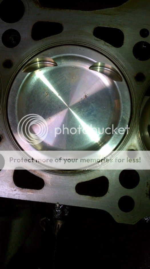

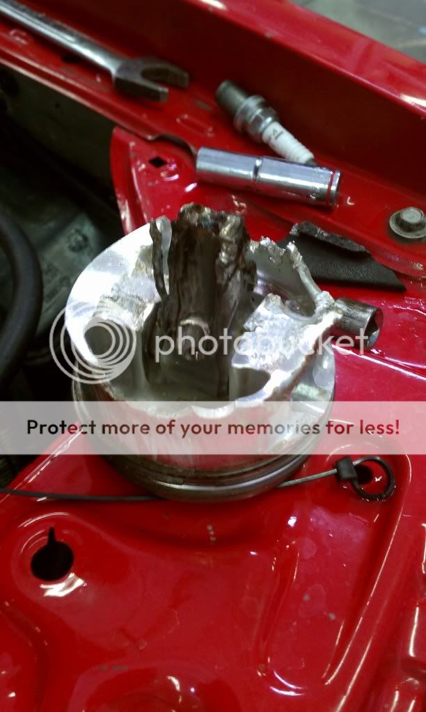

End of an era! Turns out skimping on ARP625 age hardened fasteners was a bad call. I had wanted them when I built the motor, but they were back ordered. Problem with this motor(well not really a problem) is that with the hta3582r on e85, you can run a ton of boost at relatively low rpm. My only regret was not getting this thing on the dyno. I drove the car with 540wtq at 35psi on the 2.2L, and the car was just rediculous at torque peak on the 2.6L at 42psi. If I had to guess, I would bet it was making close to 700wtq and mid to high 600s ATW. Probably torque peak at around 4600 and peak power at around 6200 with boost dropping off at around 7500 to around 550whp. All speculation.
I had sorted through some triggering issues that were plaguing high boost, and that meant I could turn up the boost a little more. I giggled the whole way home last night at 42psi, as it was enough torque to rip tires loose at 90mph in 3rd gear. This morning on my way to the shop, I got on it in 4th and just as the needle hit 42psi, hell broke loose. Windowed both sides of the blocks and scattered them on the I-215. Like Sean said, better there than at Spring Mountain in April. You don't make friends at the track dumping 4 quarts on the track.
Oh well, no sense in crying over milk on the floor. Rest of hte motor looks pretty good. Even the crank looks pretty good, including the rod that lost the bolt. The rest of the rod is still in the sump, but you can see the bolt sheared right below the 12 point head. No bluing or signs of oiling issues. No signs of detonation anywhere. The cap looks like it just came off fairly clean and then the capless rod just beat around windowing the block. The head actually was saved by a fortunate event. The valves were bent and protected the piston from beating up against the head. THey all look like this with a squirt of carb cleaner and a wipe! Looked like a well tuned engine overall!!
