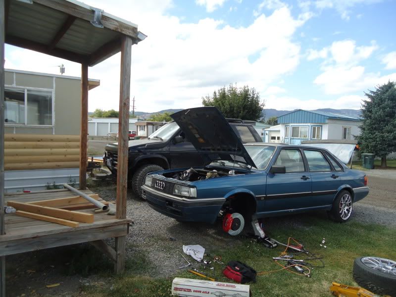

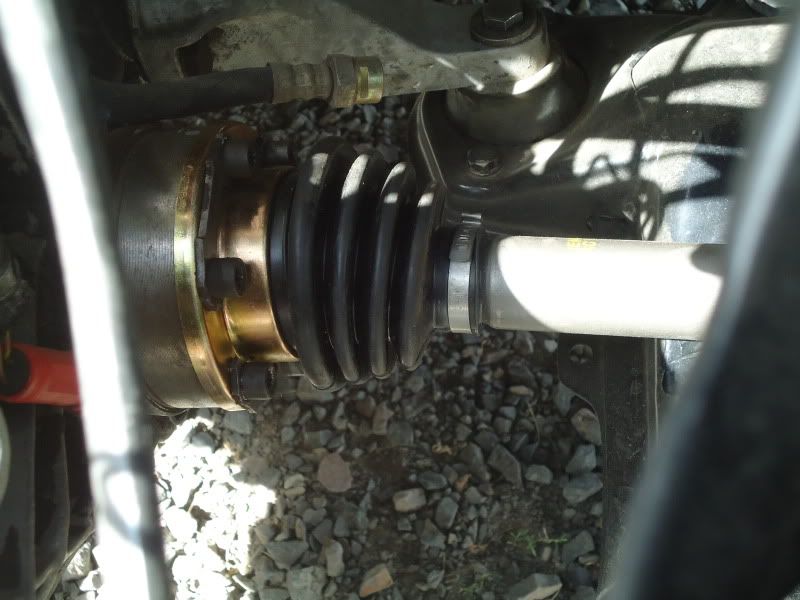

Re: Ben's AAN 4kq - Working on the front brakes & suspension
40v4kq wrote:Please tell me you have the cv's in and torqued.

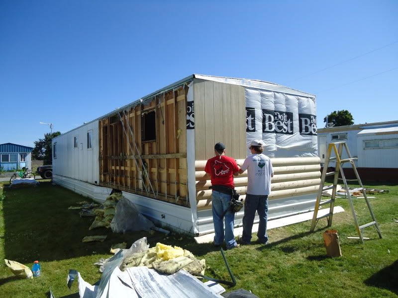

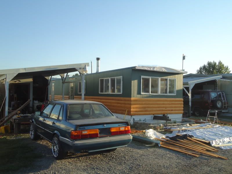

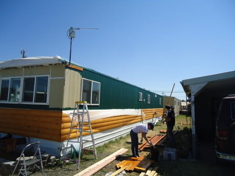

Another reason why Audi progress has been a tad slow is I have been working on residing/insulating my place, I thought I would just share a bit of it
I have too many projects for my own good. :bashtard:
Re: Ben's AAN 4kq - Taking stock
Nice, siding looks great
You left the fuel door on pappy open. LOL

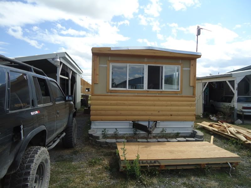

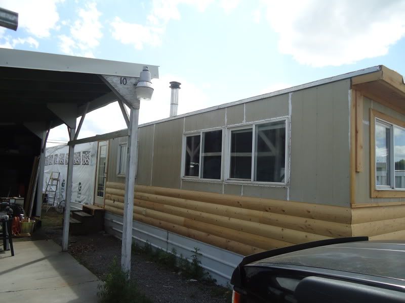

Didn't get much done to the Audi this weekend, but I did make great progress to my place! I think it's turning out really really nice for a freakin single-wide!
jcarrick
Looking good Ben! Good choice on siding
Nice work there Ben. Home is a little more important than the 4kq, barely, but it is. I sent one of my hero HD's up to Derek so you guys can "document" your trip to battleborn. Wish I could make it this year since you guys are going, but there is always next year.
EDIT: Did you install new cv shafts or did you throw on some new boots? Either way, it's another step in the rigth direction. Keep it up.

I am pretty stoked about how the place is turning out. A few more days and it should be all sorted out, then I can really lay down some good quality time on the Audi. Oh and just on a side not I scored a 2nd job mechanicing at a local shop, so now I will be doing pizza at night and cars in the morning. HOPEFULLY I will have some decent funds to throw at the Audi in short order.
The 4k got some new reman shafts. So they should be great till I break them.
40v4kq wrote:Nice work there Ben. Home is a little more important than the 4kq, barely, but it is. I sent one of my hero HD's up to Derek so you guys can "document" your trip to battleborn. Wish I could make it this year since you guys are going, but there is always next year.
