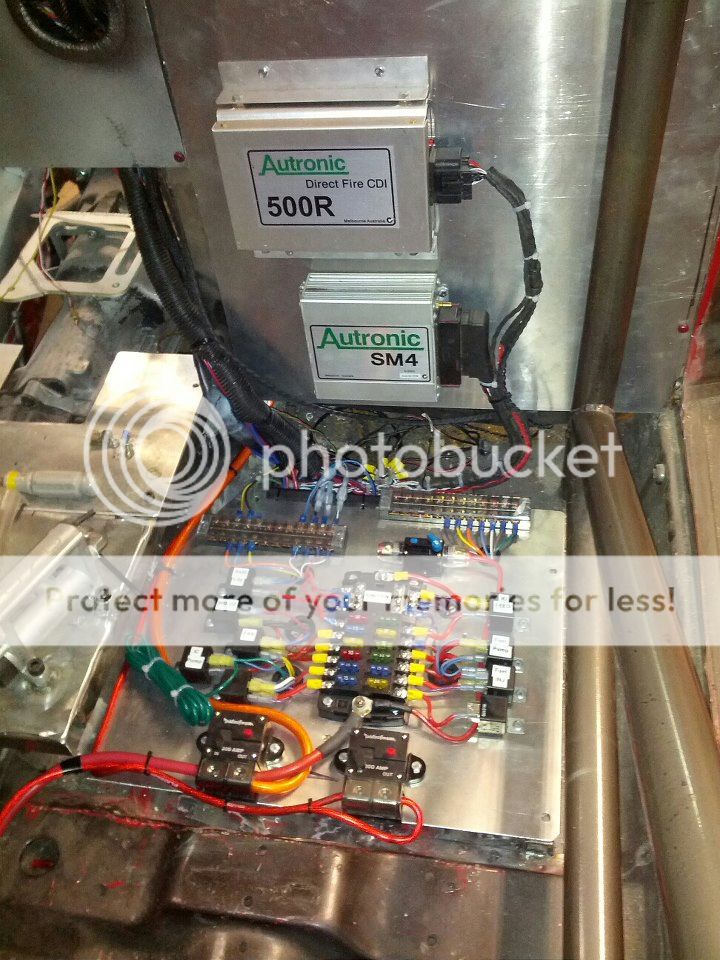

did a lil wiring.... slowly moving along with what i can when i can ;)

aaaaand, figured out the "no-ignition to ECU" i was having a problem with. just because, i turned on some power and was testing switches and relays. and didnt have ECU ignition. so i had to find it naturally.
one thing i finally did was delete the COP wiring. and apparently the ignition lead to the ecu went out to the COP harness and looped back LOL. took me about 30 minutes of troubleshooting, looking at the diagram, testing wires, and stuff. it finally clicked that i deleted that harness, and it must have been in there so i looked at the harness i cut out and sure enough, there it was. right past where i isolated the wiring from the harness, it was looped together. so i made it like it was, and VIOLA i have ecu ignition, which also allows the fuel relays to be triggered.
