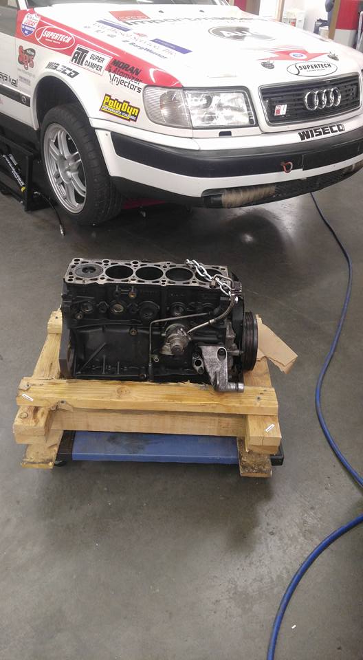

The block has shipped! Thanks Hank.
Apparently this thing weighs 50lbs more than an 07k. Ouch! Hopefully that means its stronger :)

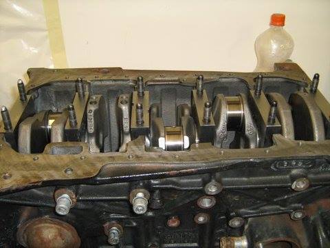

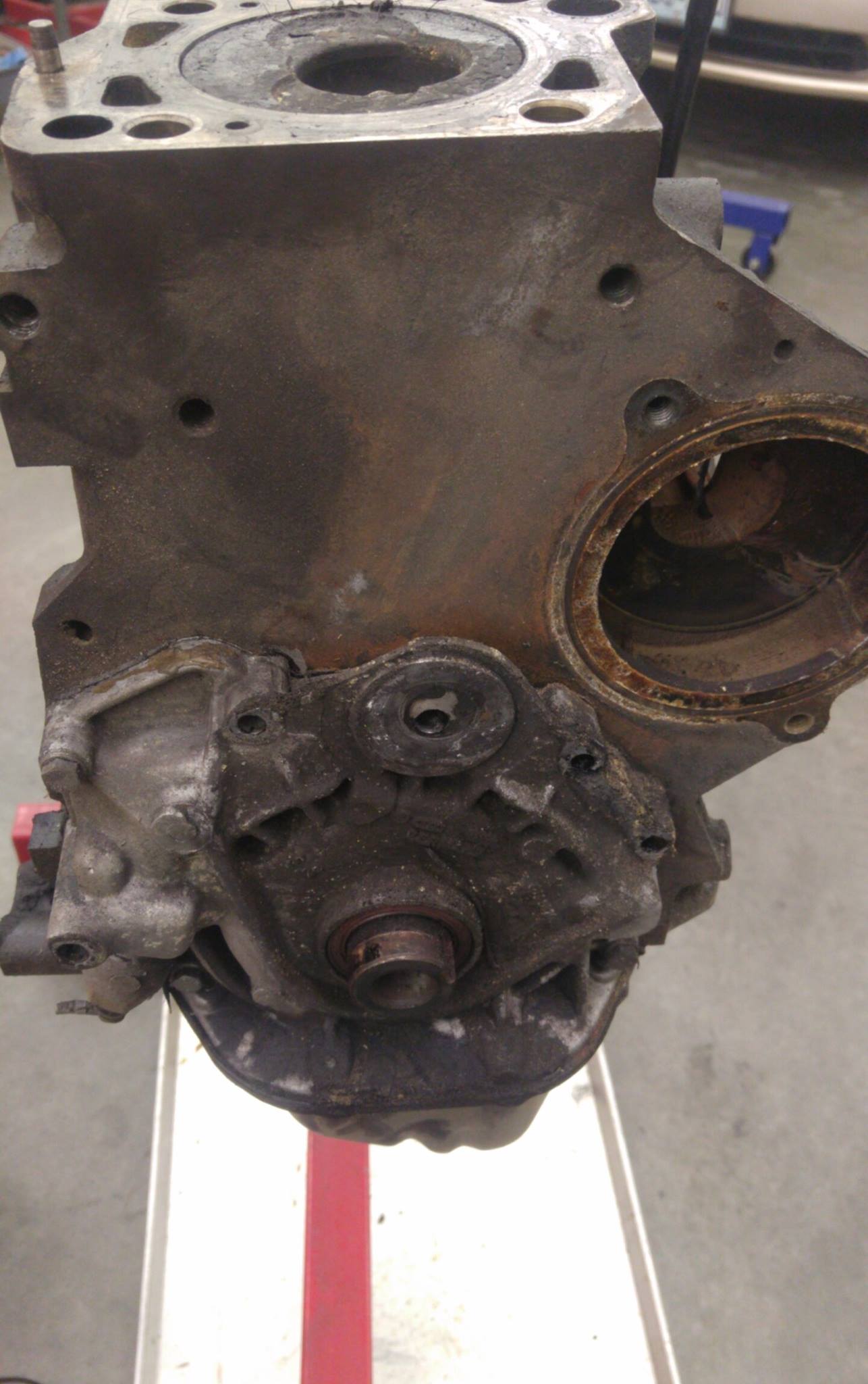

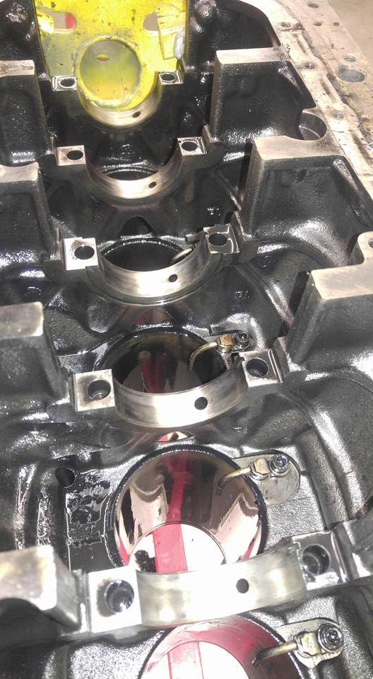

But here are some pictures finally.
Here's the block just after arriving at Jeff's
revver block at jeffs.jpg (65.47 KiB) Viewed 63080 times
Before clean-up
revver block clean up.jpg (86.01 KiB) Viewed 63080 times

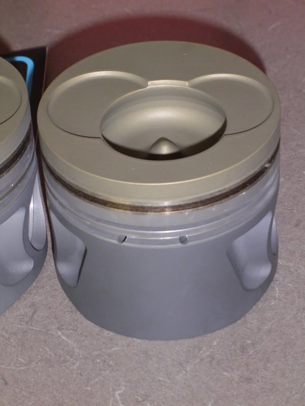

Disassembly
revver disassembly.jpg (187.3 KiB) Viewed 63080 times
Re: Chris' 200 20v Sedan - The Revver - Turbo Found
Something bad happened to that piston lol ^^^^

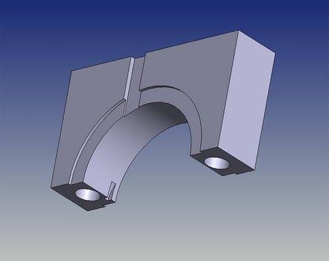

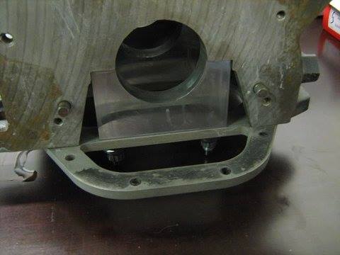

I've been talking to someone about making custom main caps for me which don't require line boring, only line honing. The reason is because the cost for line boring is significant. Having caps made with reference to the stock caps and measurements from the block they go in may offset that cost. The other option is to treat the stock caps, but I'm not very keen on that idea compared to a beefier cap made from a high performance alloy.
revver main cap design.jpg (12.15 KiB) Viewed 63078 times
revver main caps 2.jpg (20.4 KiB) Viewed 63078 times
revver main caps.jpg (27.73 KiB) Viewed 63078 times

I've been thinking of those billet main caps as well lately, but are they any good if one tends to stay under 8000rpm?
Oh wow! That's crazy, I had no idea.
Juizer, it's not worth it at all for less than 1000hp. Even then, it's debatable. I just like to overbuild in this situation.

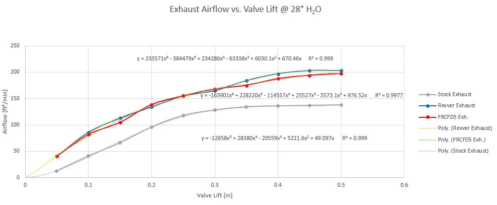

Also, I just realized I never posted the full flow data for this head. From Jeff:
"Valve opening……Stock/Revver Intake……Stock/Revver Exhaust
.050……………………………16/48…………………………13/41
.100……………………………49/89…………………………41/86
.150……………………………85/128………………………66/113
.200……………………………115/166……………………96/134
.250……………………………149/196……………………118/155
.300……………………………171/223……………………128/165
.350……………………………186/244……………………134/184
.400……………………………192/259……………………136/197
.450……………………………198/268……………………137/203
.500……………………………???/274………………………138/203
As you can see the exhaust is mostly done at .400, this is normal.
The really great thing on this head is that it has zero exhaust port turbulence between 250 and 350 lift . Most of these will have turbulence that bounces the manometer so much you cant take an accurate reading at .300.
I even cranked the bench up to 42 inches (from the standard 28) and still no break up of flow within the port! This really important because its right in the middle of valve travel and a point that get passed going both directions.
If you port these exhausts with the 29.5mm valve for the biggest number at full lift they will always have mid lift turbulence.
It will be a great head for supporting flow at hi boost / hi rpm and should hit the turbo a lot harder as well."

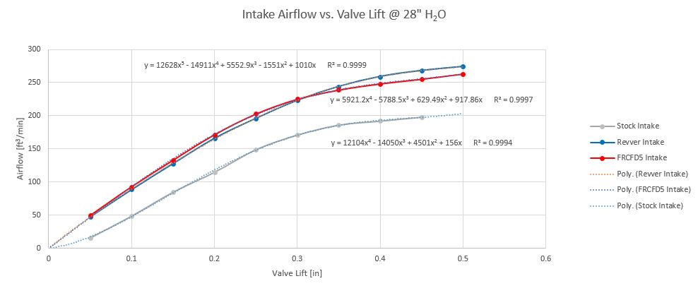

And because I'm a nerd, here are plots of my head vs stock vs another member here FRCFD5.
Intake Head Flow.JPG (45 KiB) Viewed 62973 times
Exhaust Head Flow.JPG (44.93 KiB) Viewed 62973 times
Some interesting numbers related to this. Total flow under the curve (not in CFM... I still have to wrap my brain around this lol)
RevverIntakeIntegral = 88.0807
FRCFD5IntakeIntegral = 87.5234
StockIntakeIntegral = 63.1604
RevverExhaustIntegral = 69.1274
FRCFD5ExhaustIntegral = 67.4617
StockExhaustIntegral = 46.8809
After thinking about it for bit, I see that the unit for these numbers is [in*ft^3/min] which is rather meaningless, especially when taken out of context. It is best to just use it as an arbitrary number to compare with. The best way to do that would be to compare to stock as a percentage. As a total over the valve lift profile, the revver has an improvement of 140% on the intake side and 148% on the exhaust side.

Very nice...some good info there...
As far as the area under the curve, if you have the cam profiles between stock and whatever you're running, plotting the flow versus an engine cycle would tell a much more meaningful story. Increased lift and duration will only add to the improvement shown from the valve lift data and be a little more indicative of actual engine flow.
