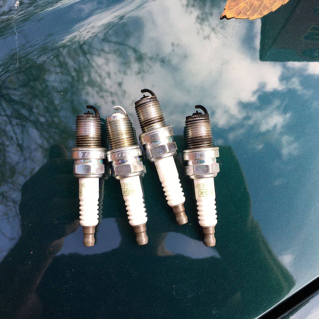

Found the source of what I suspected was a misfire today. the car hasn't run super smoothly ever so I didn't know if it was a tune issue or a misfire somewhere. After noticing a pulsing in the exhaust, I dug into what I expected was a non-firing injector or coil.
Pulled the plugs on the 1-4 side and voila! obviously not firing on #3
So I moved coils, spark plugs, injectors etc. until I proved that all the pieces worked in different places. Then I swapped the POS units and the misfire moved to coil #4 - I have an extra ABZ harness downstairs so I swapped the POS out and all is better!

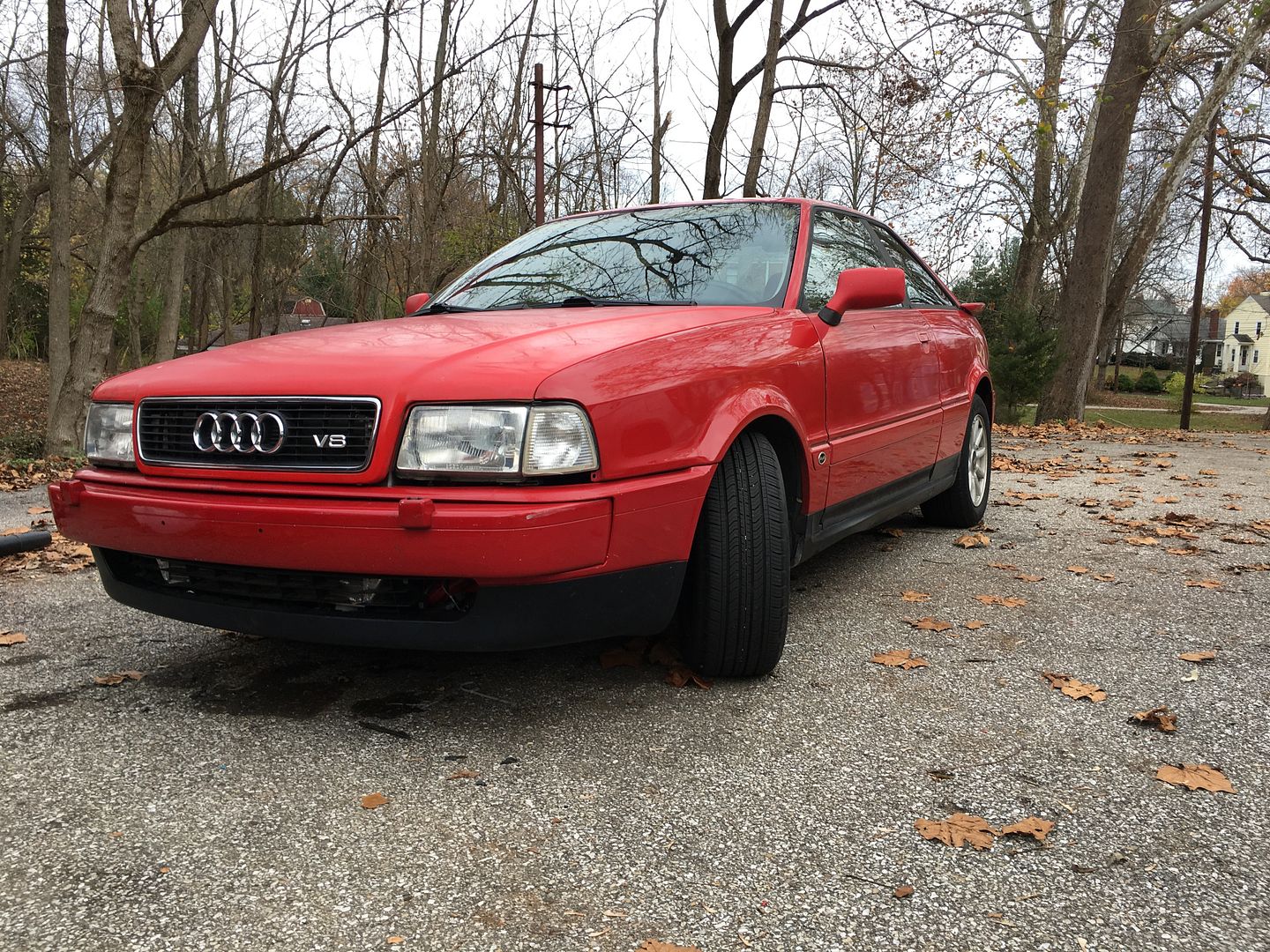

Re: Ben's V8 Coupe Quattro - First Drive!
I spent the last couple weeks getting the last couple things finalized.
Since the car hadn't moved on its own for so long, I decided that I should replace the entire braking system.
Eventually I'll switch to a big brake kit, but for now I bought a set of Stop-tech slotted rotors and some decent pads. When I do the BBK I'll move the setup over to the cabriolet but for now I know that everything is new and working. Good thing too, one of the front caliper carriers had one of the bolts missing. Conveniently a VW dealer nearby had one.
Same goes for the suspension. I will eventually look at coilover options but for now I just bought replacement struts since I suspected they were blown. I was right. totally blown.
Today, I got all the lights working. had to sand the connections on the driver's side tail-light panel to get it to work. Many years of water leaking through that tail light corroded the whole thing.
So today, with a repaired suspension and newly refreshed brakes, I took a real drive. I am planning to go to the DMV tomorrow morning and get plates so I wanted to make sure I'd make it.
I was still really gentle for the most part, I want to make sure I can stop and that nothing is going to fall off the car
Overall, I'm still trying to get used to it. The power is pretty intense but I'm being extra careful, especially while the car isn't licensed.
I'm attaching a log that I made of that drive. Overall the car runs reasonably well but I have a bunch of stuff to iron out...
I go really rich when I take my foot off the gas. What's the best way to deal with this?
I have no tachometer on the cluster - however the cluster could be the culprit here. I'm not sure.
I need to figure out all the sensors for the autocheck. I get beeps and lights for a bunch of things. Anyone with a cq want to point me in the direction of the oil pressure sensors on the harness?
I get the beep from the oil pressure on the autocheck when I reach 2500 rpm or so - which would lead me to believe that I DO have a tach signal and maybe the cluster is bad. Isn't that that beep tied to a certain RPM?
Lastly, I still have the issue with the clutch pedal being so low. I don't feel like this is a real problem since I'm not grinding gears or moving when the pedal is all the way down, just drives different than I'm used to.
I'd LOVE some feedback on the log file. Once I get the plates tomorrow, I'l try to put a video together!

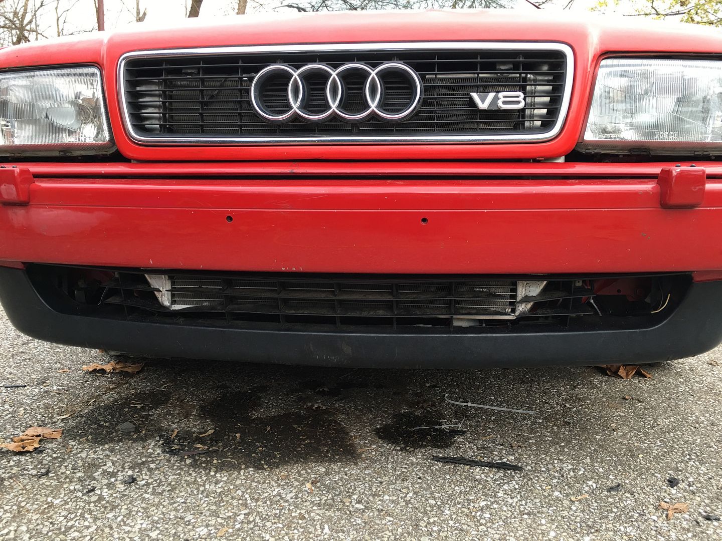

Lastly, I finally got the bumper cover back on. with the size of the radiator and how far forward I put it, I had to to some hacking to get the cover on...
I need to come up with a solution for the under headlight trims. The width of the radiator meant cutting the inside tabs off the headlights so I need to find another way to secure the trims.
