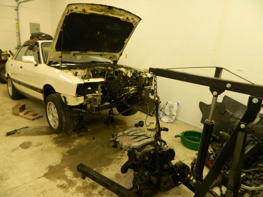

look, I actually did something on this project this evening and pulled the 7a.

First test fit in the bay
Appears that a filter is not going to fit here. Is there something that can mount where the filter was and make it remote? Also, how the hell am i going to get this nasty bay clean in the middle of winter....Not sure yet, maybe 10 cases of brake cleaner?

Can't tell by the picture, but would you be able to use a different engine mount (Ie mustang mounts that are rectangular) or is the frame itself going to interfere? I'm sure you could come up with a flange to have a remote filter, but yeah..... let's avoid that ha.
Re: Lowest HP swap ever: TDI into 90q
im really not sure. The oil pan is riding on the cross member, and it looks like some notching will have to be done to one or both. So the way the engine is sitting in the bay right now is not its final spot, i couldn't get the bellhousing bolts lined up with the oil pan issue. Just guessing though, the actual welded on metal mount arm would interfere with a filter...i think. Need to check more closely before I do anything drastic. Kind of confused about the pan issues since I don't remember reading about others encountering this problem. Its just steel and i have a cutoff wheel and welder, so not a real problem. I just ran out of motivation for today. I think it will simpler when I look at it with a fresh mind later.

dana wrote:im really not sure. The oil pan is riding on the cross member, and it looks like some notching will have to be done to one or both. So the way the engine is sitting in the bay right now is not its final spot, i couldn't get the bellhousing bolts lined up with the oil pan issue. Just guessing though, the actual welded on metal mount arm would interfere with a filter...i think. Need to check more closely before I do anything drastic. Kind of confused about the pan issues since I don't remember reading about others encountering this problem. Its just steel and i have a cutoff wheel and welder, so not a real problem. I just ran out of motivation for today. I think it will simpler when I look at it with a fresh mind later.
If you have hood clearance you could easily run a few hockey puck(or something not ghetto) as spacers to put the motor up off the cross member. I'm sure you'll figure it out, looks like there is more than a little wiggle room with that huge motor in there

If you're interested, I can modify my motor mounts to raise the engine. I modified them for an East Coast customer who had a VR6 turbo swap in a 4kq where the factory height would mean the motor hit the hood upon torque. He loves em so far....and no dents!

I think even with the trans angled as high as it can before it 'tops out' the pan still hits, so i think i will need to cut something. I think I am going to stick to the factory mounts of some sort if possible for vibration reasons. I think nice stiff mounts would make this thing rattle too much. 4 cylinder diesel isn't exactly the smoothest engine around.AngryTaco wrote:If you're interested, I can modify my motor mounts to raise the engine. I modified them for an East Coast customer who had a VR6 turbo swap in a 4kq where the factory height would mean the motor hit the hood upon torque. He loves em so far....and no dents!

Sweet trick I used on my mk2's was to use nylon washers and neoprene (Soft thick) rubber washers smushed down with hockey pucks. The vibration was non existent, as the little washers dampened everything very well

Why does everyone think I only offer one durameter loldana wrote:I think even with the trans angled as high as it can before it 'tops out' the pan still hits, so i think i will need to cut something. I think I am going to stick to the factory mounts of some sort if possible for vibration reasons. I think nice stiff mounts would make this thing rattle too much. 4 cylinder diesel isn't exactly the smoothest engine around.AngryTaco wrote:If you're interested, I can modify my motor mounts to raise the engine. I modified them for an East Coast customer who had a VR6 turbo swap in a 4kq where the factory height would mean the motor hit the hood upon torque. He loves em so far....and no dents!
I wouldnt mind doing a partial trade with you for that 7A oil pan too if you like
I do have softer than stock if you find those mounts are sufficient enough for ya
How much clearance do you need with the subframe? I wouldnt think it would be all that much

i dont think I need much clearance. Can probably make it up with the pan or the subframe. Subfame is probaby easier to mod. I sent an email to some of the other guys who have done this to see if i am missing something obvious. Maybe i can use a pan from a fwd 80.
