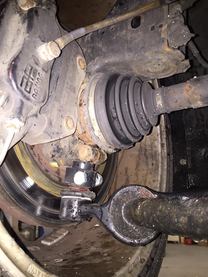

I would like to add a small piece to this puzzle that will noticeably improve bump steer. My friend Dave has been using them on his custom coilover car and highly recommends them to correct "roll center"
What does it do?... well these things extend the balljoint, and properly place the tie-rod back to their natural horizontal state. Popular among the VW crowd, the 19mm MK3 version fits our cars perfectly.
Attached is picture of his Avant at it's current height. It's Low!
BallJoint Xxxtenders
And this is how they fit....
Re: DIY Large Chassis Coilovers
I like those, don't want another alignment yet tho.
