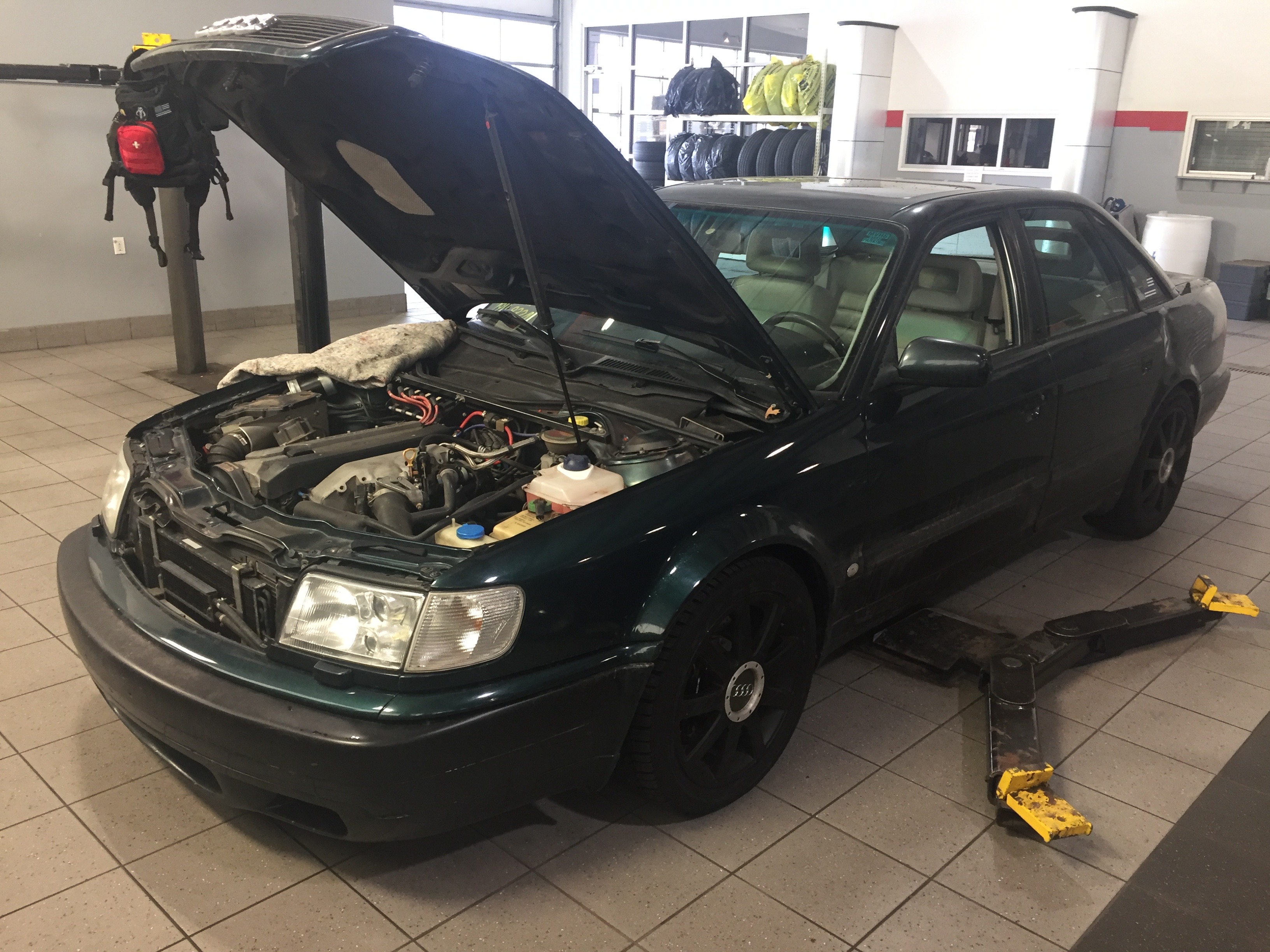

It’s getting closer to the weekend. I started soaking last night/this morning. The bottom nuts and studs are hard to get to but there is some space on the top half of the manifold that you can see the bottom nuts. Excited but also I little nervous. Don’t want to get half way and be without a part or anything. I am certain Edna I ordered everything I needed. Even ordered some new exhaust bolts for the down pipe to the cat just to be safe. I like to be able to see things and make sure I got everything so I have a few pageant printed off from ETKA with lots of writing to double check part numbers. Made things easier.

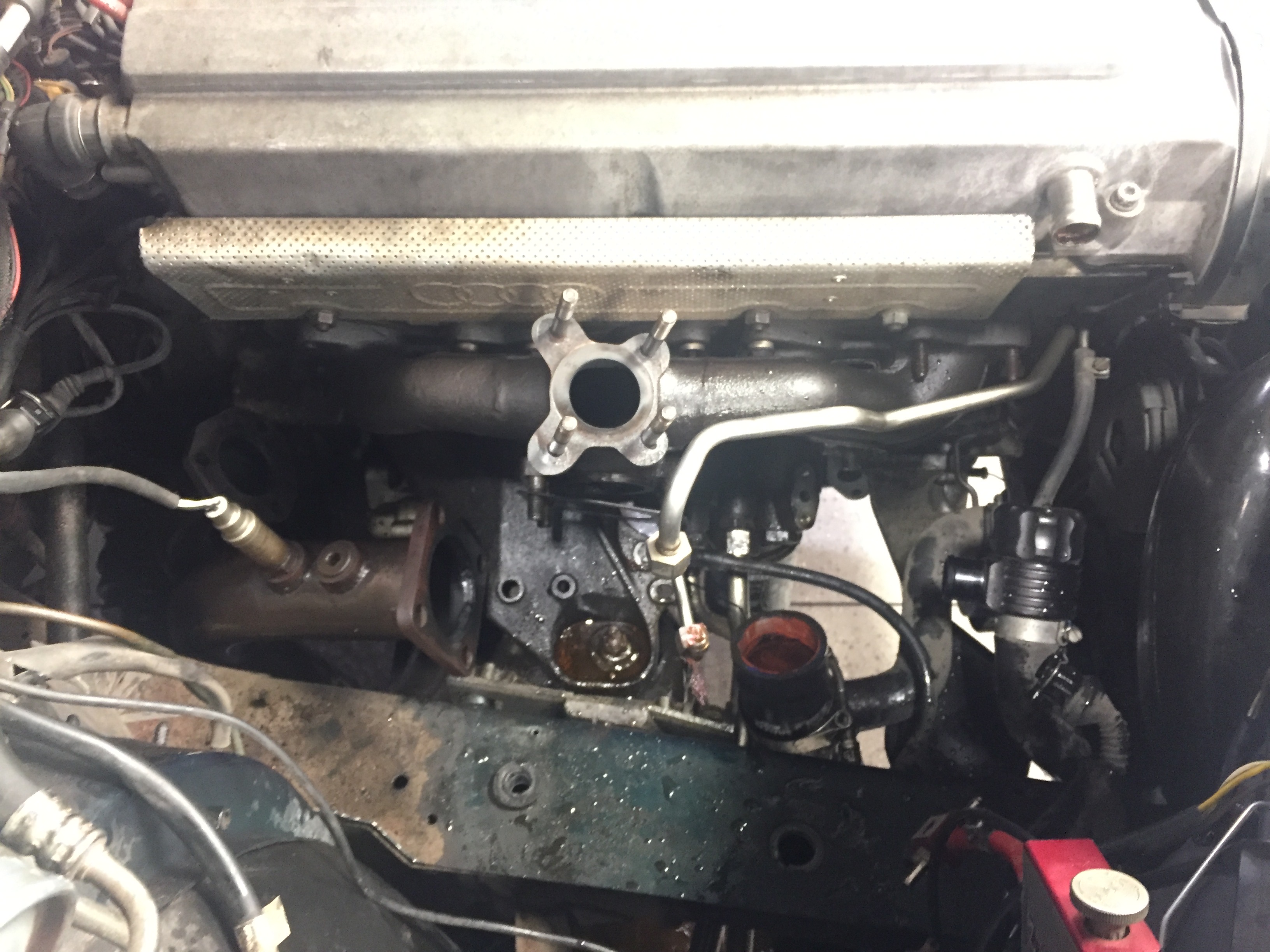

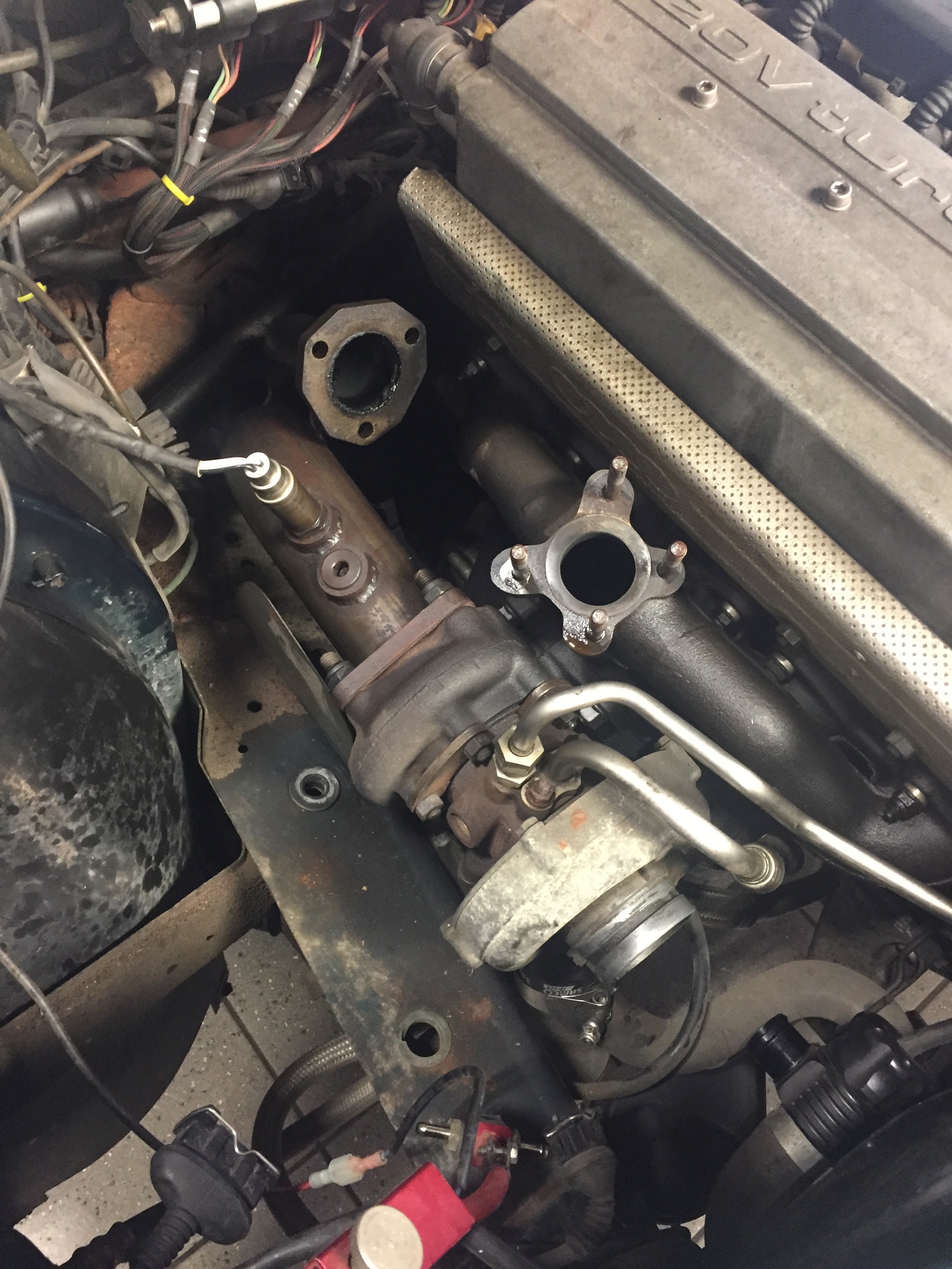

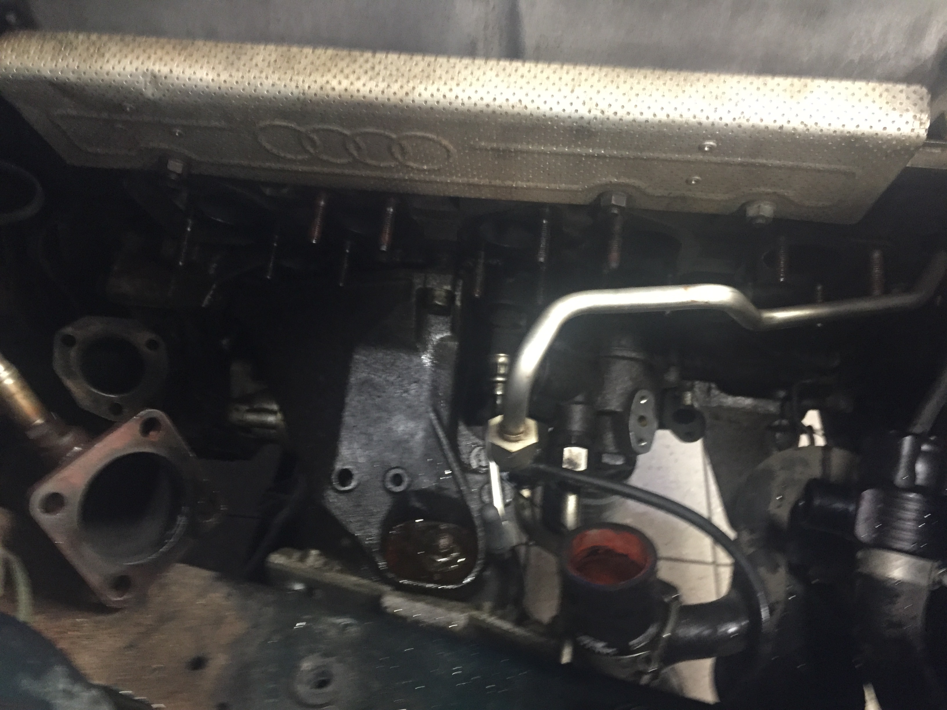

Well I did it! With a LOT of help from an Audi tech, but its in there. It wasn't as bad as thought it was going to be. It was pretty straight forward. I had soak everything a couples days in advanced and Im sure it helped a lot. There was only one broken stud but we think it was like that before we started the tear it down. A couple of the other nuts came off really easy, almost as if they weren't tight. There was one that I thought for sure it was going to break but it came right off which was nice. The tech was able to drill the remaining part of the stud out.
We removed the other studs after we installed the 4 short studs just to make sure we at least got those ones in. We then installed the new manifold but there was four studs on the tops that were to long and kept the manifold from sitting flush on the block so we ended up cutting those ones down as well. Everything fit after that and tightened up nicely.
Started her up and smoked for a bit burning off all the machining oil and the penetrating oil. No leaks that we could see or hear so all is good. I will check everything again in a week or so! I didn't end up using the "c" shaped wrenches or anything, just basic hand tools. But I did have the luxury of a lift.
I didn't have my motor mounts yet, so those will be going in when I get them in!
(Still haven't quite figured out the whole picture thing and why the first one is on last )

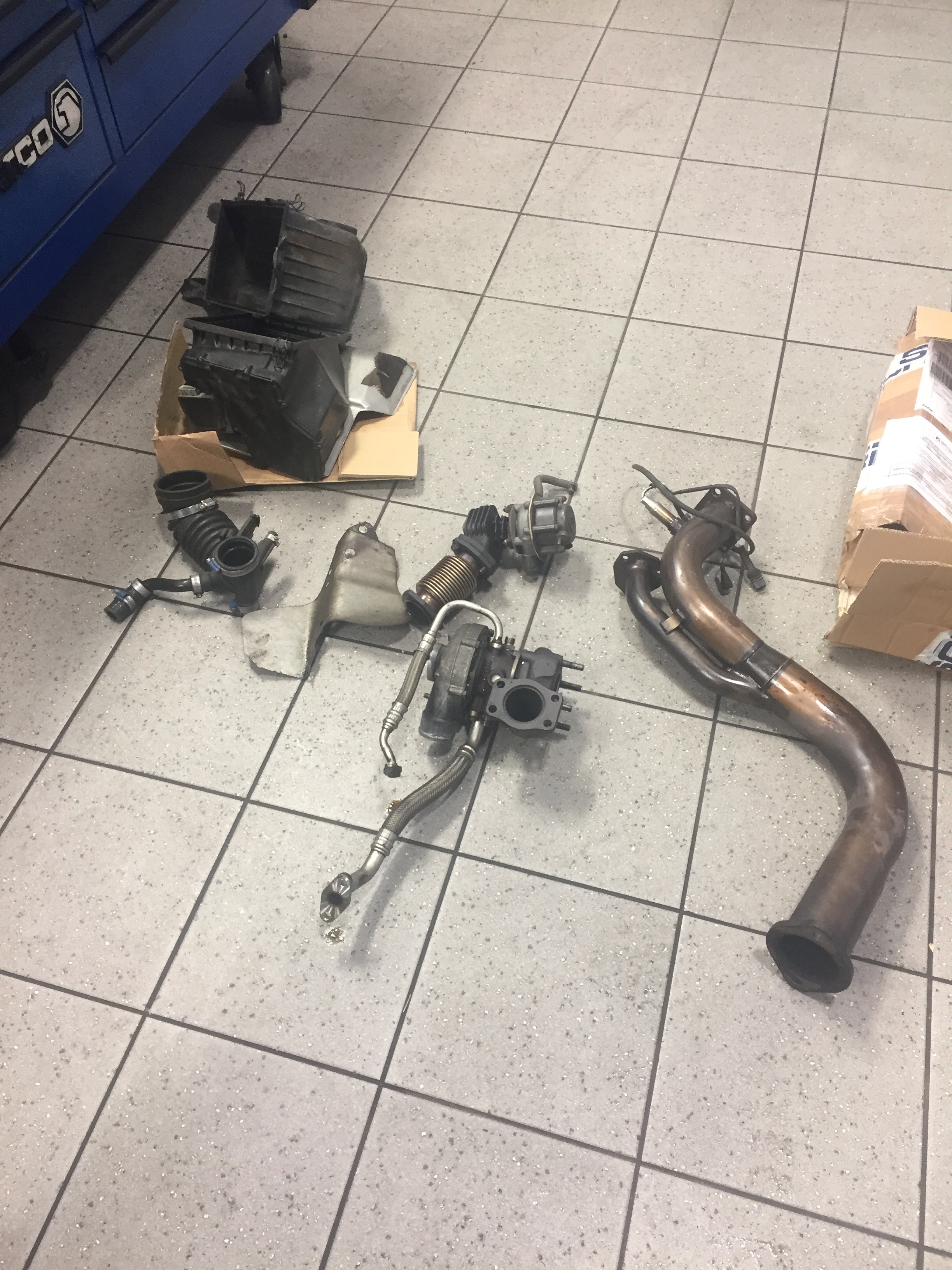

- The parts pile, ha
- IMG_7083.jpg (1.94 MiB) Viewed 68995 times

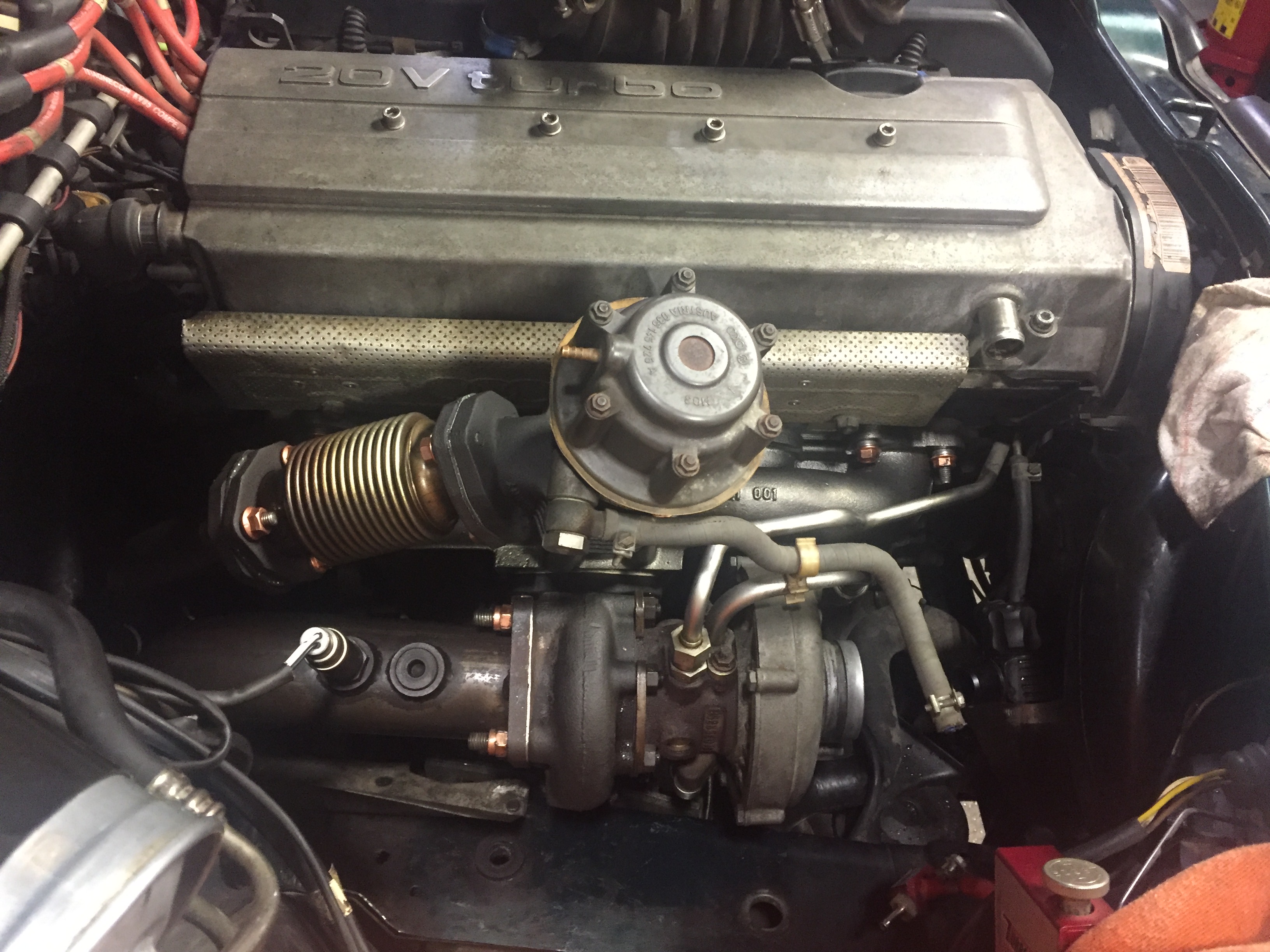

- Old mani off
- IMG_7078.jpg (1.14 MiB) Viewed 68995 times
- Turbo out
- IMG_7077.jpg (1.16 MiB) Viewed 68995 times
- Airbox and wastegate off!
- IMG_7074.jpg (1.47 MiB) Viewed 68995 times
- Step one
- IMG_7072.jpg (1.54 MiB) Viewed 68995 times

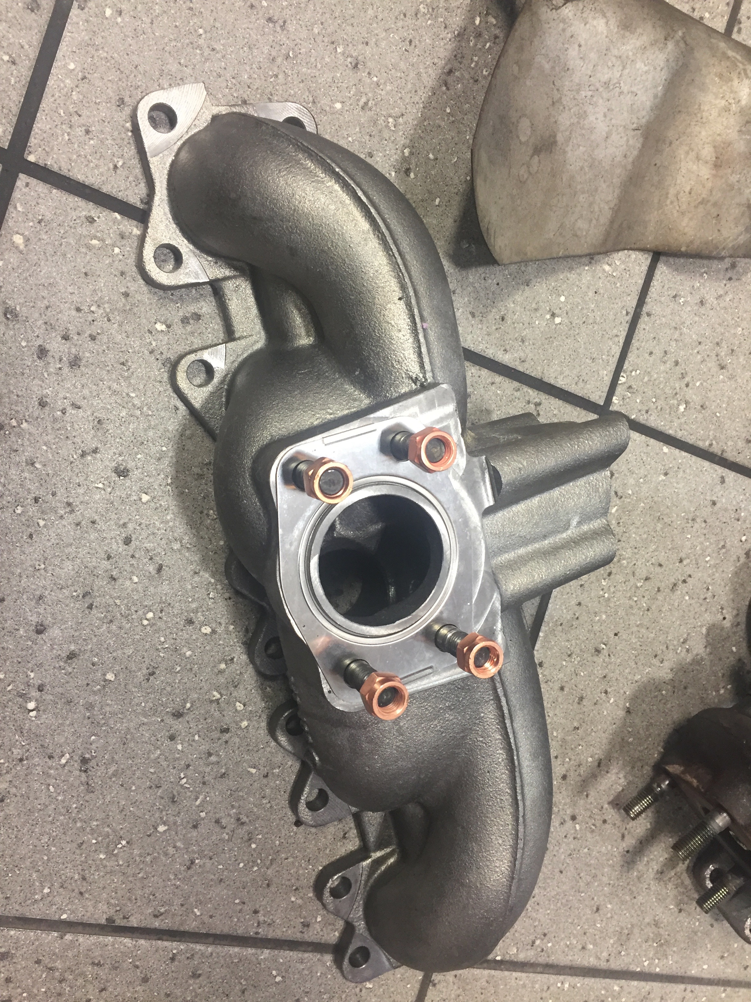

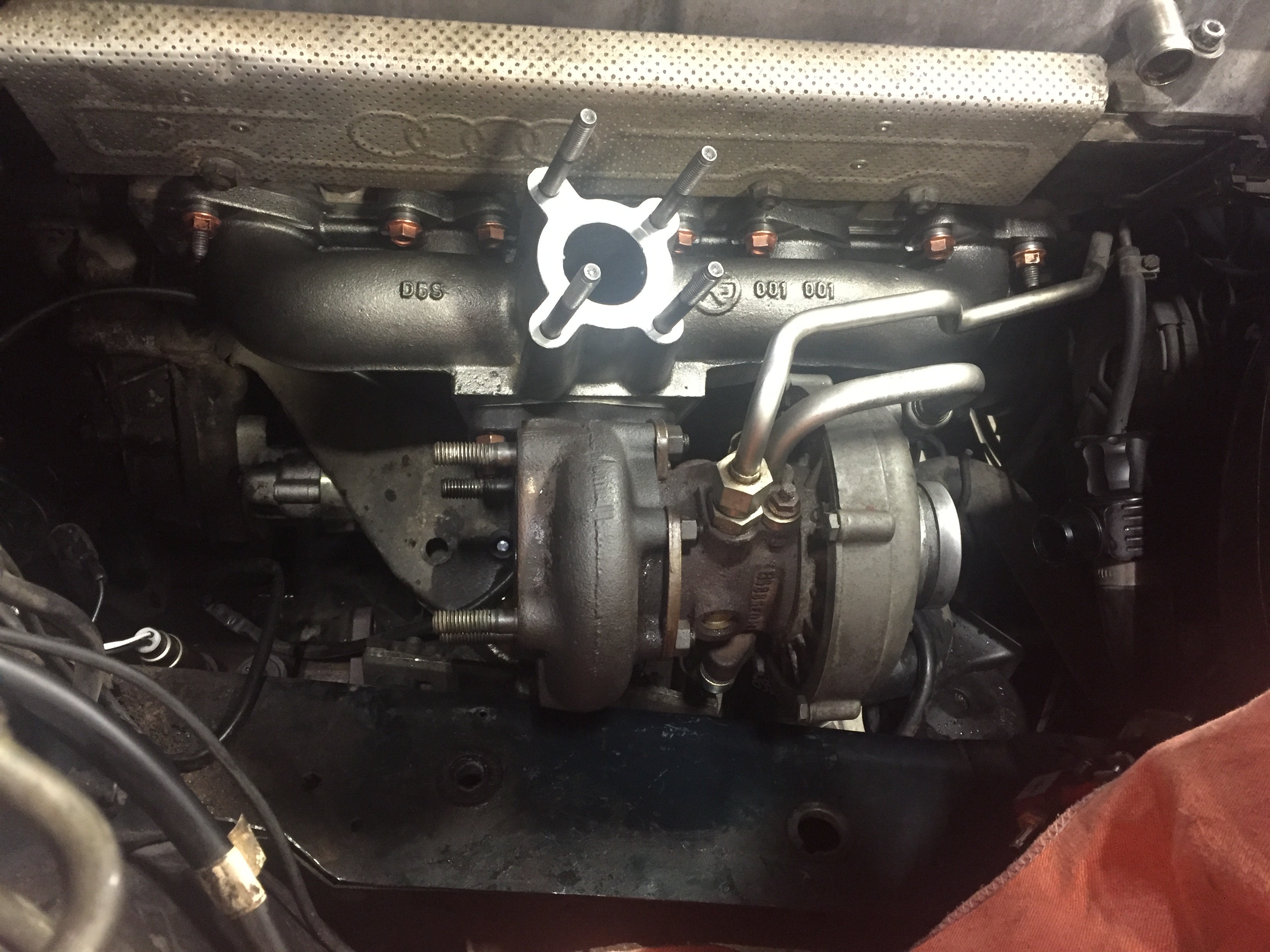

More pics
- Everything back with new hardware!
- IMG_7091.jpg (1.39 MiB) Viewed 68995 times
- Manifold and turbo on
- IMG_7089.jpg (1.32 MiB) Viewed 68995 times
- New mani and hardware
- IMG_7084.jpg (2.59 MiB) Viewed 68995 times
