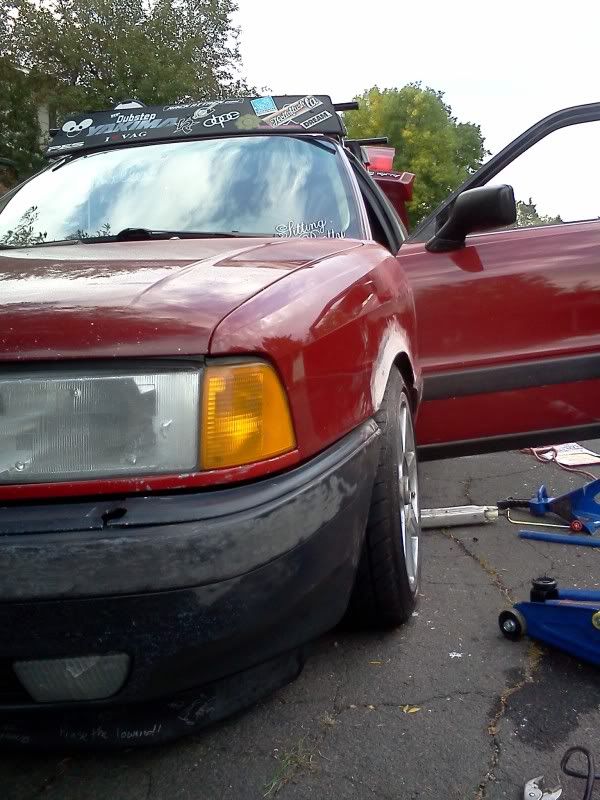

Can it be confirmed that the 215 on the red car never rubbed? my car is similar lowness.
It seems like i might want to go with 205 45 to start with. This dude had 205 45 on 16x8 with et20, cannot confirm if it rubbed or not, but it must have been very close.
Re: Wheel Opinion on My b3
I will confirm that that the tires never rubbed on Georges B3. I actually am running his old tires, as they were just sitting collecting dust. One thing is that both the ABT wheels and my competition wheels are both 7.5" wheels. They did rub on mine however, but I believe that was due to the struts being blown. After installing the bilsteins in the rear, no more rub.

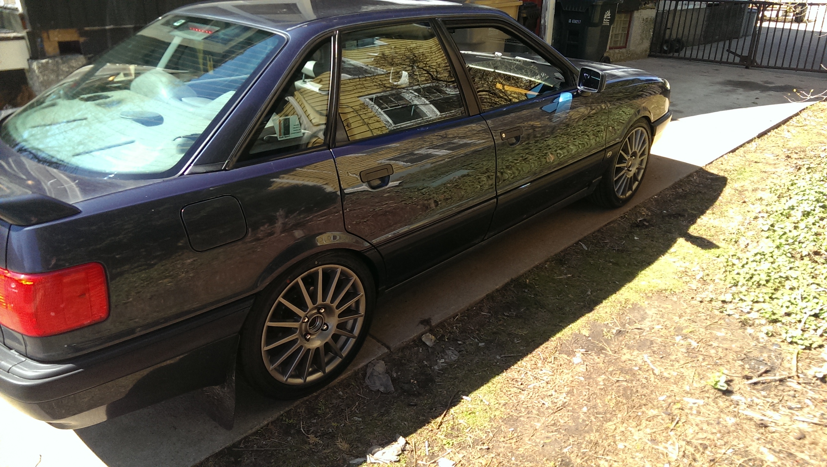

this is another shot of those 205 45 stretched on a 16x8. Not too bad, i wouldnt want more than that though. Again, this dude has 10mm more poke than I will have.
That shouldn't be too bad at all! I look forward to seeing how it turns out for you.
