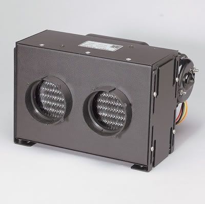

Also I am thinking about ordering or making something like this.
Anyone have input, advice , pics, or experience. Thanks in advance.
those exhaust pics are perfect.

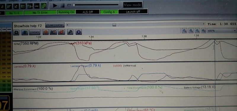

Re: My VEMS VRT o1e CQ..
Is wheel speed activated on your config by any chance?
