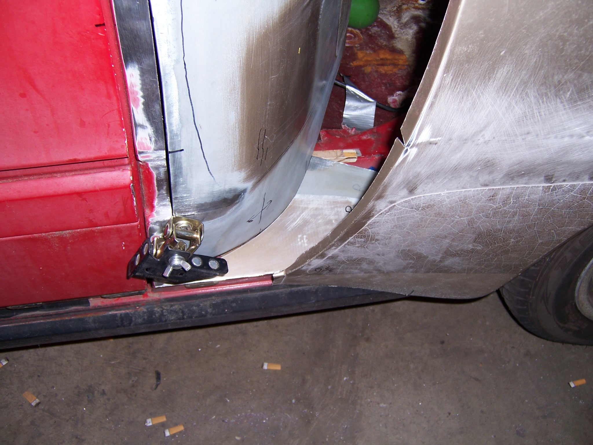

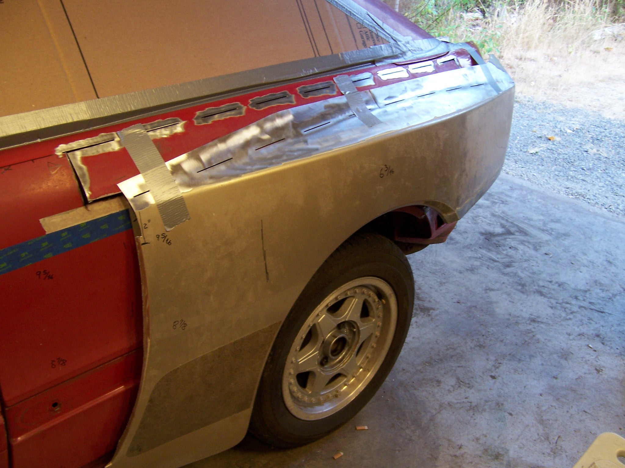

Few updates
Right side sectioned and weldet
audi wide build 043.jpg (451.43 KiB) Viewed 58005 times
Overhead shoot
audi wide build 046.jpg (595.29 KiB) Viewed 58005 times

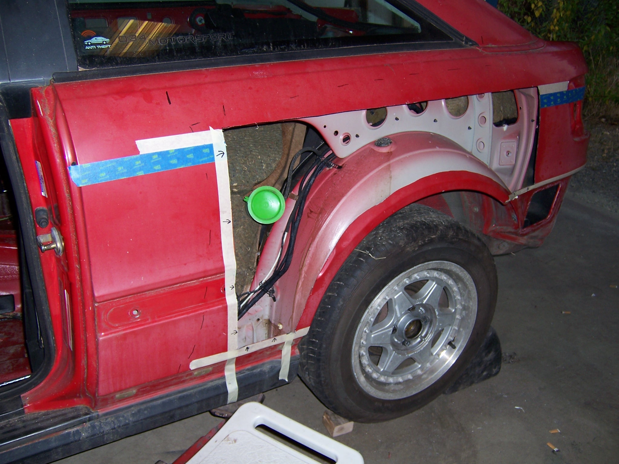

A little bit more hammering and some tweaks and i can start on the noses of the fenders. Once that is done the rear quaters will be next.
Then Rocker panels
Cheers
Mike

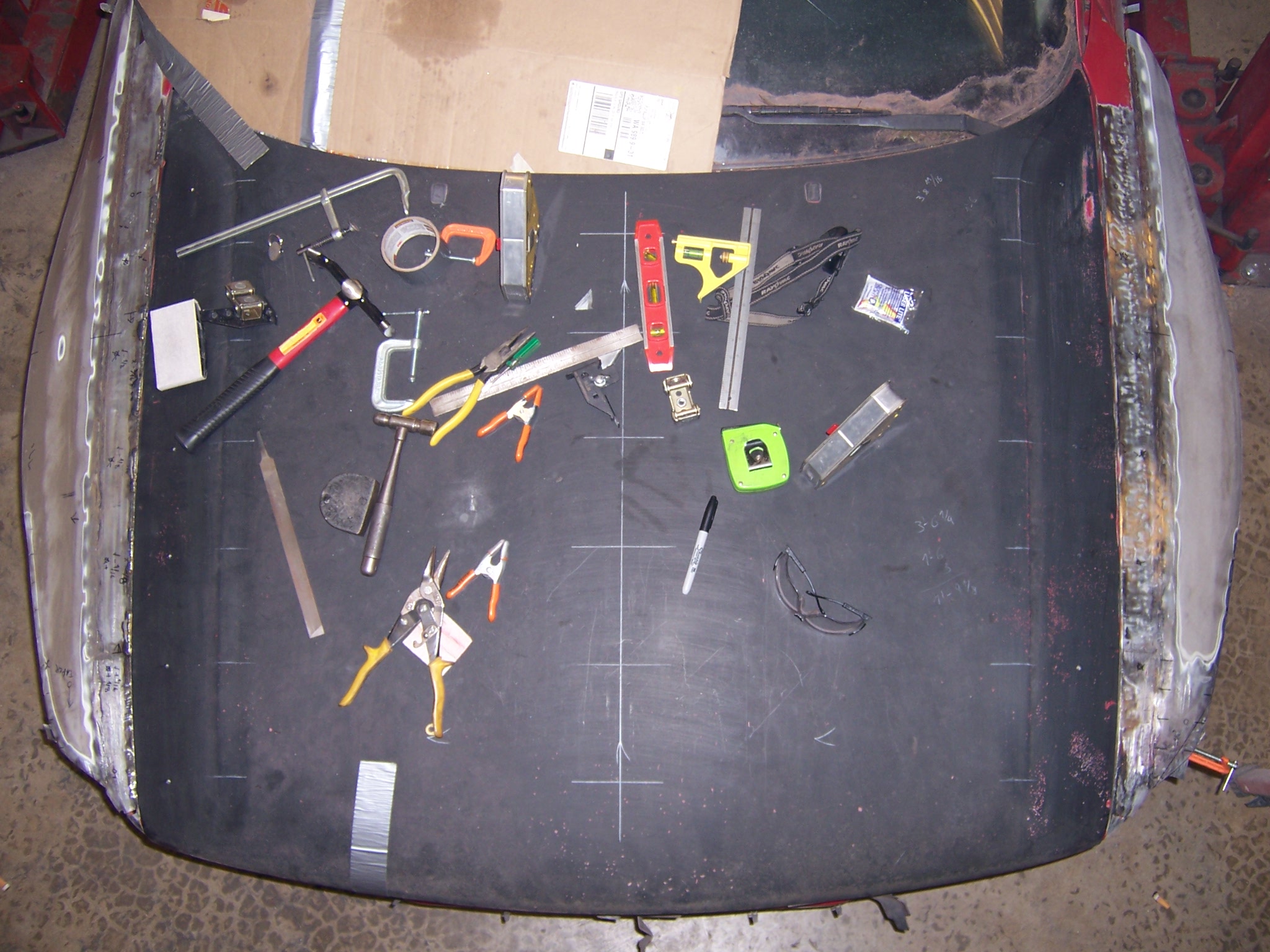

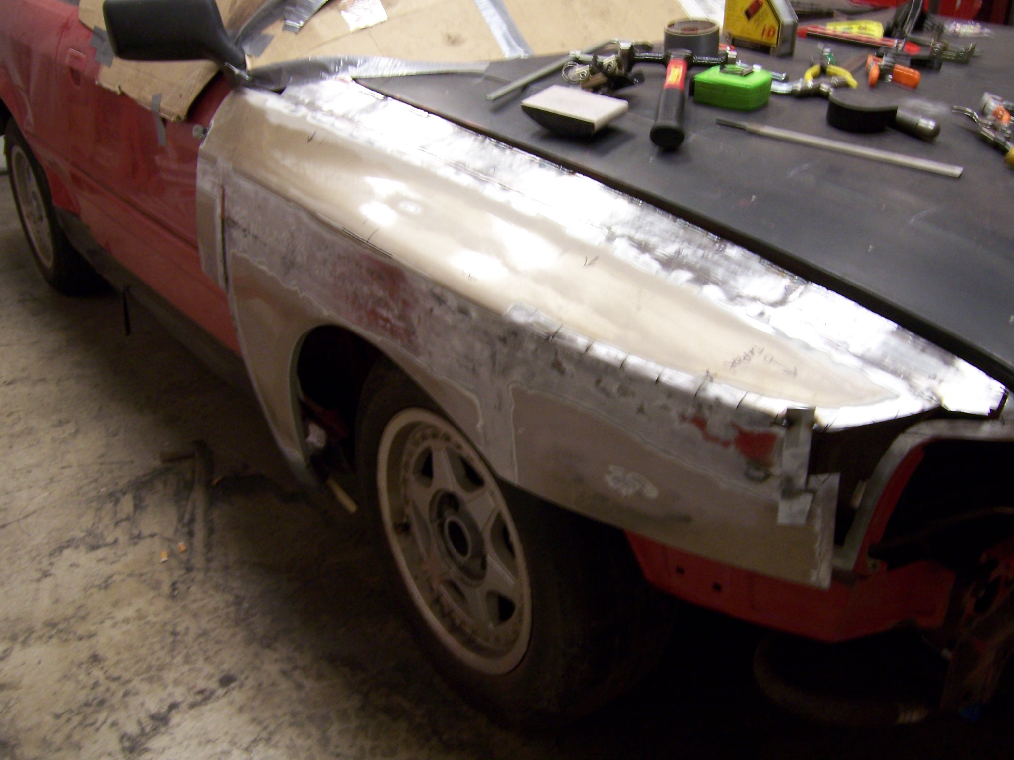

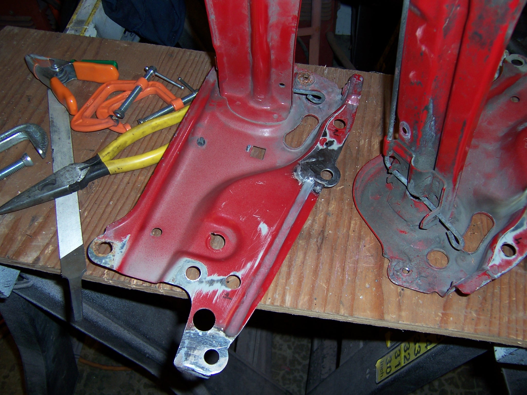

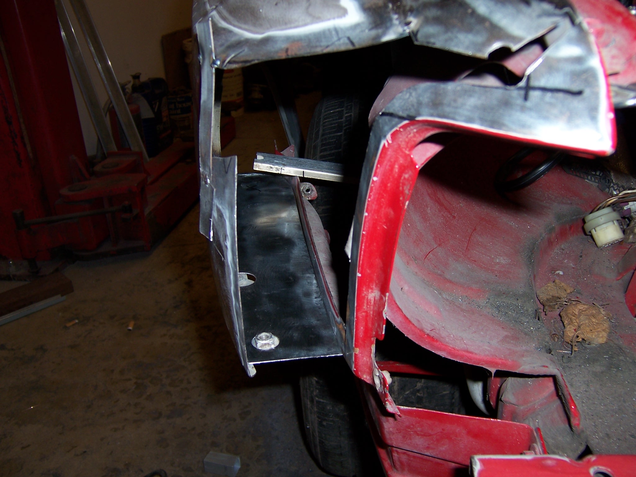

So i am working on the noses of the fender and i needed some targets for measurements , witch resulted in some parts removal.
The offending parts removed
audi wide build 074.jpg (864.97 KiB) Viewed 57943 times
Thing that are being modified so noses can get finished
audi wide build 077.jpg (708.34 KiB) Viewed 57943 times
Updates as soon as i get some more done .
Mike

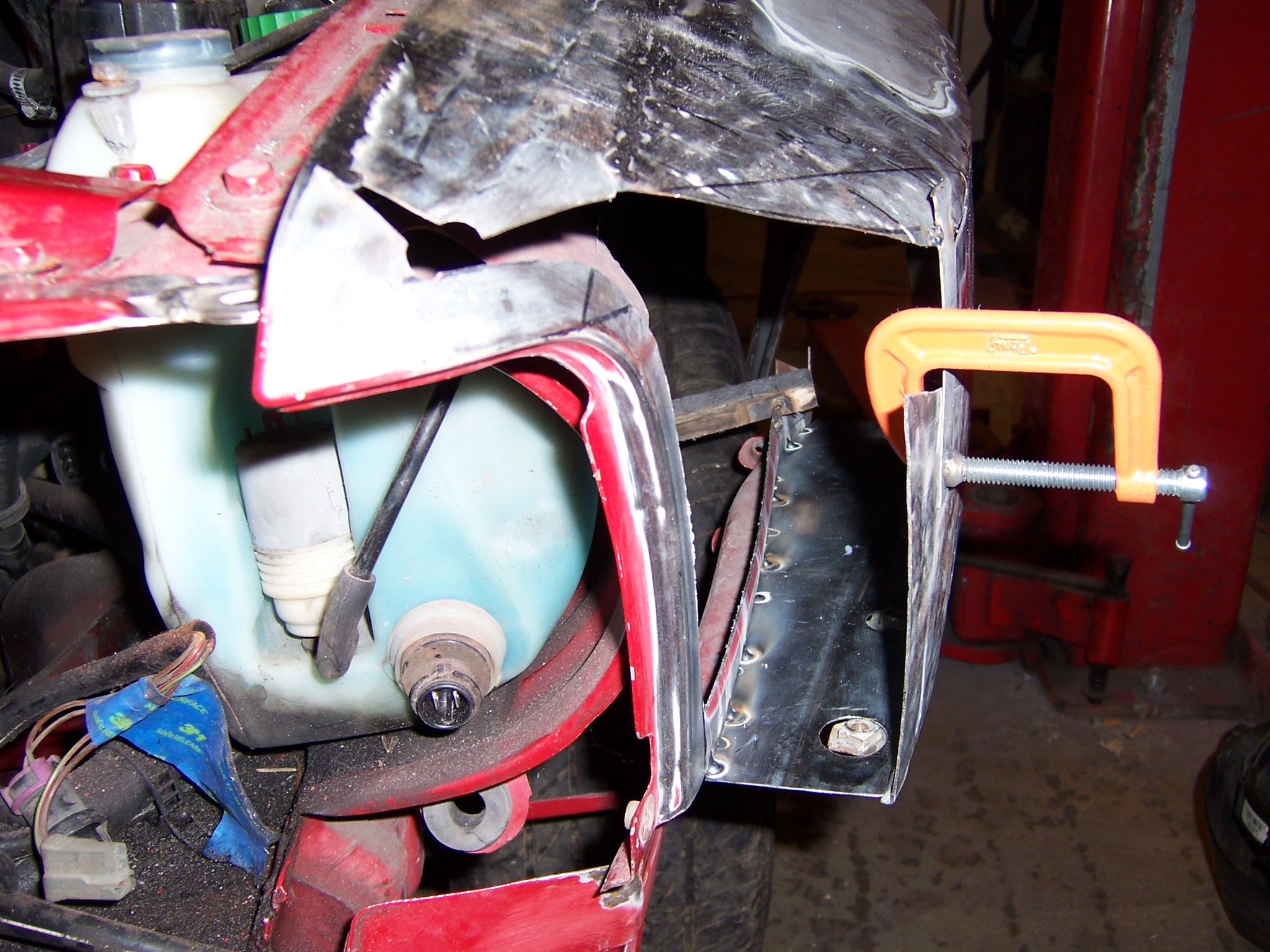

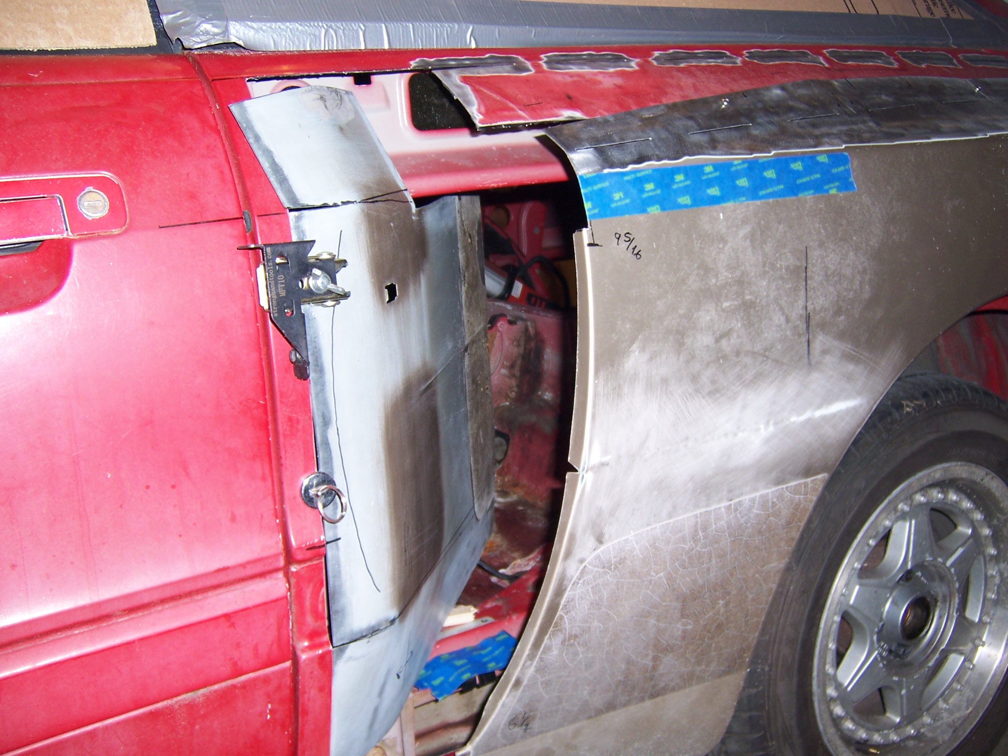

Patch panel for fender
audi wide build 078.jpg (690.79 KiB) Viewed 57856 times
Other side but not tacked yet
audi wide build 080.jpg (501.75 KiB) Viewed 57856 times
More things i have learned doing this build:
Use New sheet metal , stripping the paint of used metal to make it weldable Eats Allot Of Time. :shame:

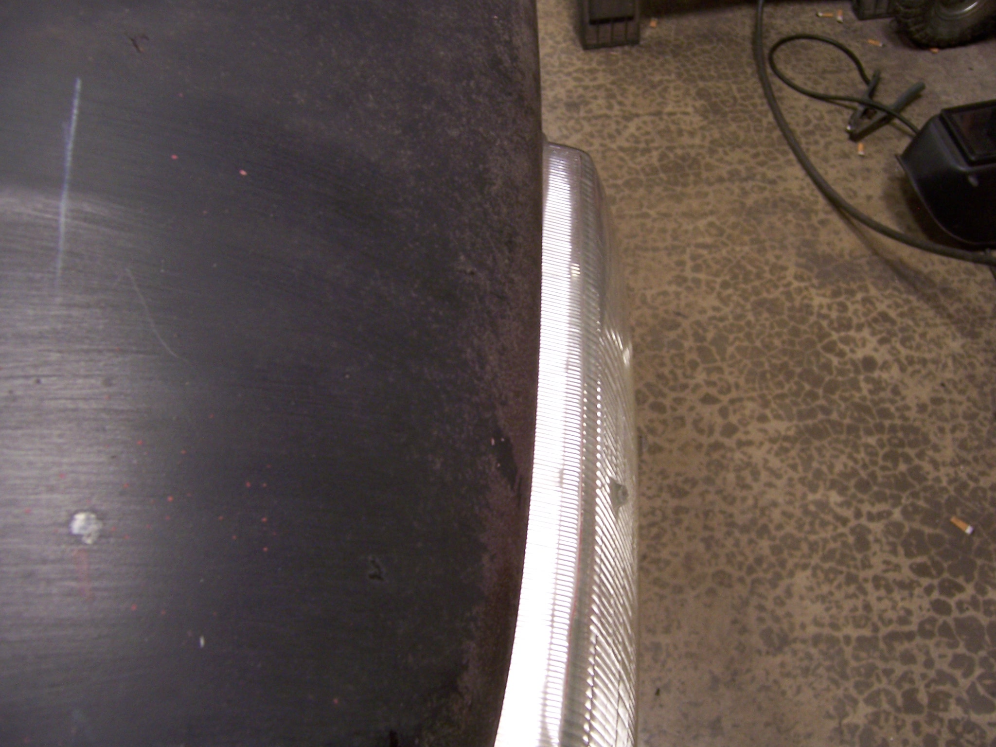

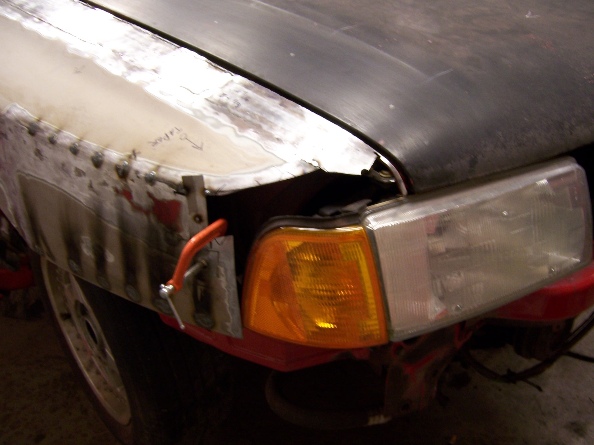

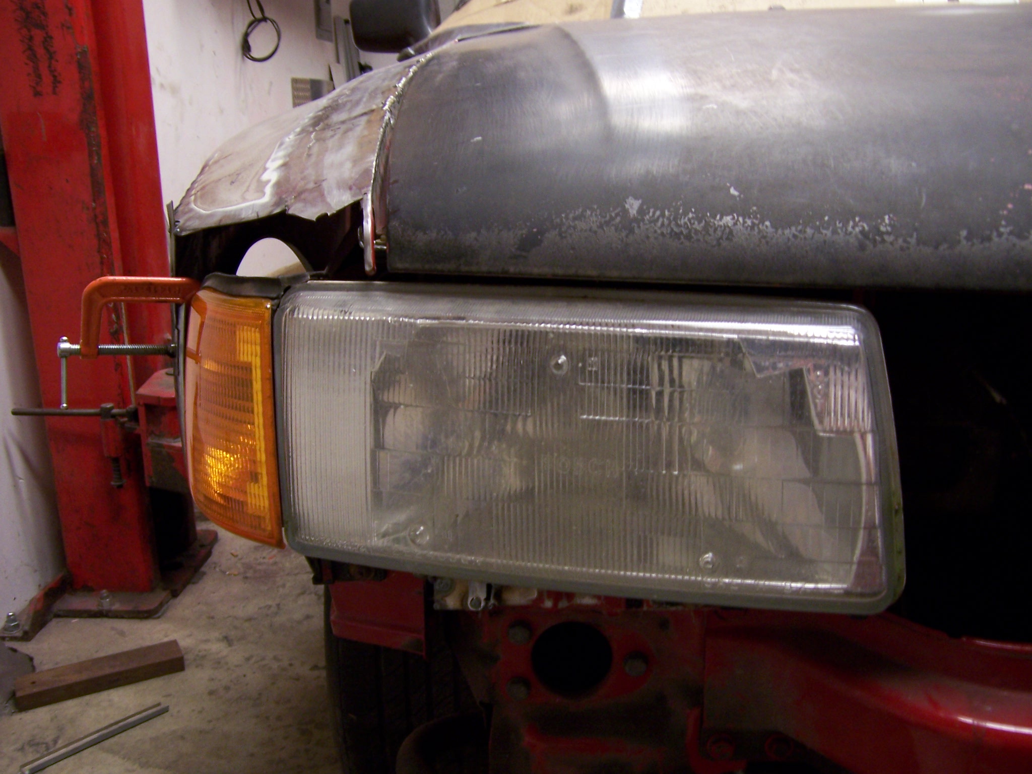

So work on the nose of the fenders is on Hold. The turn signals are just not stable enough to get the frame placed with any kind of
accuracy . I need eurolights to make that happen the way i want it to , as i only want to do this once . To top that off , i think i need to
redo the Headlight mounts to place the light further back . :bangshead: So i will focus on the rear of the car until i get some
one piece headlights .

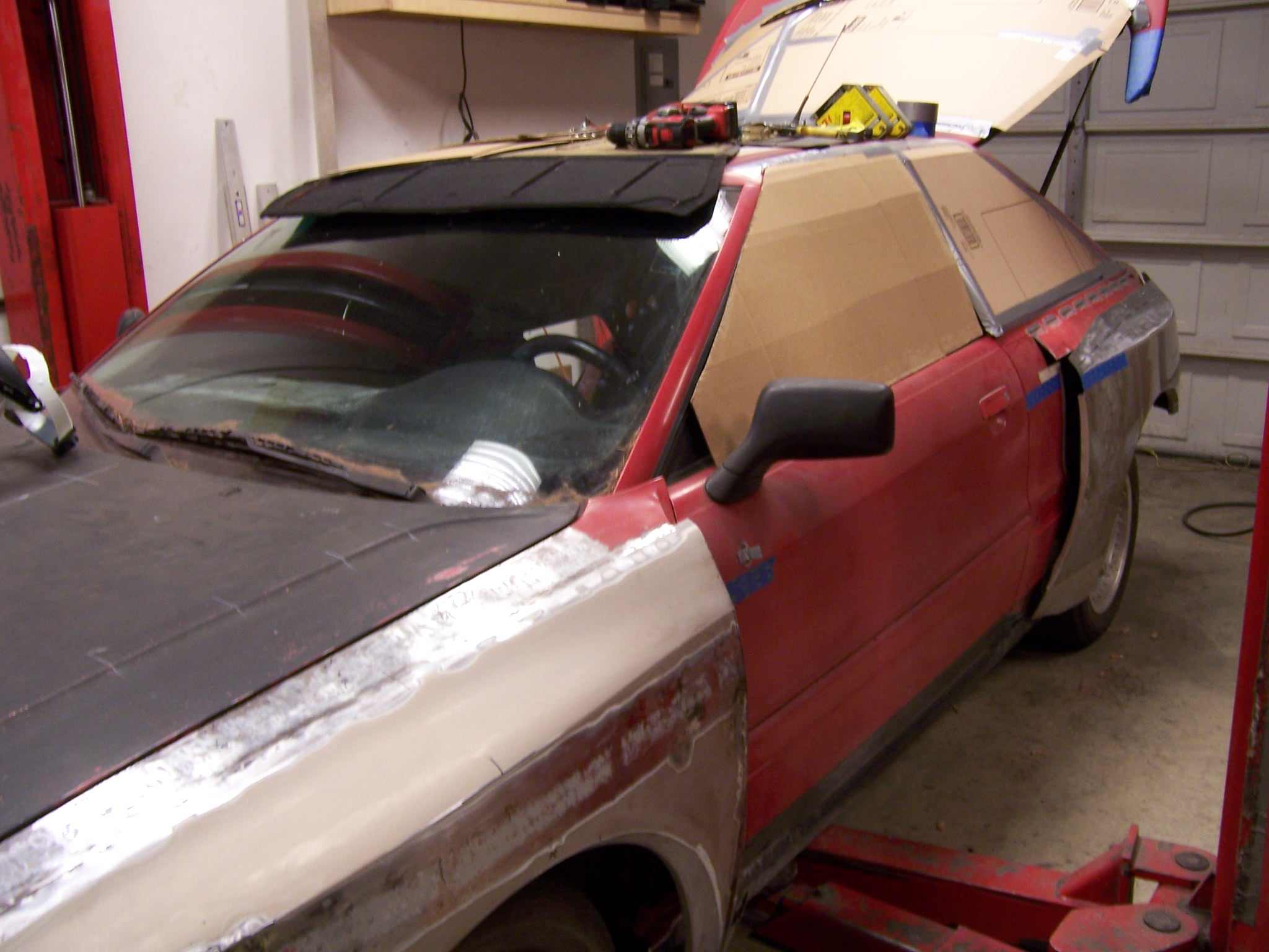

This is how it sat tonight
ok 002.jpg (489.89 KiB) Viewed 57832 times
ok 003.jpg (410.49 KiB) Viewed 57832 times
ok 005.jpg (482.91 KiB) Viewed 57832 times
Thats it for now .

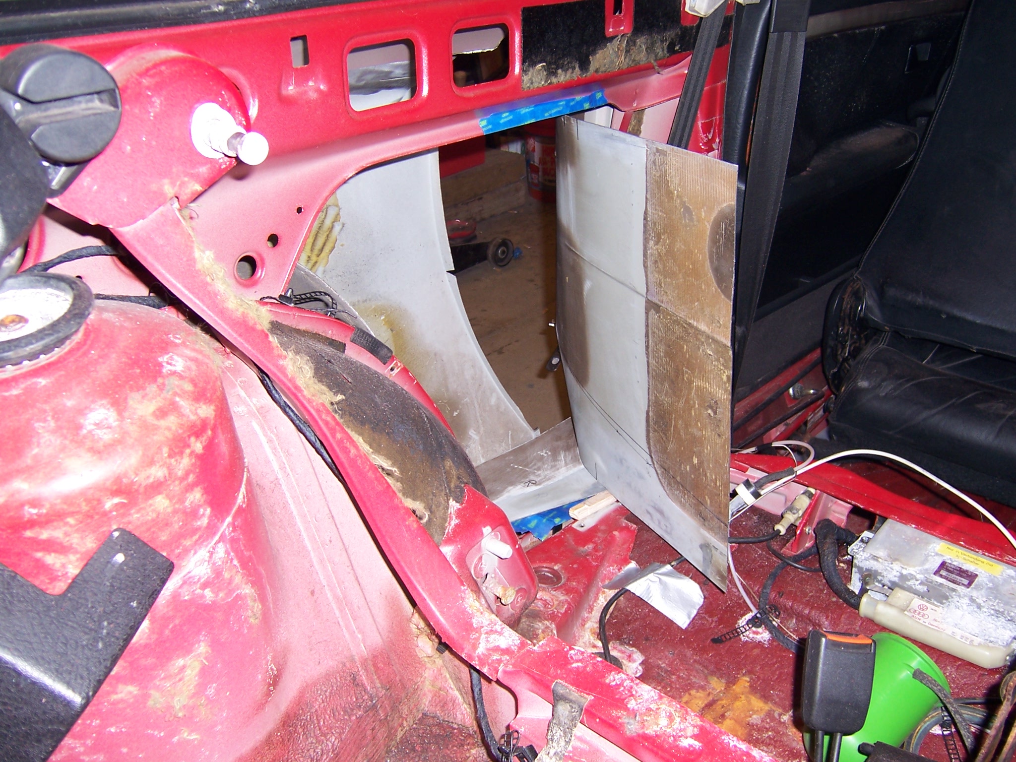

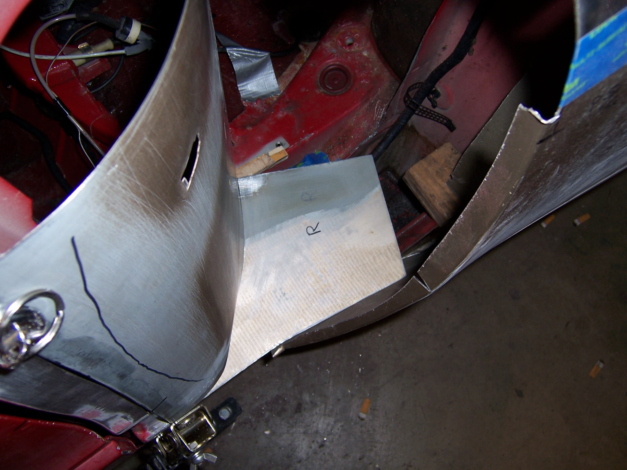

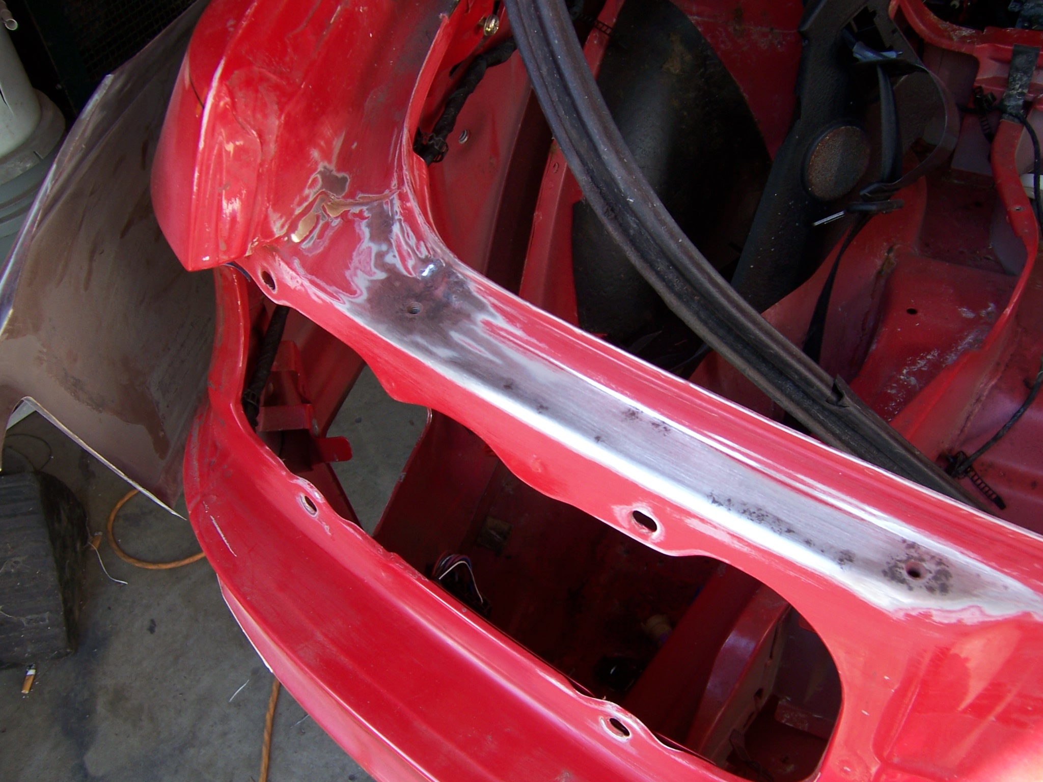

Made some progress on the Rear of the car.
Making a Hole
Rough fit Needs more love ,but starting to look like it was meant to be there
Mike
Einbilden
Posts: 149
Post by Einbilden »

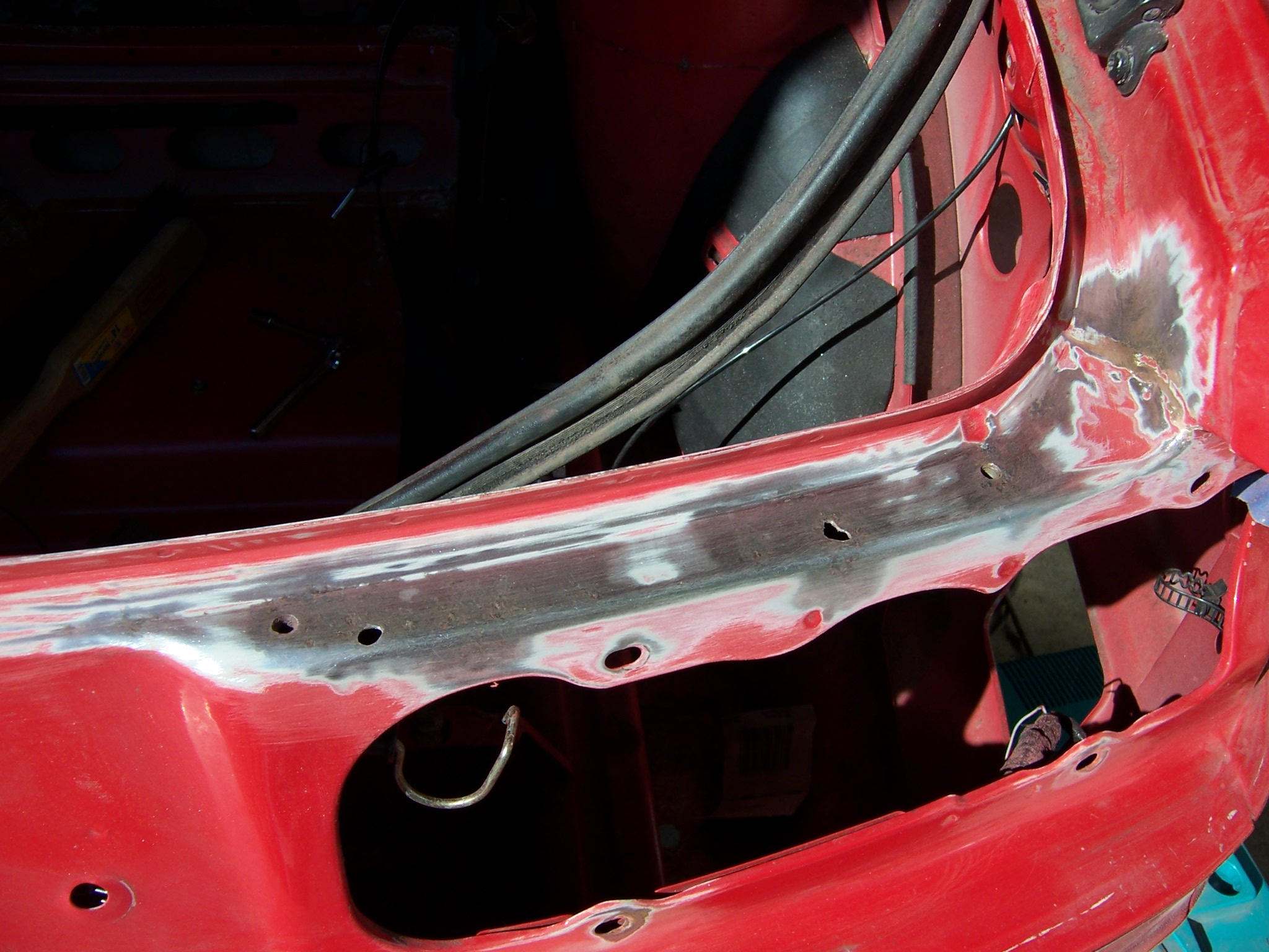

Looks like a radiator is going into the Trunk. Working on supplying air to make that happen. Any thoughts would be appreciated! :hail:
Has this been done before on a street car? If so where the results successful or failures?
An opening presents itself.
Needs more TLC but you get the idea.
Till next time.
Mike

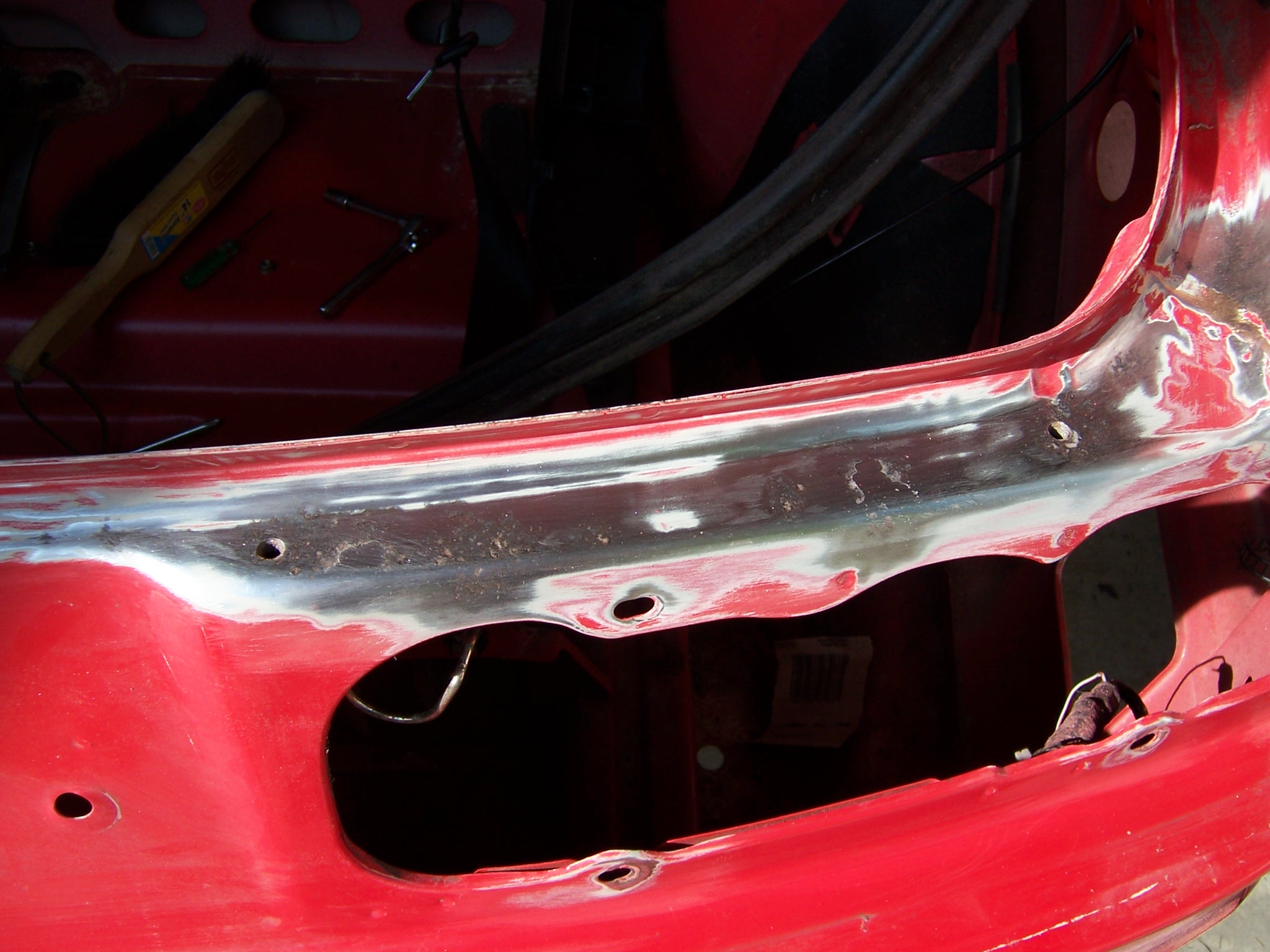

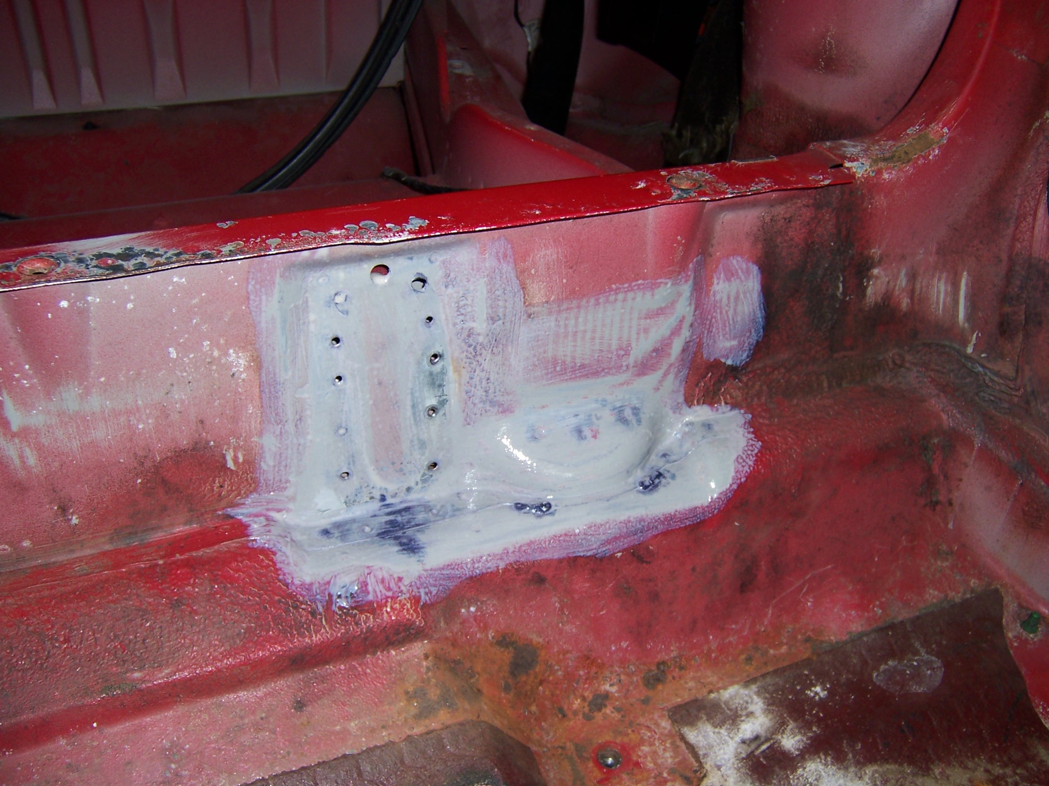

Also fixed this
Holes welded and ground , waiting for rust destroyer

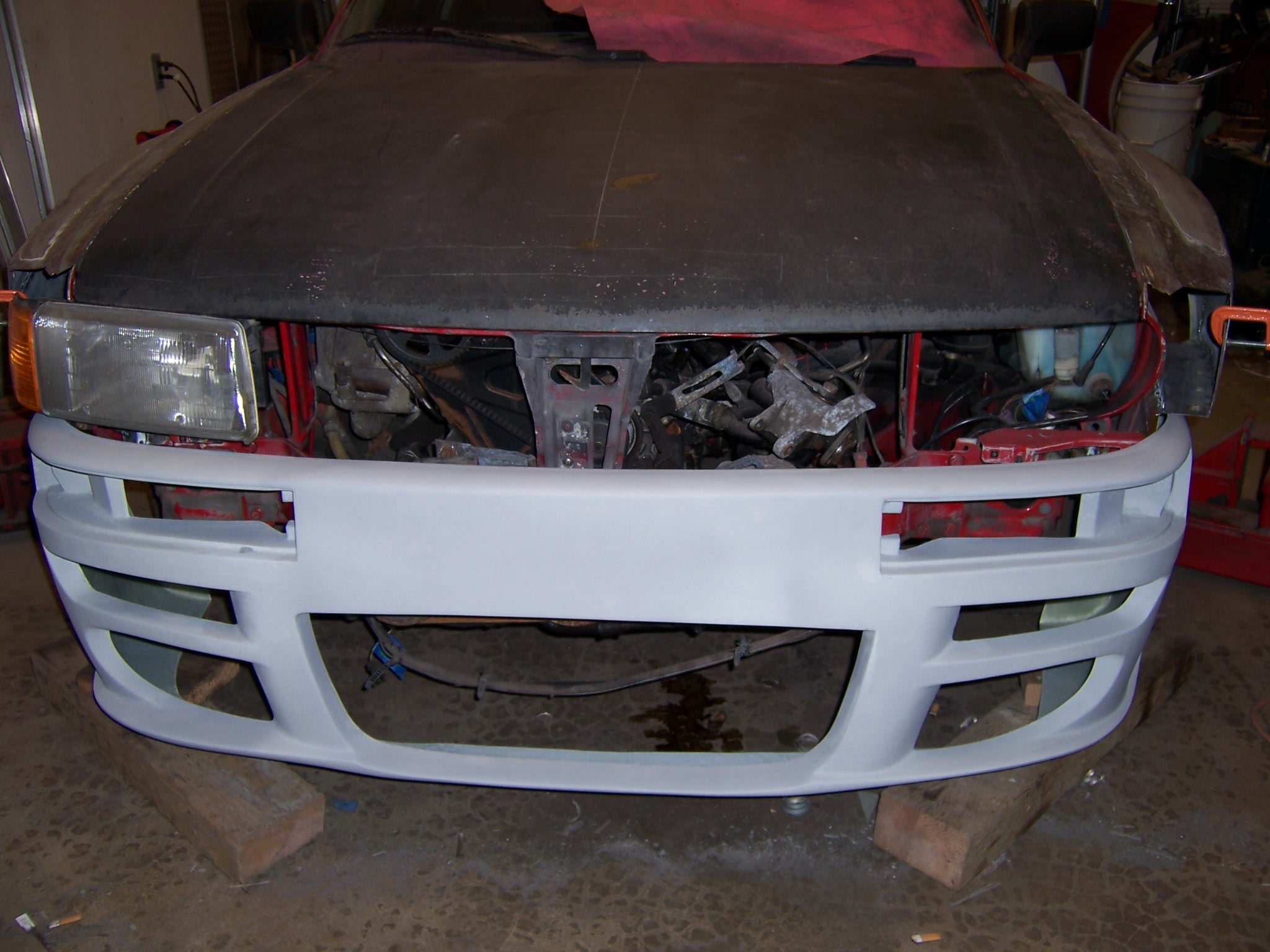

Also ordered this Front Bumper :hide:
audi bumper.jpg (70.54 KiB) Viewed 57397 times

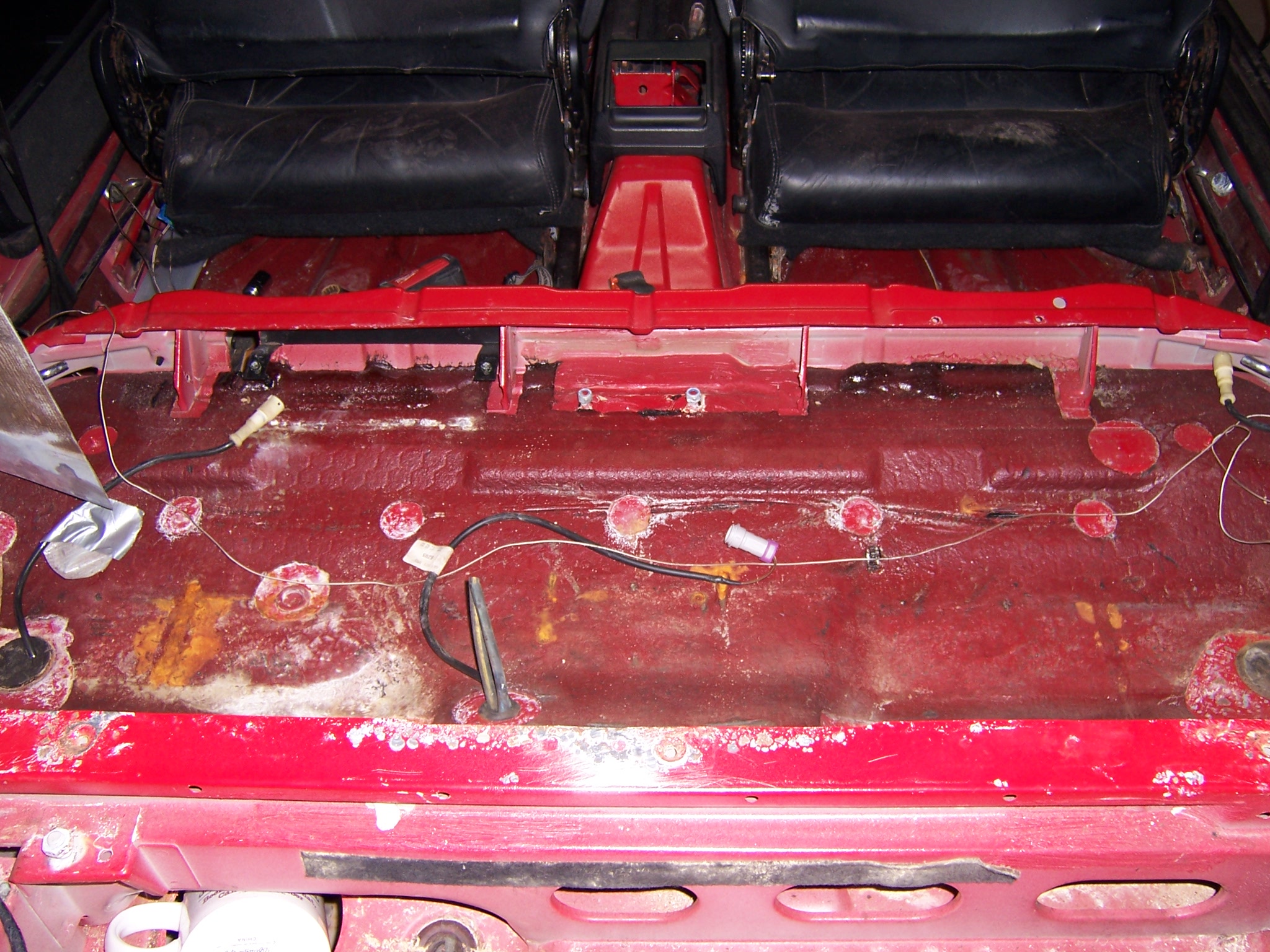

Got a couple of hours done on the car tonight.
Removed backseat center pivot mount
Also all the control units under the backseat are now gone
All this meant having to be in the car. Getting in and out a few times I realized just how Light these cars are in the Rear. :o Glad I am adding weight in the Trunk to hopefully offset that a bit.
:wave:
Einbilden
Posts: 149
Post by Einbilden »
Received the bumper yesterday, and slid it under the car. Needs to get Wider, plus the top edge of the center opening would look better Straight (to me anyways). Maybe I get some time tomorrow to work on the car. Ill keep you guys posted.
