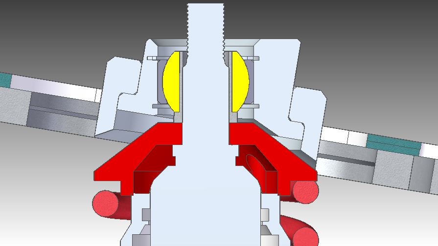

Looks like from the centered position, I am able to achieve 1.96 degrees toward the more positive camber direction and 1.65 degrees toward the negative direction so far. I just came up with a new spin on the design though which will help us keep all of the adjustability and as much travel as possible.

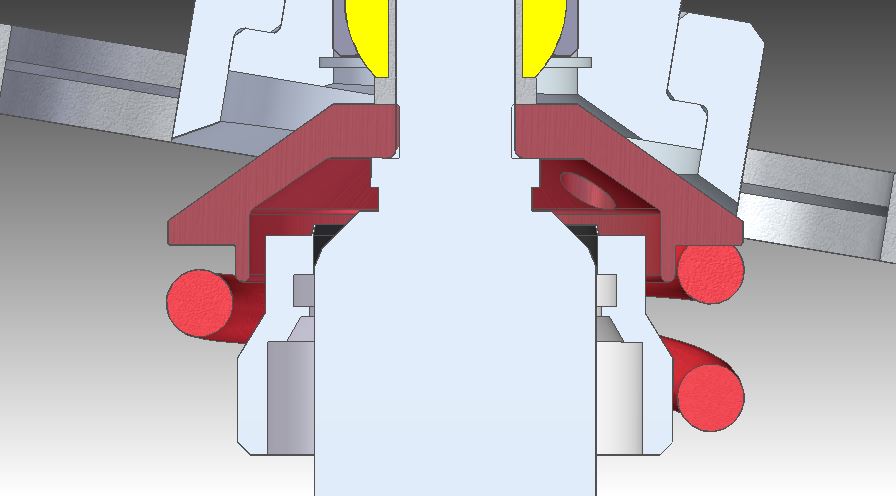

Kind of a shitty pic, but you can see the radial bearing in the top cap, then the 3/4" spherical on top. Mine don't however have any means for adjusting castor, yet.

uberaudi, make your next point of education in that program to learn how to take a section view. That will help a lot! Until then, I can't really tell what you have going on there.

Yeah I should of done that to begin with!

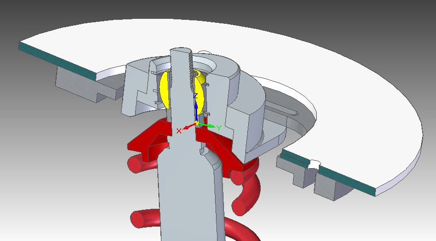

How's this?
The blue parts are just 1018 while the orange is 6061. Note that the strut drawn is a 5000 strut, not a 20vt, but the steps and diameters are the same between them. Well, except for the main shaft.
Much better, I can tell what's going on now for the most part :)
Is that not still just loading the spherical bearing though? I don't see how you are taking any of the load off of it.

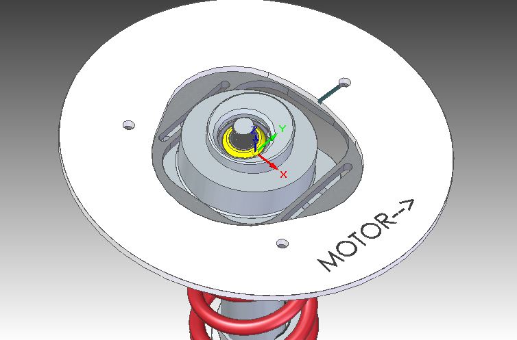

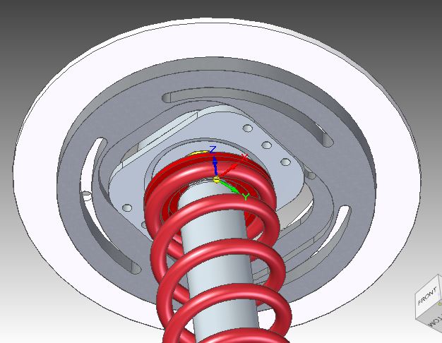

Re: T44/URS Strut Mounts - Help Me Help You!

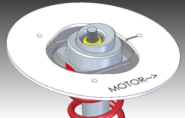

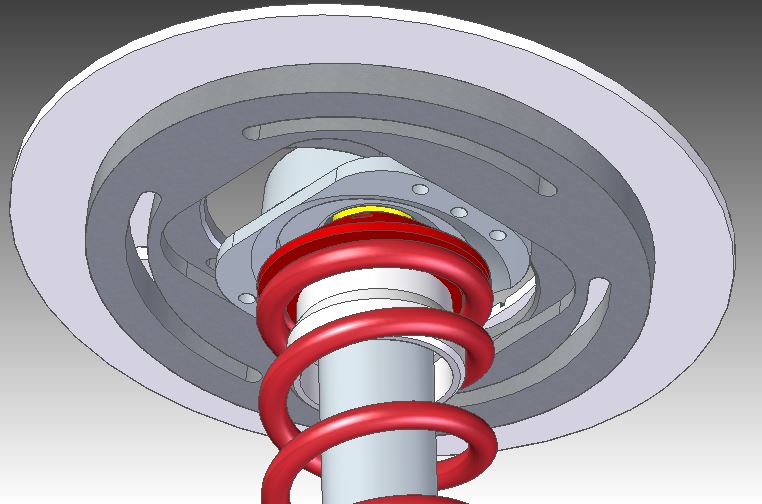

Things are looking more and more feasible by the minute. So far, this one sacrifices nothing. It should even be relatively cost effective to have made compared to some other ideas I had. Still lots to sort out and perfect, but it's much closer than ever before.

Cool idea on the eccentric castor adjustment, haven't seen that before. How do you lock it down?
When I was talking about taking load off the spherical bearing I was thinking more radially, not axially. Plus having a sealed bearing is important when your car is exposed to different weather extremes, and I could see longevity becoming an issue otherwise. It also provides bind free adjustments.

uberaudi wrote:Cool idea on the eccentric castor adjustment, haven't seen that before. How do you lock it down?

You lock it down the same way you do for camber. Just torque the bolts.
Even if you are talking about radial load on the spherical bearing, I don't see how your design is preventing that. Either way, spherical bearings are much stronger in radial loading than they are in axial. This size bearing can typically handle 6-7,000 lbs axially, but 35-45,000 lbs radially! That's for a quality, Made-in-USA bearing though ;)
Weather-proofing is something I will have to look into. For now, know that the design is made to allow for easy hot-swapping of bearings if needed :)

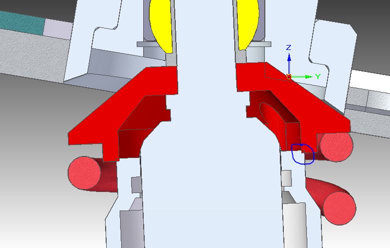

Ed, are those Bicknell hats? They look even lower profile. I think the gland nut is actually going to limit whether what you did there is worth a damn or not. Maybe not though depending on where the strut bottoms out internally and if the Bicknell spring retainer ID is bored out or not.
Pic for reference:

Here are the hats... they are very low profile. If I remember correctly, the ID is not correct for Bilstein, but once modified slightly on the lathe they fit perfectly. https://technotoytuning.com/universal/p ... 2mm-center
I don't think it's possible to have the hat interfere with the gland nut. I'm pretty certain the Bilstein will hit its internal bump stop before that can happen, plus I think the spring would be fully compressed before that happened as well. We're not exactly running long springs here

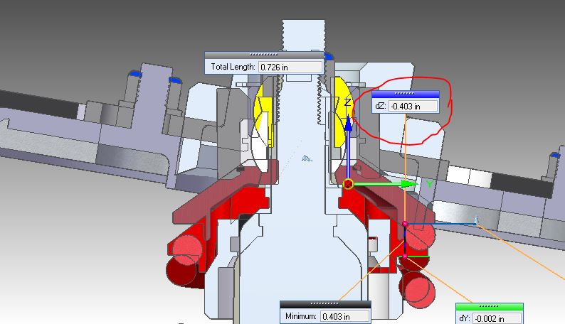

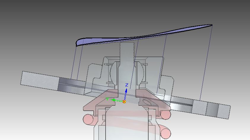

Progress has been made!
I took very good measurements of the strut tower bolt pattern (it was pretty close to the one you gave me in your CAD files Nick), the Bicknell hat (you got a little lazy on that one ;) ), and hood clearance (thanks Kevin!). From those measurements, I was able to come to a few conclusions.
1) The Bicknell hat has clearance for the Bilstein gland nut when the strut is all the way compressed. Woo! I thought that's what I remembered, but now I'm 100% sure of this.

2) This design really does maximize strut placement with respect to hood clearance. I used Kevin's more conservative values (with the hood lining in instead of out) and we end up with just enough clearance in the middle of the adjustment range. If you want more camber, there is more room, but if you want to adjust in the positive direction, a spacer may be required. There is already a spacer used in the design to allow proper contact between the bearing and the top hat, so this can be made thicker for those wanting more adjustment in the positive direction.
Mind you, those hood clearance measurements were taken from a 200, so you UrS guys are on your own if it doesn't clear in your cars. Again, the fix is a simple spacer. It may be possible to just use some washers to space it out if needed in fact.

3) Nick, I'm not sure how much your design which replicates the stock mount, but gets rid of the stock spring perch, etc. raises the strut position in the body, but this design should raise it at least 0.4" more than what is possible with your setup. So that's good news!

You'll probably be okay with respect to hood clearance for two reasons: firstly, the hood seemed to have a slight dome-shaped profile, so, since the numbers I gave you are around the perimeter, you probably have a little more room to play with towards the center.
Secondly, I measured vertically with respect to the car, not perpendicularly to the strut mount plate, so (unless you already took this into account) that 'ceiling' could be shifted slightly up and out towards the fender.
