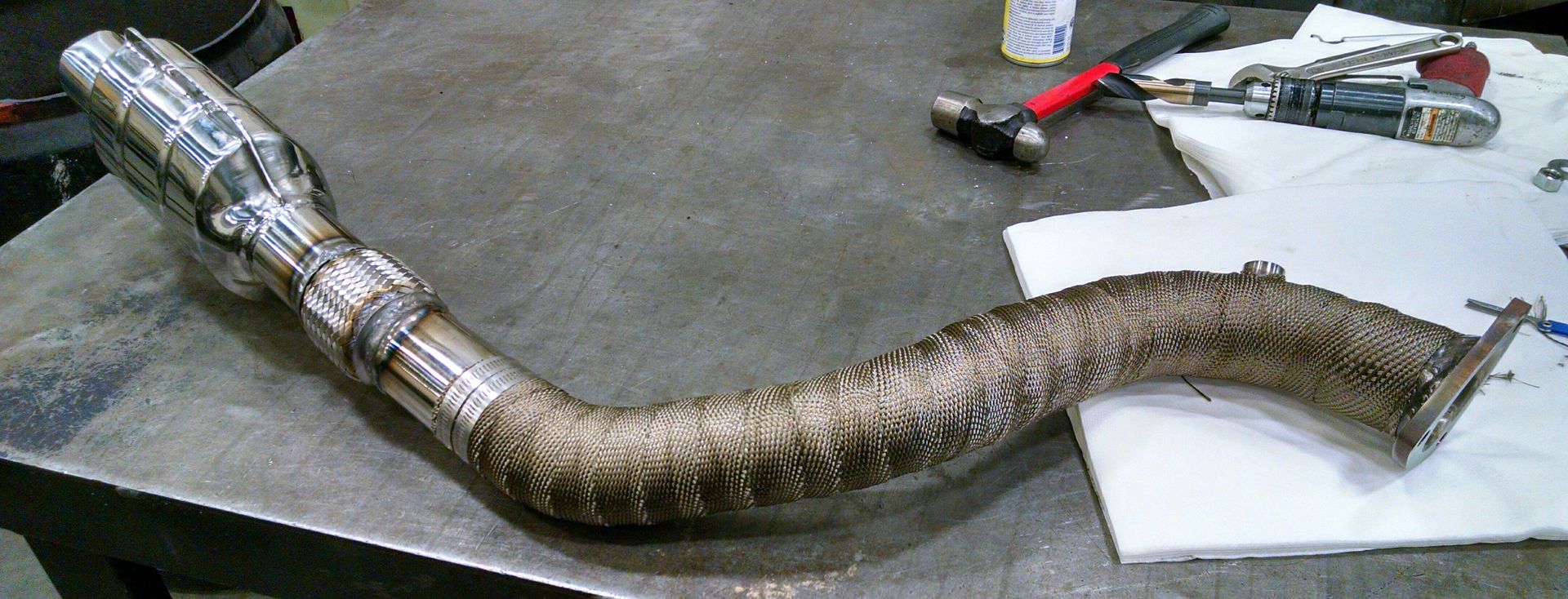

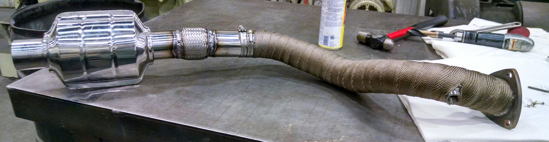

Here is a little teaser for those still watching. I really didnt like the way this pipe welded. Maybe its the gas we use at work, but who knows. Either way, its together and ready to go on.

Minor update. I got the downpipe installed and O2 sensor in. If I didn't know better I would think it was made especially for this car haha.
