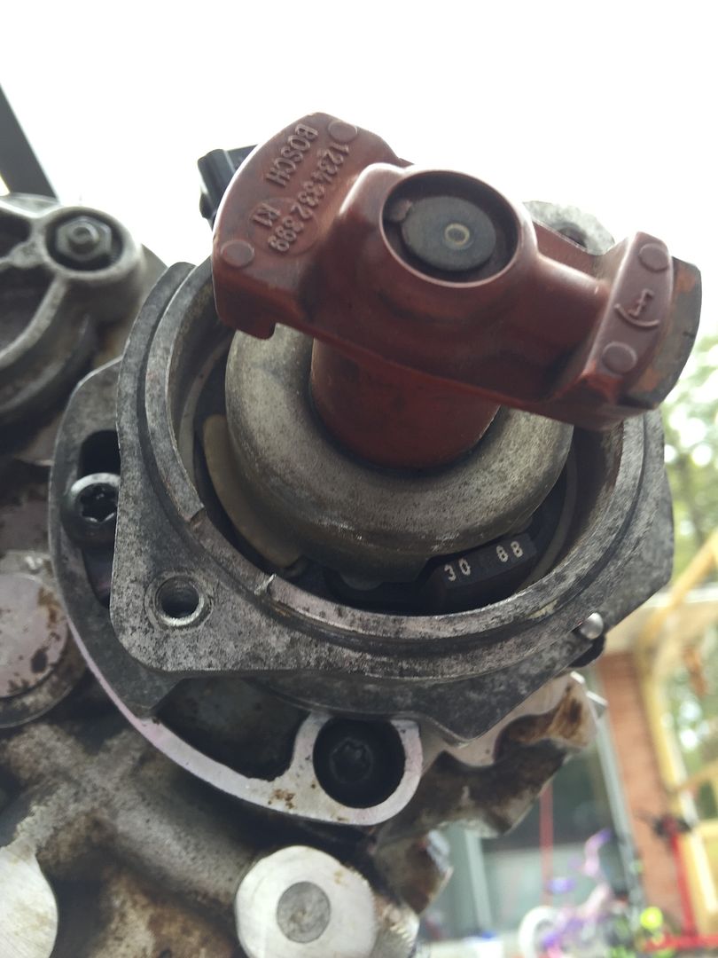

Re: Ben's Coupe Quattro - V8 - Making Progress
Does the ABH not have a camshaft trigger stock? Mine does...I'm not using it though, perhaps it was added at sometime, I don't know.
I am so stupid. You're right. There is a cam sensor inside the passengers side distributor. I sold mine about 4 months ago and totally forgot about it. That is certainly a simpler solution than replacing camshafts ssuming it will fit with the airbox in there,

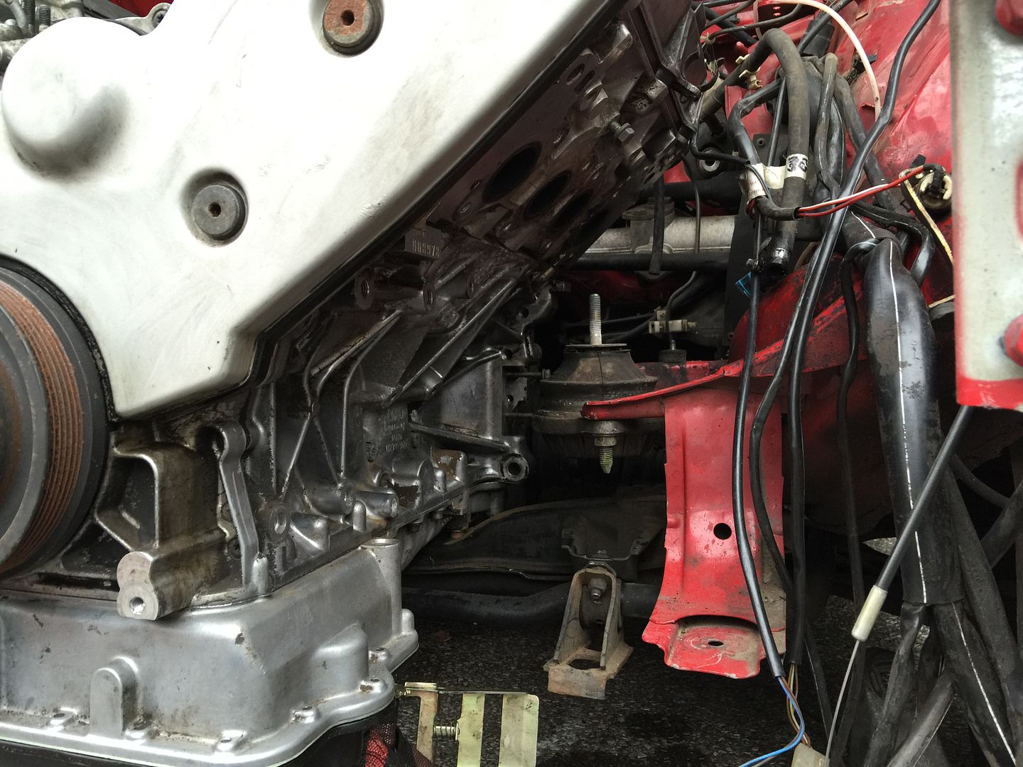

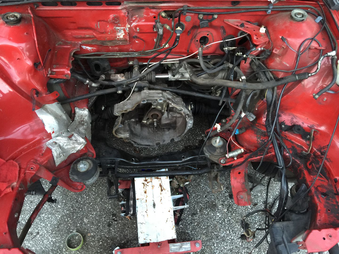

battery box removed, ABS Bracket cut out and holes drilled for the bolts
Fits better but still need to shave the oil pan better

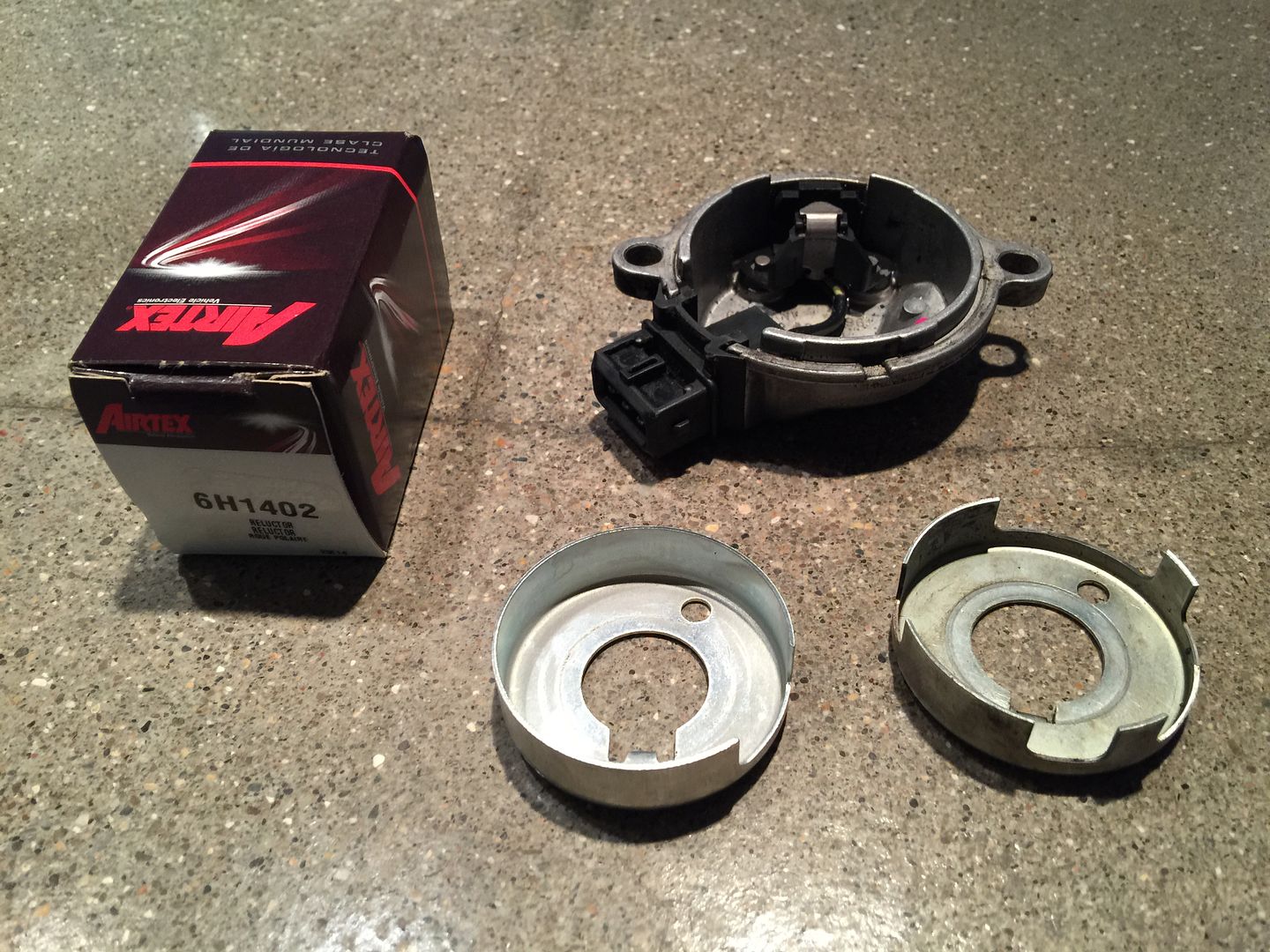

The one that's on mine is just like the ABZ one above...and is seperate from the distributor cover plates that I have on there.Grillage wrote:I am so stupid. You're right. There is a cam sensor inside the passengers side distributor. I sold mine about 4 months ago and totally forgot about it. That is certainly a simpler solution than replacing camshafts ssuming it will fit with the airbox in there,
Really? can you take a pic?

Yeah, I'll get one. I've never tried to use it, so maybe it's just on there and doesn't even have the cam gear for it.Grillage wrote:Really? can you take a pic?
Yeah. Could be used as just a block off. My ABH cams aren't threaded to receive the bolt that holds the reluctor in place. I have an ABH distributor with can sensor en route

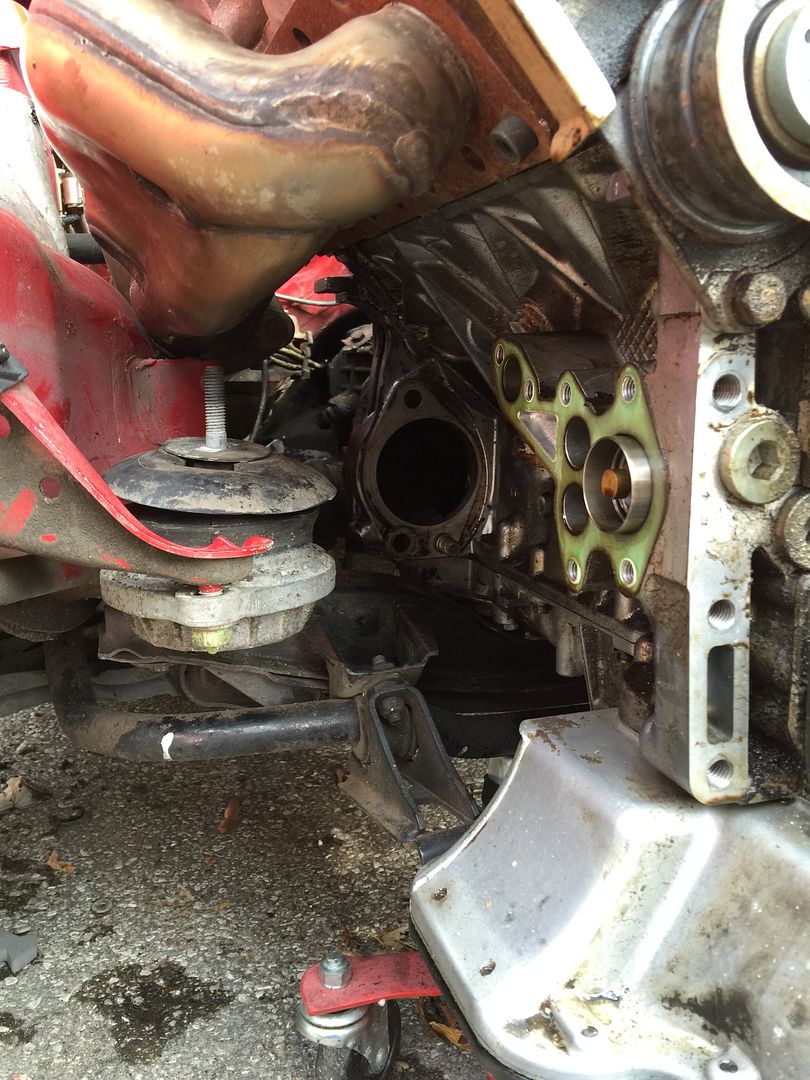

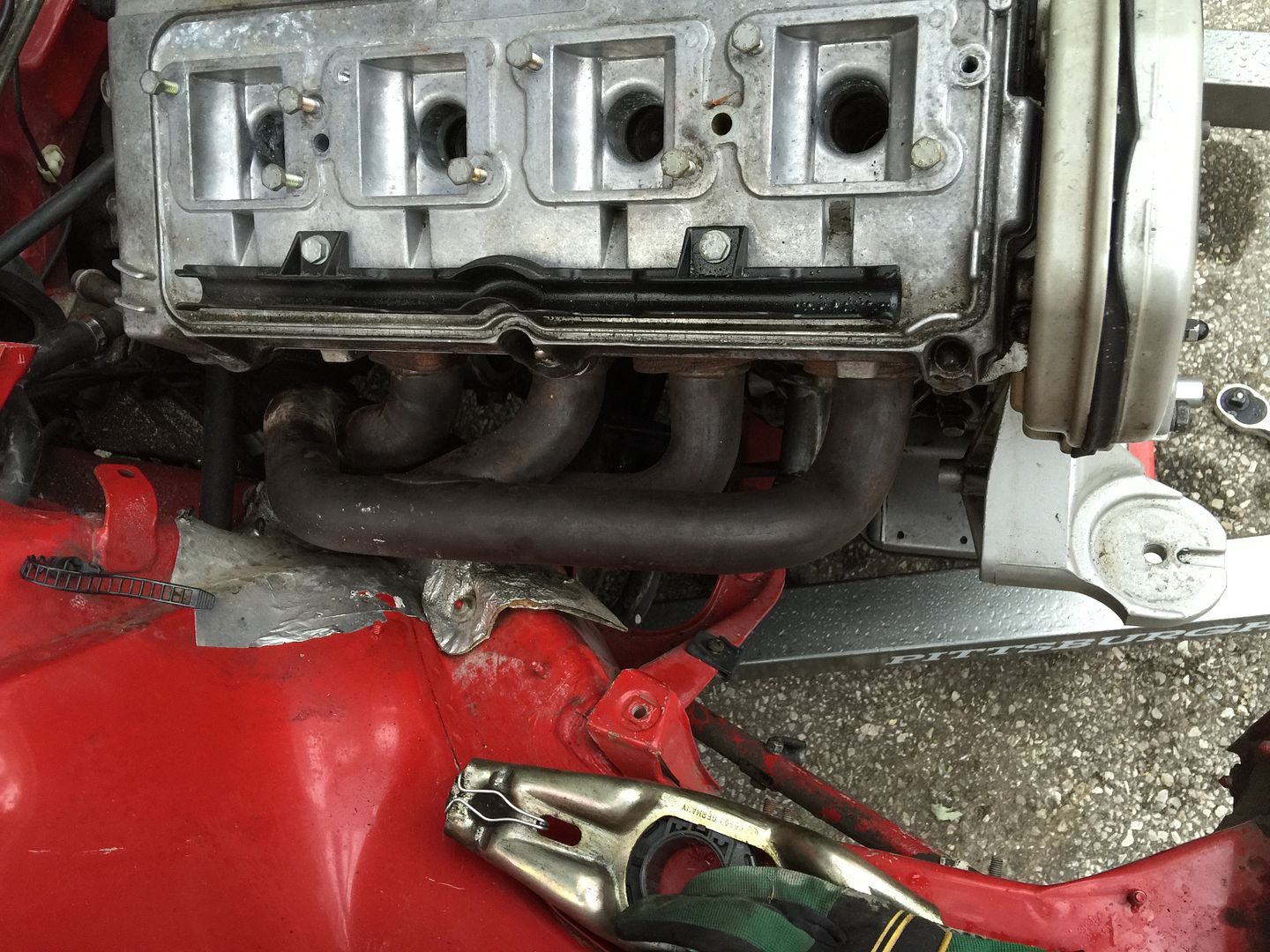

Some mounting questions...
I tried to fit the manifolds in with the engine in place today and had a lot of trouble.
On the drivers side, the engine mount is in the way...
On the passengers side the subframe is in the way and the pipe from cylinder #2 needs to be brought in a bit...
Would the ABZ manifolds fit on my ABH heads? They appear to be smaller but I don't know for sure.
Also, has anyone confirmed that I do in fact need a longer slave cylinder rod?

the german
- Posts: 720
- Location: Bellevue, WA
ABZ manifolds will fit, should just need to move some studs around- I tried both the ABH and ABZ manifolds on mine and found only the ABZ would fit well.

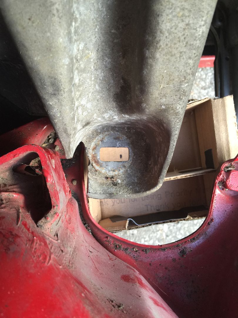

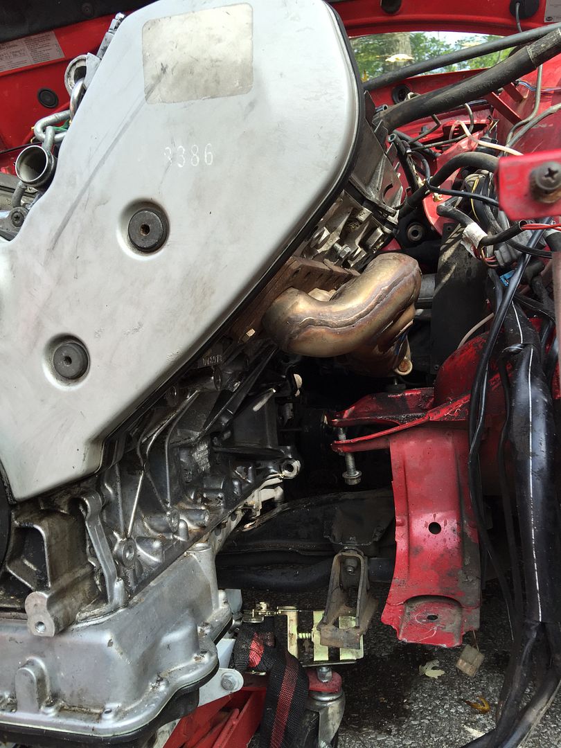

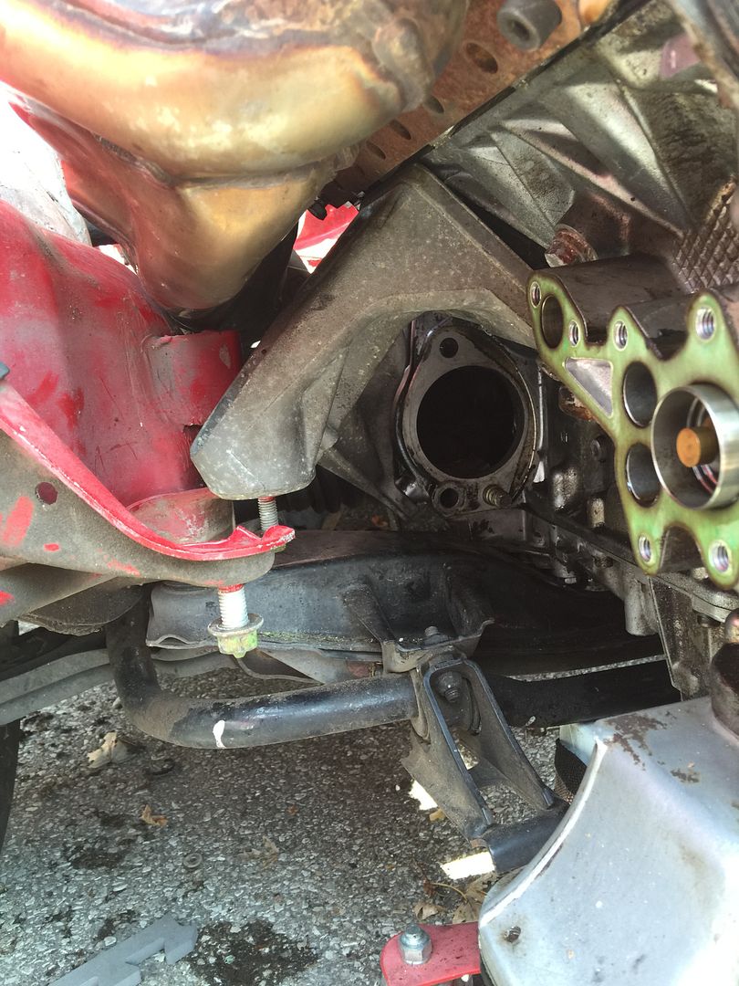

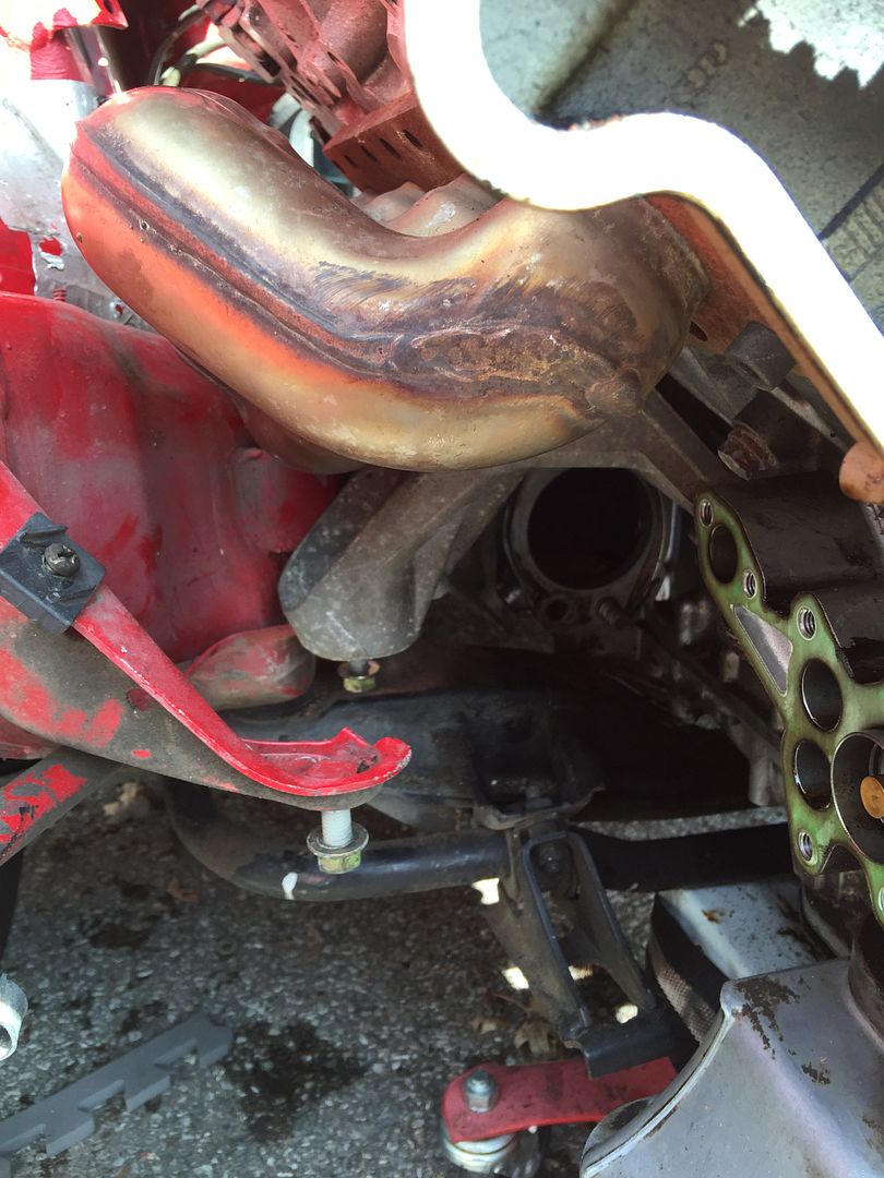

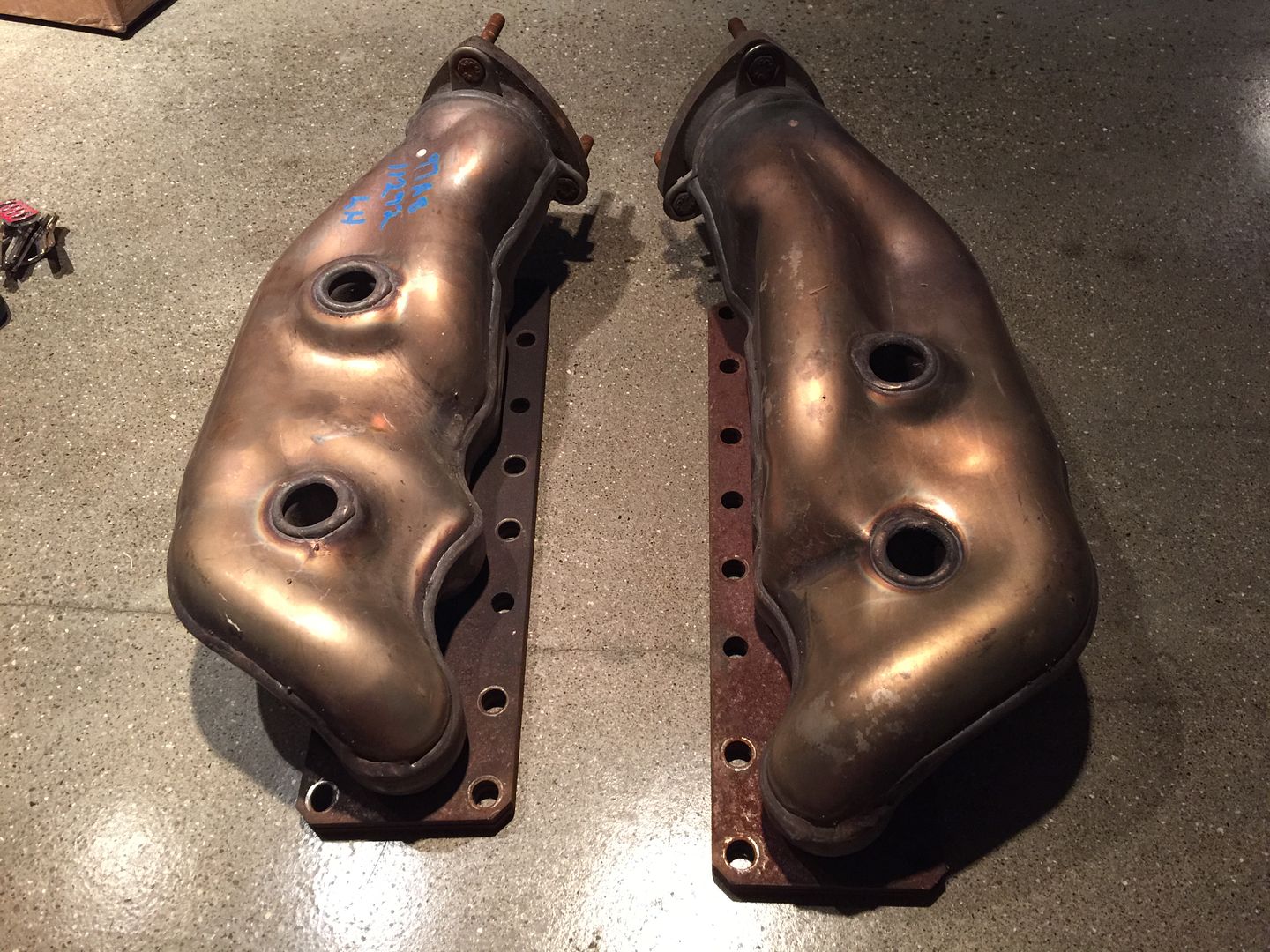

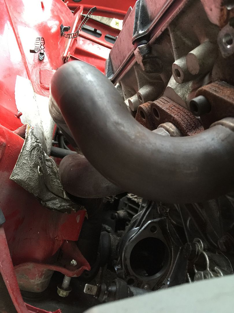

I figured out the exhaust manifolds. ABZ is most definitely the way to go…
installed on the drivers side:
Not a lot of room to turn down behind the motor but can definitely be done:
Installed on the Passenger's Side is a lot tighter but should work:
Now to figure out Motor Mount Brackets.

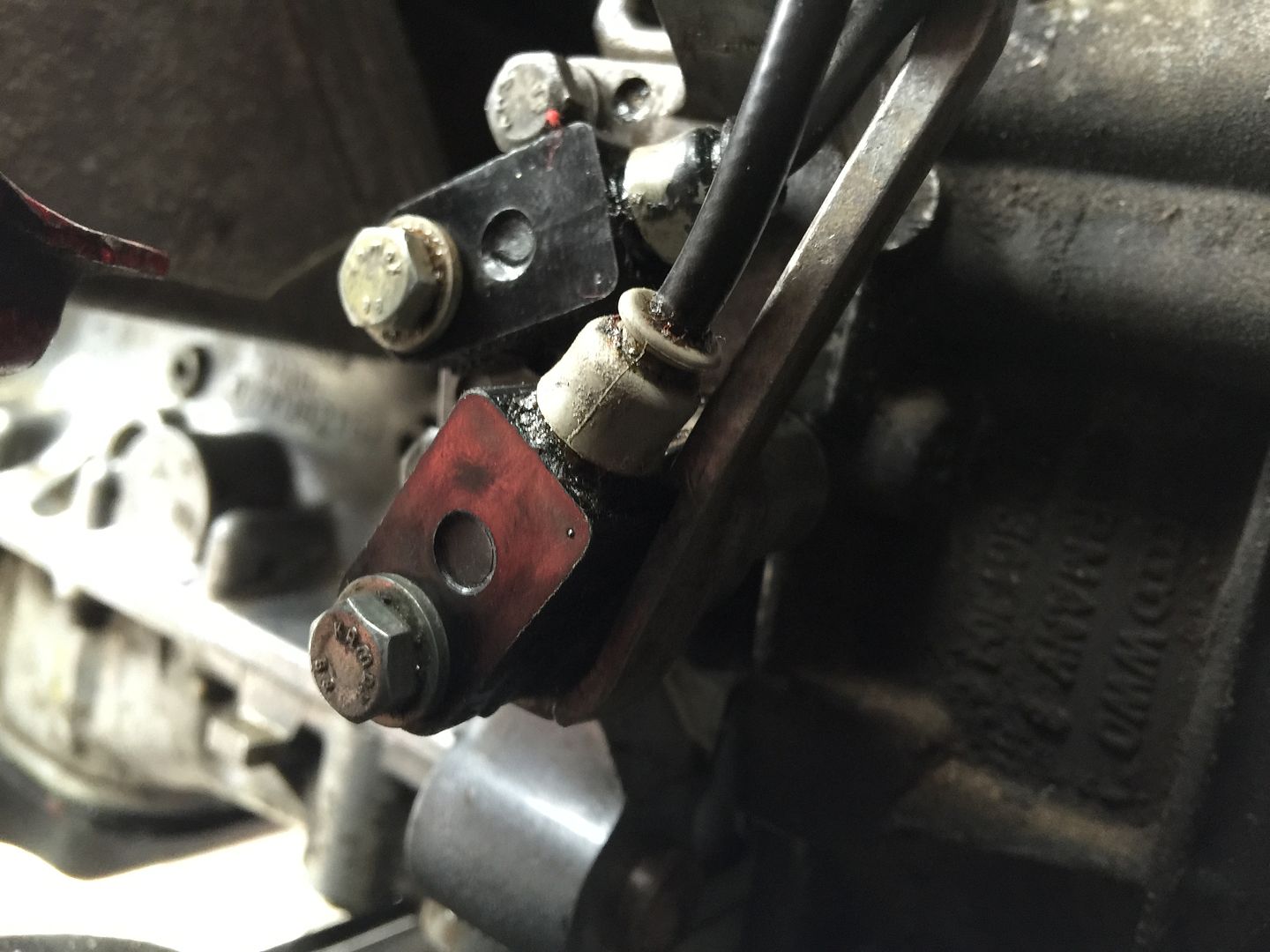

Here's the stock ABH mount on the passengers side…
The mounting spot on the bracket actually falls between the brackets for the coupe so I wonder if it might be easier to make an actual motor mount to meet the bracket where it falls on this side.
On the drivers side I can't get the existing mount to bolt up to the motor, I'll have to mock something up in foam core and have it fabbed.

Oh yeah, I also figured out the Cam sensor issue. I totally forgot that the ABH passenger's side distributor had a built in hall sensor. Unfortunately I sold mine quite some time ago so I sourced another and installed it. it has the single window - exactly 10mm wide…
So supposedly I'll be able to get VEMS to work with the sensors I have (and no 60-2 trigger wheel).

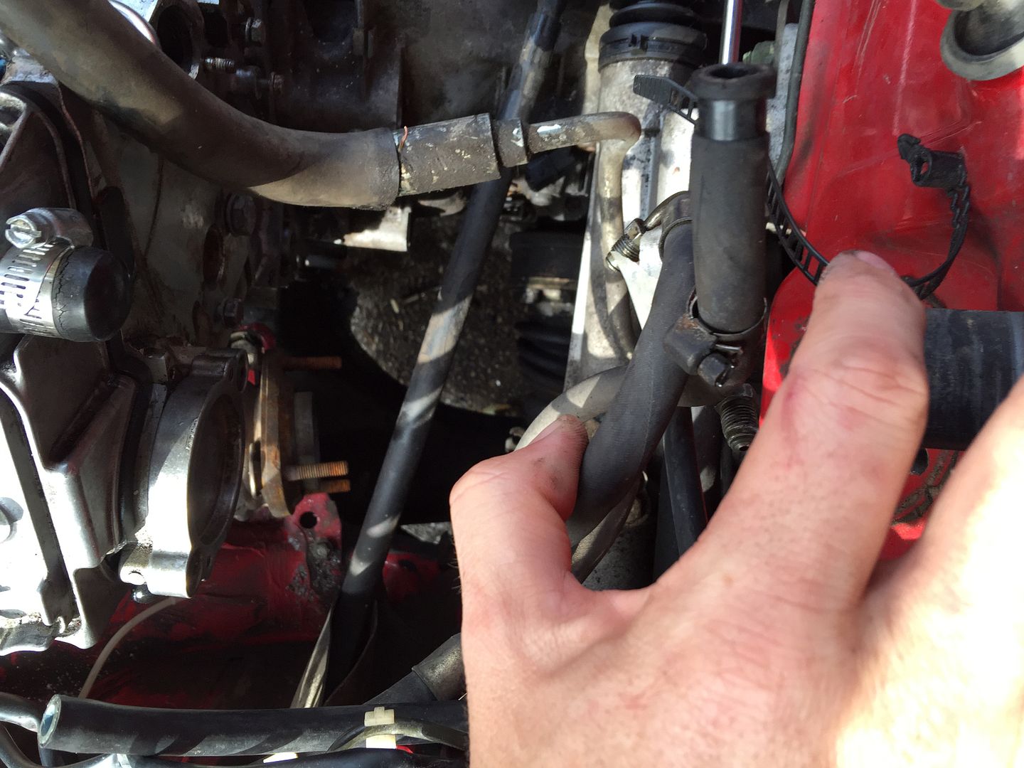

I'm doing the whole hydraulics system while I have everything apart. new clutch MC/Slave, ABS delete and Vacuum conversion. I would like to get that all buttoned up before putting the engine in the way.

kieron_32v
- Posts: 70
Looking good. The abh mount looks like it should be pretty straightforward to get to work. And fwiw that's the side that is the biggest pain as you have to clear the starter motor. The other side should be pretty simple with just some straight sections joined together. I put my abz back in my coupe a couple of days ago, and really wish I hadn't decided to turbo it. Bag of worms and all that. The exhaust is doable from those manifolds, just need the flange and flare to join the manifold, then a short radius 90 bend and should be pretty easy to see how to bring it all together from there.

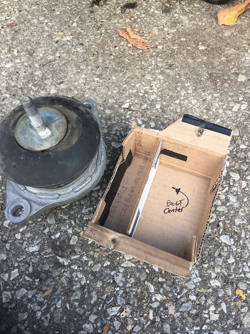

Re: Ben's Coupe Quattro - V8 - Making Motor Mounts
I did a mock up on the passenger's side -- I could have this (very) rough mount holder fabricated to hold the Flexane Mount.
This could work.

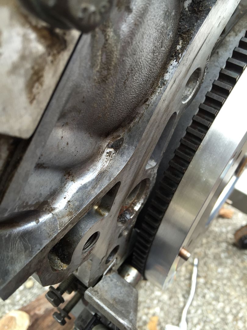

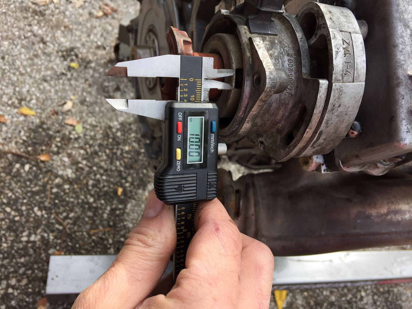

Also, I worked on the sensors today to make sure everything lines up as it should…
With the Flywheel Pin right on the sensor (which I swore you could see in this pic)
The Cam sensor is right in the window…
Unfortunately, I'm going to need to make room for the starter ring sensor - the 01A doesn't have a hole there…
This could work.

the german
- Posts: 720
For the motor mount- I suggest making a custom arm from the motor to the stock mount. The reason for this is that the motor mount is a wear item so using an off the shelf part will make your life much easier in down the road for replacement, as well as afford you a number of different durometer mount options which are readily available.
01A and 01E slave cylinders are the exact same thing.
2xthe german wrote:For the motor mount- I suggest making a custom arm from the motor to the stock mount. The reason for this is that the motor mount is a wear item so using an off the shelf part will make your life much easier in down the road for replacement, as well as afford you a number of different durometer mount options which are readily available.
For the slave- I'm running the original one from the 01a with my 01e no problem.
Arms would be better in the long run and you can use factory correct parts which are easily available and replaceable

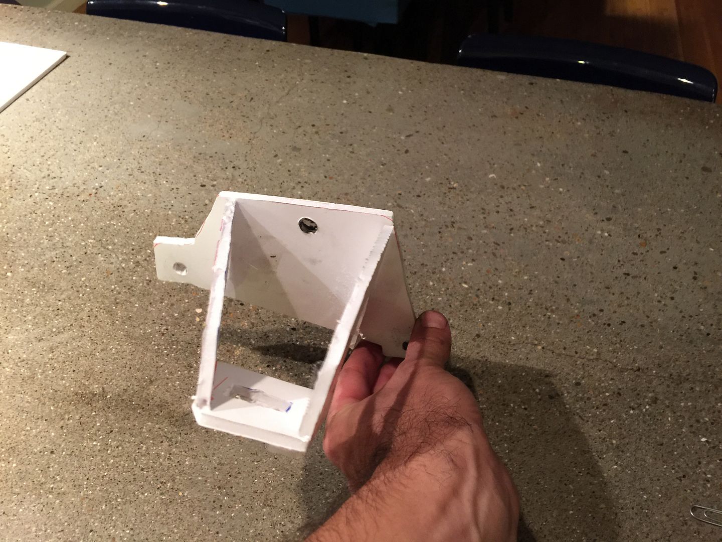

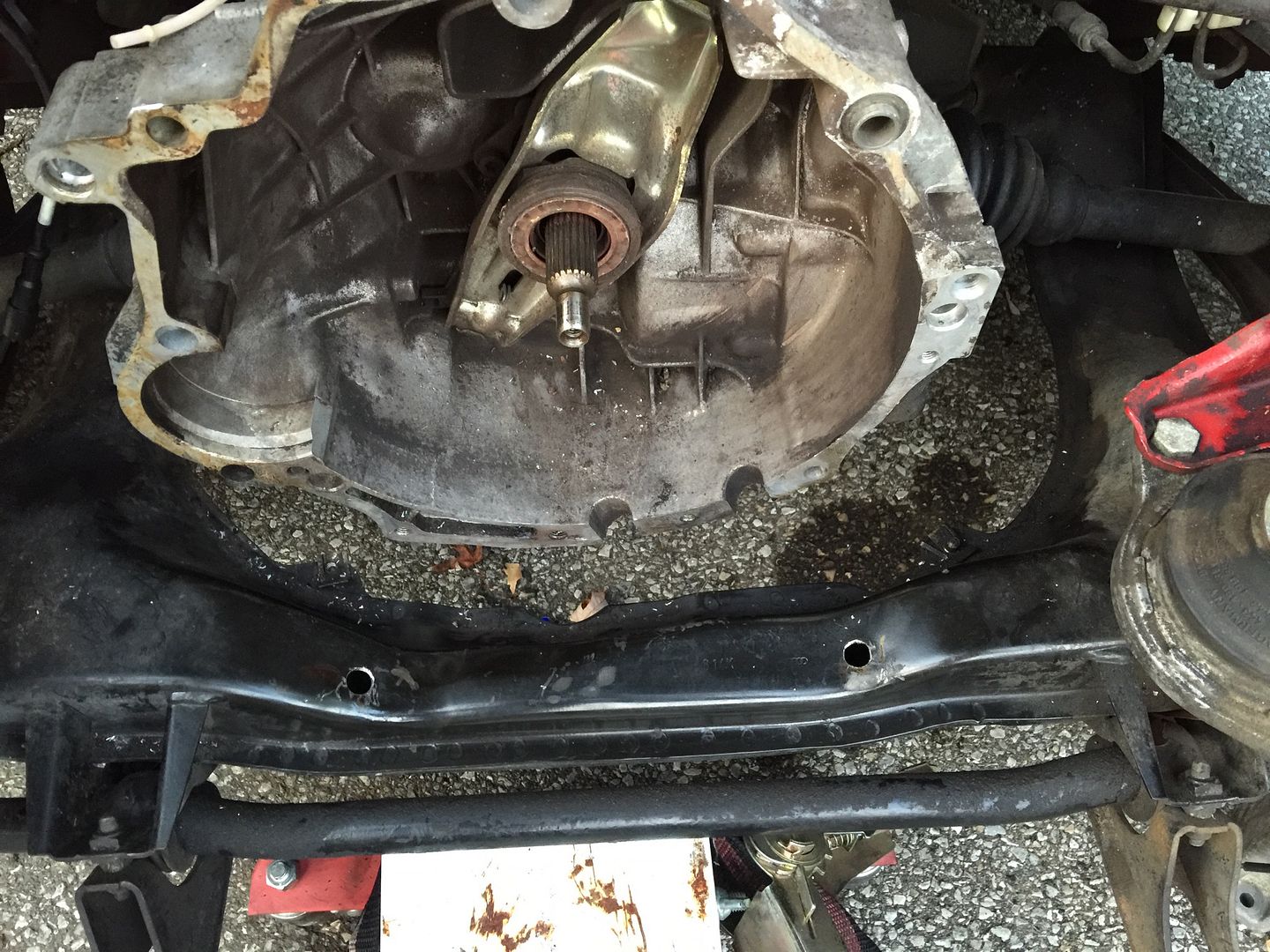

Finally had some time to work on the car this weekend.
Did some cutting on the transmission bellhousing to make room for the two sensors - flywheel and pin...
Also decided to follow everyone's advise and keep the existing motor mounts and fabricate the brackets rather than the other way around.
I "fabricated" them myself out of foam core today...
drivers side:
Passenger's Side:
Now to get someone to fabricate them in steel!
drivers side:
Passenger's Side:
any general machine shop can laser out the pieces. Both look like they would be a 4-piece mount. Very easily done.
Heads up: It will be cheaper if you draw the parts up in Autocad yourself rather than have the machine shop do it. Ask me how I know lol
