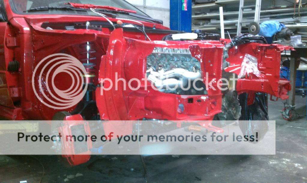

I got to the shop tonight for a bit tonight to finish off the 996tt brake brackets and mock up the tall deck for my new header and downpipe. I am still waiting for some stuff to finish off the wastegate, but everything looks like it is going to fit with stock motormount position given that the motor is solid mounted. I wanted a new valve cover before bbq, but I only have two saturdays to finish up.

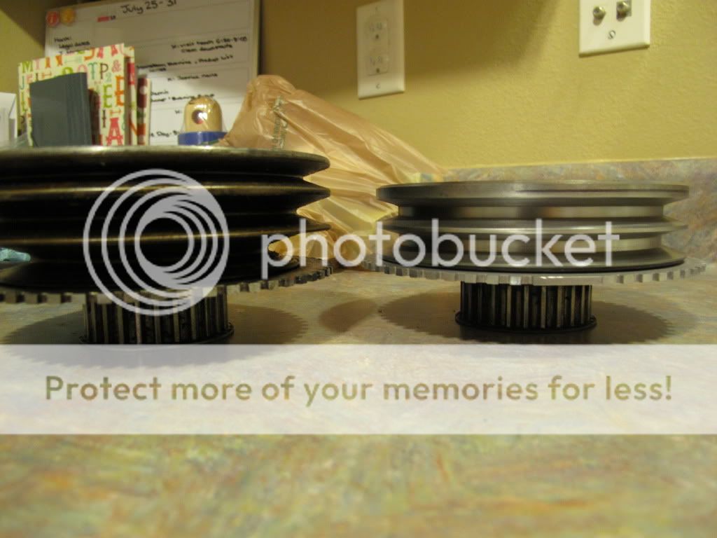

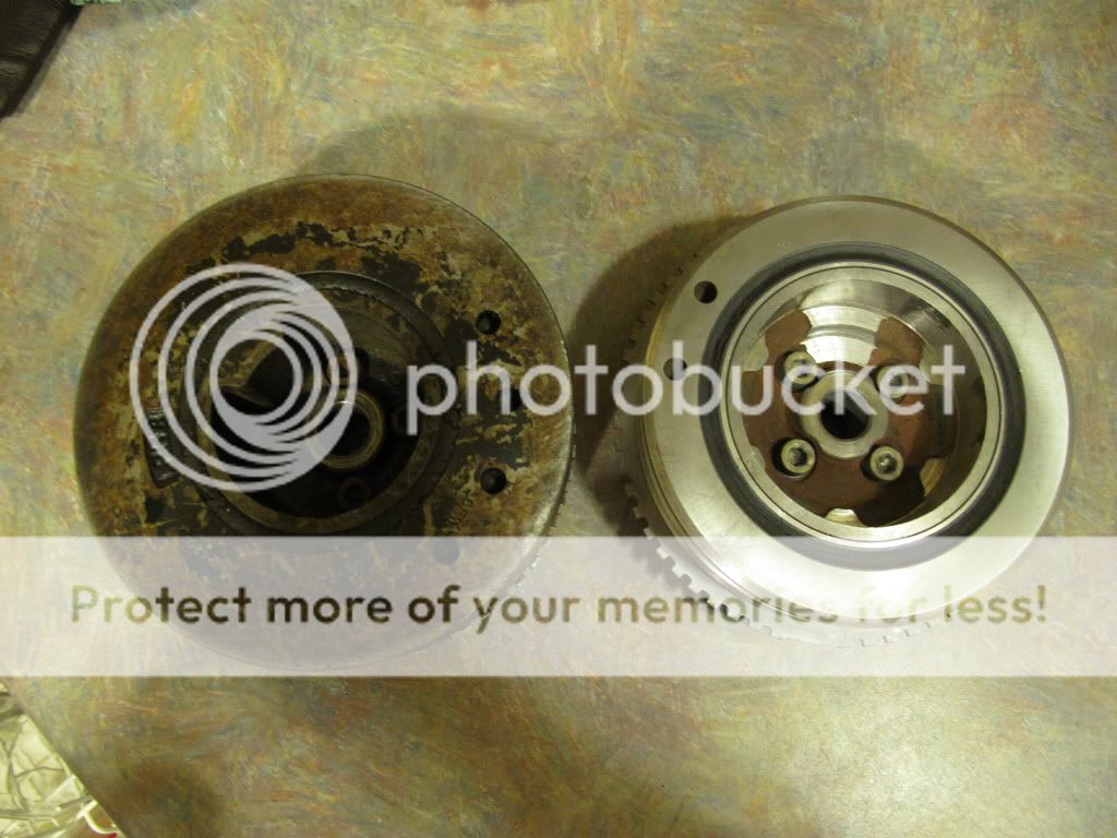

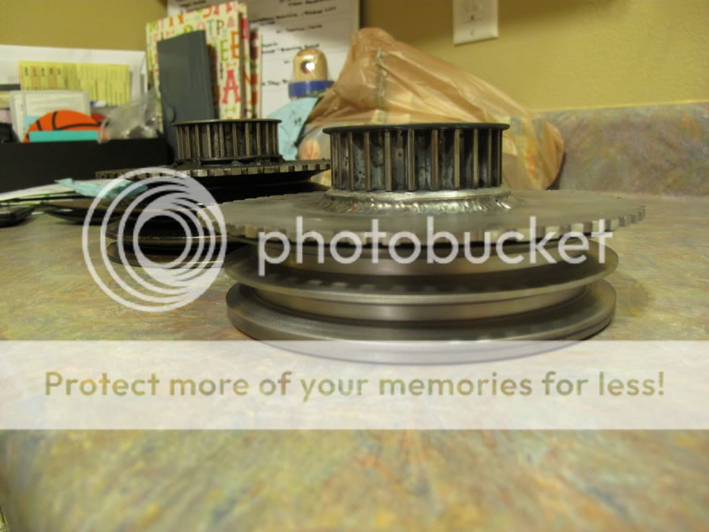

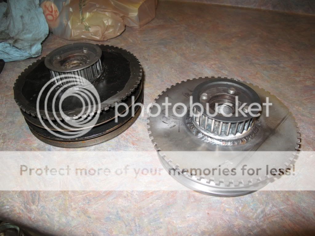

I got down to the shop for a couple of hours tonight after school. I needed to make a crank pulley so I could get the assembly dropped off tomorrow for balance. This is what I ended up with. I wanted to start off with the AAN pulley as the rubber is usually nicer and lots wider than the 7a/vbelt stuff. I thought about going serp, but I want to go electric PS pump, so the only accessory I would have is the alternator. It just made more sense to go with a vbelt setup. I trimmed the AAN pully down from 11.5lbs of the old setup to 6lbs of the new one. Most of the weight is out side of the rubber so I am confident that hte dampening effect will still occur. I also deleted the chunks for the crank tool as I rarely use it anyway( I typically tighten in gear with the ebrake on). Got my new trigger wheel on, and hopefully this setup will yield easy starting with the good signal.
Re: Hanks 612whp URQ: painted engine bay
oh, and my favorite part. I machined the v-belt groves to accept the available gates belts vs the super skinny belts NLA that the car really wants. Hopefully these like 8500rpm a bit more than the last ones

Nice work Hank. Does it matter that the keyway is messed up though?
Yes, it is holding mr up atm. I noticed it late last night. I will order one ASAP. Wherre did you order yours?
034 and EFI Express both have em. $95
034105263A
$70 @ GenuineAudiParts
Too bad Marc no longer has the forged version available, that was a nice piece
Yeah... I might have to talk to someone about making those again.
