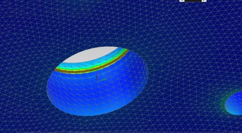

did a little finite element analysis on the rough draft of the bearing housing. This is with a snap ring groove with a minimal depth requirement. I really want to figure out how to do some durability simulation on aluminum, but there is something wrong with the strain values in my program. I'll continue to do more analysis by hand. Just wanted to show that I'm doin' it properly!

This is going to be your best friend when cutting those grooves on the lathe (unless you have a some super duper CNC that can do it another way):
As for the mounts; are you still going to radial slot the bolt holes so there is some camber adjustment?

I have all the tooling. They will probably be turned on the lathe for the groove and such and then on the CNC for the final shape.
