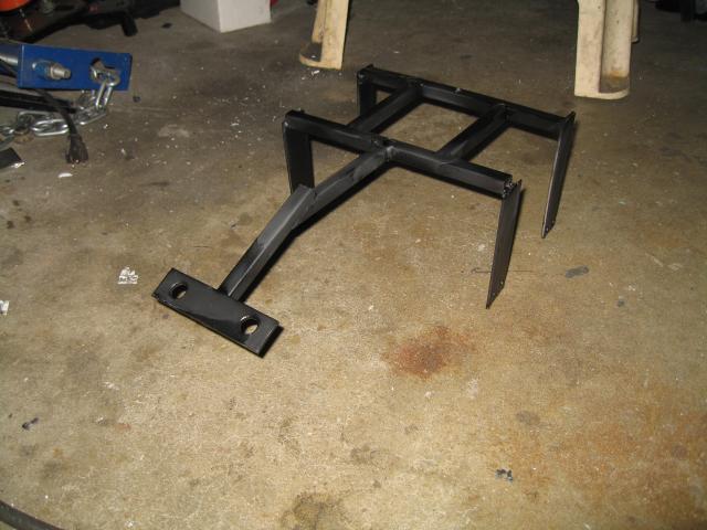

So I set to work adapting a factory intercooler duct to work with the oil cooler. As I was fabricating the bracket for the whole assembly I thought it was sort of funny that it came out looking like some kind of creature when detached from the fan/oil cooler :-P
The assembly about ready to go on the car:
installed:
I still have to wire up the fan to a switch but I'm pretty happy with how everything came out.

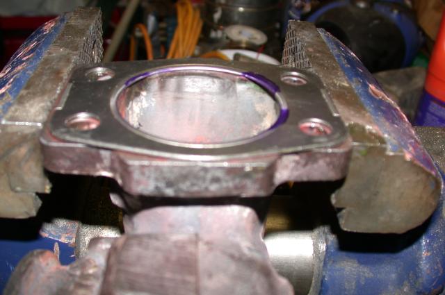

So looking further into my gasket issues I noticed that the turbine inlet doesn't fully match the gasket profile of the factory KKK gasket (the marker denotes where the gasket is exposed to the interior of the turbine inlet):
So my thought is that elevated track temperatures eventually burn up the gasket from the inside out. I never had any issues at all on the street, only at the track did I have problems with blowing up gaskets. To address this issue I (and by I, I mean Fred Soucey, my mega-pro welding instructor
) welded some filler material into the corners of the turbine inlet
and milled the flange flat, so now the gasket has a full surface to sit on.

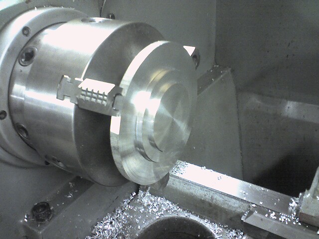

here's the adapter we made up to mill the hot side on the bridgeport.. it bolts where the center section sits and then gets bolted to a right angle adapter to sit correctly on the bridgeport:

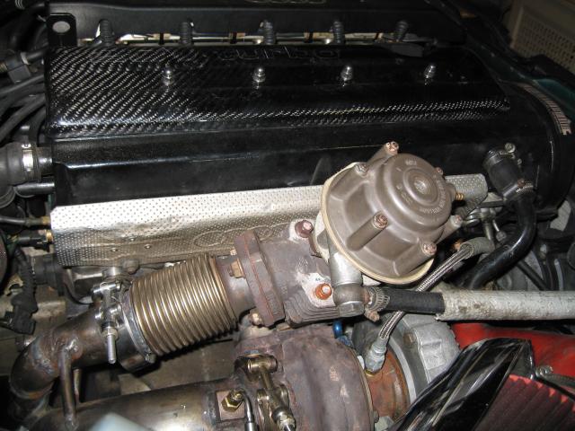

Furthering my addiction to v-bands, I replaced the three bolt flange on the bottom of the wastegate. Downpipe removal now takes 2 minutes

Nice V Band, nice Carbon plug cover tooa4kquattro wrote:Furthering my addiction to v-bands, I replaced the three bolt flange on the bottom of the wastegate. Downpipe removal now takes 2 minutes
Next up, replace passenger side lower control arm before my trip to canada for F1 and Mosport next weekend. Discovered it was blown while crawling under the car to play with the downpipe. Guess that explains the occasional shaking I get under braking :-P
Yeah, other than the extra heat it'll hold in on the coils!timmmy wrote:Nice V Band, nice Carbon plug cover tooa4kquattro wrote:Furthering my addiction to v-bands, I replaced the three bolt flange on the bottom of the wastegate. Downpipe removal now takes 2 minutes

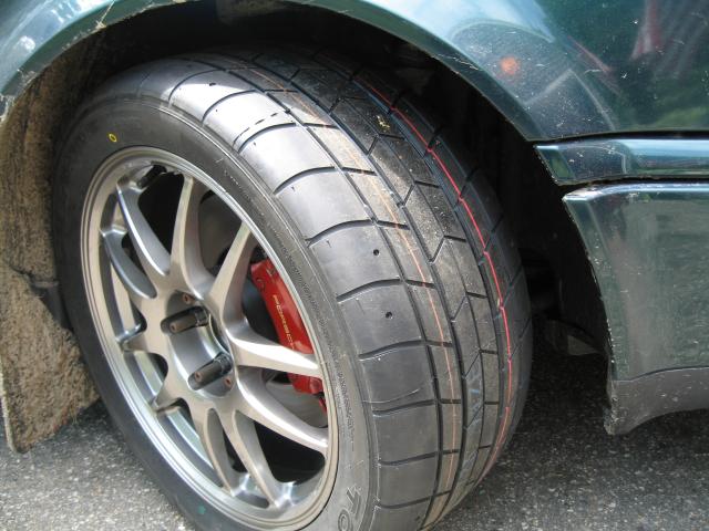

Arrived just in time for the COMSCC mosport track event. Wheels are Rota Torque 17X8 shod with 255/40/17 Toyo RA1s. I would have shaved them if I had time, oh well, these tires still kick ass even with full tread.
