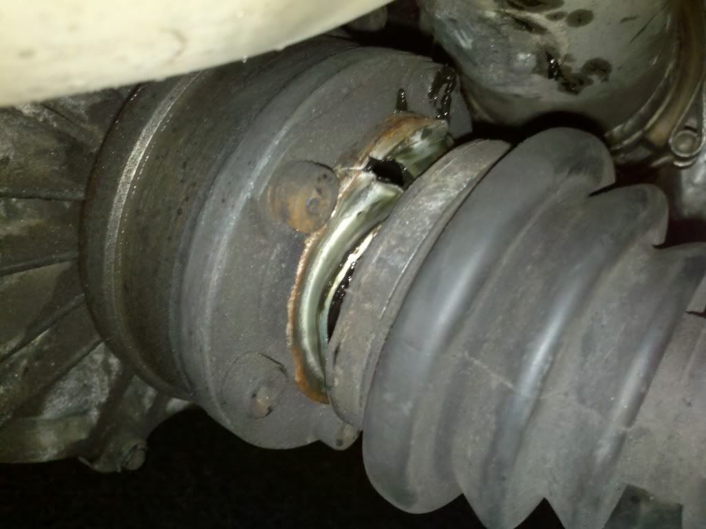

I busted a rear axle tonight on the inner joint. Smoke was billowing out the boot when I looked under there for the culprit after nasty grinding bucking( I think that best describes it) I may be able to get away with just sliding a new joint on the existing shaft, but I also think there is a good chance that the thing is going to be mangled Janis style when I take it apart.. ..

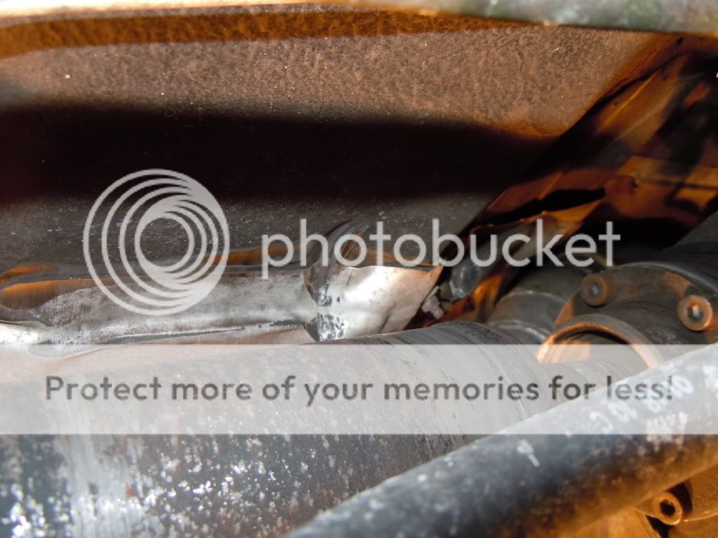

looks like the exhaust took a ding

looks like serious rubbing at some point too(exhaust)..initial fitting?

Yeah, I wonder Hank, when your car squats maybe the exhaust contacted the crazy busted C.V. ???

Yeah, the exhaust "ding" is from when I lost an exhaust hanger, and the aluminum exhaust crashed on the axle for a couple of miles before I limped over to Daves house(the warehouse) for a replacement. I welded on thick portion where that would potentially happen in the future, so it woudln't wreck the exhaust like last time.
The exhaust is somewhat hard mounted to the body, and the subframe is hard mounted to the body, so I don't think they ever come into contact unless a hanger/hardmount breaks.

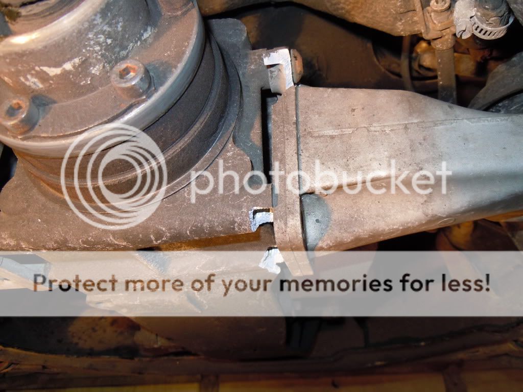

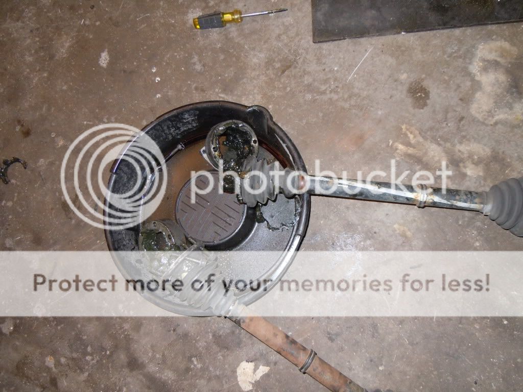

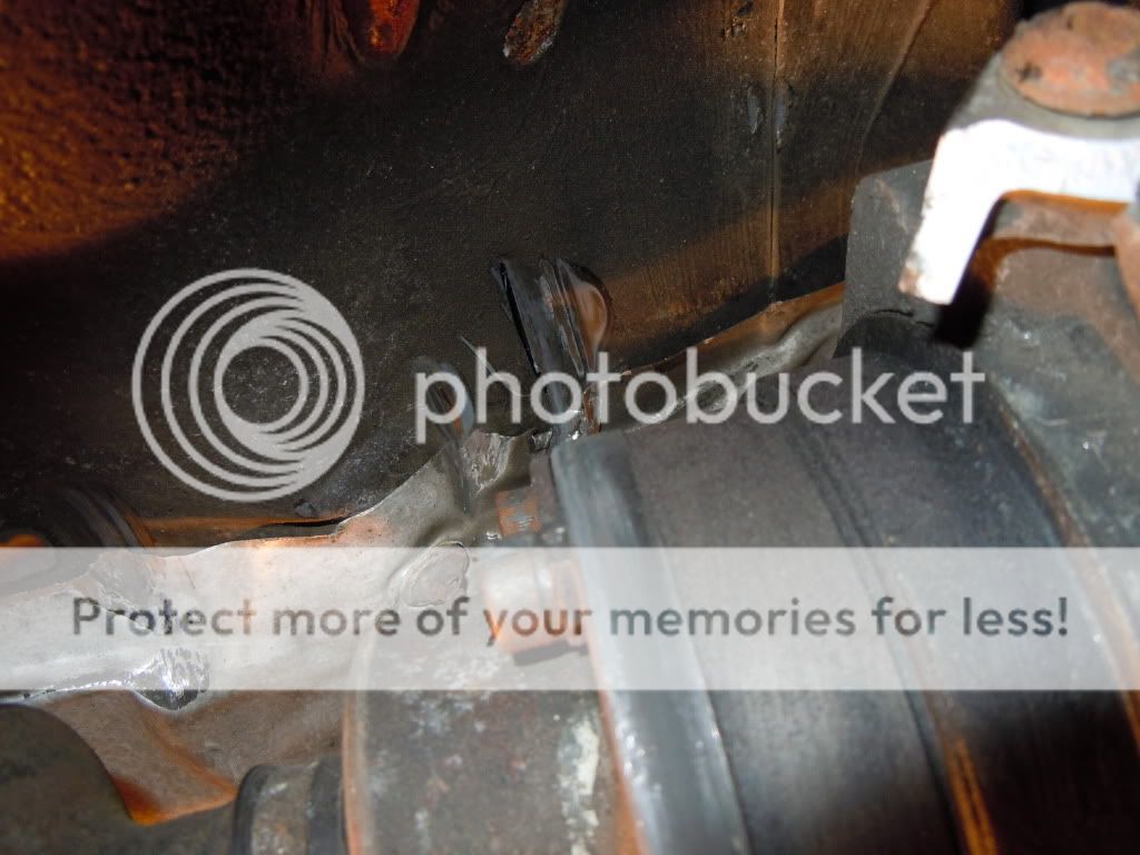

A couple new developments. I wondered last night why I could not get the car to move with the rear diff locked. If one shaft goes, you still should be able to lock the rear diff(it was locked at the time of breaking) and limp with the good wheel, and the torsen would not freak out. (yes Aaron, I have a torsen center diff in an 01e)
Well I found out why that was..
Not one, but two busted inner CVs.
Now here is the interesting part. I had the car up on the lift just 2 days ago swapping in a new 01e trans that didn't have a fubared 1-2 shift collar. I had to take out the exhaust, and I would have noticed this. I even scoped out the possability of putting the big body urS rear diff in there, and looked at the mounts then..
Look how far it traveled up at some point (probably the loud bang sensation when it went)
That gives the drivers inner CV a break, as it would have overstreatched, but the passenger side really had no excuse, as it still had it's mount intact, and a very limited amount of movement..
Anyway, I put the cups from the urS diff in the 4kq diff. They fit perfectly. I misspoke a bit earlier, as I used drivers half shafts in front. So I do have the passenger rear URQ shaft, and it plugs right into the car right now with the urS cups. The other side is going to be more tricky. I am hoping that my axle shows up with 108mm cups, and I can just order a drivers rear 4kq axle and be done with it. if not, I plan on trying to weld a shorter length axle from a 5kq assembly, and trying it. What is the worse that can happen??
