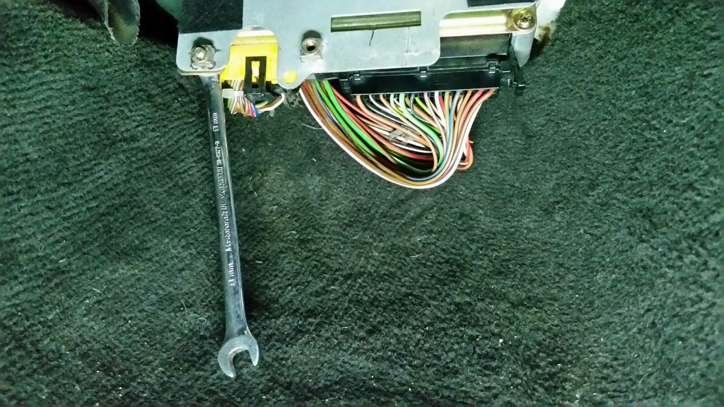

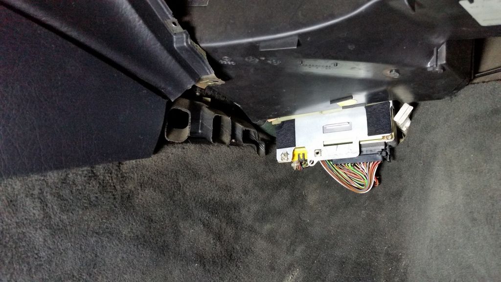

Here's today's issue. When I pulled the glovebox and went to remove the ECU (ahead of installing VEMS), the damn thing wouldn't cooperate.
So with all the bolts and screws out, the ECU slides up and down about 3" independently of the mounting plate. But still won't come out. The threads I've read say it should just slide right out at this point. Not sure why, but the electrical connections refuse to come off (I'm being firm at best, as I don't want to ruin anything being hamfisted).
Any tips or tricks with this would be greatly appreciated. :)

How to pull the main wiring harness off of the ECU?

push the tab on the right towards the left and pivot the whole plug in a counterclockwise rotation with the left side of the plug being the pivot point. Does that make sense?
Re: While I'm In There... CGR Install & Stroker Prep
dana wrote:push the tab on the right towards the left and pivot the whole plug in a counterclockwise rotation with the left side of the plug being the pivot point. Does that make sense?
Thanks Dana, you conveyed your point with crystal clarity. However when I tried that it just felt like something was going to break. I wedged a flat screwdriver blade into the seam above the VW/Audi logos and pried it up a tad... looks like there are pins inside holding everything firmly in place.
It's probably something really simple that I'm not seeing, but I'll try again tomorrow.
