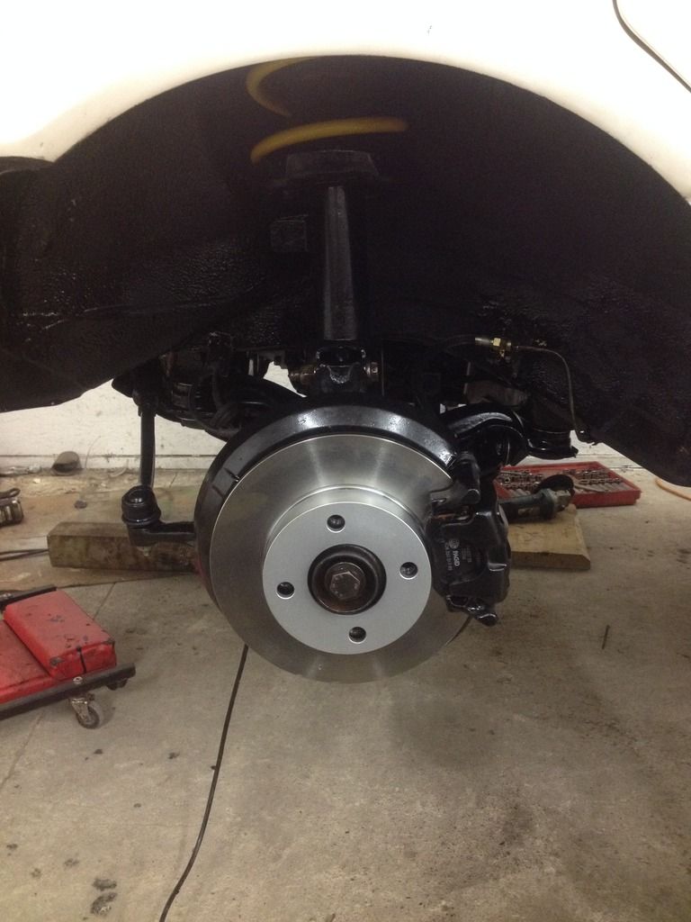

rear subframe and suspension installed finally!!
I finished all of the extensive sheet metal replacement in the rear quarter panel and trunk floor. That job was crazy. I have hundreds of hours into the rear of this car. Should have started with a better example, but it has been a great learning experience.
All new control arm bushings, ball joints, rear tie rods, koni adjustable shocks, ST springs, brake pads, lines and rotors, strut mounts, rear diff resealed, locking actuator repaired, HPR rear diff mount etc etc etc. I made the mistake of adding up the cost to refurb this rear subframe.....:barf:
Pretty stoked to see the car going back together instead of coming apart.

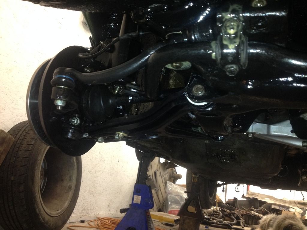

finally had the chance to do a little more work on this.

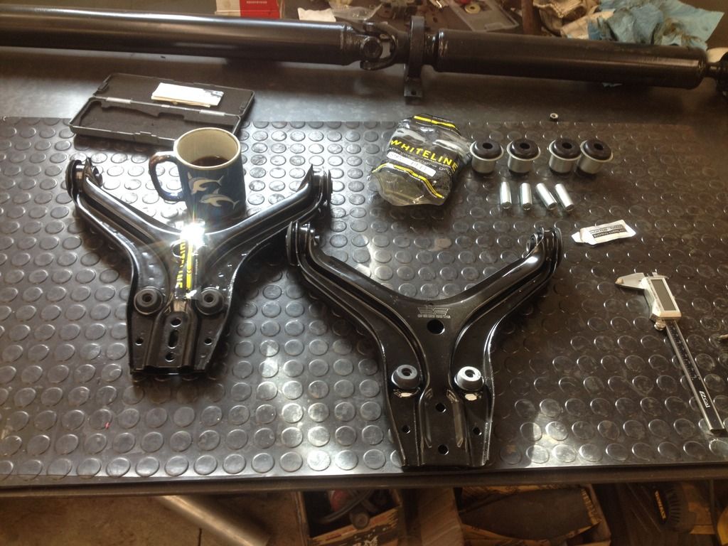

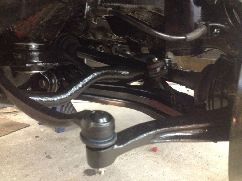

control arms do-over. Got a new set of 4kq front control arms for the back of the 90 from rock auto. Sold under the dorman name, chinease built, but actually pretty good quality. I did this so i could mount my 4kq front swaybar in the back of the 90. I burned out the bushings they came with and put another set of whiteline bushings in
rear suspension finally buttoned up, new everything Image
next up, rebuild front subframe and suspension

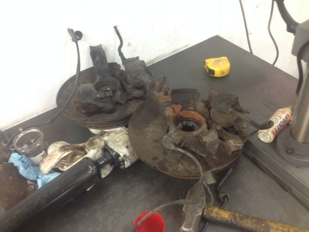

gutted

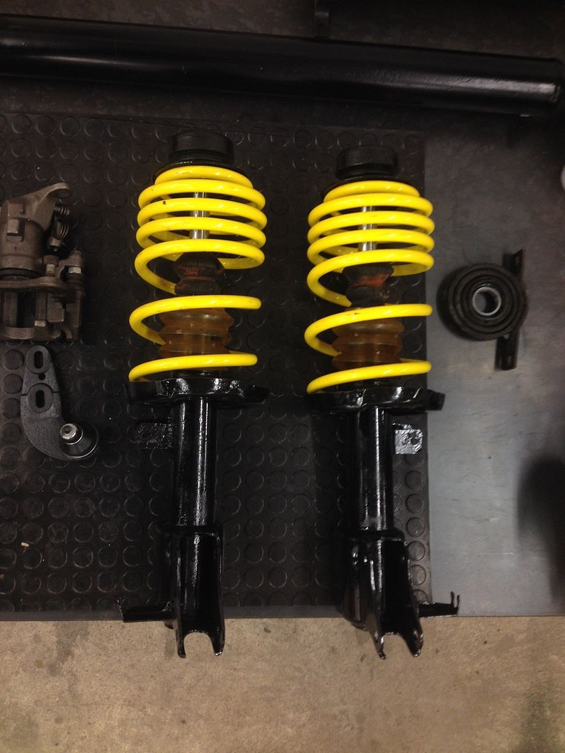

spindles out and ready to be refurbed

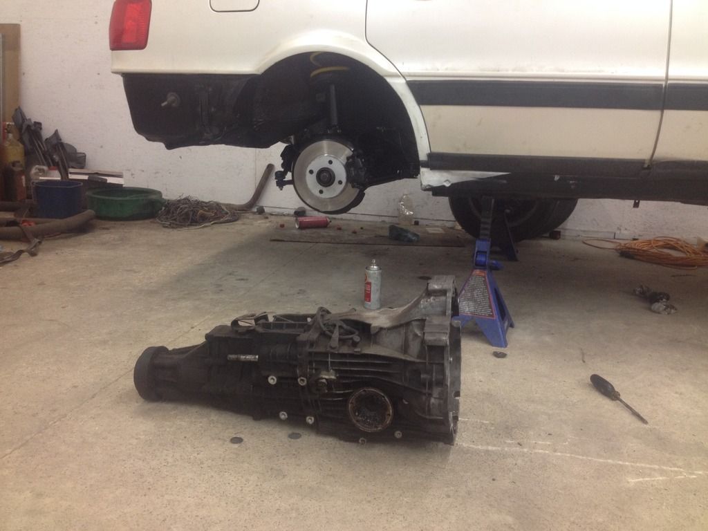

01a trans removed
