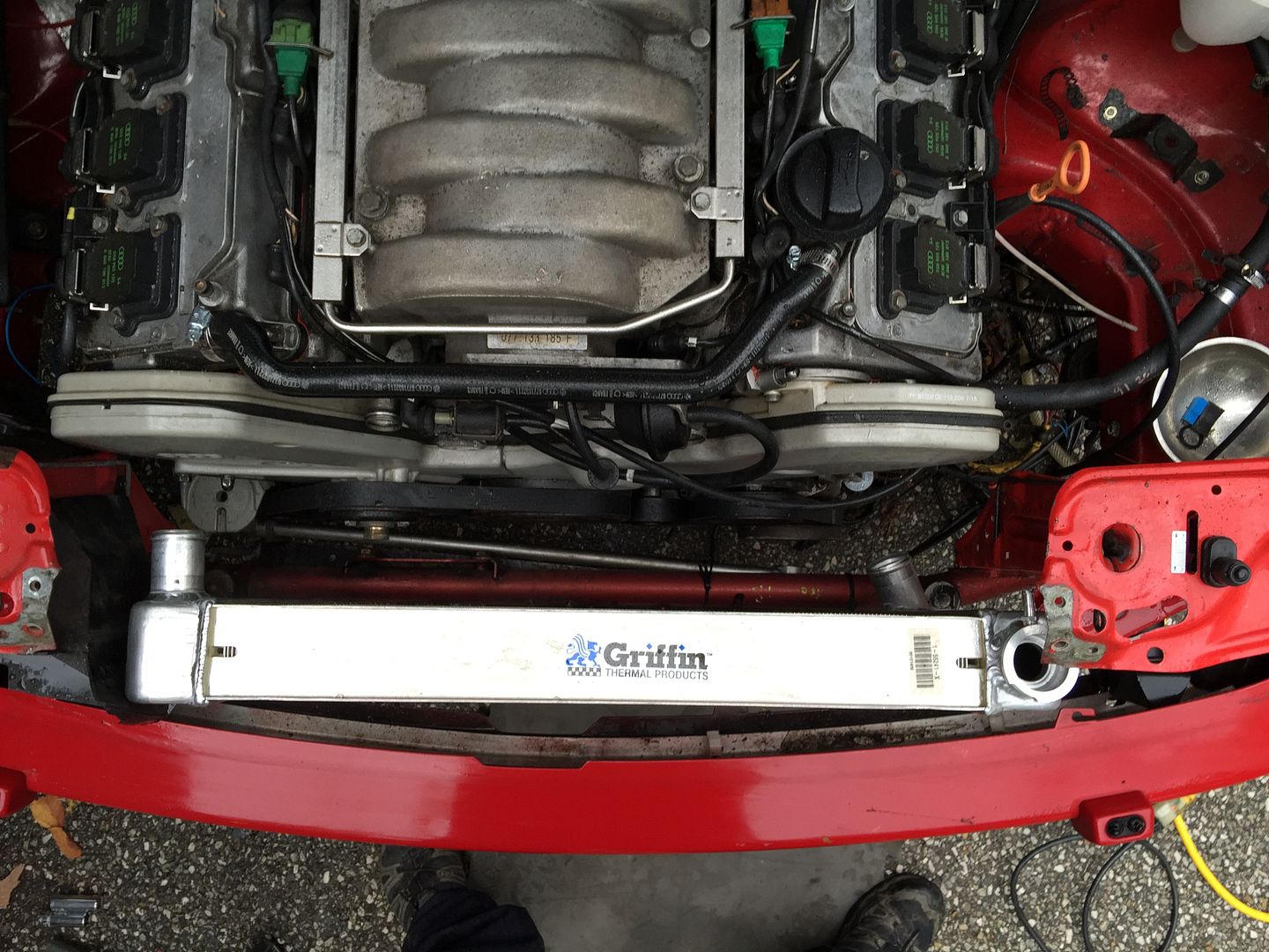

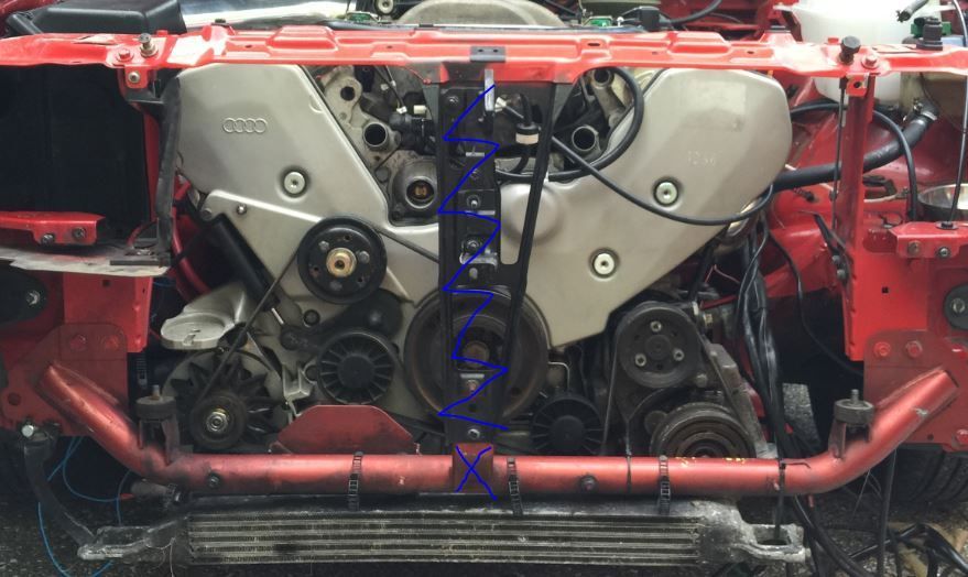

I got the radiator yesterday and it definitely fits - did some brief mock up and it's clear that I will need to remove the center support to create some room behind it.
Here's what I got:
(http://www.griffinrad.com/load_details1 ... odel=Racer)
I'll try to post some pics when I get home tonight.

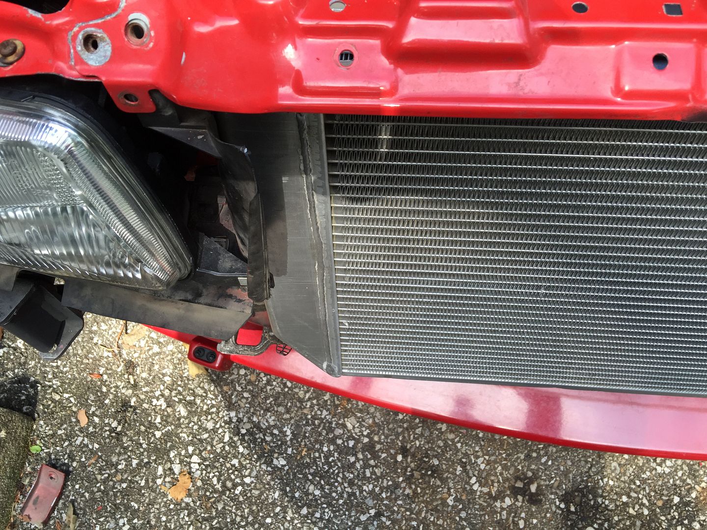

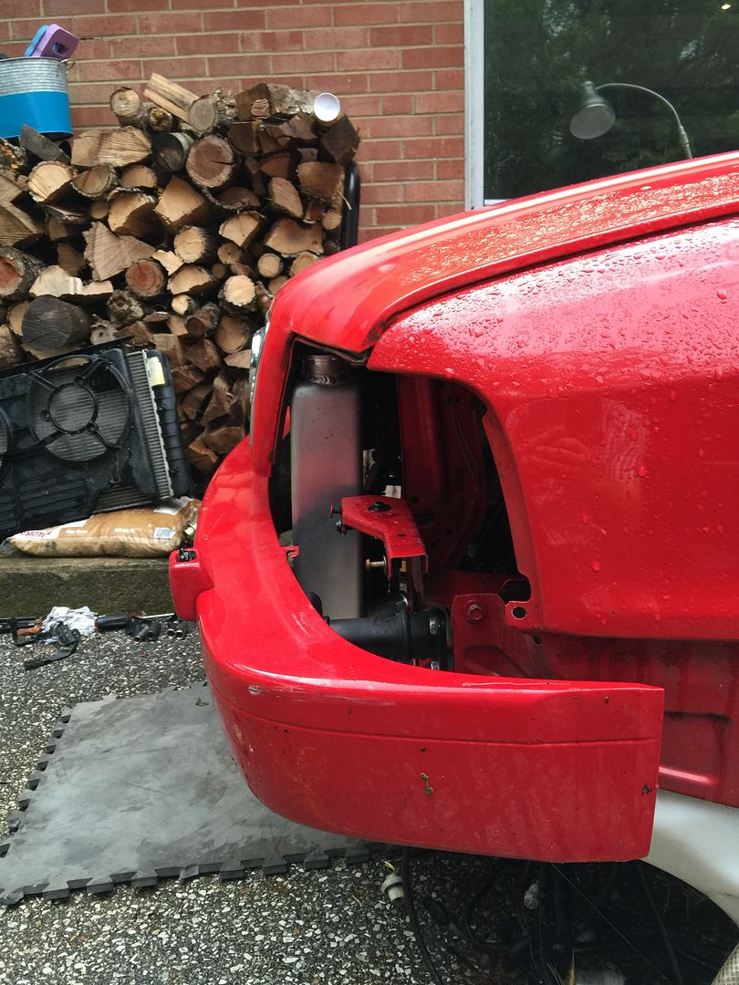

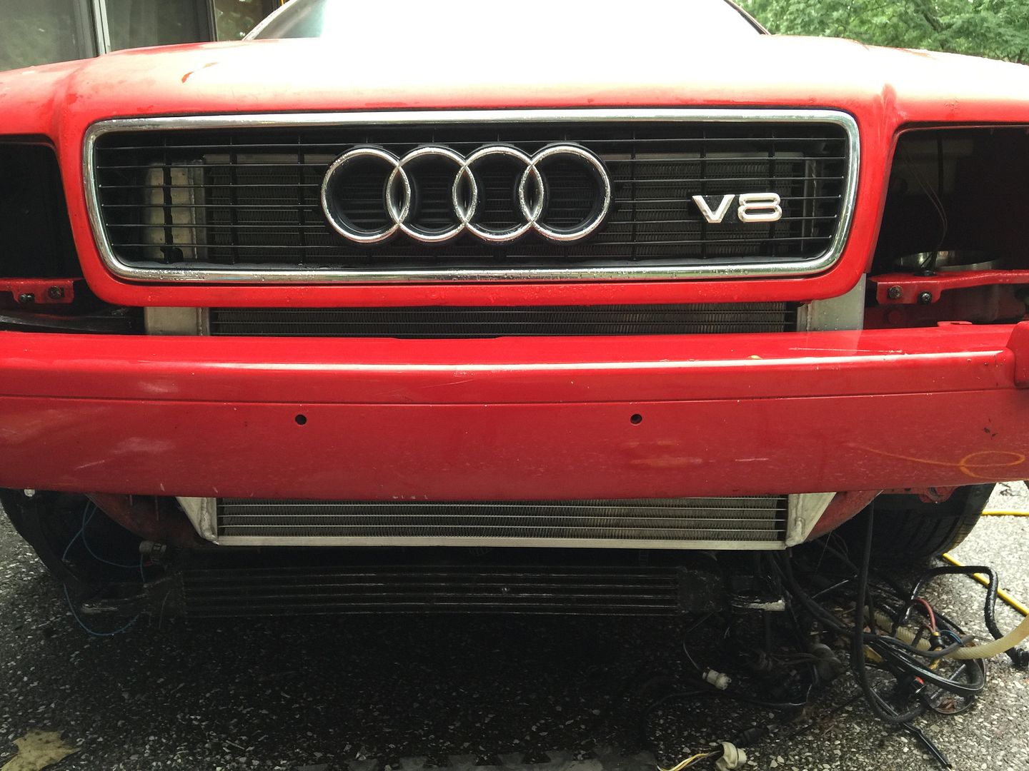

Got some pics and did some fitting today!
Here's the radiator sitting on the v6 ratiator support. you can see it's a great fit:
I'm going to need to mount it in front of that crosspiece to make enough room behind it.

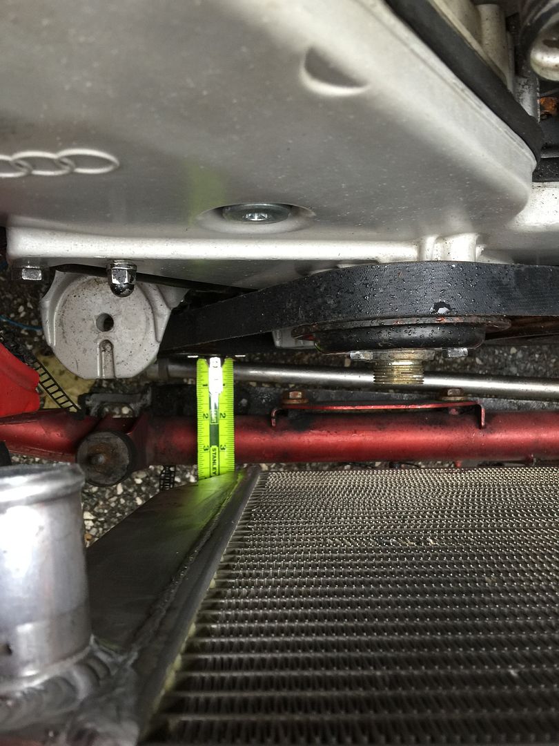

Here it is mockedup as far forward as I can get it. with the hood latch cut out I can make it sit totally upright...
Got about 3 1/2" clearance in there.
Now to make provisions to mount it.
for us non-welders, there is aluminum epoxy - is that strong enough to use for this?

My suggestion would be find a local enthusiast who can weld and trade him restaurant gift card :)

Please find someone to weld it on. If I was closer, I would do it for you. I would hate to see you go through all this work just to have the rad fall out going down the road.

Yeah. I can get my exhaust guy to do it for sure.
I'm actually about to build a garage - hopefully before winter - and I will have a place to set up a welding rig. Then I can learn!

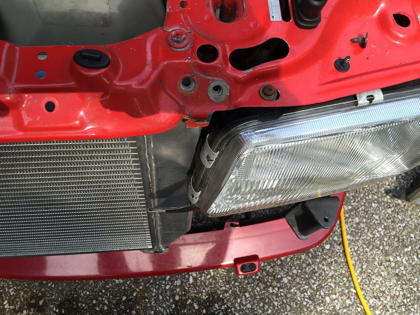

Make sure your headlights clear (mine were a tight squeeze due to them being B3). I used alumi-weld for putting tabs on mine as I didn't have my TIG yet.

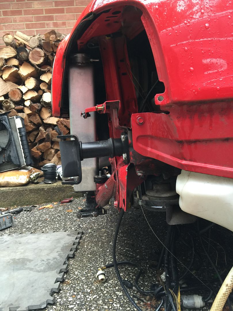

I put the headlights on today and am working to figure out how to make all this fit...
Driver's Side:
Passenger's Side:
Obviously the tabs for the headlight trim keep me from tilting the top all the way out. I'm thinking I may actually keep the radiator and cut those tabs off. I'd rather figure out another mounting method for the trim (or forego it altogether) than reduce my radiator size. Not sure what I'll do but I'm trying to figure all this out without screwing the radiator up so I can still return it if need be.
This is the issue most people have run into with radiator choice. I trimmed the support rib on the back of the tabs to make mine fit, and it looks like you could do the same if you shift your radiator over toward the PS from where it is in the photos (and cut that plastic shrouding back on the PS).
